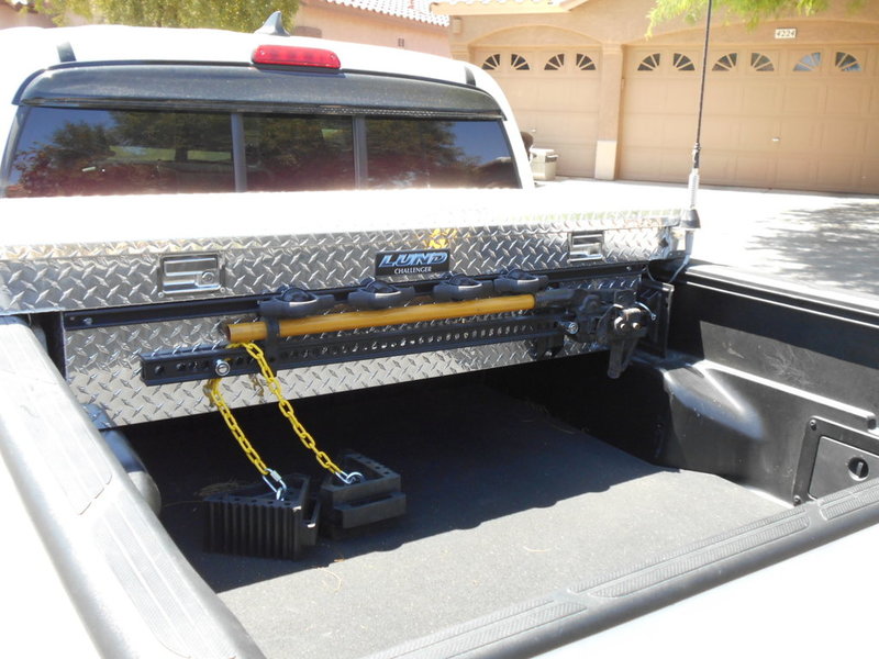

Put some extra heavy attachments from the box to the bed - so the forward tie down rail could be remounted on the box. Used a piece of square tubing to replace the rail. It spaces the box away from the window so the lid swings free. Jack is clamped with wheel studs and lug nuts that match the truck.
