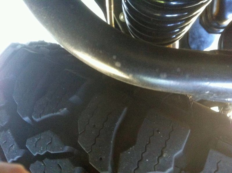

Top Down shot of Light Racing UCA leading arm
2012 DCLB Tacoma Sport with SCS F5 wheels, LR UCA and OME 886 coils/nitrocharger shocks up front This is a top down photo of the leading arm of the Light Racing UCA on the driver side with tire turned full lock right. Showing clearance (or lack of) when using 265/75/16 GY Duratracs and SCS F5 wheels with 4.5 backspacing. Compressing the suspension 2"-3" under these circumstances causes rubbing between the tire and the UCA. Rubbing occurs on the passenger side when the situation is reversed (full lock left) and suspension is compressed a couple of inches.
