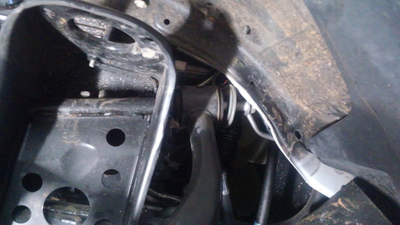

UCA Bolt - passenger side
UCA bolt catches on passenger side here. There's two layers of metal. It's impossible to remove without extensive sheet metal cutting. It's a little bolt - chop with a 4" angle grinder and replace it, putting it back in backwards. The replacement part is Upper Control Arm Bolt - Toyota (90105-A0095)
