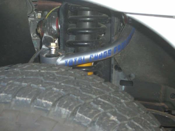

uca5
uca5

      How was the install on them? Ive been lookin at them.
    • FLATaco06
      What is the benefit of the new UCAs? I know that's probably a stupid question but it is what it is. =p
    • chris4x4
      Total Chaos UCA's add caster to the front geometry that is lost when lifting. When used with longer shocks and springs, more travel can be had as well. They use a Uniball instead of a Ball joint, for more travel, strength, and they can be rebuilt easily. :)
