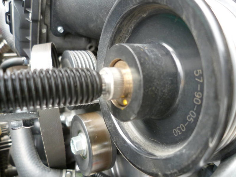

Closer look how the extractor shaft goes onto the allem bolt. You can see, the pulley is not flush with it's shaft, it takes quite a bit pressure until it cracks and begins to be pulled.
