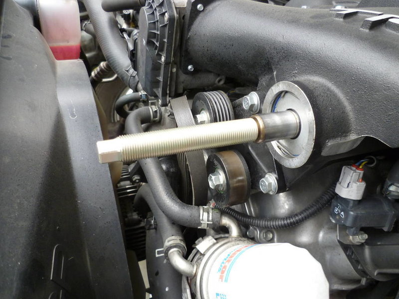

The installation shaft. Now all you need to do is start the new (heated) pulley, washers and bearing, and finally the nut. If it's done quickly it does need just a little effort. But with a pals help is much easier, keeping the shaft still.
