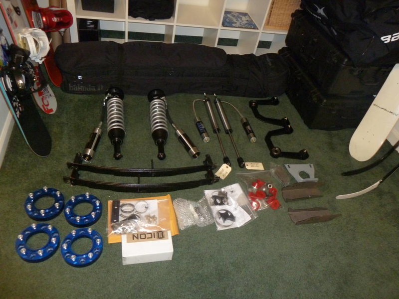

Waiting....
Waiting....

      You're probably gonna wanna keep a drill handy, you'll have to wallow out the holes for the front resi mounts, the dimple cuts make it impossible to mount.
