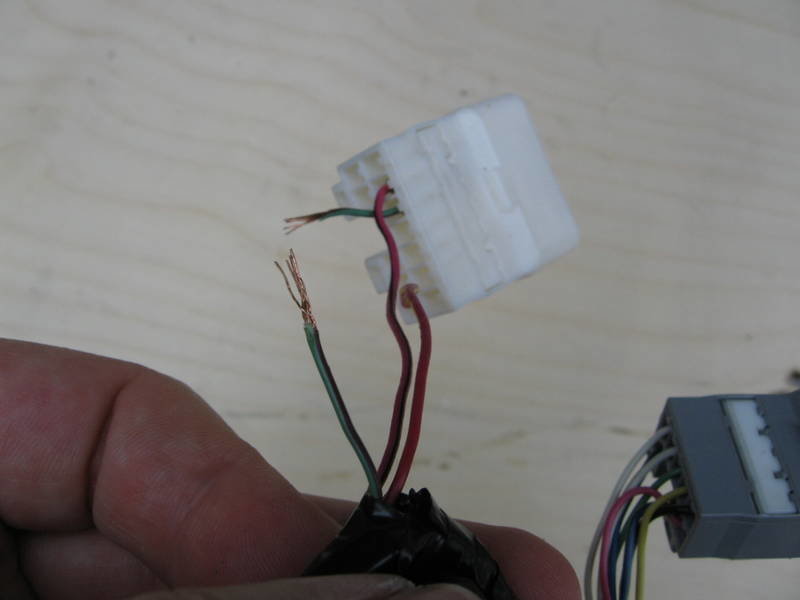

Wire to cut... (DRL disable)
This Green wire with a Red stripe going from the DRL module to the plug on the lower backside of the ECU is the wire to cut to disable the Daytime Running Lights.
