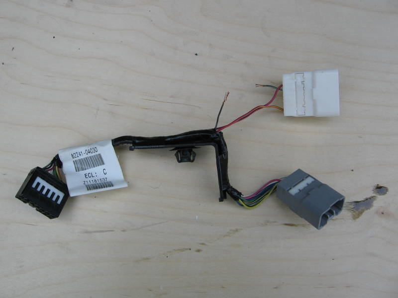

Zoomed out wire to cut... (DRL disable)
The Green wire with the Red strip is going to go from the white connector to the DRL control module. This wire is only one of three wires coming from this particular connector.
