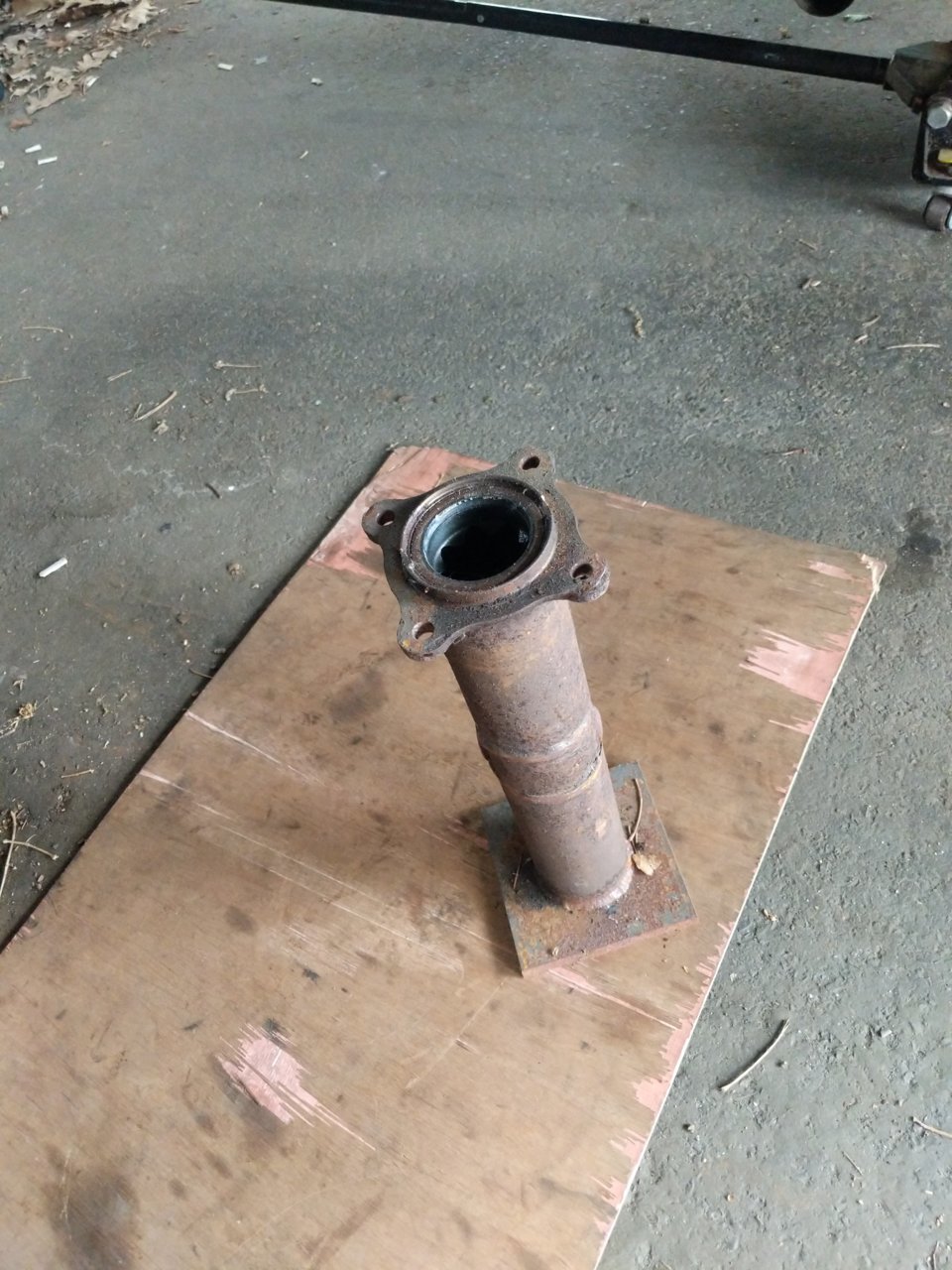

    The tool you need for rear wheel bearings.
    This was cut from a diff housing. A hole drilled in the bottom as seen in the pic for the axle to pass through.

    That's nice how do you get the old bearing off? Beat the snot out of the end of axle? Don't forget the bearing retaining ring is under size and that press is what keeps the axle from running out of the new bearing because it is a size fit. This really is not a backyard project.
