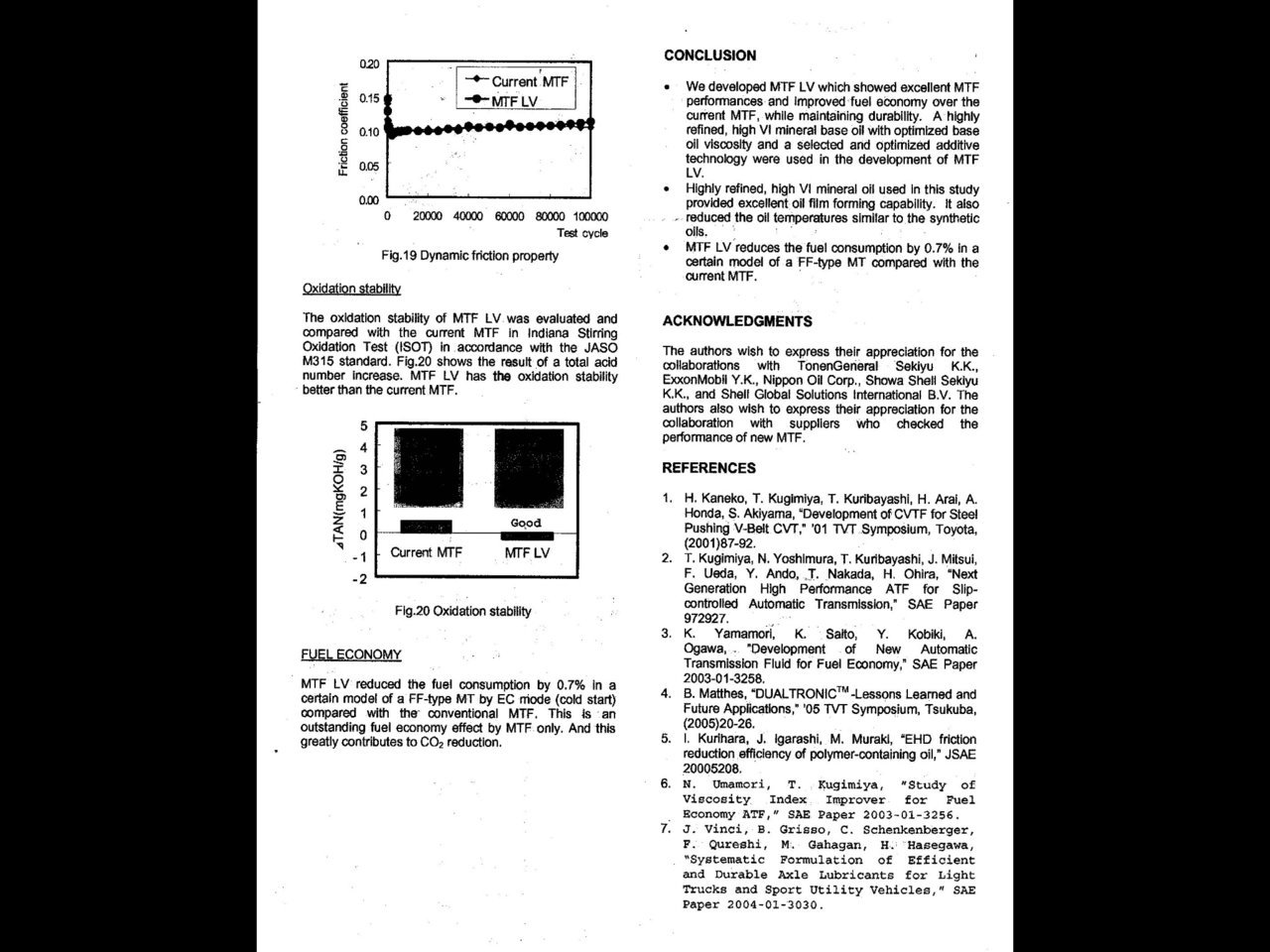

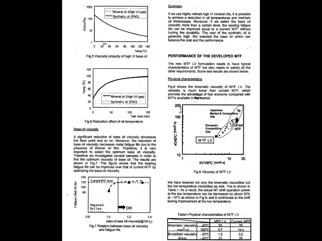

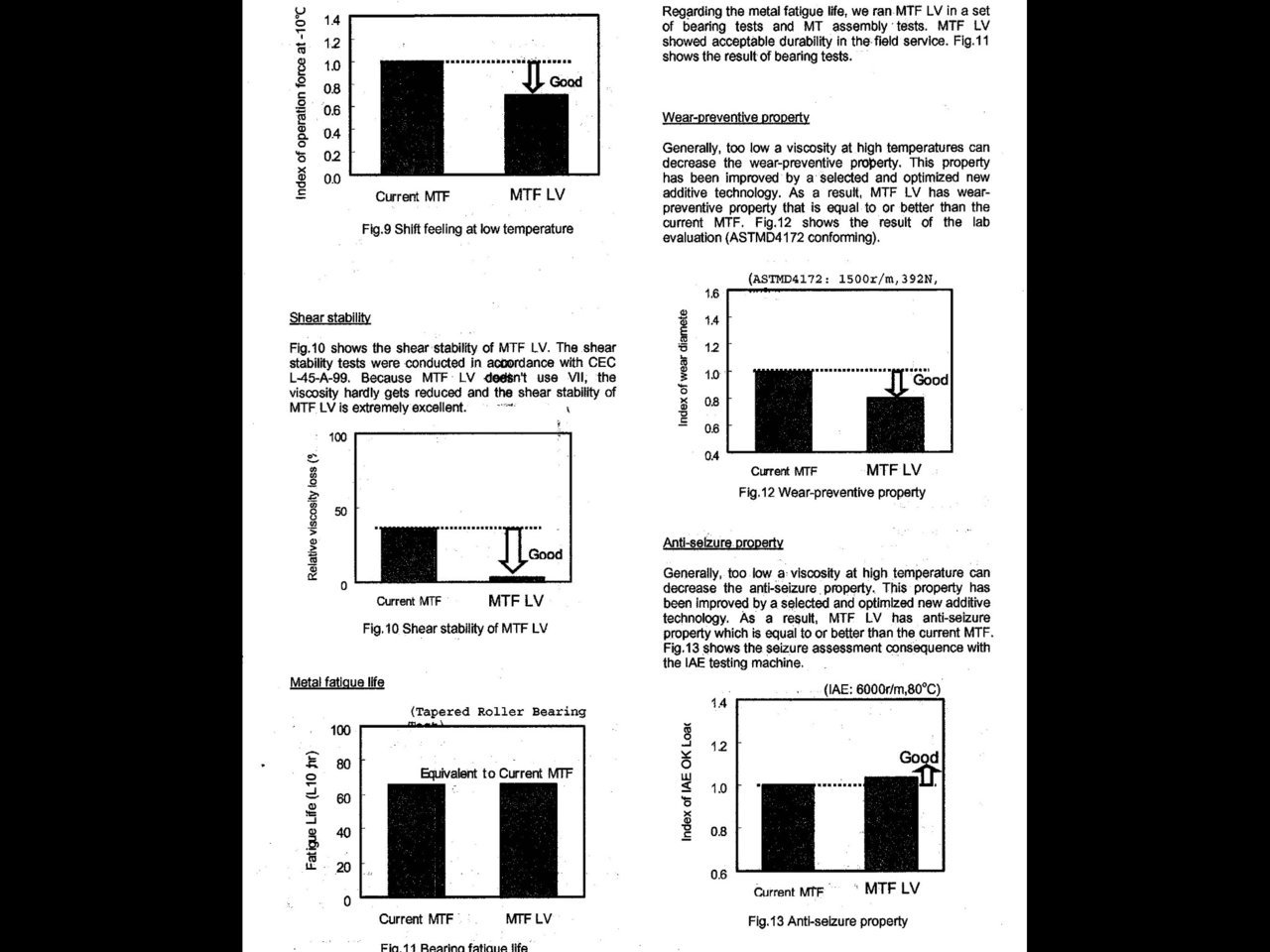

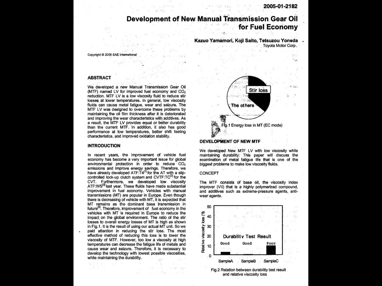

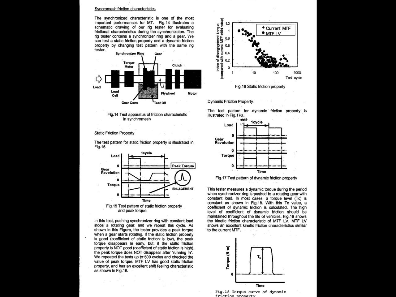

    This paper is far from perfect (political)... and deals with the LV 75W, which the LF is very likely based upon. The comparisons go back and forth between the old convential 75W90 MTF, a Group III, and a PAO. The additives are there to take over when the thin oil can no longer do the job of maintaining a barrier.
    IMG_3031.PNG.jpg IMG_3032.PNG.jpg IMG_3033.PNG.jpg IMG_3034.PNG.jpg IMG_3035.PNG.jpg IMG_3036.PNG.jpg

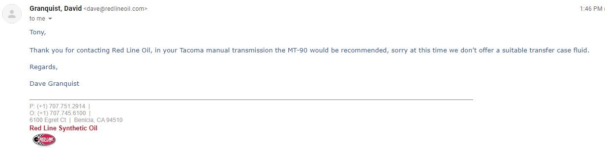

    I checked with them about that a few weeks back (October 7th). They replied quickly and said that they do not have a product for our T cases:
    I am not exactly certain why, but I do not think that LV and LF are the same?

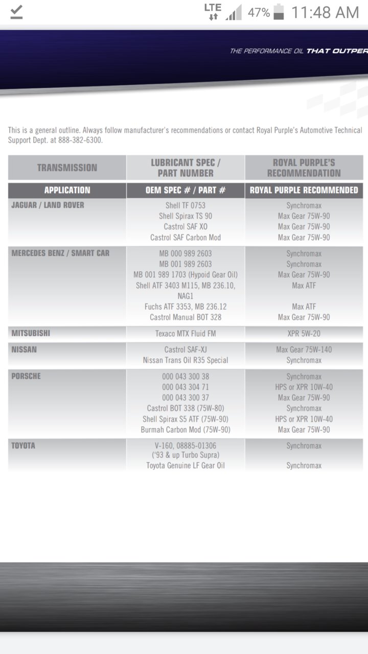

    These claim to be suitable; I haven't gone looking in a while though.
    -Ravenol MTF-3 75w
    -Bravoil FMT-3 75w
    -Morris Lubricant Lodexol MTFE 75w
    -EXN-MTF 75w
    -Royal Purple Synchromax

  15. Oct 29, 2019 at 9:42 AM
    #35
    tonered
    tonered bartheloni
    Sep 25, 2017
    #231055
    31,068
    tony
    Lynnwood, WA
    Nice list. But, RP Syncrhomesh / Synchromax is not listed as an application on their site:
    Now, tying all the fluids to VOAs would be killer.
  16. Oct 29, 2019 at 9:48 AM
    #36
    splitbolt
    splitbolt Voodoo Witch Doctor
    Mar 7, 2010
    #32761
    7,858
    NW Arkansas
    2016 TRD OFFROAD DCSB MGM
    Excuse me; Synchromax...
    From their PDF...
    tonered[QUOTED] likes this.
