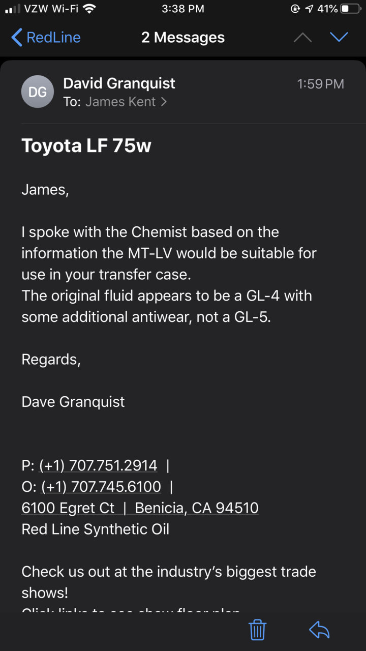

    Here’s my reason for looking. I’ve said this over and over, I do not like the fact that a manufacturer(not just Toyota, they’re all guilty of it) putting their customers into a corner with its “dealer only” type of products and/or service. If I can get 60k out of a 75$ can of fluid, about 2 years for me, that’s not a bad cost average. Even yearly it’s not that bad. I had some a/c work done around 37k and told them to do diff’s and t-case while in shop ( I should’ve just bought a new truck), my fault for not paying close attention when they quoted price. Now I’m closing in on 90k so I’m changing fluids and don’t like what I’m being told, stubborn that way sometimes. I also like supporting smaller independent businesses when possible, you know, the ones that take time to speak to you if you have questions about their products

    Well for what it’s worth, I was just told that the LF75W is a gl-4 with extra anti-ware additives, this is some of what I wanted to know. So the dealerships do not need to be using gl-5 fluids in t-case. I was also told that Red Line 70w75 would be a suitable match for use in transfer case as well.

    What does Redline say?

    That’s who told me

    I forwarded the ExxonMobil SDS for the LF75W that @Jeff Lange posted up along with the VOA of the LF75W to Red Line and the response was what I stated. Now, I hope all of you don’t go blowing up David’s email and/or phone. Here’s the email for verification. All I ask is to Please be respectful of his responding to me AA9EEEE8-E5D3-4DC2-9A92-0E50DBA73322.jpg

    I’m going to try the Red Line, I have both the 70w75 MT-LV and the Can-O-Gold só I can swap out if needed. I’ll give updates as I go.
