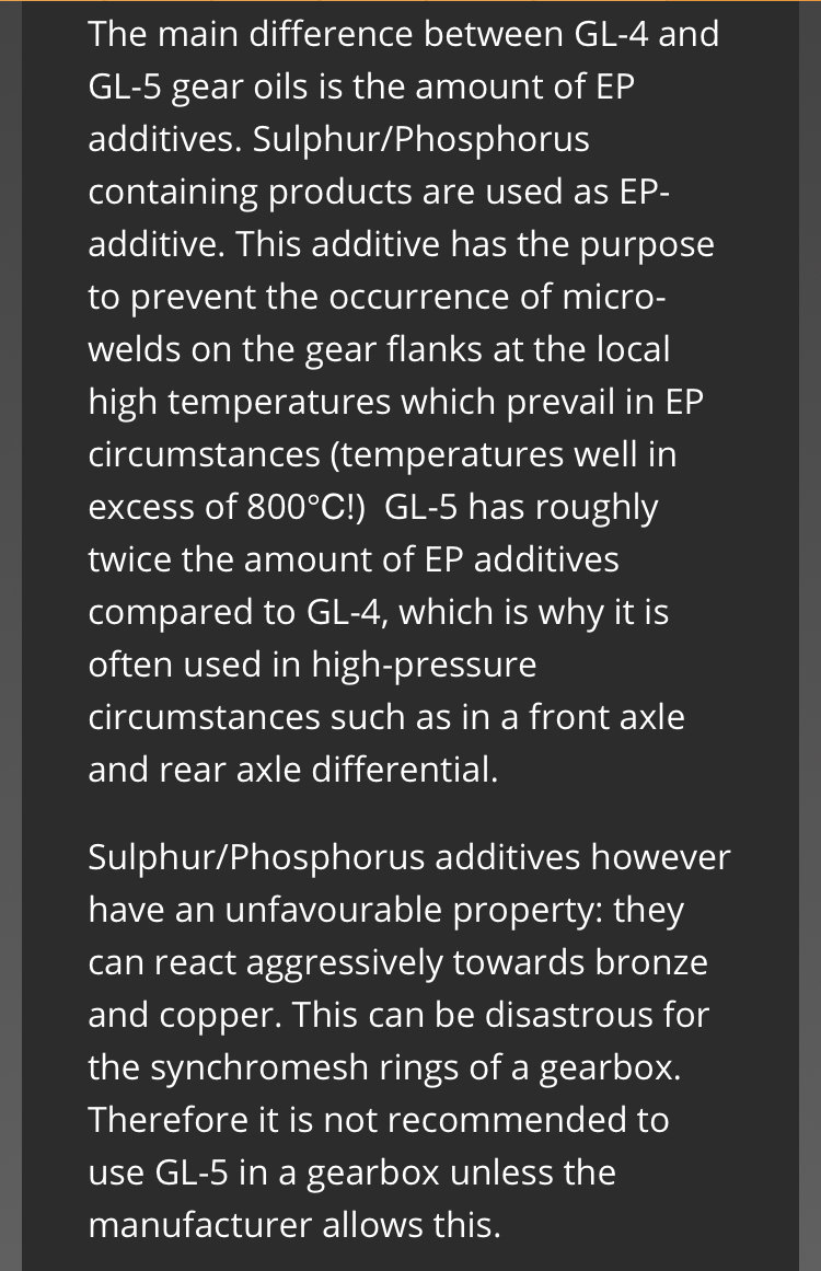

    That is one of those partial myth things. Good modern GL-5s will not harm bronze/brass.
    Amsoil and others make good GL-4 MT fluids.
    Now I know there are some poorly made GL-5 some low cost gear oils that I would not put in my MTs.

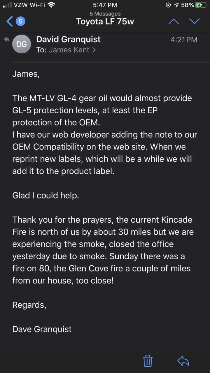

    Here’s a follow up email from Red Line concerning their MT-LV. E6C83CAE-C78E-4E7C-BA02-19BF58C7E382.jpg

    So is that Redline saying their MT-LV is close to the Toyota 75W LF, but just not quite there?

    It says that their MT-LV will provide the same level of protection as the OEM at the minimum, possibility more.

    That is what I read as well.
