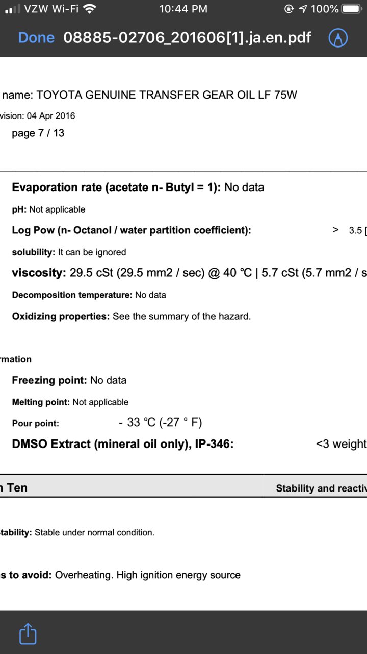

    I think I need a reset. What is the actual 100°C viscosity of the Toyota labeled product?

  12. Nov 1, 2019 at 5:38 AM
    #112
    Pablo8
    Pablo8 Here!
    Aug 7, 2019
    #301483
    9,820
    Paul
    Everson WA
    2019 Cement Sport 4X4 MT AC
    OVT, 4.88, ADM, F&R ARB lock, KO2's, RWD L MOD
    5.7. Thanks.

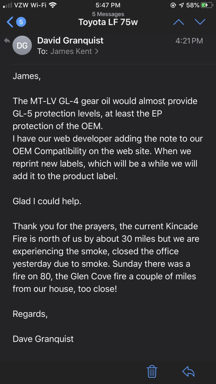

  14. Nov 1, 2019 at 7:05 AM
    #114
    You did what?
    You did what? [OP] Well-Known Member
    May 30, 2018
    #254934
    52
    James
    Ar.
    ‘16 TRD Off-Road
    C82A4129-B429-43FA-A016-81C5F2F3810A.jpg 1A5FB418-71B9-452F-BEFF-700D8811E6D6.jpg

    Thanks for the discussion, I ordered the redline oil and I guess we’ll see how it goes.

    I did the same just ordered mine too

    Anyway, the Red Line LV fluid is reasonably priced. Having to stock another unique fluid at home is a nuisance, but that's about it. Either way I won't have to worry about it until 2022.
