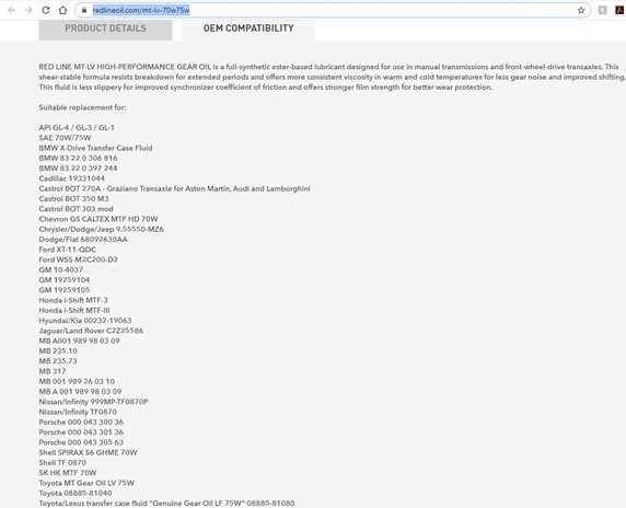

    Honestly haven't done any VOA research, I know that when I was looking at T-case oil options last go around it was RP, Ravenol or OE that I believe were listed as LF75W equivalent. I discovered through various threads and general comments outside of T-case gear oil specific threads that Redline recently got email confirmation from redline and the labels now reflect OEM Compatible with Toyota LF75W (part #08885-81080).

    Yes. The RL compatibility was in this thread. I think RP is a multi grade and had some other questions regardless what their website says?

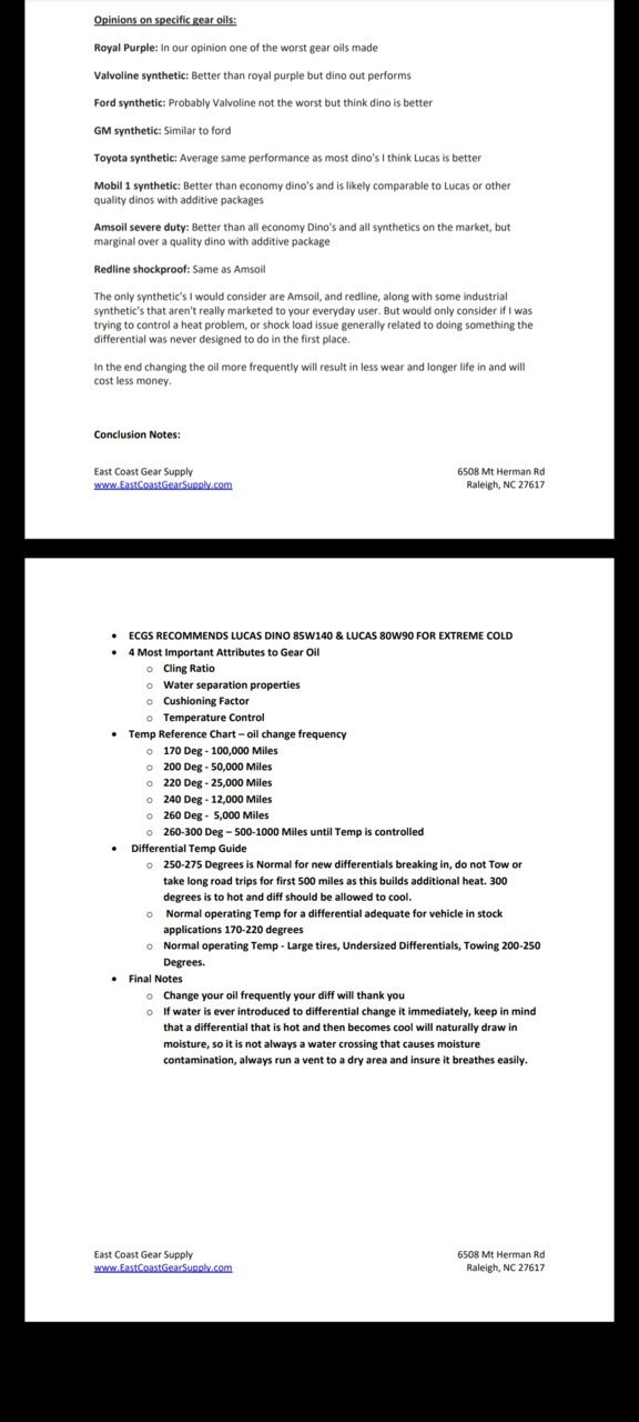

    All the info regarding Dino VS synthetic and Lucas oil is in a download pdf on their website. Here is a screenshot of the the 3rd page of the pdf:
    I don't agree with them unless you are fording deep water all the time and your axles are sucking water. When I was in fleet maintenance 20yrs ago almost everyone was switching to synthetics, all the studies and testing indicated synthetics were a win win in every category.

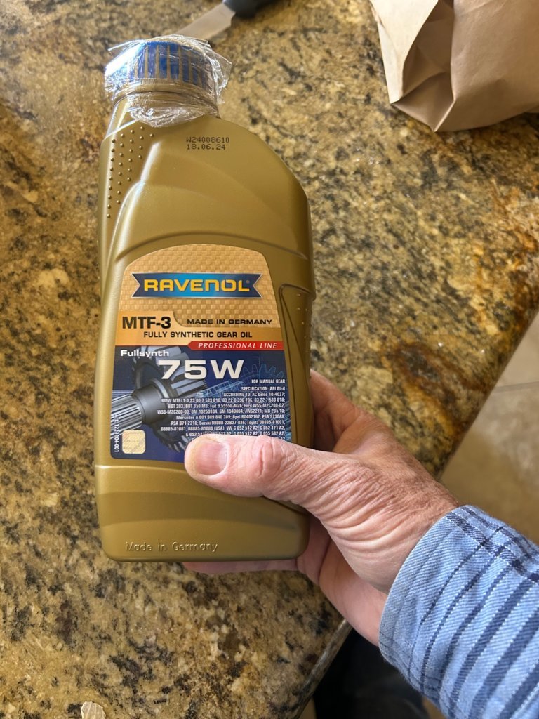

    So, I just got my liter (litre?) of Ravenol 75W for my Transfer Case delivered by Amazon. It says right on the bottle that it is spec'd for Toyota.
    Also, the Blauparts website has a good explanation as to why Toyota (as of 2016 in 3rd gens) is using 75W rather than the older 75W90 oil used in the 1st and 2nd gens. https://www.blauparts.com/blog/what...acoma-transfer-case-fluid-specification-guide
    In addition, although I haven't used it yet, I understand their bottle has an interesting tube attached to it so you don't need a pump to get it into the transfer case.
    Cost me (as of Nov 2024) $45 ($29 for the oil and $16 for the shipping). The actual vendor is Blauparts.com and so I went to their website and they sell it direct for $35. ($20 plus $15 shipping). I ordered on a Sunday and it came on Wednesday.
    DARN. Coulda saved $10--which is a LOT for a single quart (oops--Liter) of oil.
    Next time I am going to Blauparts directly. Forget Amazon
    I tried to get the Toyota brand 75W gear oil from my local dealers . . . but they don't carry it even though some say they do---very strange. I even went on Amazon and ordered the Toyota brand there from a dealer in Miami, Florida (I'm in Phoenix, AZ). After about a week got a message saying that the shipment was delayed in transit. Waited another week--same thing. Sooooo-I cancelled and got a refund (over $100 for ONE quart (liter) and noted that the new price from that Miami dealer is $120/liter which is $25 more than when I ordered it 2 weeks before.
