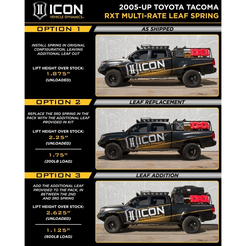

    I've heard great things about the Icon RXT leaf packs. Plus, they can be set up for minimal lift.
    Pretty much all aftermarket leads provide lift. You could go custom leaf packs from Deaver, but I don't think that is what you're looking to do.
