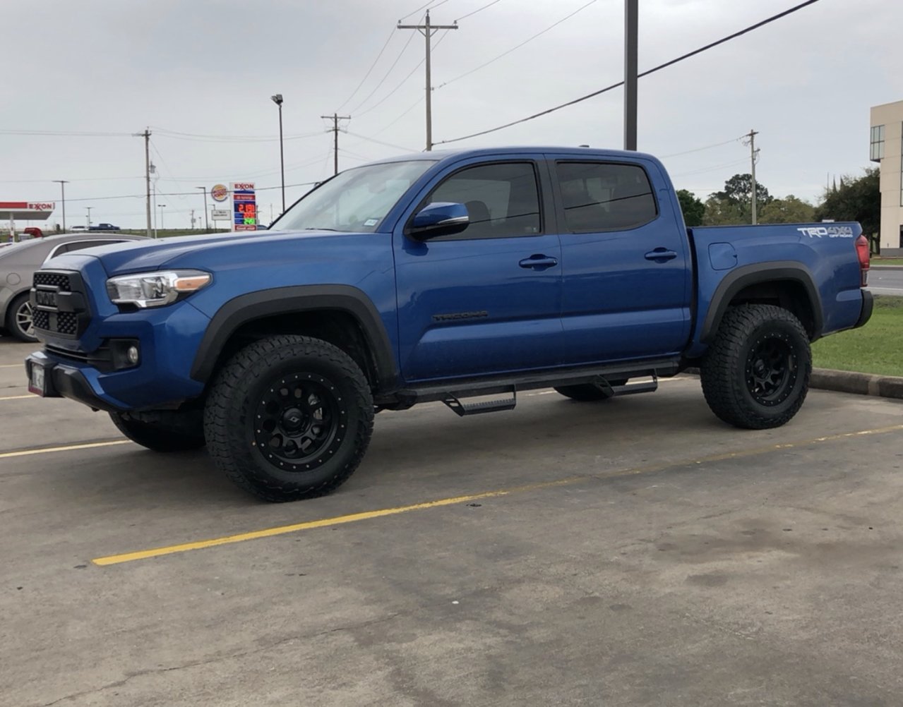

    2018 TRD OR
    TRD Pro grill
    Stock suspension. Rubs on plastic when reversing or going up/down a driveway hot. Easiest fix!?

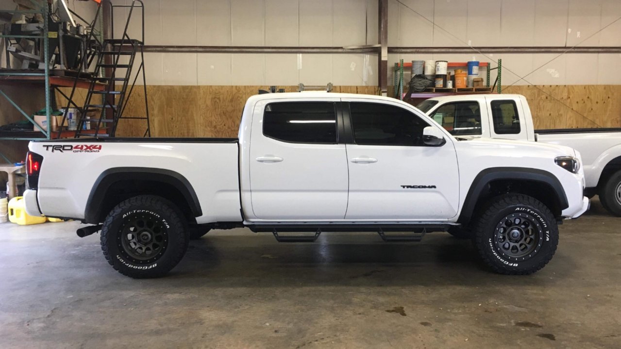

    KO2 Ray10 5100’s 884’s Rx350 Retro Headlights
    Lift the front an 1” min. I did 5100’s and 884 springs and still rub every blue moon.

    You don’t have to cut anything with 265/70/17

    FWIW I’m the OP in that thread, and caster wasn’t the answer. Some light trimming and heat molding worked though.

    Did you add anything to rear?
  17. Apr 5, 2019 at 12:52 PM
    #17
    SgtPuddin
    SgtPuddin Well-Known Member
    Apr 8, 2018
    #249851
    660
    Mississippi
    2018 Tacoma TRD Off-Road DCLB
    No, stock height.
