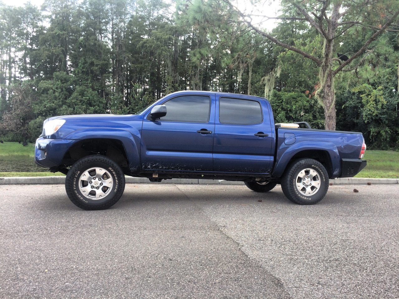

    Some fellas like this look:
    Junkhead, philth and 44-16 Taco like this.
