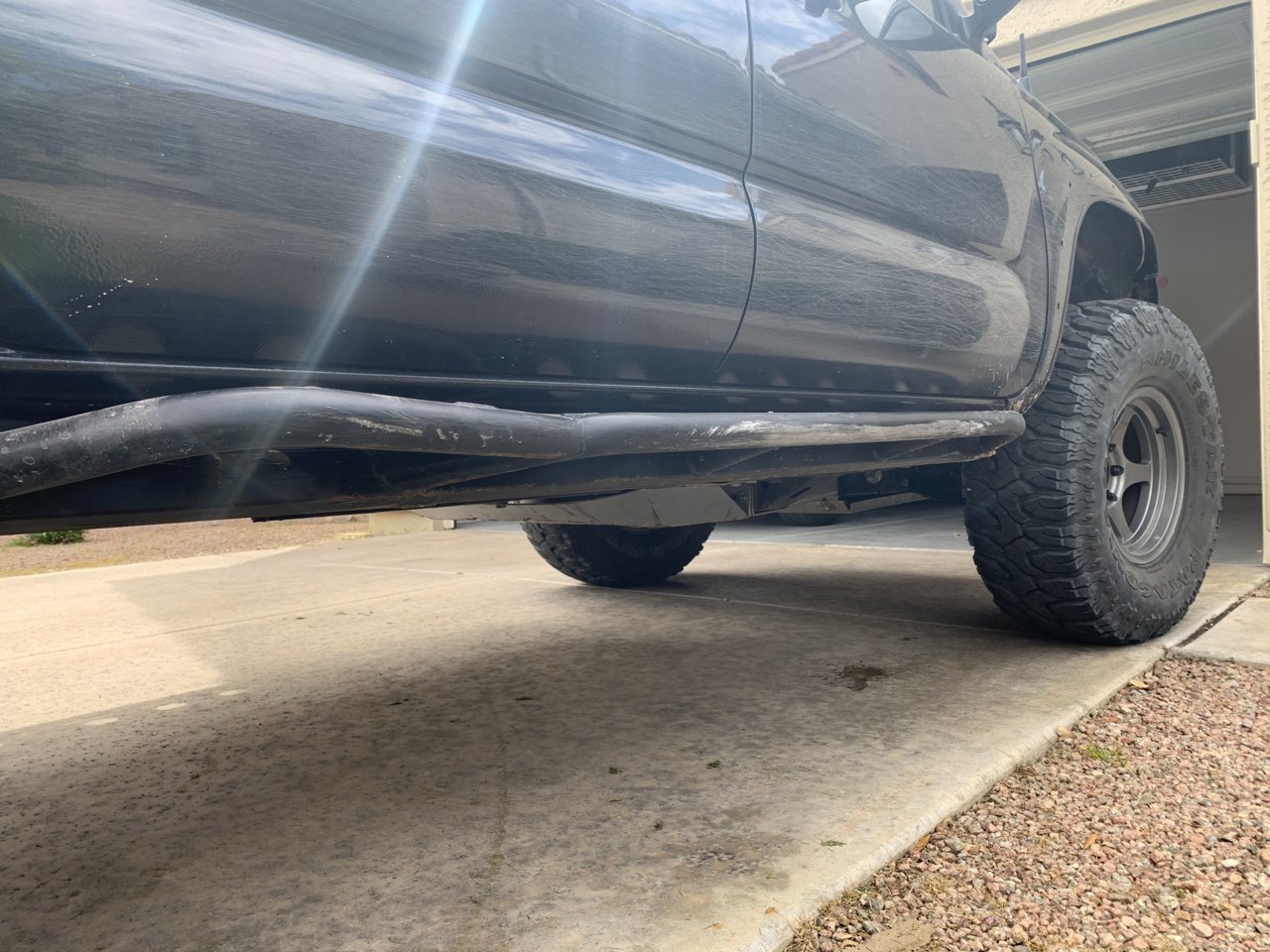

    I keep waiting for my @SOS CONCEPTS sliders to run out of steel.

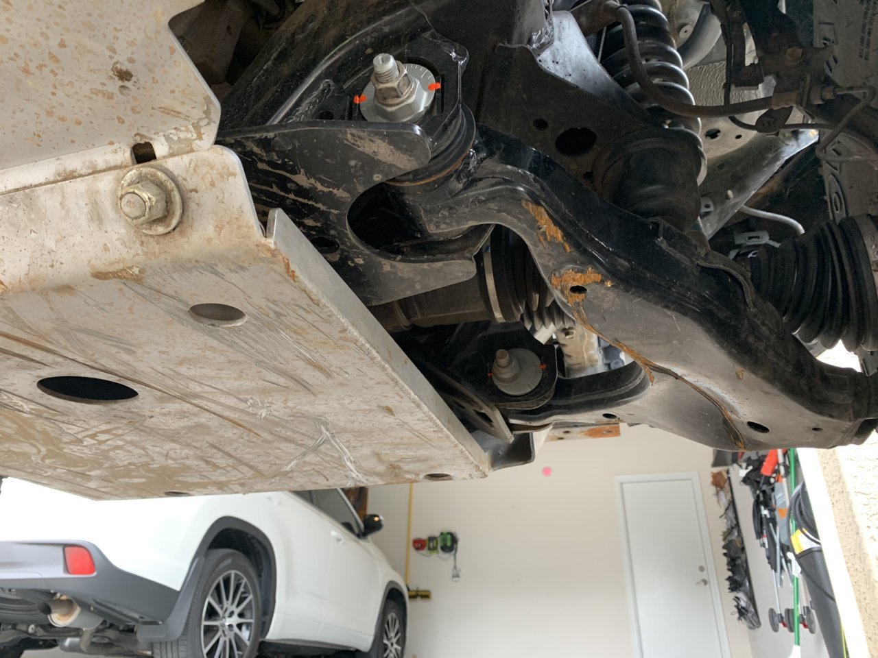

    I don’t know whether to be mad or glad at how my MOOG LCA took this hit. Alignment is still perfect. Probably thanks to the @Marlin Crawler LCA brace kit

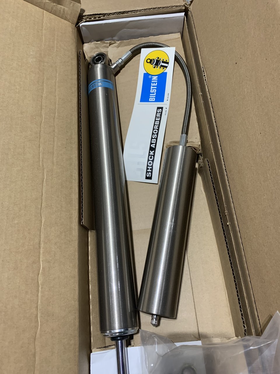

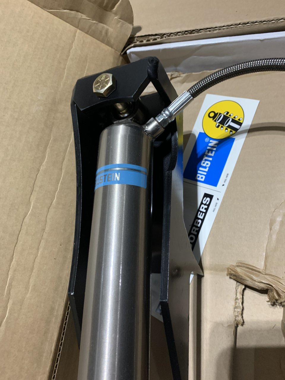

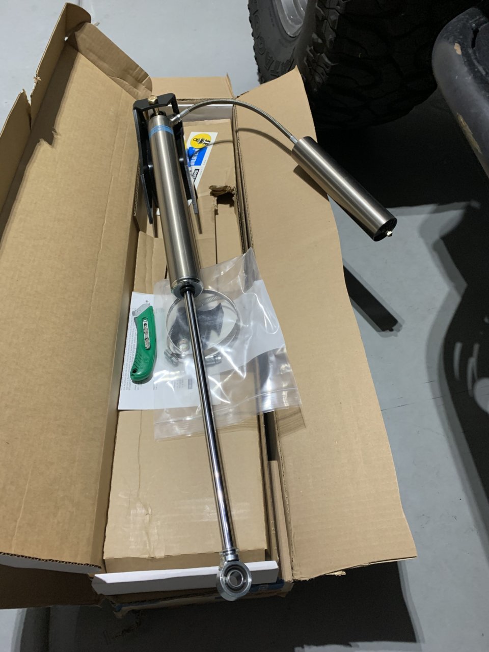

    I spent the first hour of my morning reading this thread. Tons of good stuff going on here. I'm curious, what made you go with the longer Bilstein shocks for your relocate instead of going kings like you originally thought?
  12. Mar 28, 2020 at 1:57 PM
    #192
    singletrack_ftw
    singletrack_ftw [OP] “I chopped the wrong leaf!”
    Aug 27, 2017
    #228223
    3,685
    Tyler
    AZ
    ‘08 TRD OR 4wd
    https://www.tacomaworld.com/threads/singletrack’s-‘dad-shred-build-thread’-i’m-just-doing-it-for-the-kids.619250/ Sos offroad sliders (kickout + filler) Sos offroad full belly skids (steel) Sos offroad front recovery point Sos offroad concepts HC rear bumper with bedside kickout tubes Marlin Crawler LCA frame brace kit Trail Gear rear diff cover Bilstein 5100 + OME 885 Total Chaos UCA BILSTEIN b110 OME Dakar standard pack Wheelers Ubolt flip kit Wheelers Superbump f/r Wheelers SS extended brake lines FN five star 16x8 -25 Milestar Patagonia MT 315/75r16 Custom projector retrofit (acme super h1 + morimoto 4300k) Baja Designs S2 sport ditch pods on CBI ditch pod mounts Amazon AMAK rock lights CMC CB radio hardmount
    The 14” short body bilsteins cost me $368 shipped to my door & they are 4” longer than 12” kings with no relative downside to being a “14” short body” other than maybe some loss of up travel. So basically, the Bilsteins are half the price of the Kings and longer. It was a no brainer for me. Pair the bamf kit with those bilsteins and you’re out the door less than for King smoothies ALONE. The bilsteins are super impressive & 2.0” shocks. They’re sick

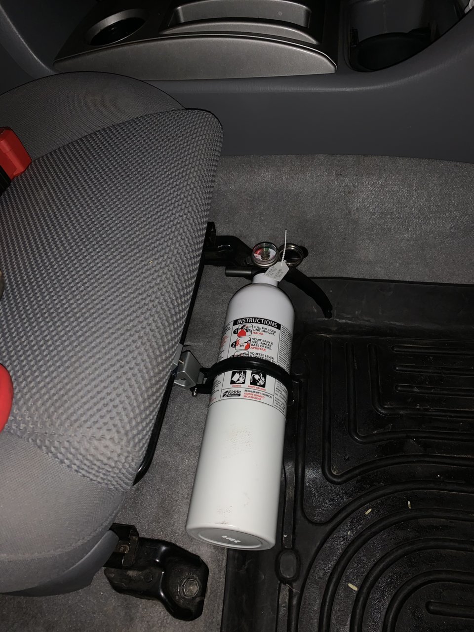

    FINALLY have my extinguisher in a QR mount. YUSSSSS.
