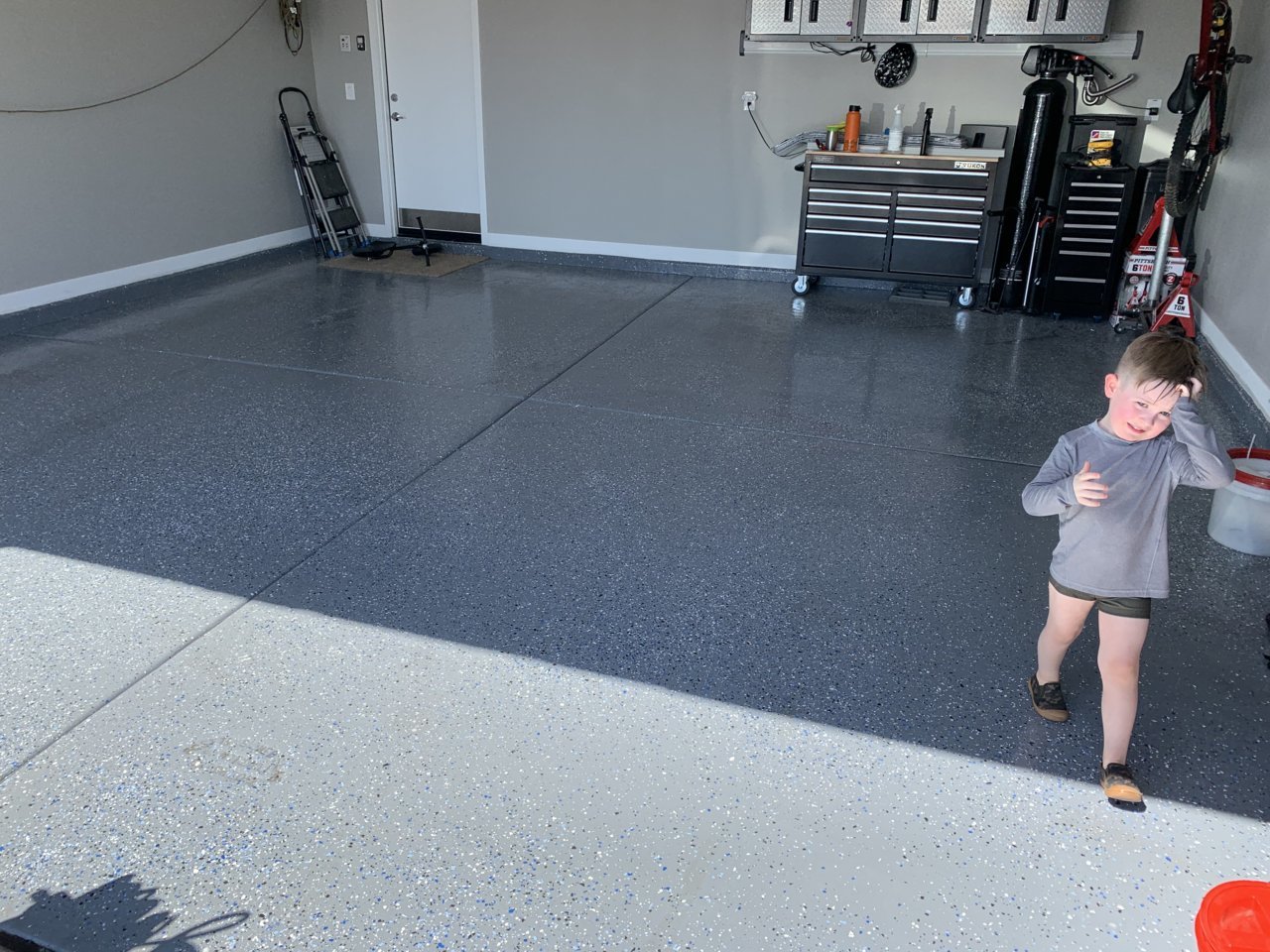

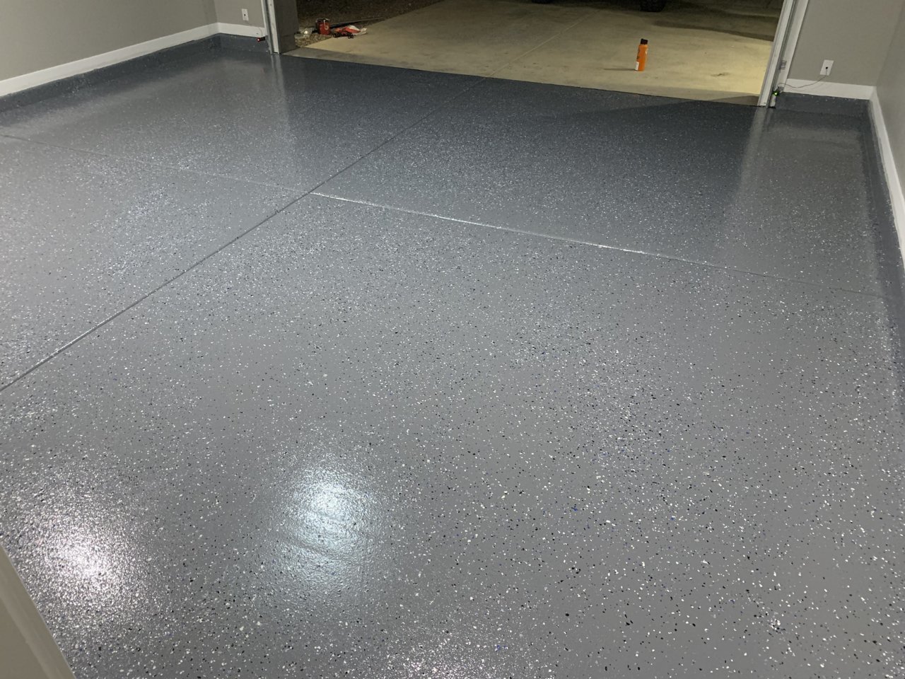

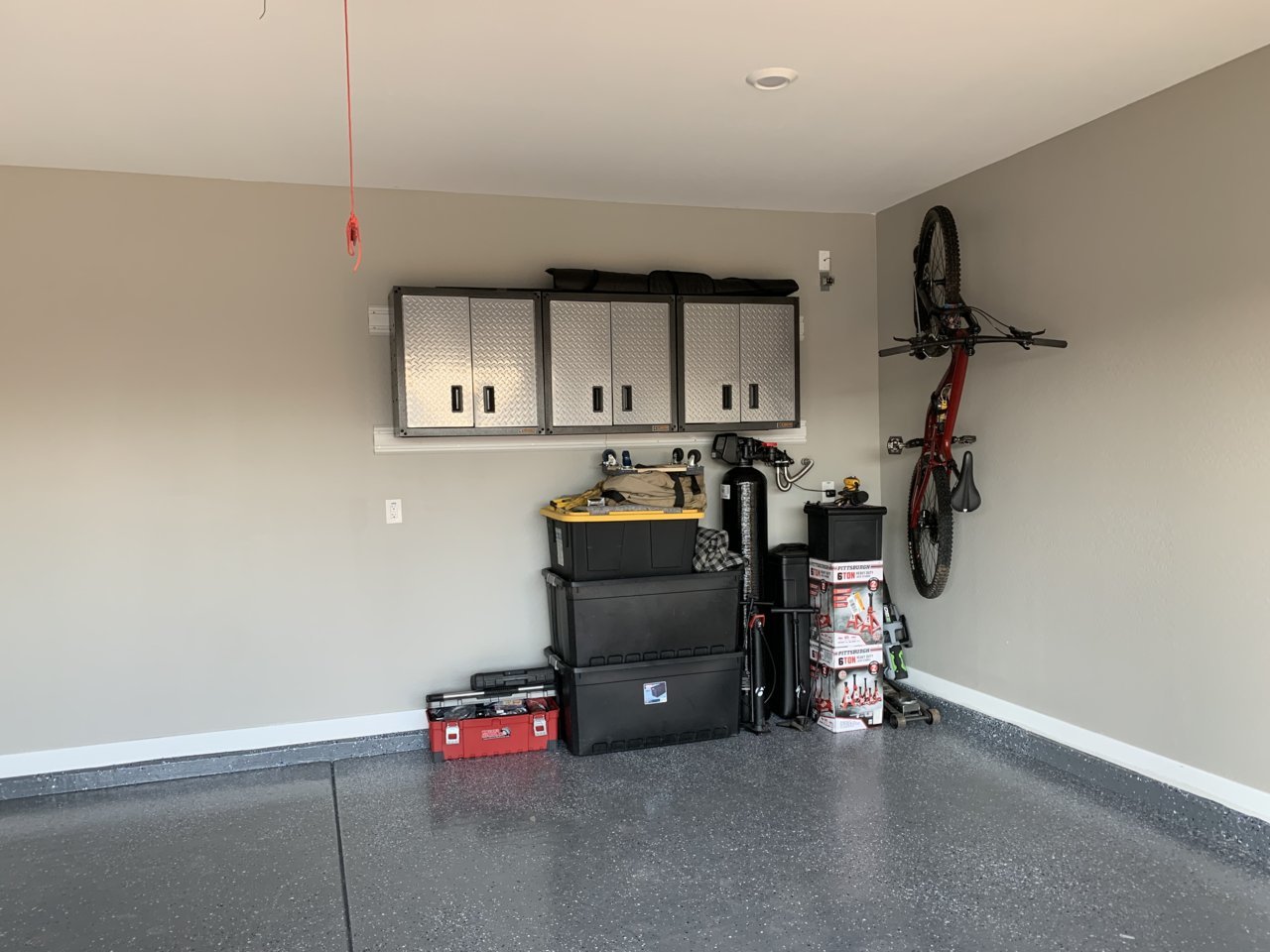

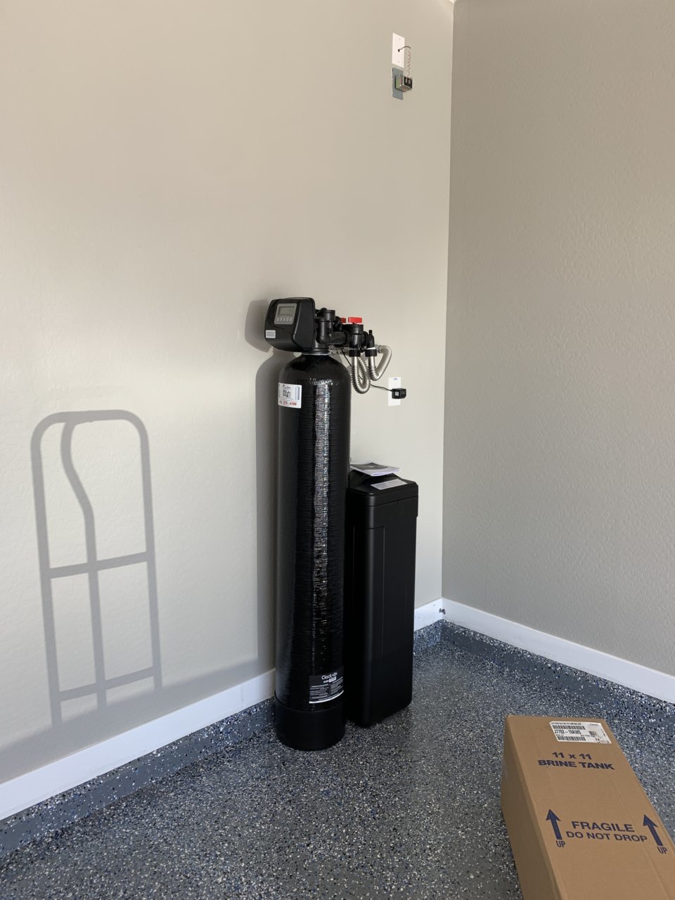

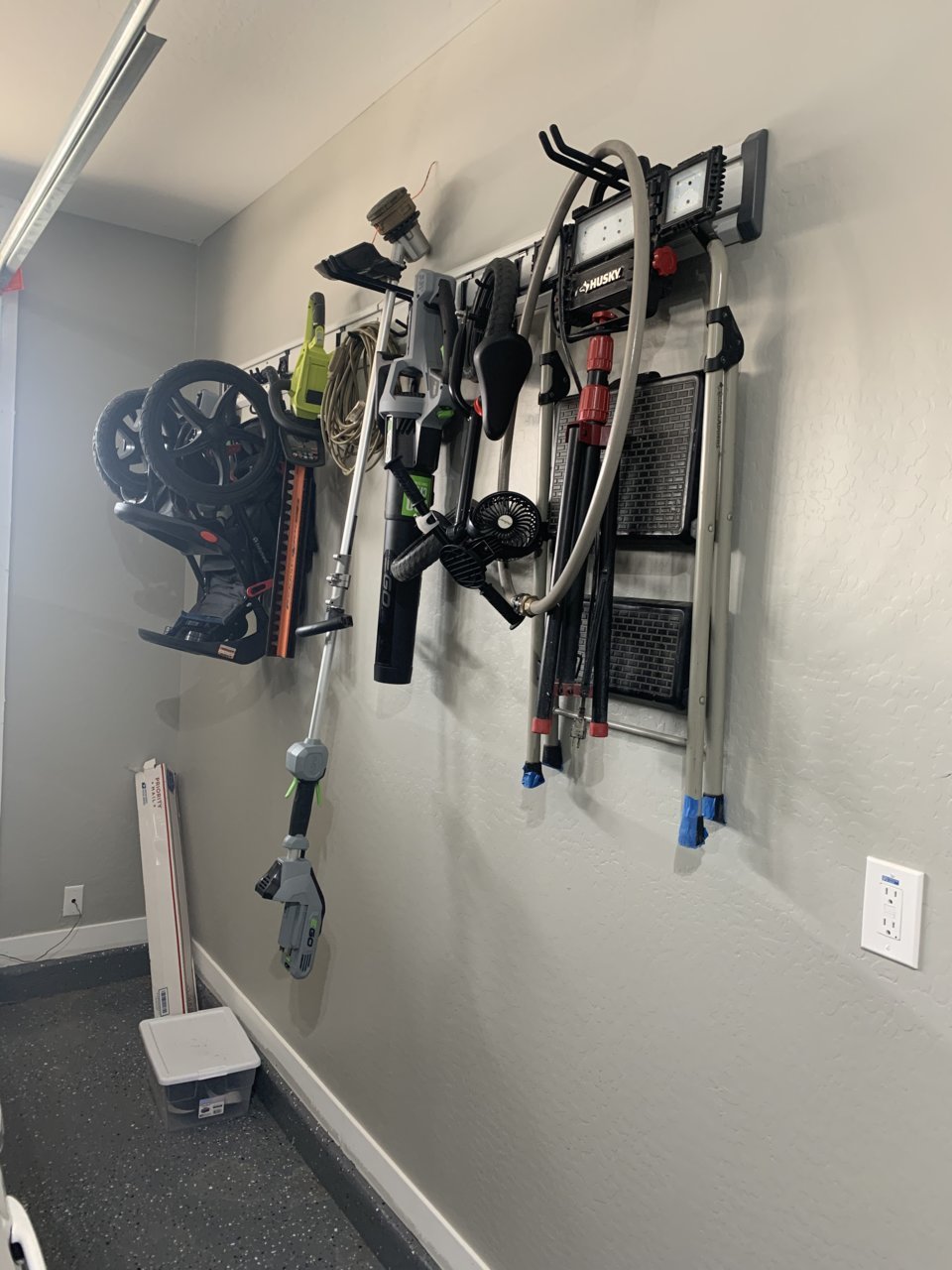

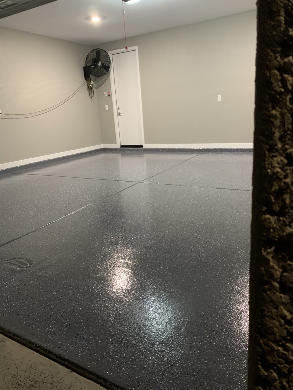

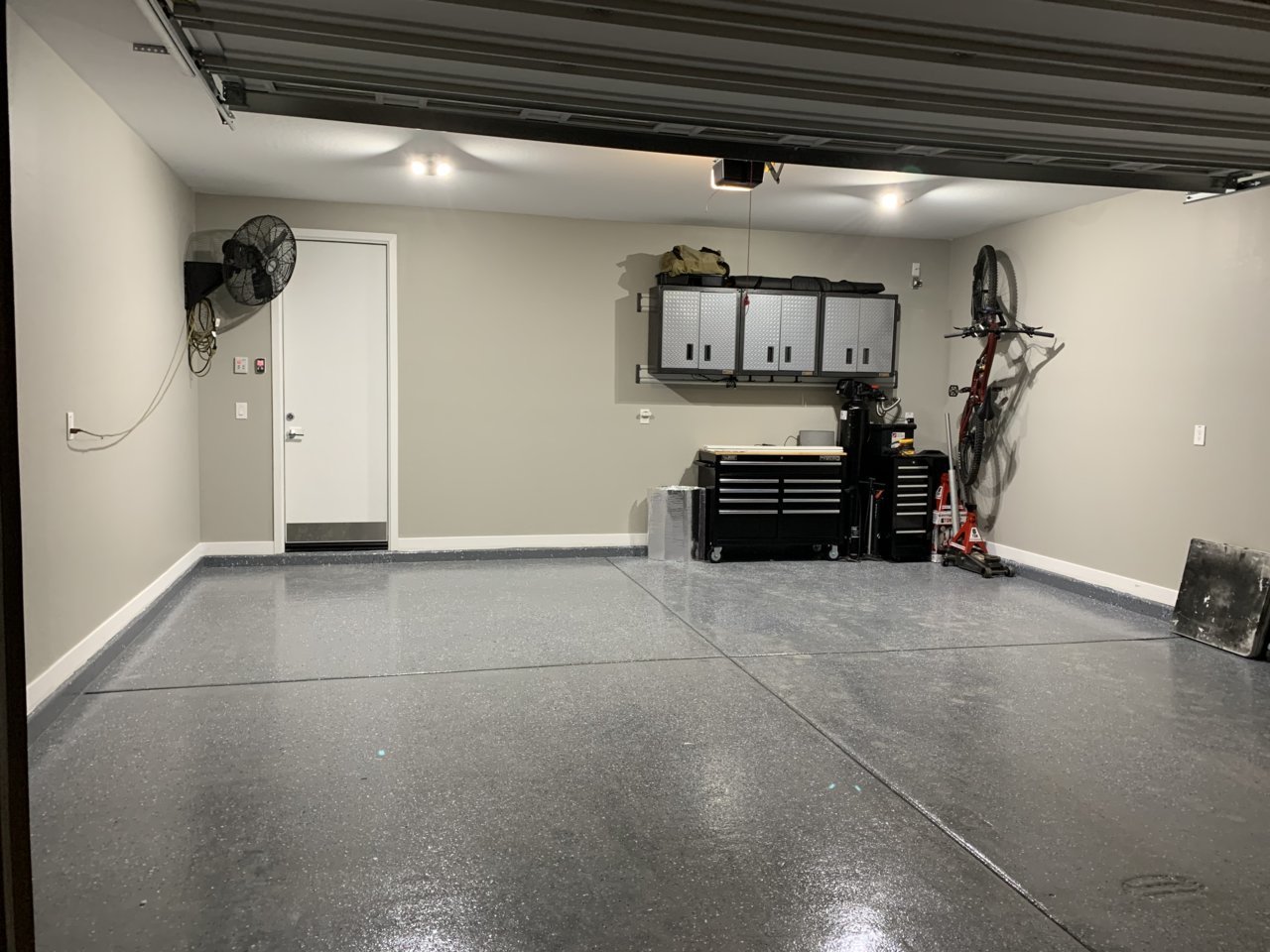

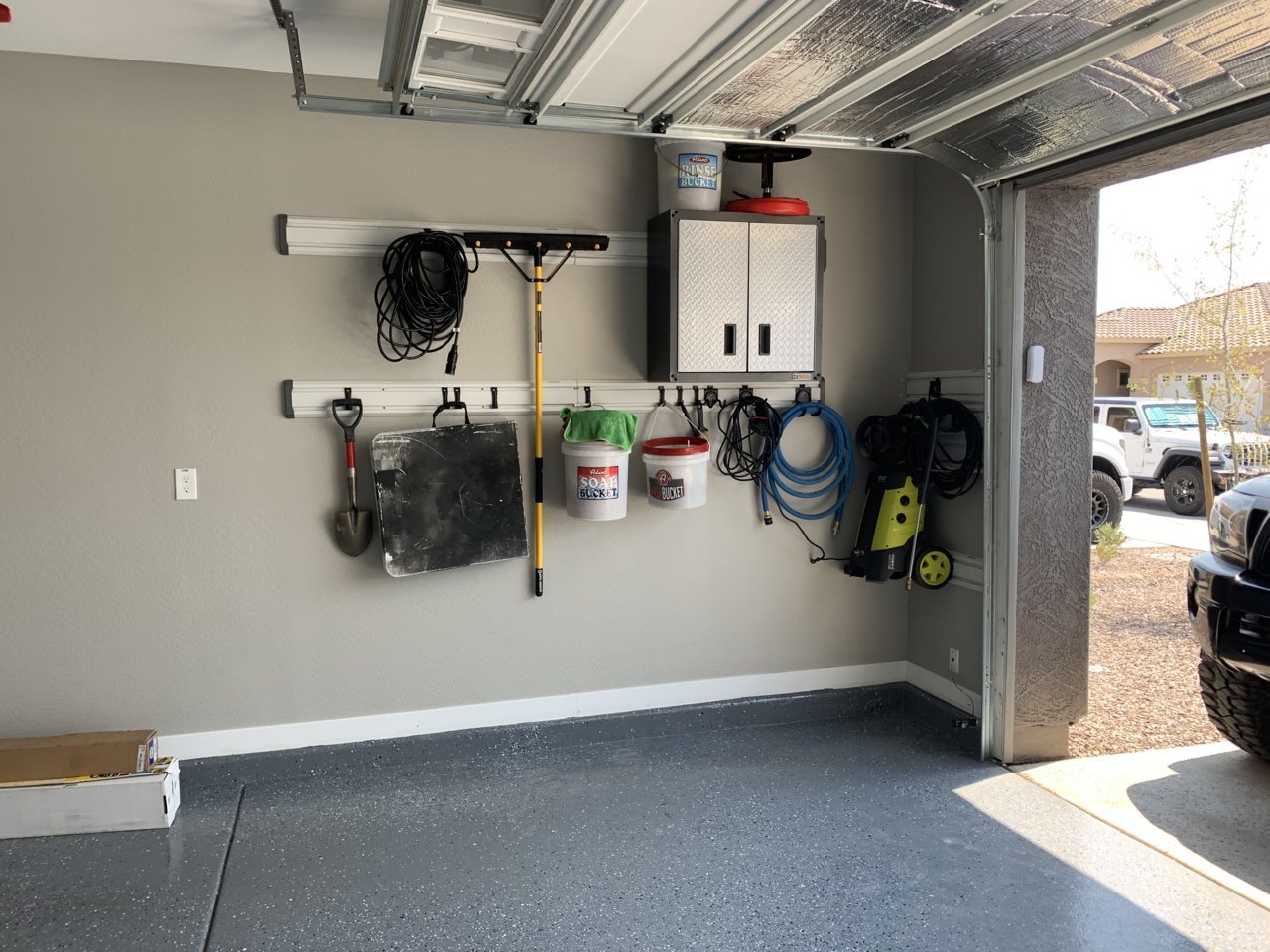

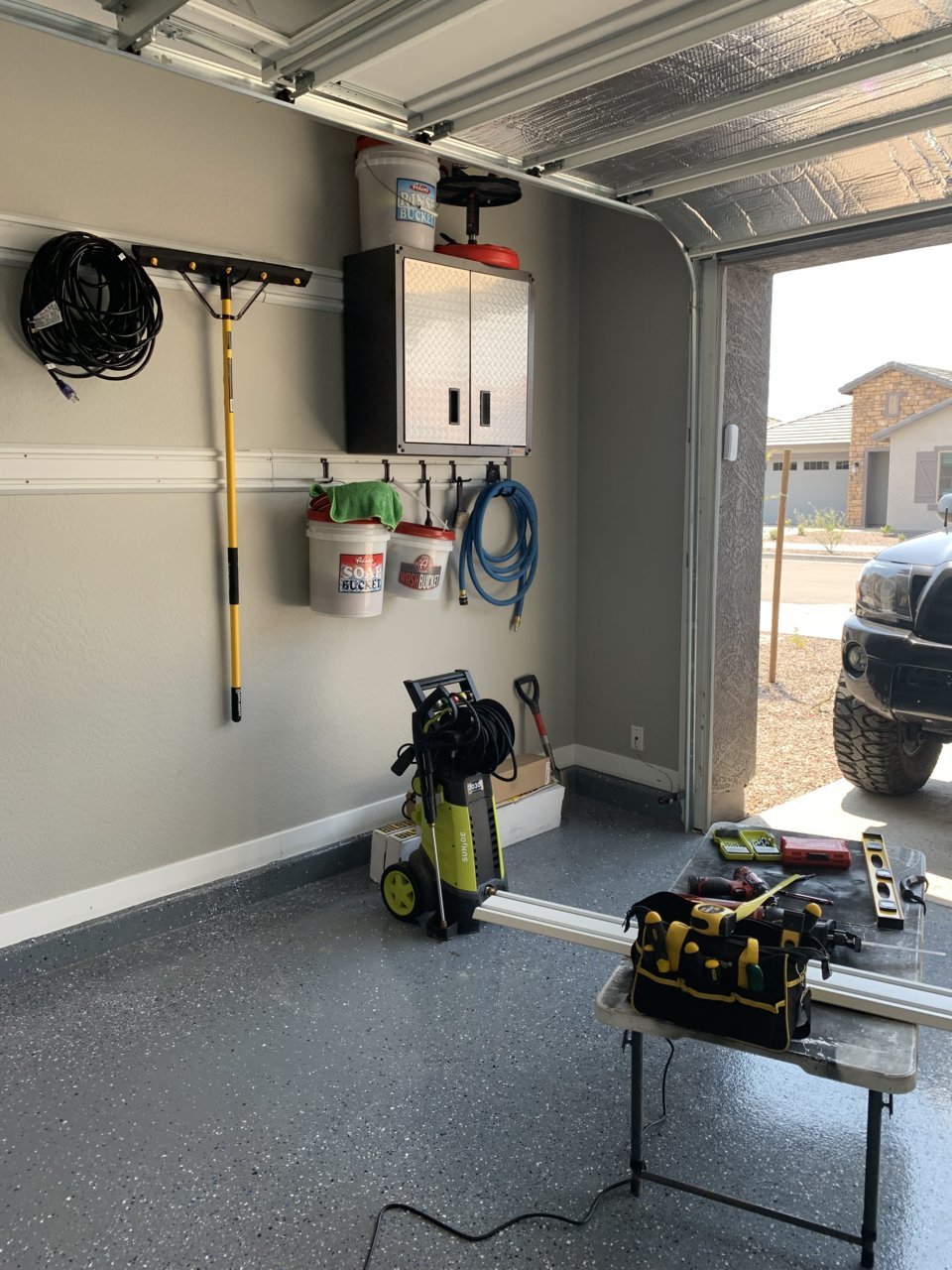

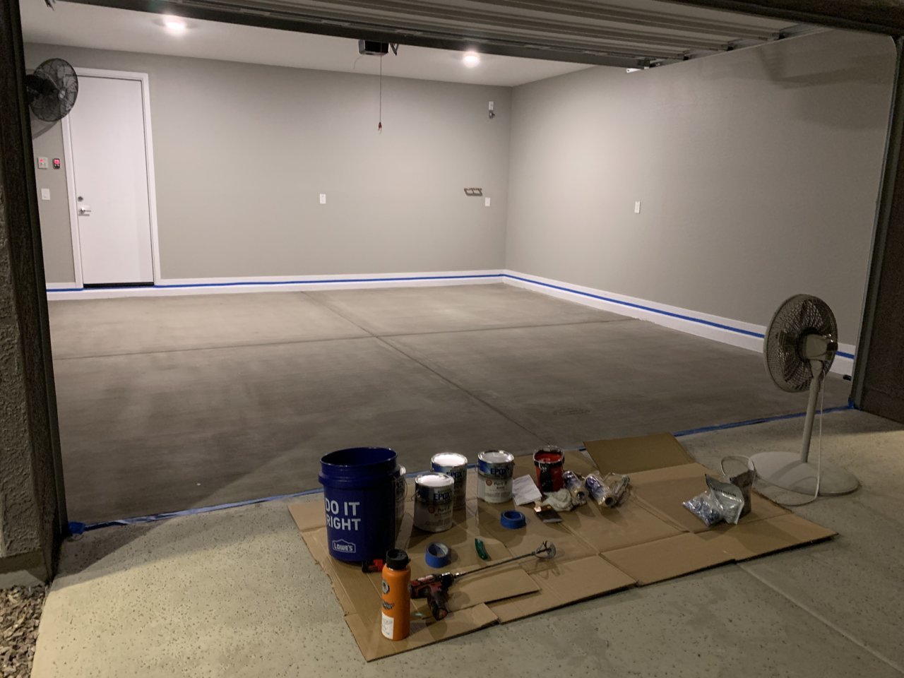

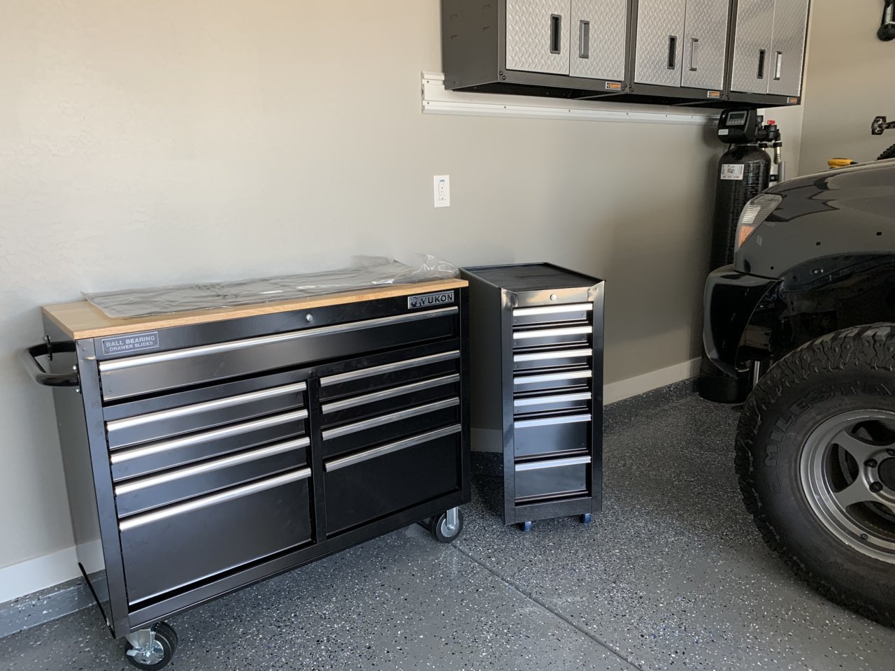

    22x22 2 car garage with 8ft garage door. That’s all I’m working with here. Came standard with 2 recessed cans lights which are integrated LED.

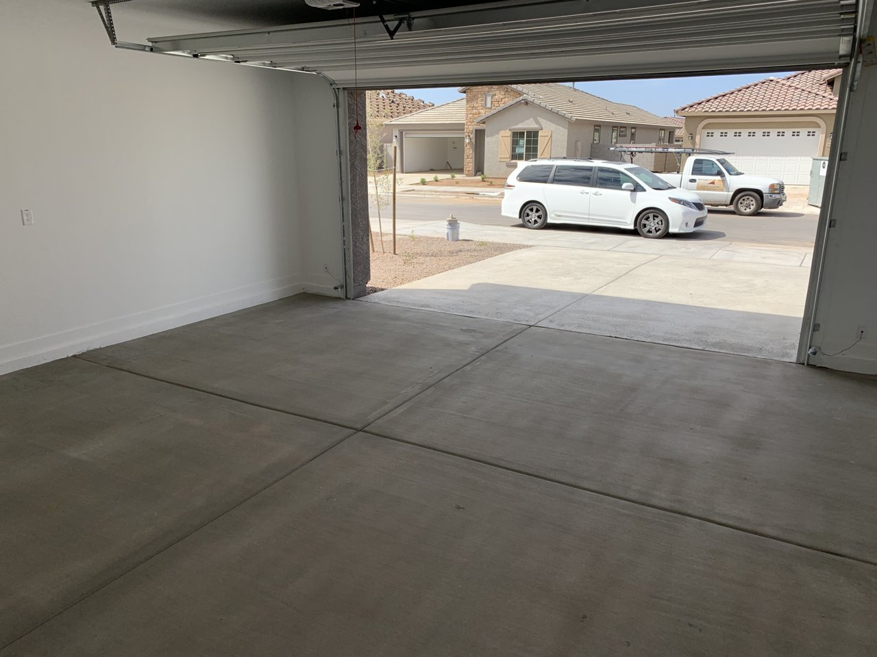

    Here are the transition pics. From zero to hero. All done DIY for cheap
    sherwin Williams mindful gray paint on the walls
    Rust-Oleum professional grade epoxy floor (I did dark gray and bought $50 worth of extra chips and then did a nice thick clear coat on top). Also painted the stem walls around the perimeter.
    air king 99539 oscillating 5000cfm fab (only 69 decibels). Industrial heavy duty fan. 24” model
    steadyrack swivel bike mount
    gladiator gear tracks throughout & gladiator steel cabinets
    harbor freight 46” 9 drawer wood top work bench
    harbor freight US General end cabinet (I added castors to it to get it off the ground
    Salt based water softener
    SS house door entry kick plate
    Swapped out integrated LED overheads to cheap $30 Amazon fanned LED lights 6000lumens each.

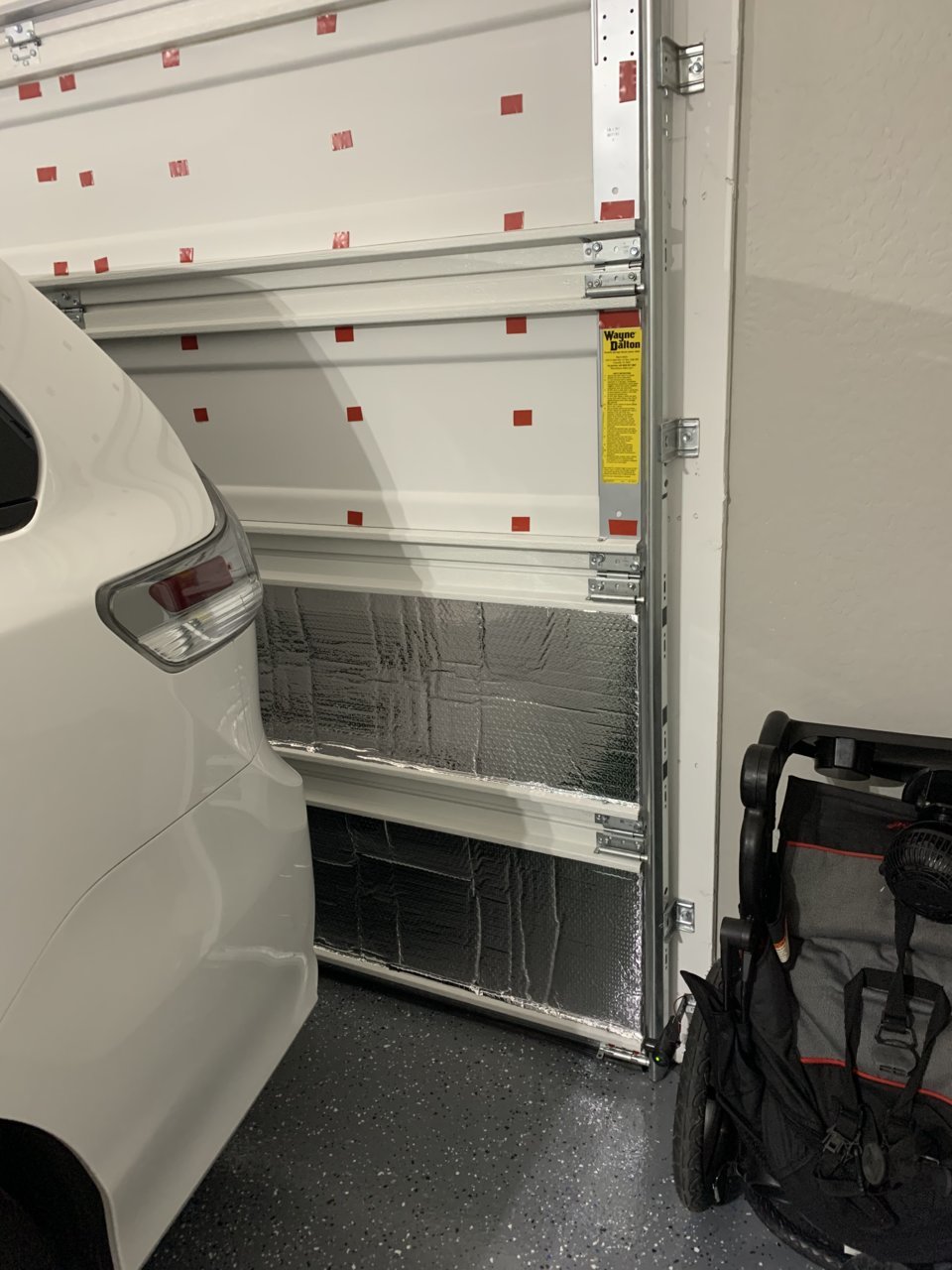

    Right now I’m insulating the garage door.

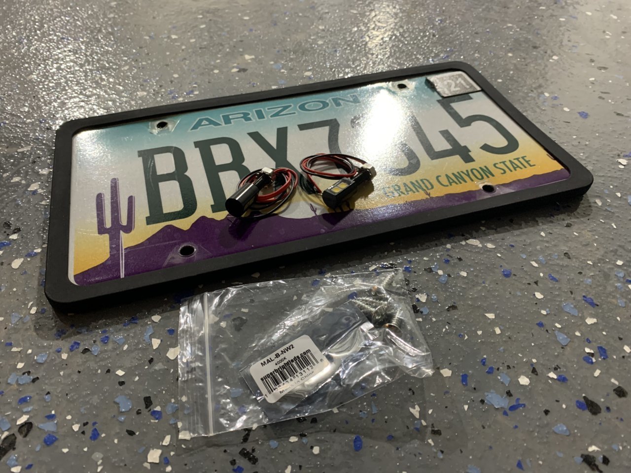

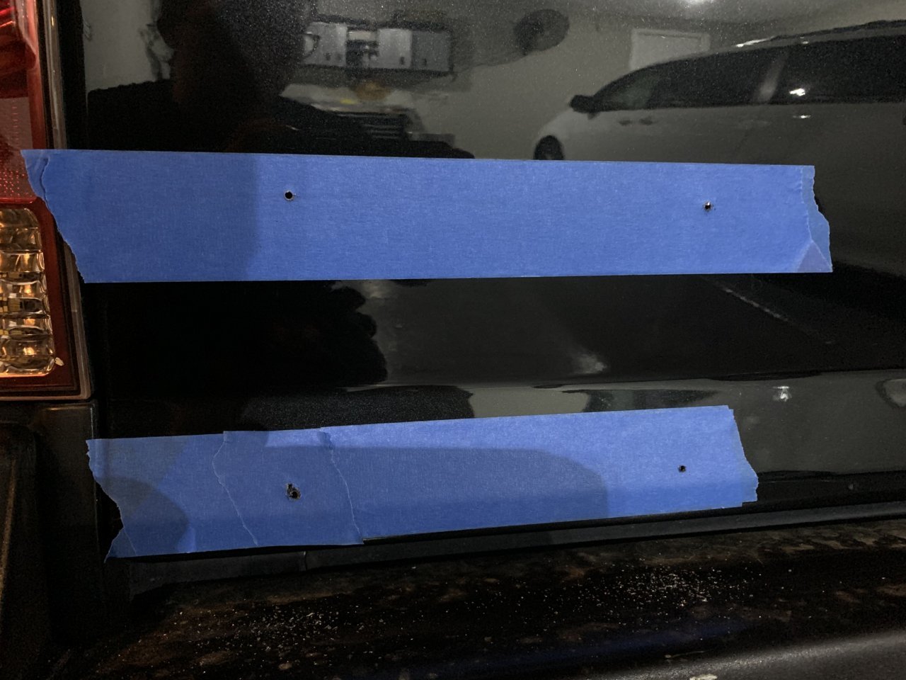

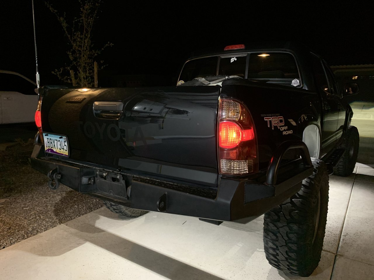

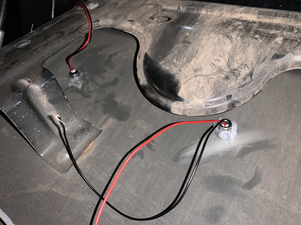

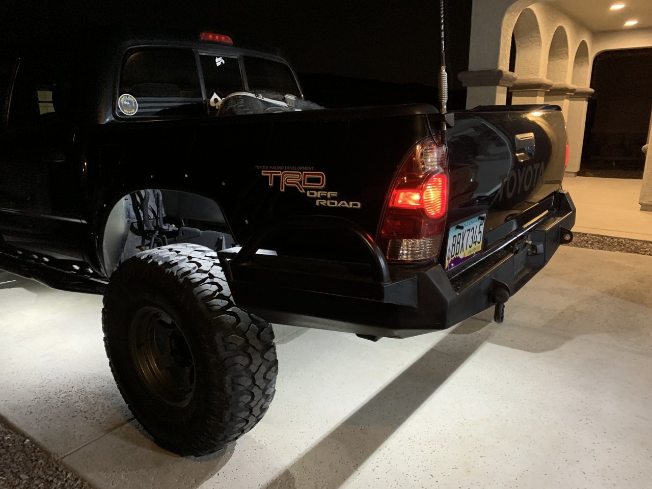

    Rear Bumper is going for sale soon. New bumper will be SO TUCKED - so this is my license plate solution. Many have done this already. I love the look & function.
    - silicone license frame holder
    - LED tag light BOLTS with wiring pigtail
    - drill 4 holes in the tailgate, painted/silicone the holes
    - slap er on.
    thanks @EatSleepTacos for the link to these bad@$$ led Tag light bolts.
    Gonna have my buddy splice the wires into my factory wires. I DONT DO WIRING. Hahaha. Also - Rear bumper for sale

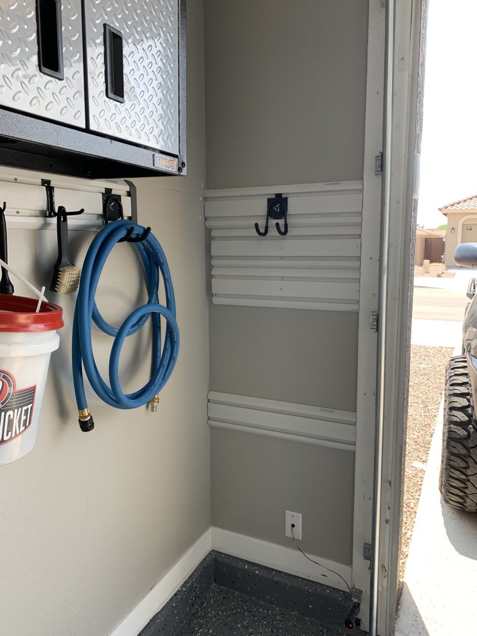

    Dialed in my “detail corner” a little more. Got my pressure washer off the floor & such.

    Tag lights wired’ WE ARE LEGAL! Lol

    Garage looks damn good man! I'd love epoxy, but the effort to scour a painted concrete floor is too much for my blood.

    You only have to scour it as bare concrete to prep the surface. Then after that all you do is rinse it off as needed & squeegee

    Only cost me about $450 in supplies to do my garage floor. Super easy, just takes time

    be sure to buy a resin or epoxy based product (not water based). Be sure to acid etch the floor & let it dry for a few days & be sure to put a resin urethane clear coat on within 4 days of the epoxy

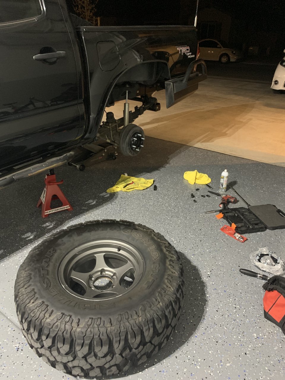

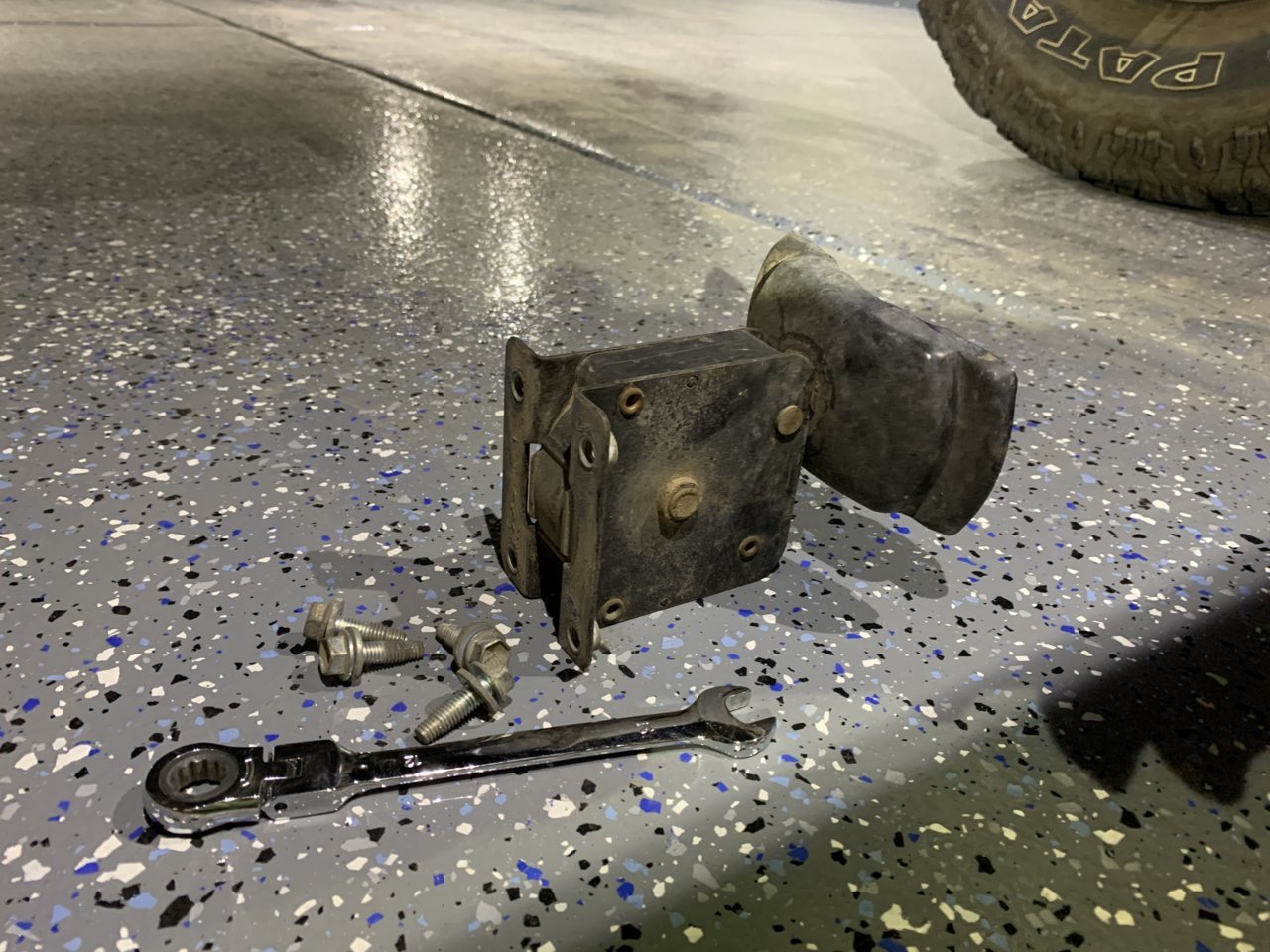

    Bora .75” spacers for shock relocation next week. Did some light sanding / wire brush on the drum and backside of wheel surface - Torqued to spec Drove 10 miles. Re checked torque spec & witness marked. Gtg.
