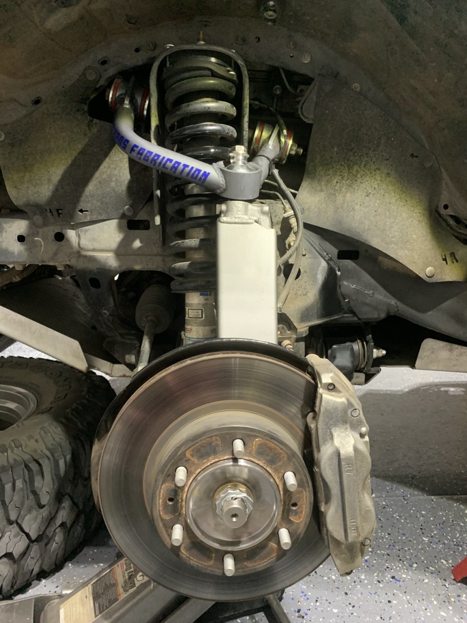

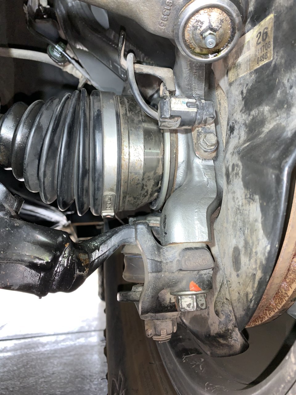

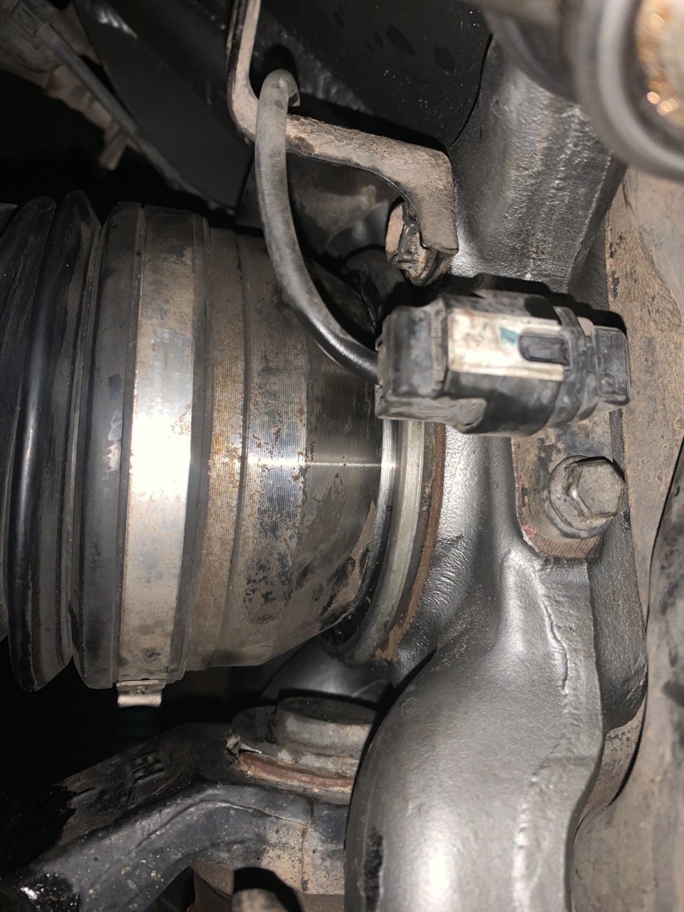

    :mad: Did all this work & the axle isn’t seated fully. Need to fix that tomorrow.
    Fixed it today.

    Got the other side done. Test drive - truck feels & sounds really great, smoother & quieter than before.

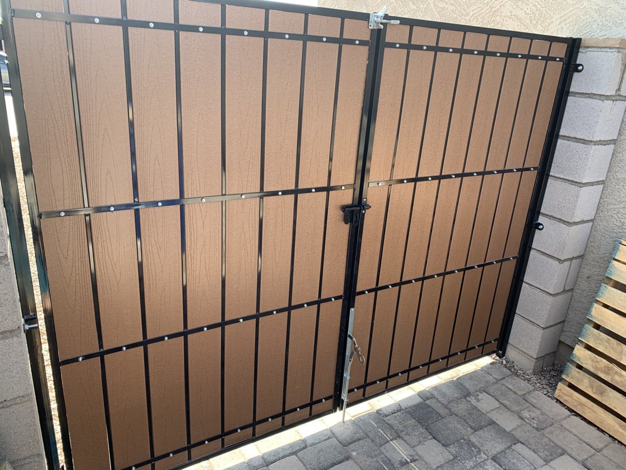

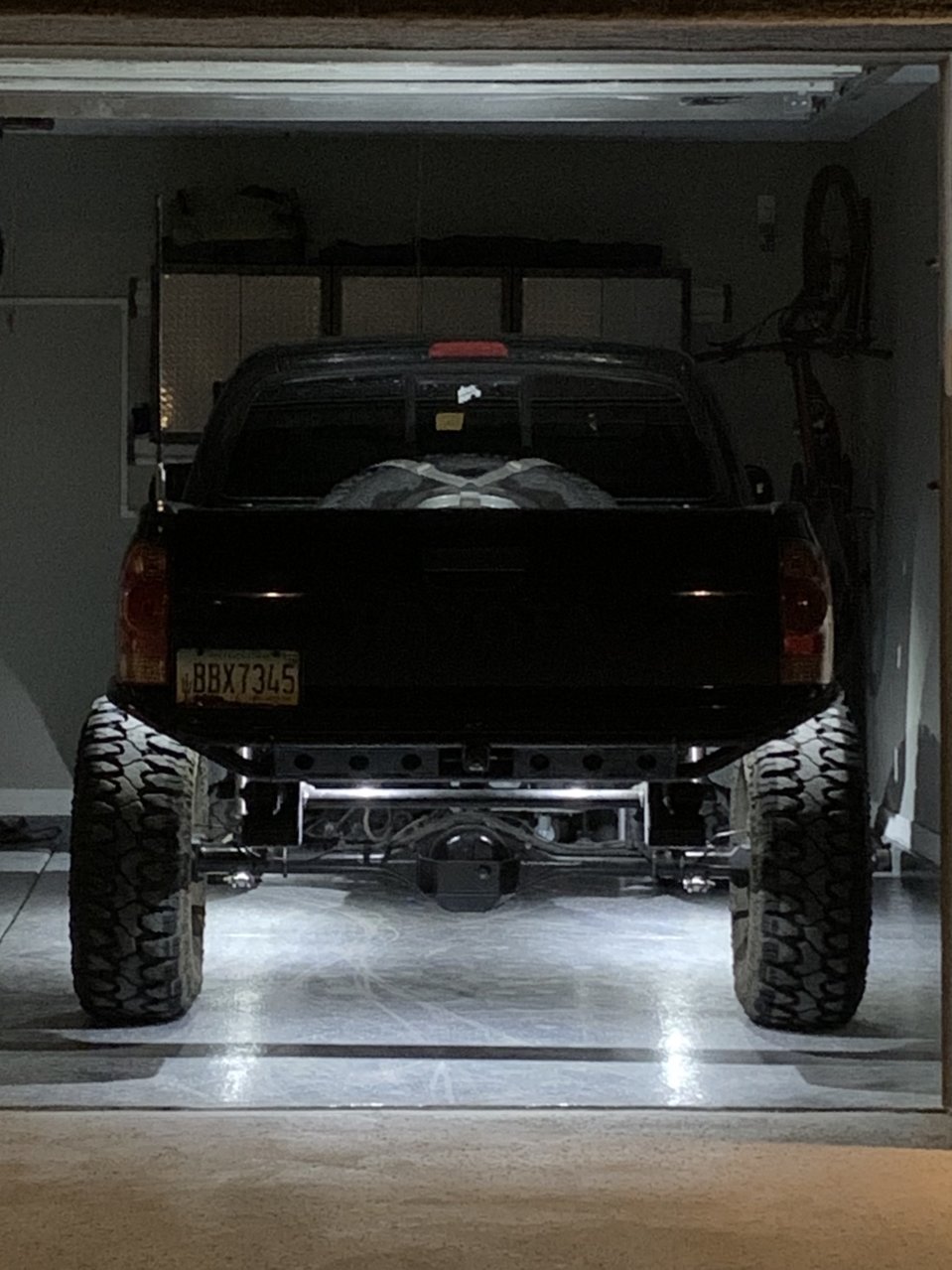

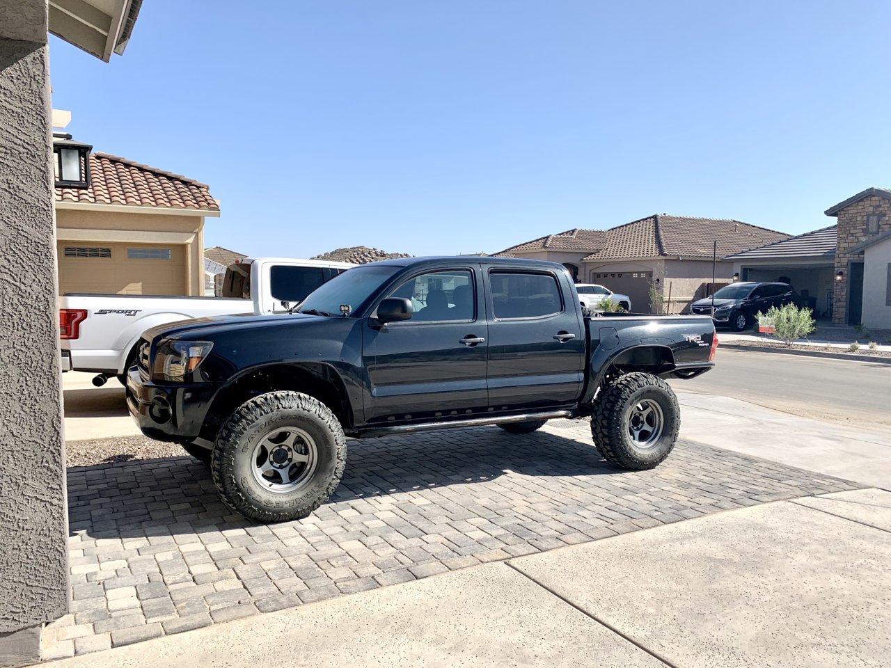

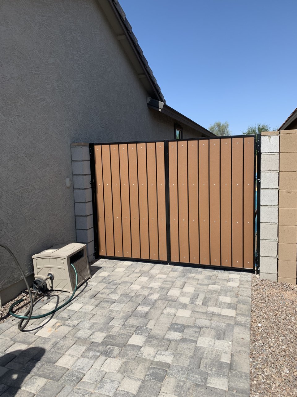

    IVE WANTED A LARGE DRIVEWAY EXTENSION MY ENTIRE LIFE AND NOW I HAVE ONE GUYS IM SO THANKFUL!!!! It’s so nice to have people over and they can park here or I can shuffle cars to this spot while I work in the garage or driveway. Double gate is going in where you see the pallets, so I can even park a vehicle on the side yard behind the gate if needed.
  5. Sep 26, 2020 at 4:43 PM
    #285
    fasteddieyj
    fasteddieyj Well-Known Member
    Nov 25, 2018
    #273740
    859
    Ed
    Hanover, PA
    2015 camping/mild wheeling rig. 2014 DD
    Fancy.

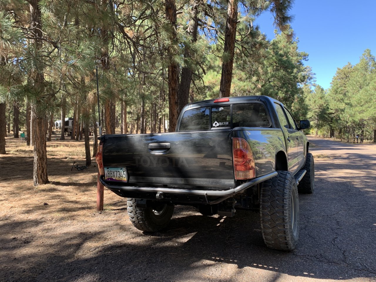

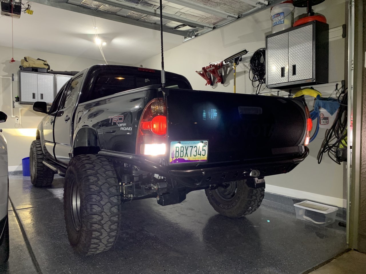

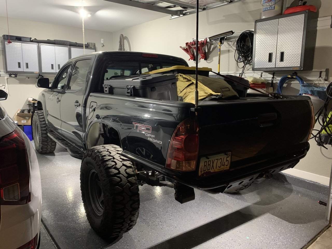

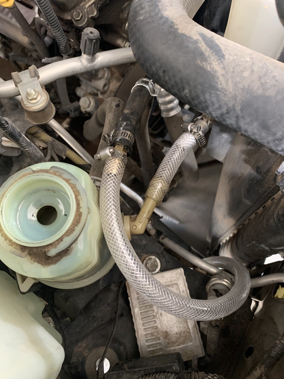

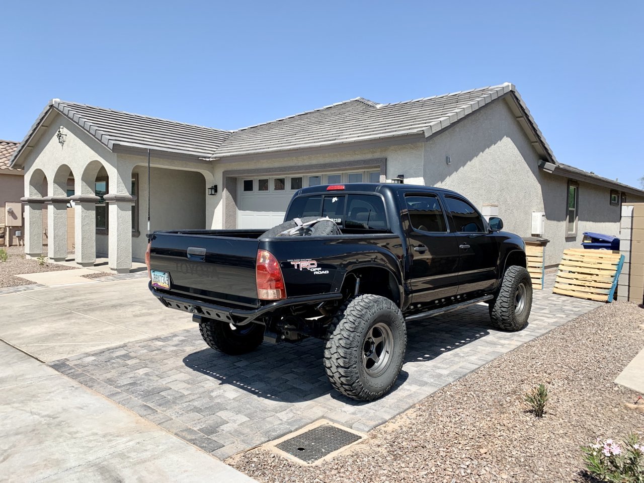

    Relocated my backup camera. The new bumper build meant it needed to be moved. This’ll do for now. Will see dirt very soon.

    Side parking and trailer storage is the greatest!

    They just finished the double gate!!!!!! Ahhhhh I can’t believe I have one of these

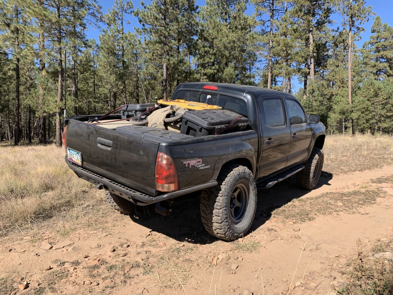

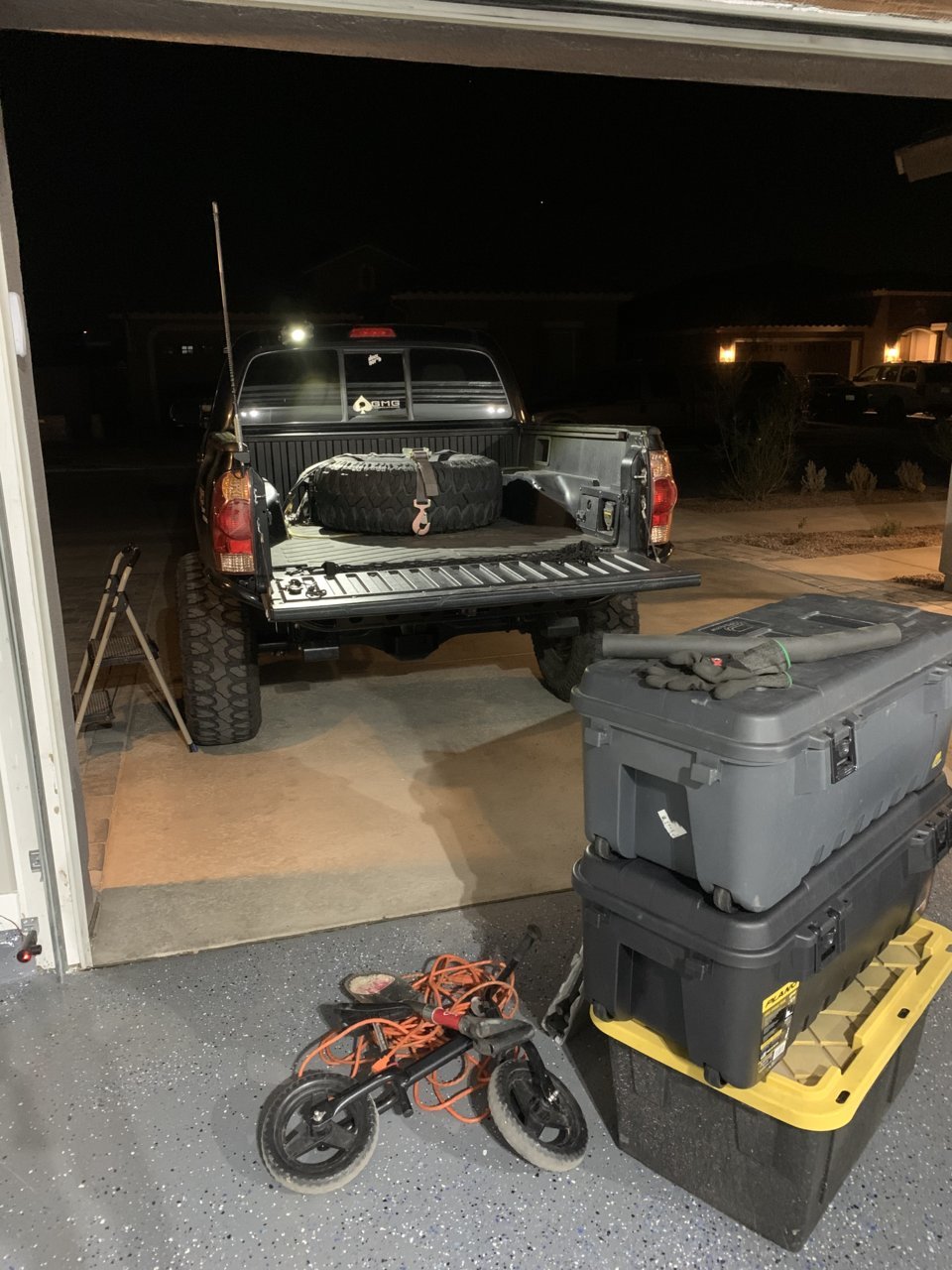

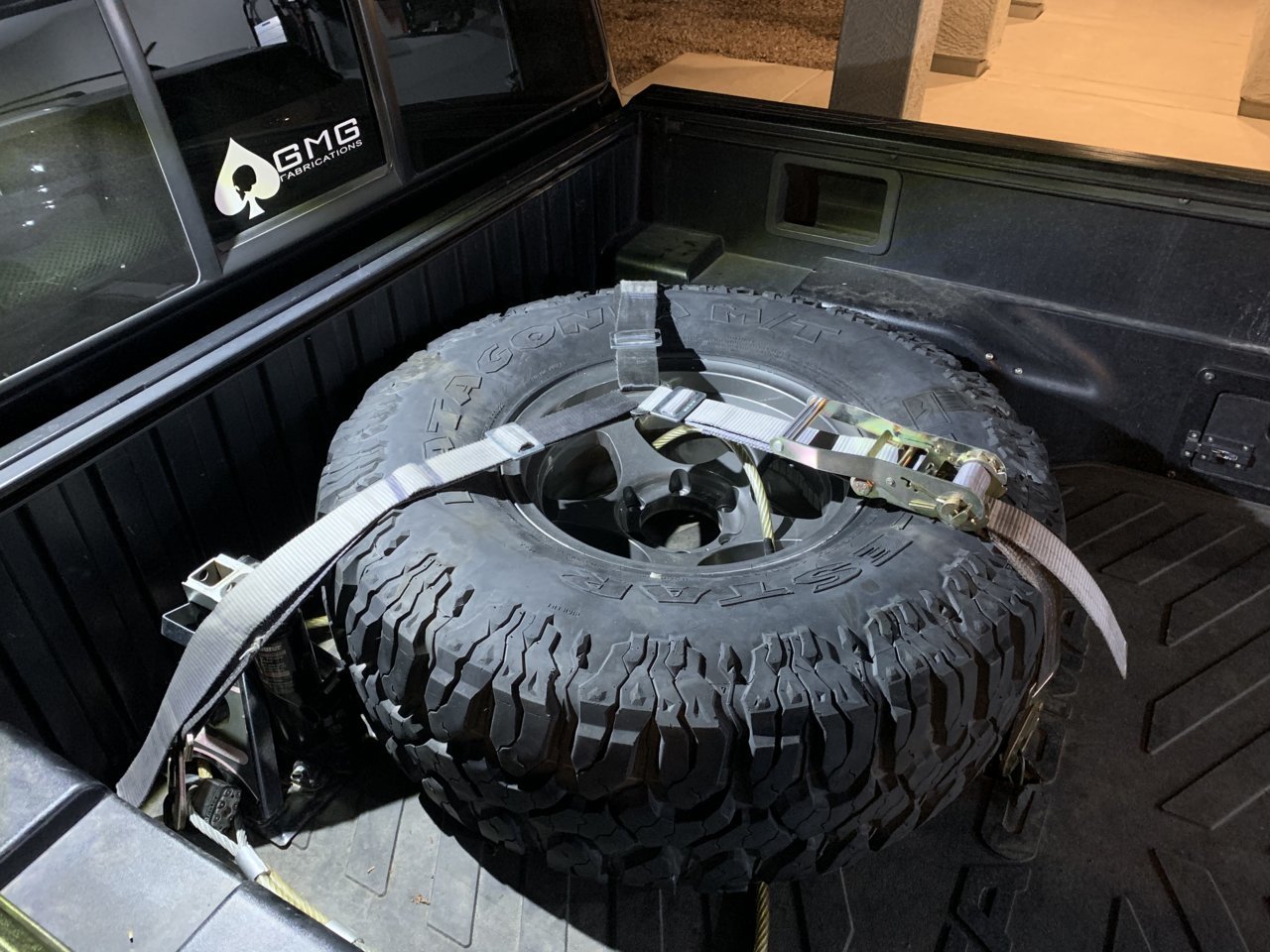

    Still love my full sized spare / HD bottle jack in the bed setup but I have decided to lay the spare flat instead of angled on top of the jack because it’s just a nightmare trying to throw some camping totes in the bed working around a big angled spare tire. With it flat - I have no problems stacking stuff on top of it. I moved the bottle jack next to the spare & it is locked in with the HD cable lock. This setup is even simpler and cleaner than before. Will keep it like this from now on. All loaded up for camping trip this weekend.

    That's what I found too when I went camping with bobbed bed + angled spare. Just not a lot of useable bed space like that, unfortunately.

    The new bumper is sick looking.:thumbsup:

    Thanks man. I’m in love. It’s so great how great of a job he did. (GMG Fab).

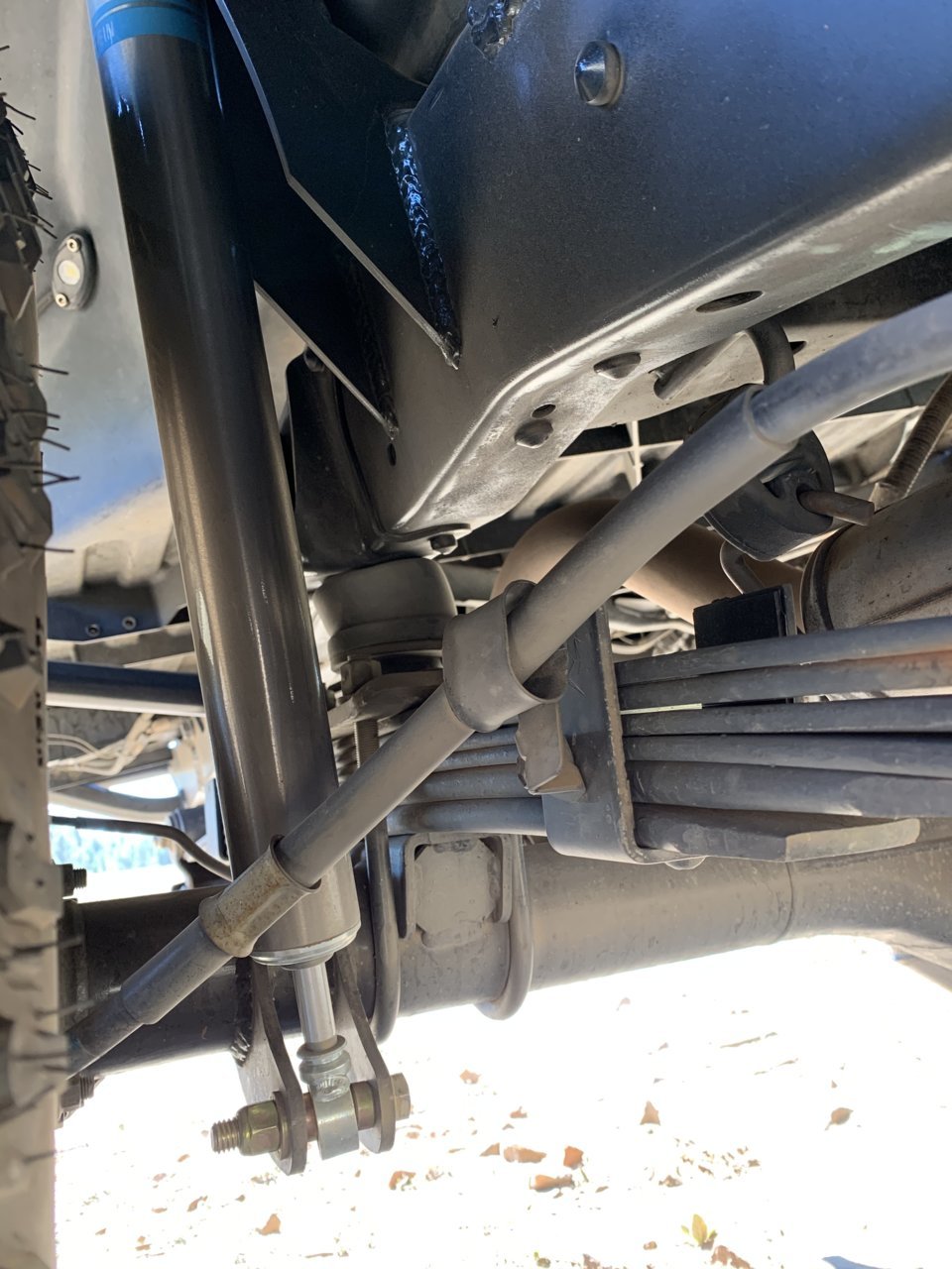

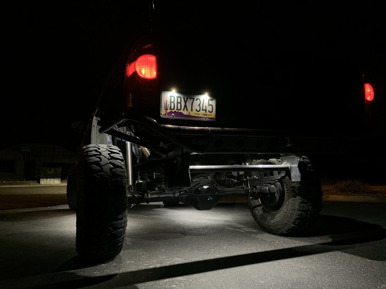

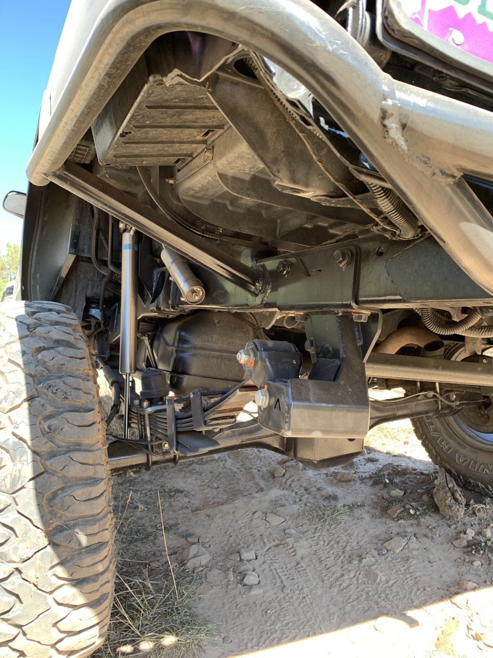

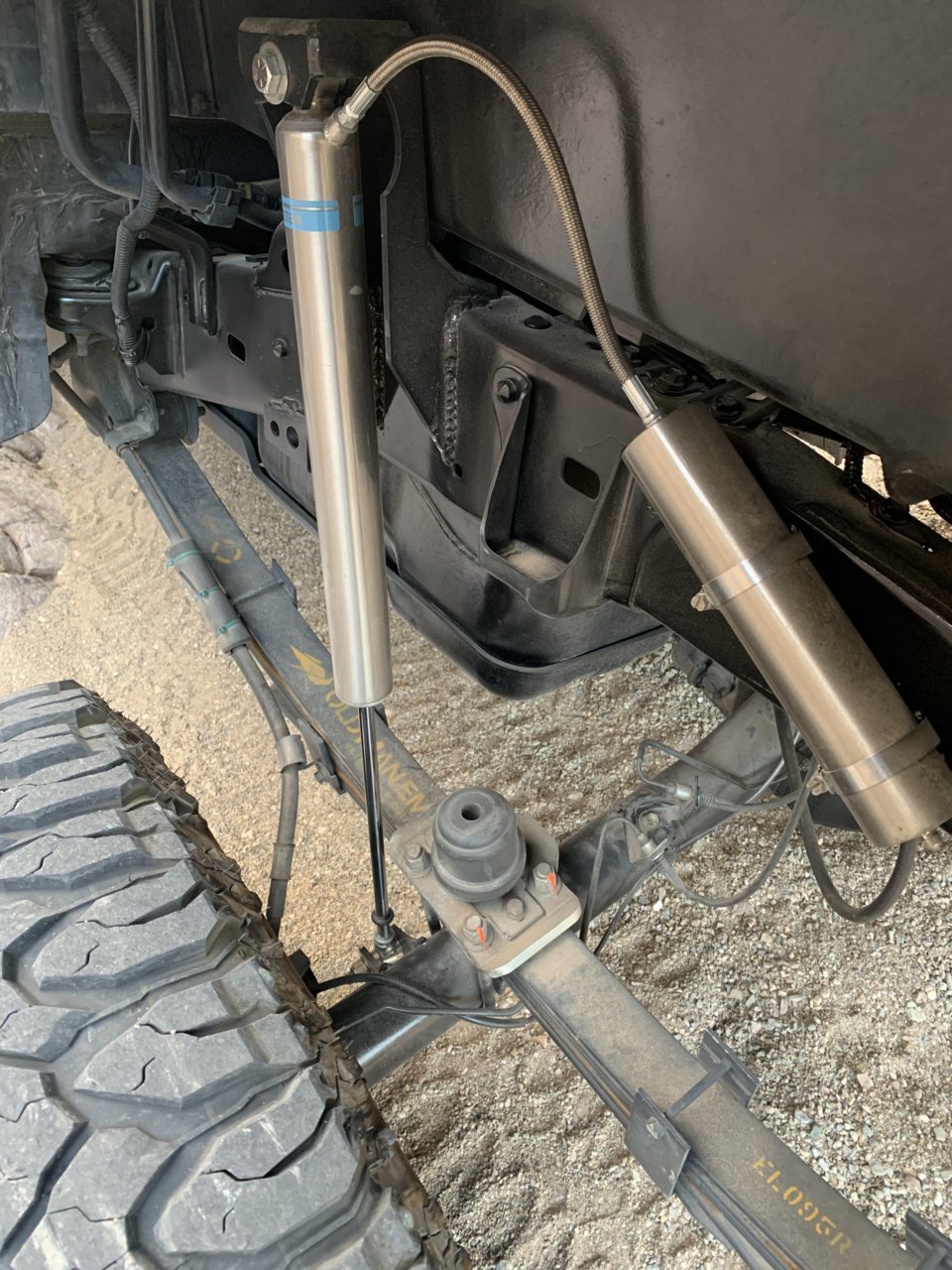

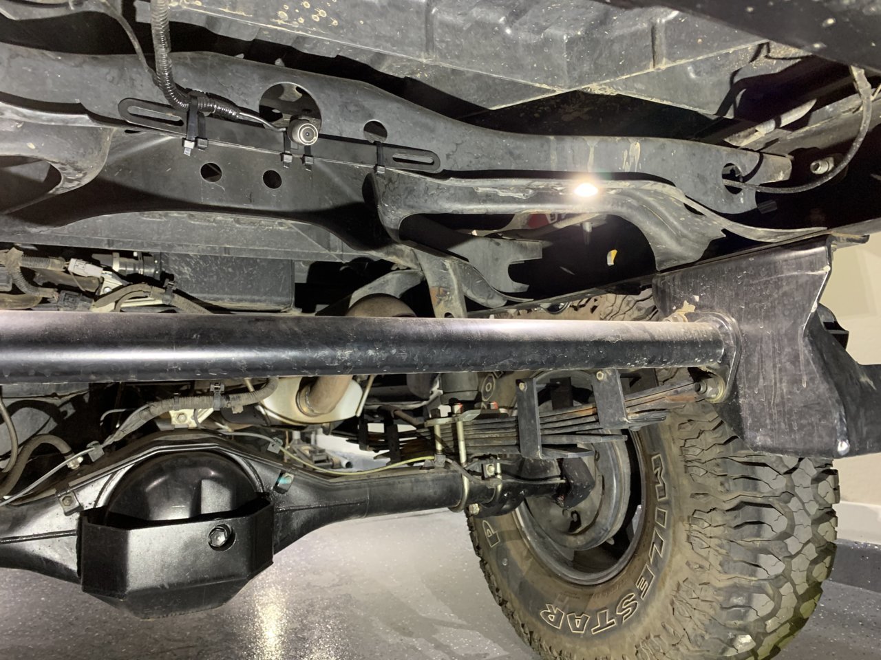

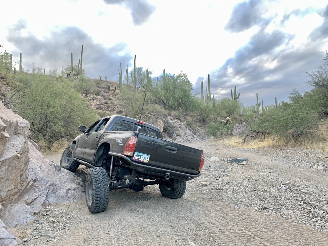

    I wanted to bump the trucks travel to see how everything looked back there with the 7100’s. This was helpful because I know I still have a ton more droop travel on the DS, the shackle wasn’t even fully dropped out. & the PS shock only had a little over 1” left before bottoming out and you can see my superbump spacer is already squished almost to full compression. I had a lot of camping gear in the bed (which I NORMALLY NEVER HAVE). So that adds to it also.

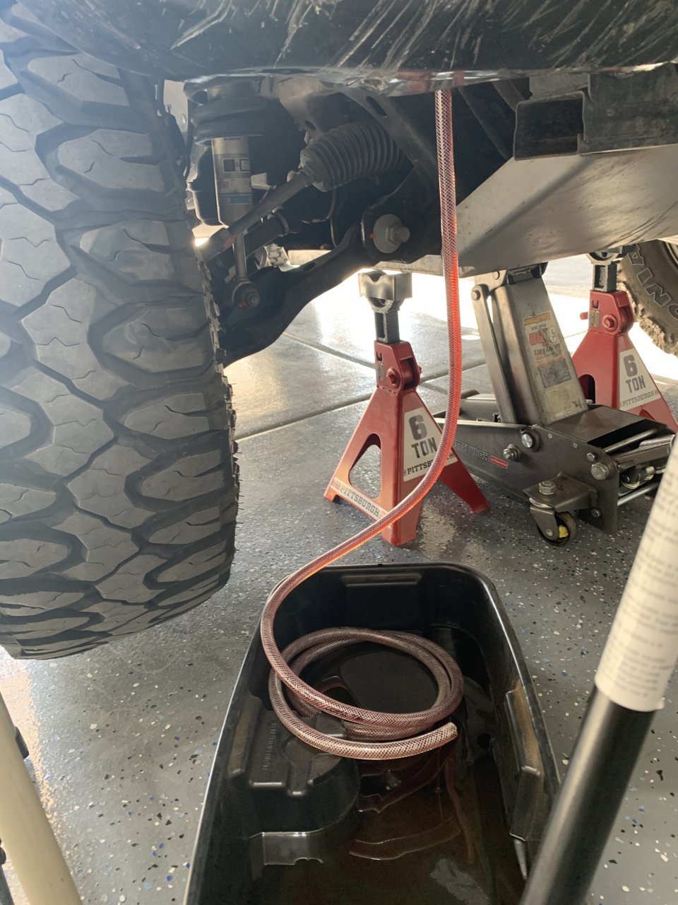

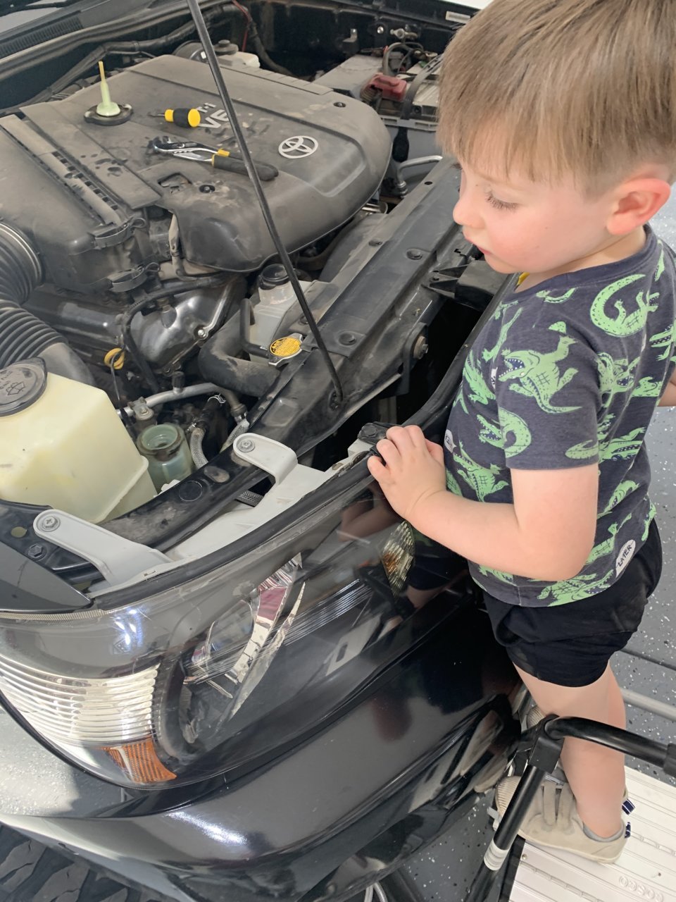

    https://www.tacomaworld.com/threads/singletrack’s-‘dad-shred-build-thread’-i’m-just-doing-it-for-the-kids.619250/ Sos offroad sliders (kickout + filler) Sos offroad full belly skids (steel) Sos offroad front recovery point Sos offroad concepts HC rear bumper with bedside kickout tubes Marlin Crawler LCA frame brace kit Trail Gear rear diff cover Bilstein 5100 + OME 885 Total Chaos UCA BILSTEIN b110 OME Dakar standard pack Wheelers Ubolt flip kit Wheelers Superbump f/r Wheelers SS extended brake lines FN five star 16x8 -25 Milestar Patagonia MT 315/75r16 Custom projector retrofit (acme super h1 + morimoto 4300k) Baja Designs S2 sport ditch pods on CBI ditch pod mounts Amazon AMAK rock lights CMC CB radio hardmount

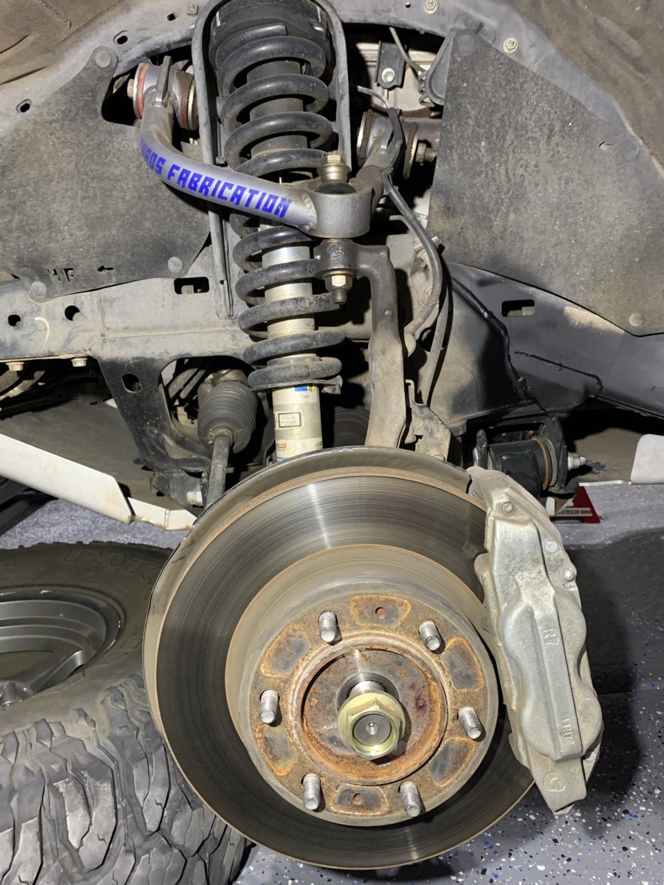

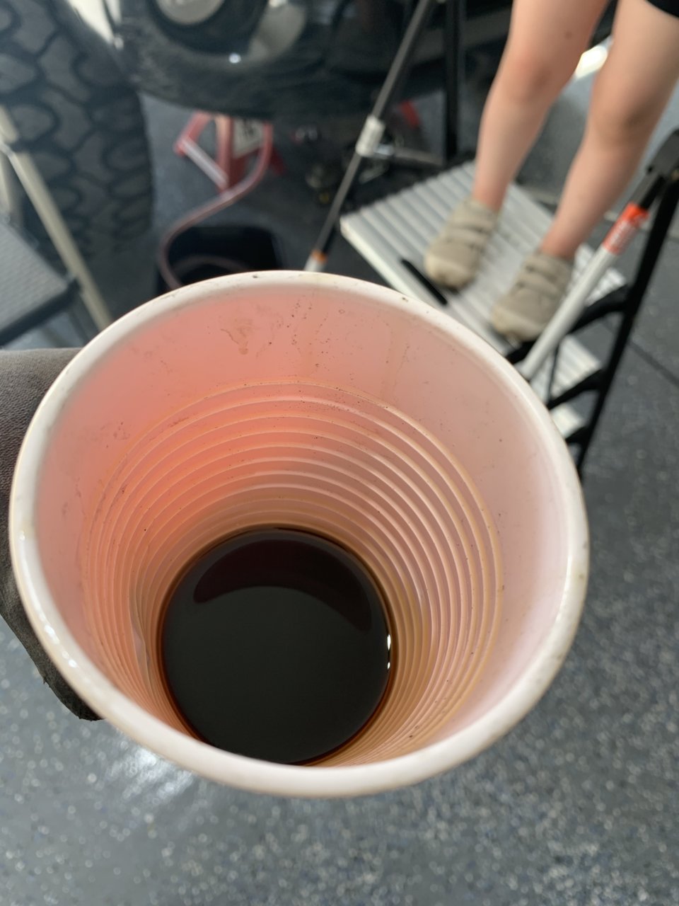

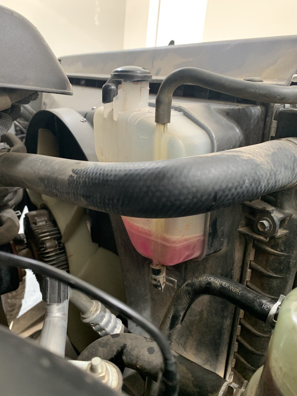

    PS flush with Theo. Steering feels lighter and smoother imagine that. Not sure if it’s been done on this truck or how long ago. Topped off my coolant overflow also because it’s been looking rather low for a while now. I realize it fluctuates.
    mcharfauros and Taco-Obsessed like this.
  17. Oct 21, 2020 at 6:26 PM
    #297
    Taco-Obsessed
    Dec 23, 2018
    #276756
    7,448
    Ha, my boy has the same shirt plus matching shorts.
  18. Oct 21, 2020 at 6:27 PM
    #298
    singletrack_ftw
    singletrack_ftw [OP] “I chopped the wrong leaf!”
    Aug 27, 2017
    #228223
    3,685
    Tyler
    AZ
    ‘08 TRD OR 4wd
    YES so does my son. They’re his PJ’s. I didn’t want any of his other clothes getting covered in dirty PS fluid hahaha
    Taco-Obsessed[QUOTED] likes this.

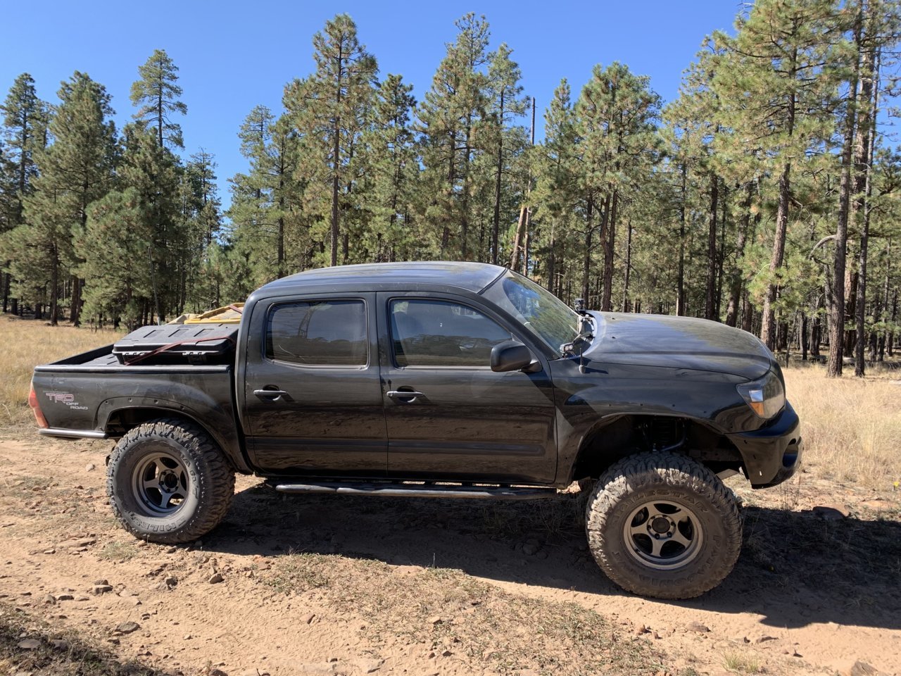

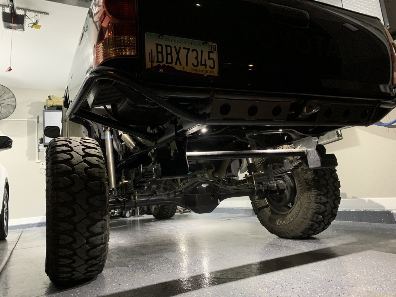

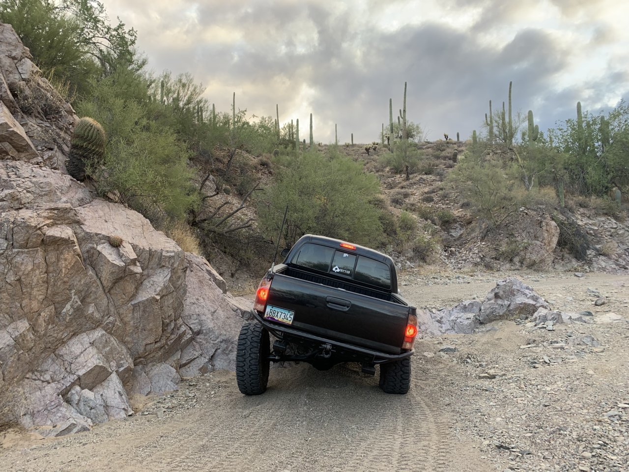

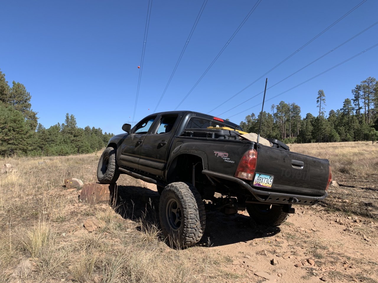

    Couldn’t be happier with the way the rear end of the truck articulates. This is def full droop travel on DS, with the shackle fully horizontal & the PS has just an inch of shaft showing at full stuff (with my superbump squished down pretty hard).
  20. Oct 28, 2020 at 8:32 AM
    #300
    HCJ
    HCJ Well-Known Member
    Mar 30, 2016
    #182820
    2,559
    John
    Virginia --> Texas
    '05 Taco with not enough miles

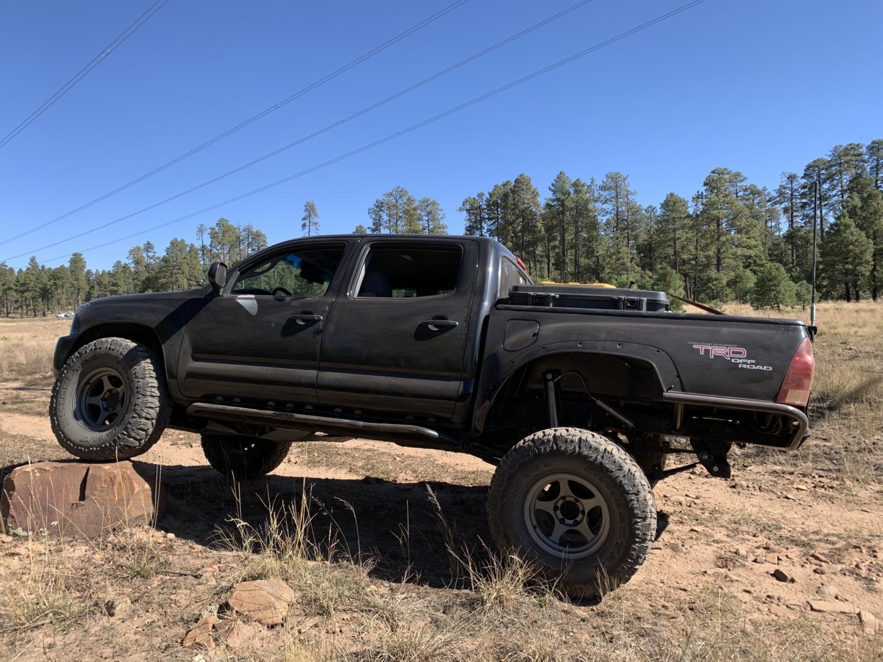

    Were you near pine top AZ? I coulda sworn I saw your truck driving through there around this time
