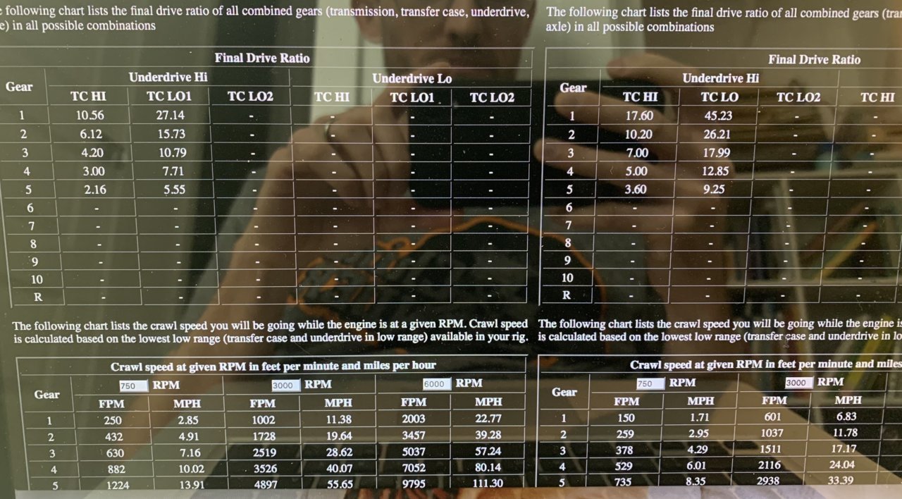

    https://www.tacomaworld.com/threads/singletrack’s-‘dad-shred-build-thread’-i’m-just-doing-it-for-the-kids.619250/ Sos offroad sliders (kickout + filler) Sos offroad full belly skids (steel) Sos offroad front recovery point Sos offroad concepts HC rear bumper with bedside kickout tubes Marlin Crawler LCA frame brace kit Trail Gear rear diff cover Bilstein 5100 + OME 885 Total Chaos UCA BILSTEIN b110 OME Dakar standard pack Wheelers Ubolt flip kit Wheelers Superbump f/r Wheelers SS extended brake lines FN five star 16x8 -25 Milestar Patagonia MT 315/75r16 Custom projector retrofit (acme super h1 + morimoto 4300k) Baja Designs S2 sport ditch pods on CBI ditch pod mounts Amazon AMAK rock lights CMC CB radio hardmount
    So that’s not necessarily true, I spoke with Zuk (ken Francisco) gear legend here in phx az where I live & I asked him about this concern.. “smaller teeth more prone to breakage?” Ken assured me that is not the case, it comes down to what the quality of the gears is, WHO did the gear work, and the break-in process. I know several guys with true crawler toyotas who are running 5:29 without hesitation & it’s not an issue if done right.
    also - I’m doing a REM/cryo treatment to the rear ring and pinion which further strengthens the teeth surfaces further reducing any changes of breakage. I’m hard on my truck but I’m not an idiot, I’m confident I’ll be ok. If not - it is what it is, all part of the game we play.

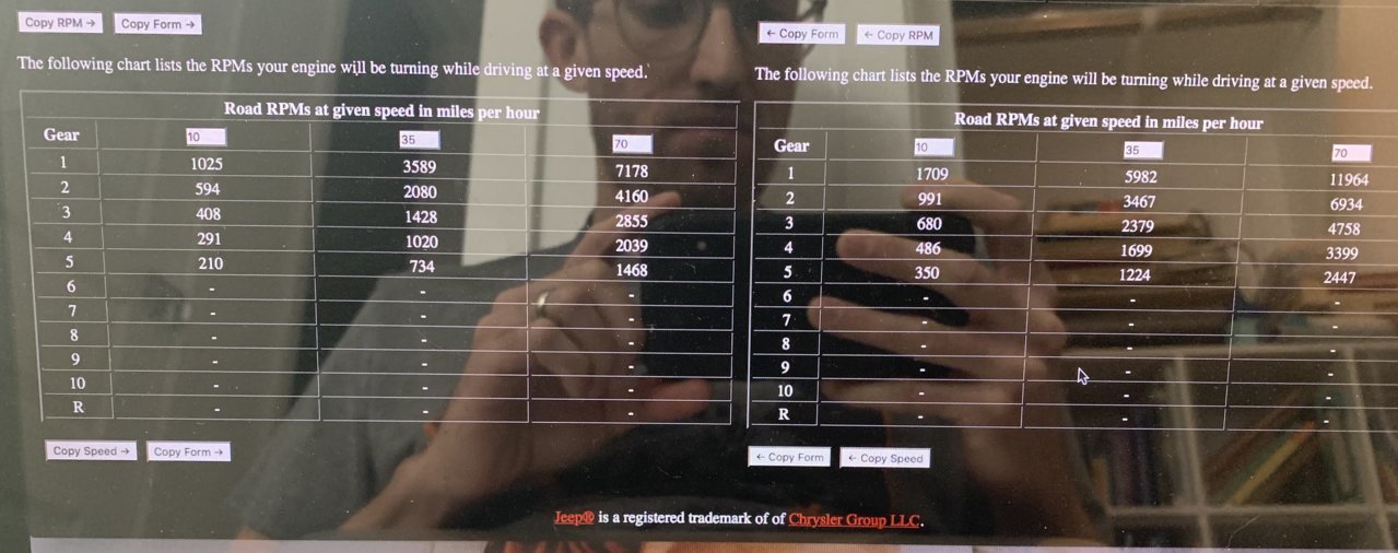

    also - here are some screenshots of the Grimm keeper gear calculator of stock gears w 35’s vs 5:29 w 35’s for the 5spd AT and 4.0 v6.

    Those are just mitigants. They may be enough. Not trying to talk you out of it.

    2447 RPM at 70mph in 5th gear. That’s totally tolerable and reasonable for me. Check out the crawl speeds.
