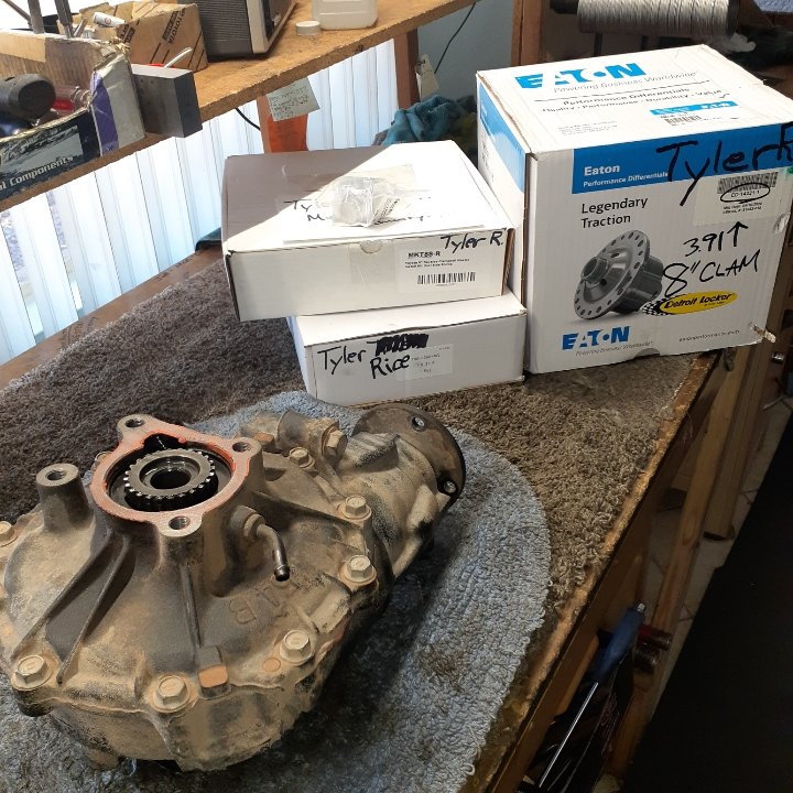

    Last tank of gas on stock gears. 5:29 here I come. Pulling diffs Wednesday

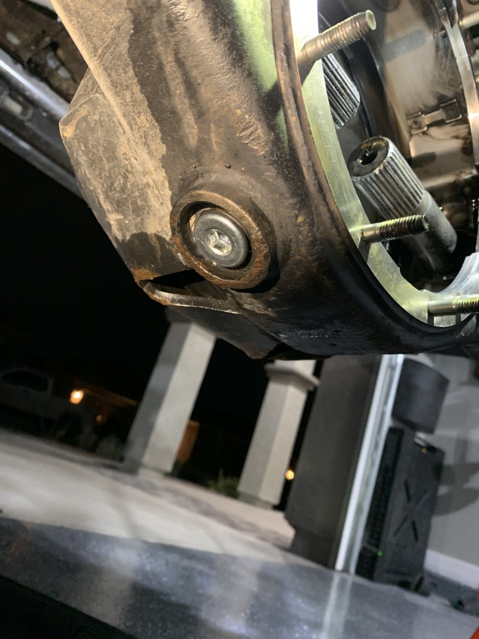

    https://www.tacomaworld.com/threads/singletrack’s-‘dad-shred-build-thread’-i’m-just-doing-it-for-the-kids.619250/ Sos offroad sliders (kickout + filler) Sos offroad full belly skids (steel) Sos offroad front recovery point Sos offroad concepts HC rear bumper with bedside kickout tubes Marlin Crawler LCA frame brace kit Trail Gear rear diff cover Bilstein 5100 + OME 885 Total Chaos UCA BILSTEIN b110 OME Dakar standard pack Wheelers Ubolt flip kit Wheelers Superbump f/r Wheelers SS extended brake lines FN five star 16x8 -25 Milestar Patagonia MT 315/75r16 Custom projector retrofit (acme super h1 + morimoto 4300k) Baja Designs S2 sport ditch pods on CBI ditch pod mounts Amazon AMAK rock lights CMC CB radio hardmount

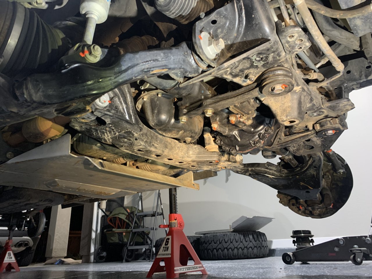

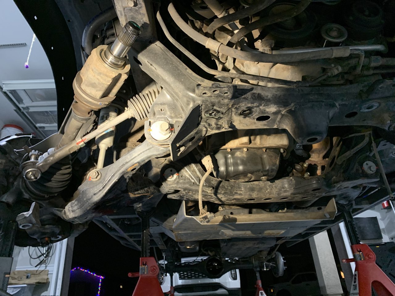

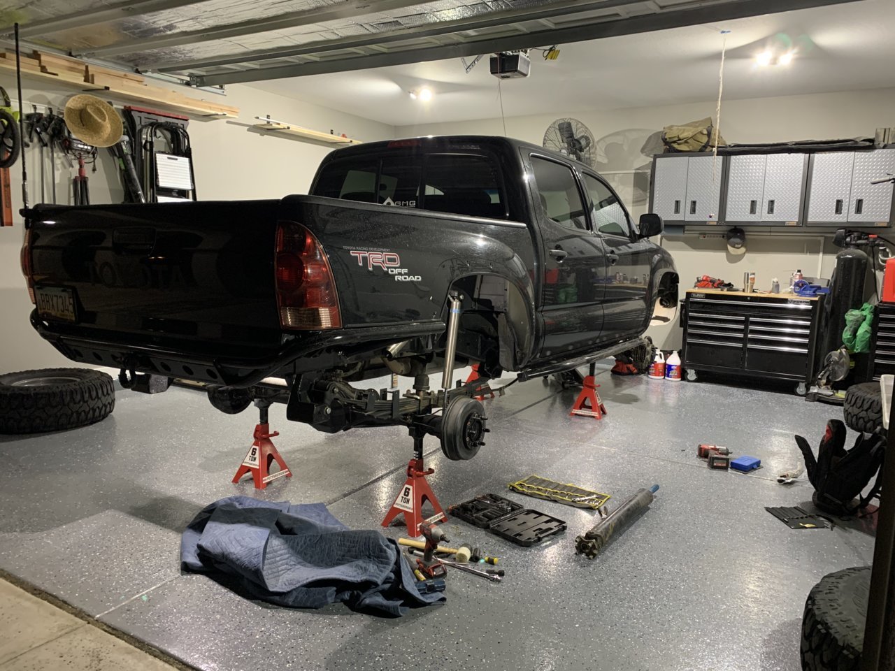

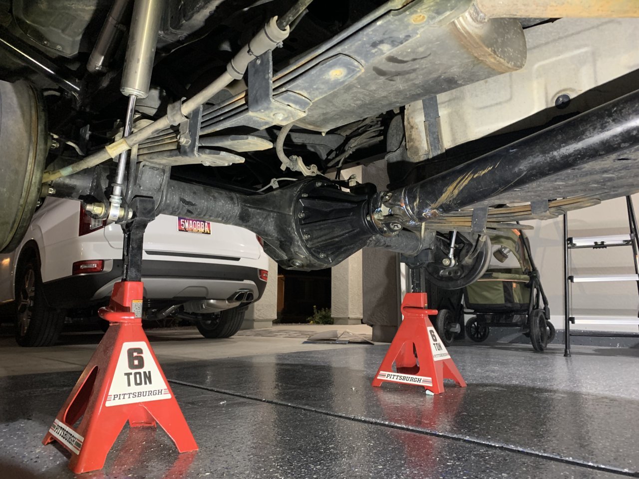

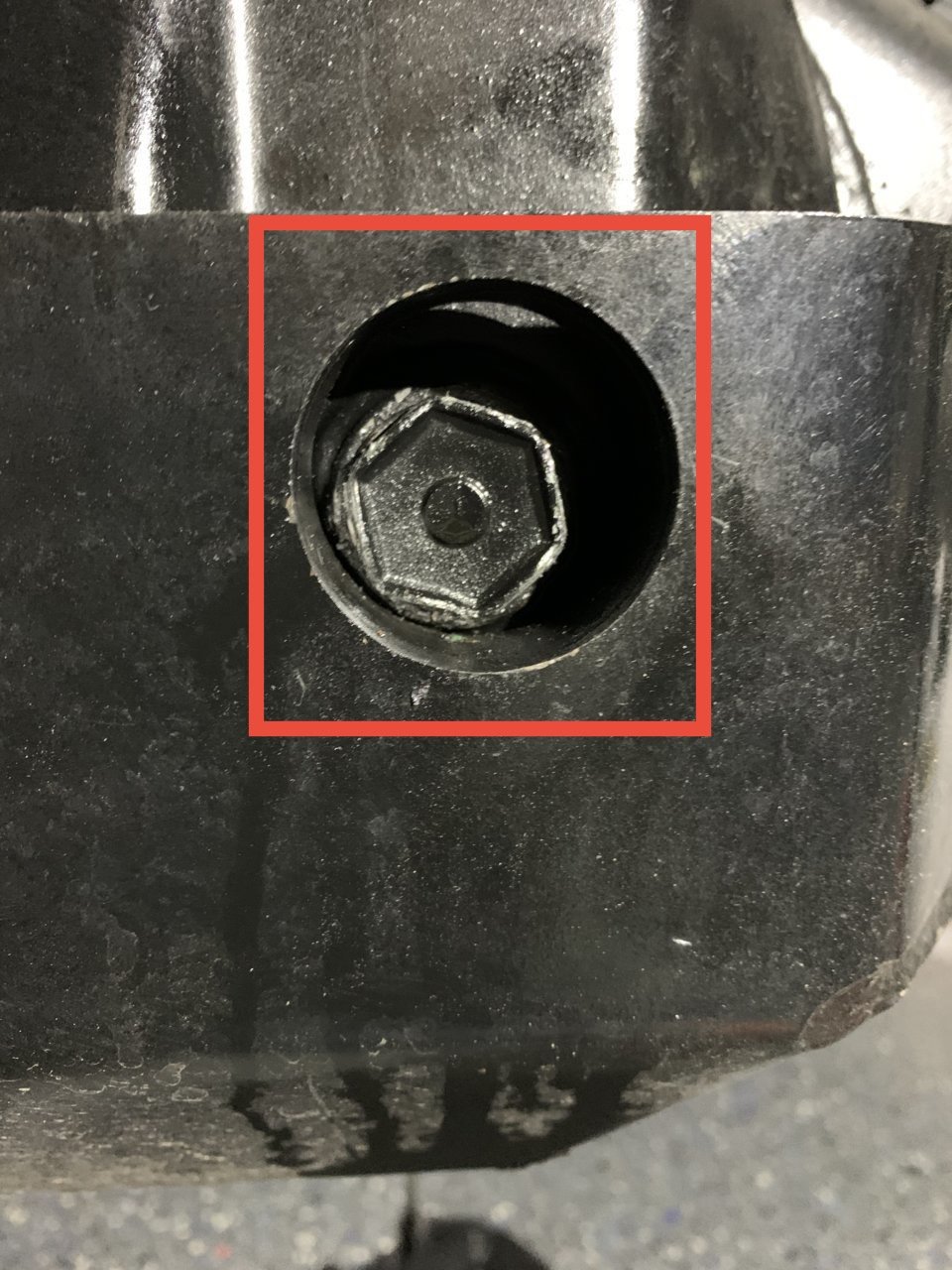

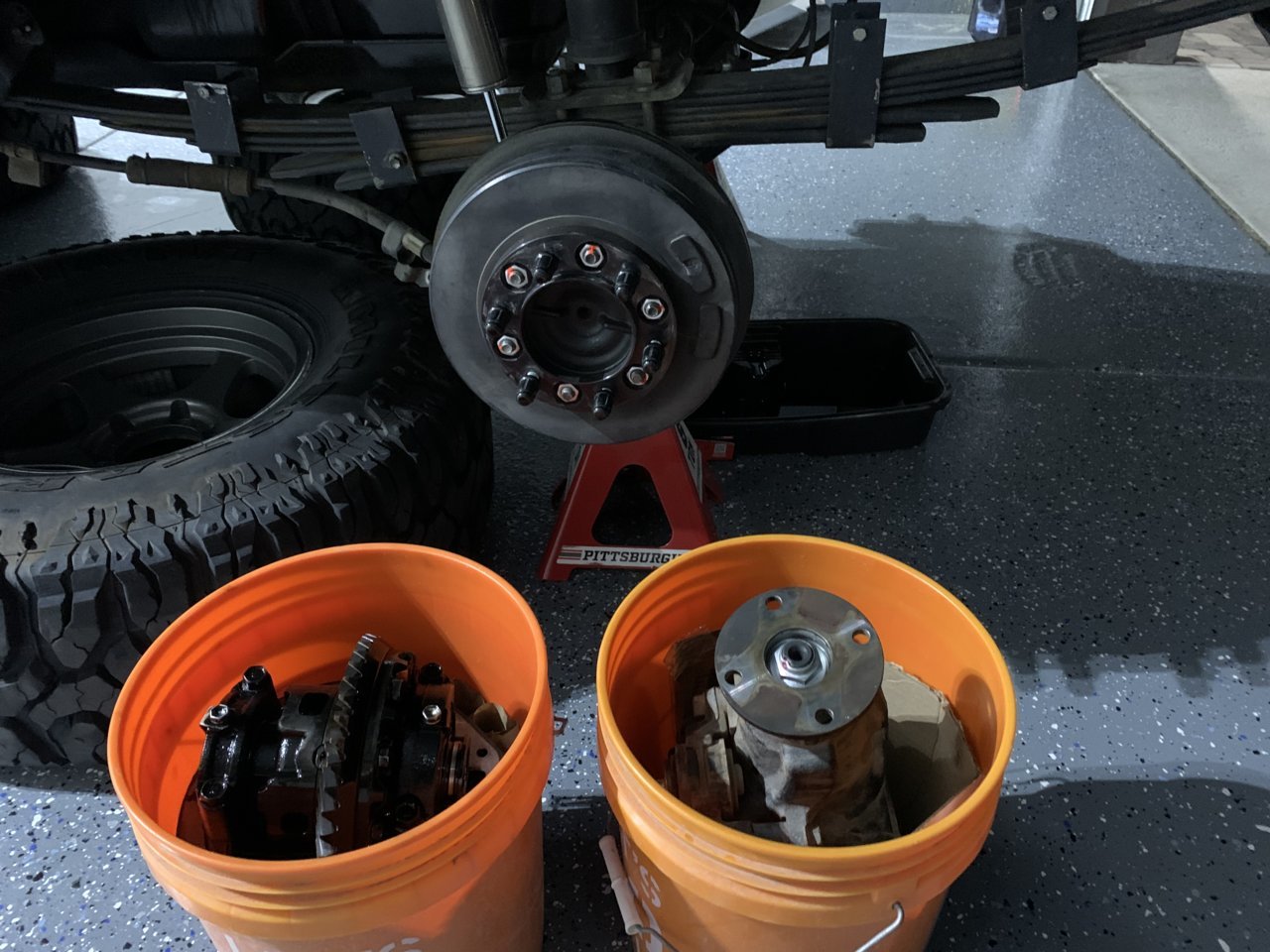

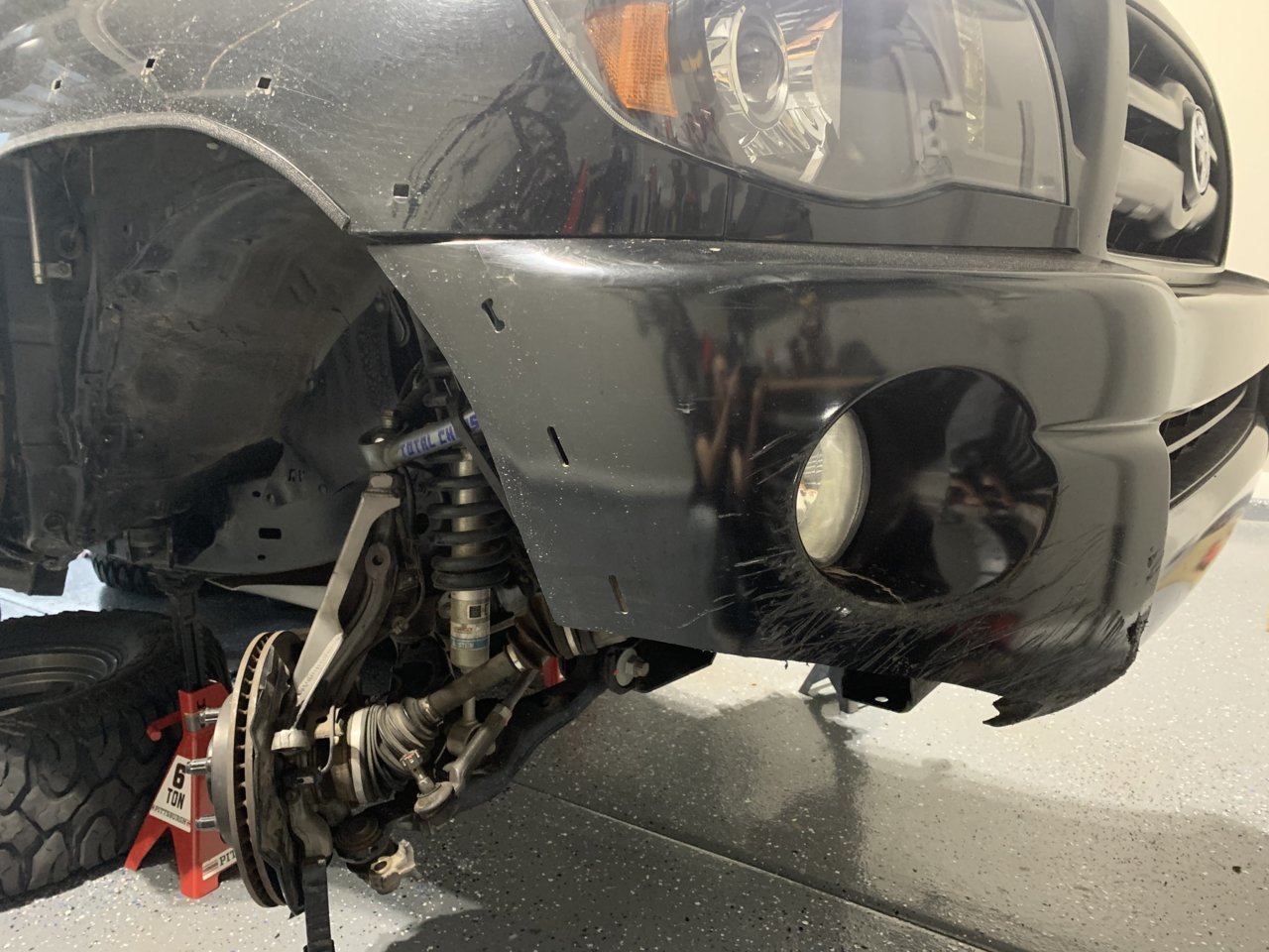

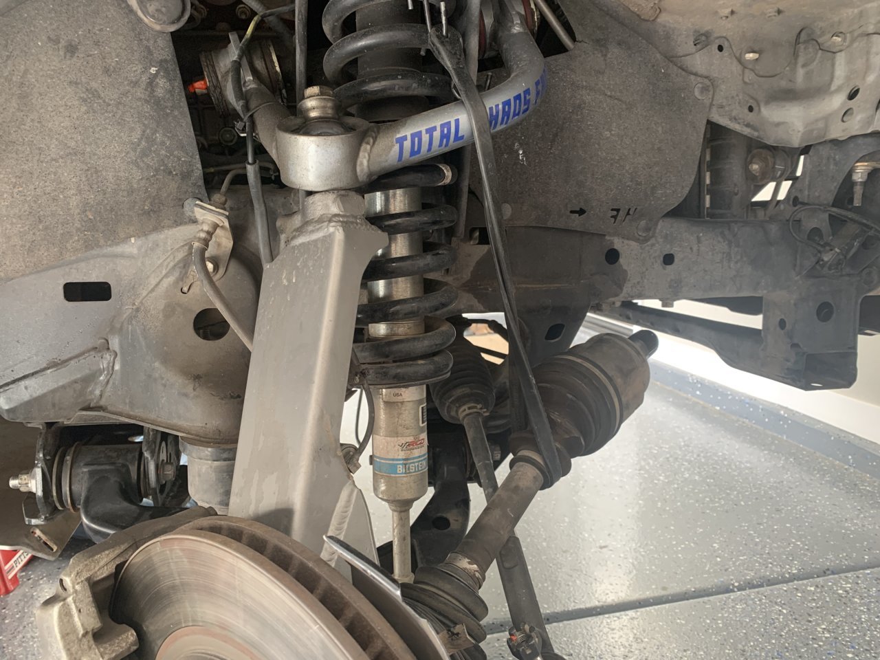

    Driveshafts disconnected, front diff drained & front knuckles all loosened up, brake lines unbolted in the rear, just need to figure out a workaround on this fill plug that’s too close to the diff cover before I drain the rear diff. Will be pulling the actual diffs out tomorrow night. Nice head start tonight. #hovertruck

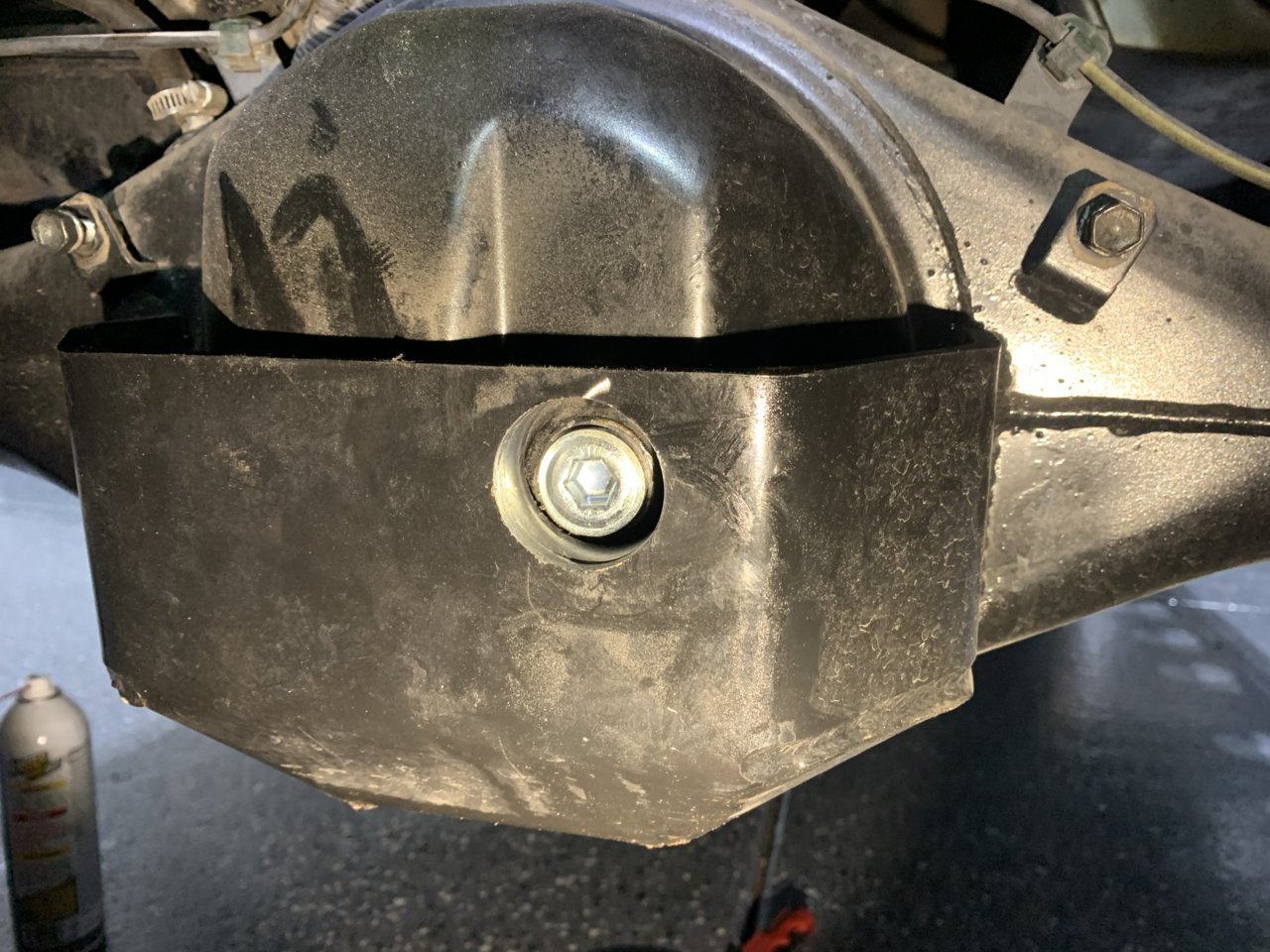

    2017 4Runner

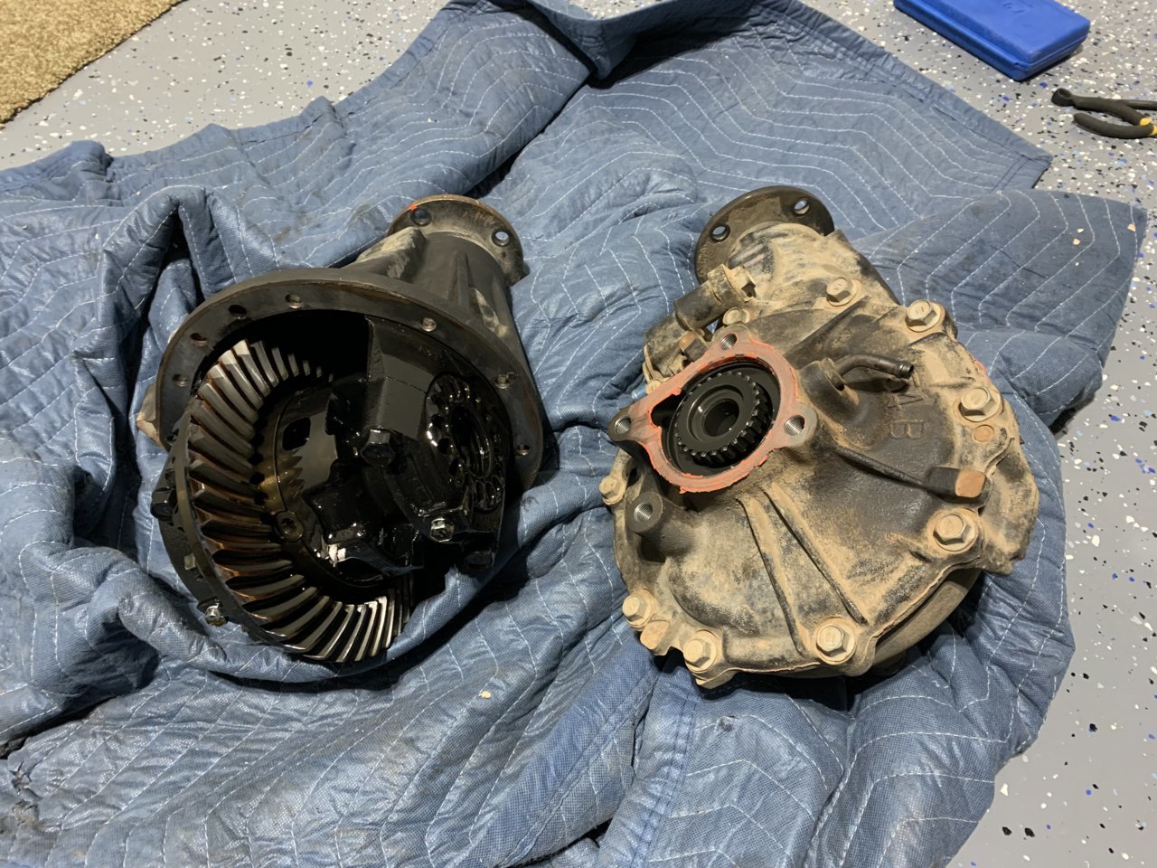

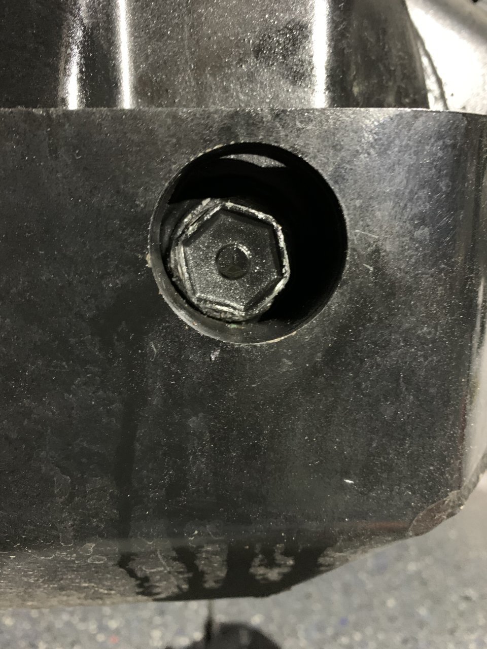

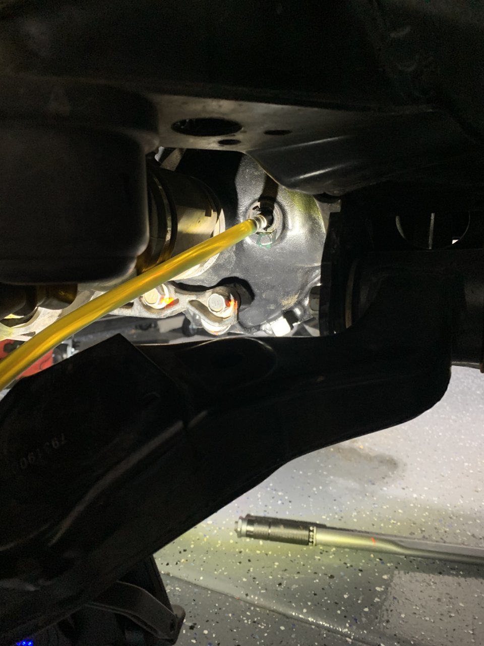

    That fill plug looks like a tricky one. Whenever I weld one of those covers on, I like to put a socket on the plug while I position the cover to avoid this. You could cut out a square to provide better access to the plug.
  5. Jan 27, 2021 at 6:01 AM
    #365
    singletrack_ftw
    singletrack_ftw [OP] “I chopped the wrong leaf!”
    Aug 27, 2017
    #228223
    3,685
    Tyler
    AZ
    ‘08 TRD OR 4wd
    Excellent idea Randy, another thought was to use a Dremel disk to cut a line deep enough into the plug to use a sturdy flat head screwdriver
    EatSleepTacos[QUOTED] likes this.

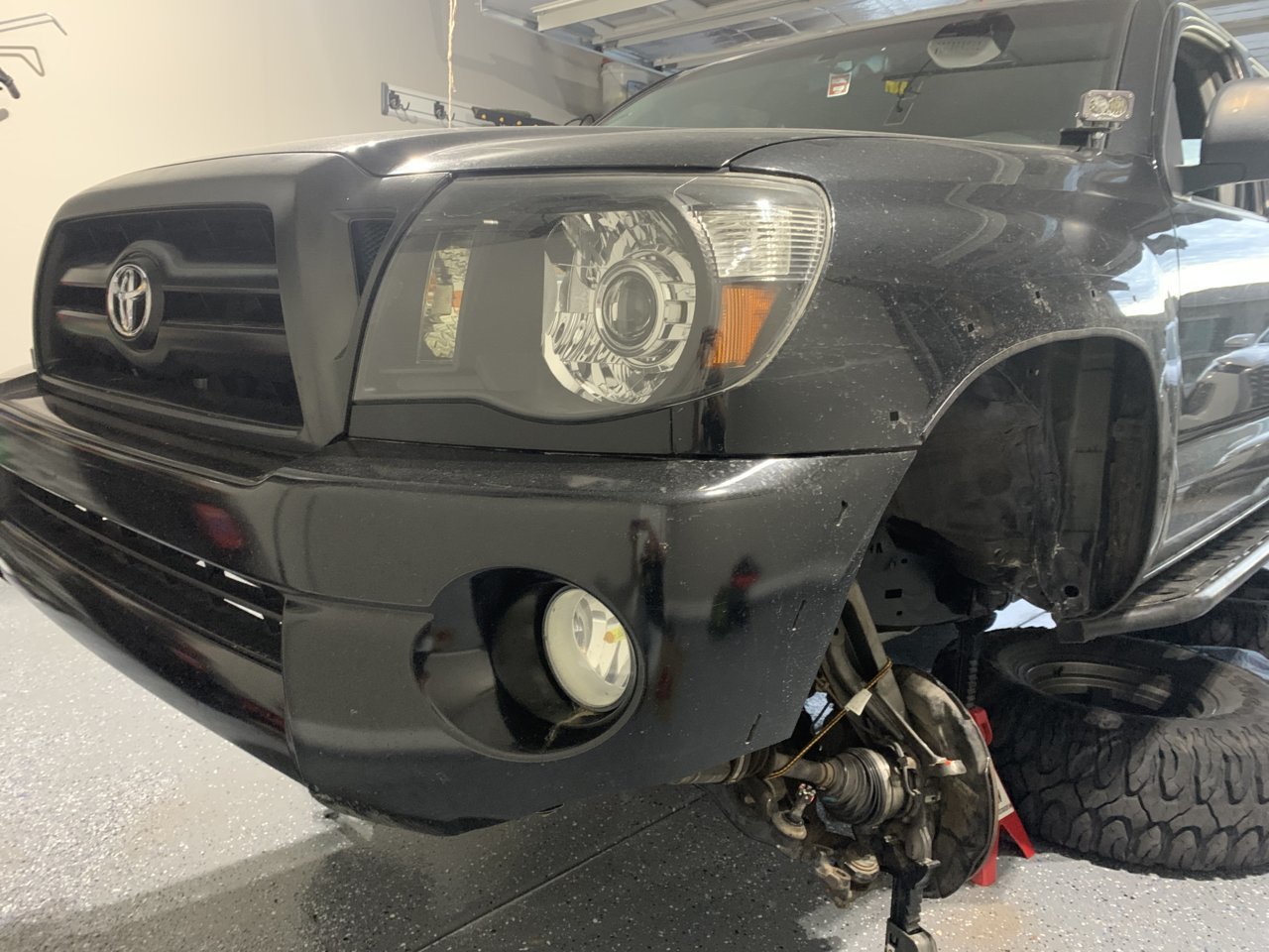

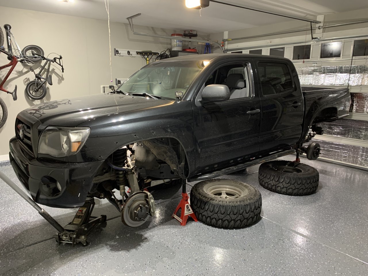

  6. Jan 27, 2021 at 11:01 PM
    #366
    singletrack_ftw
    Aug 27, 2017
    #228223
    3,685
    Tyler
    AZ
    ‘08 TRD OR 4wd

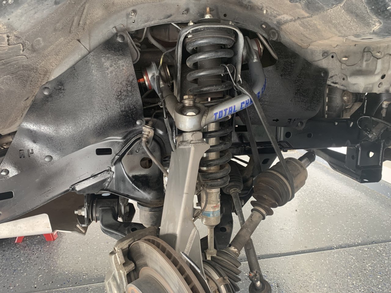

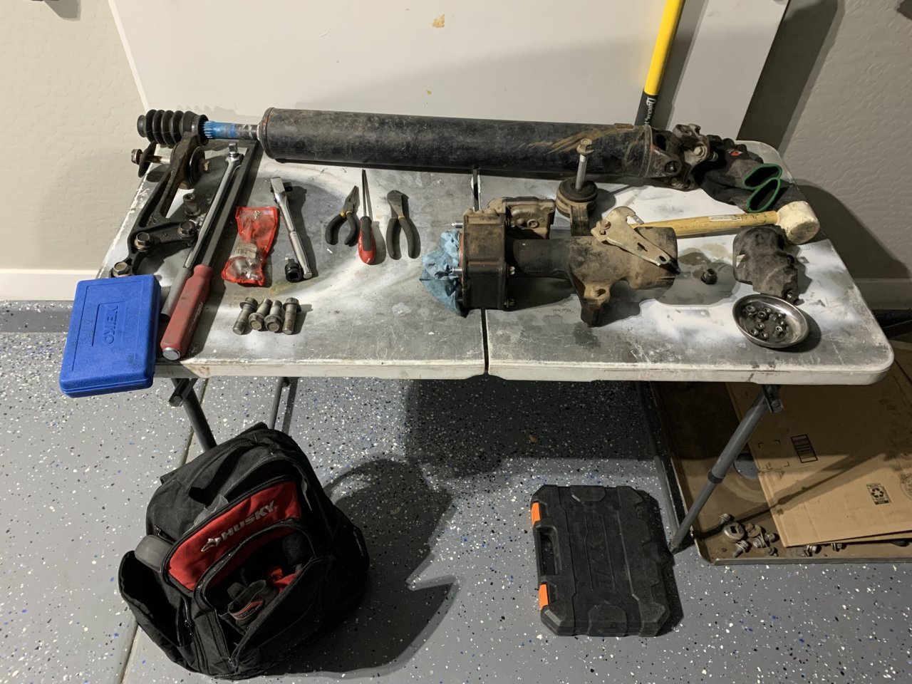

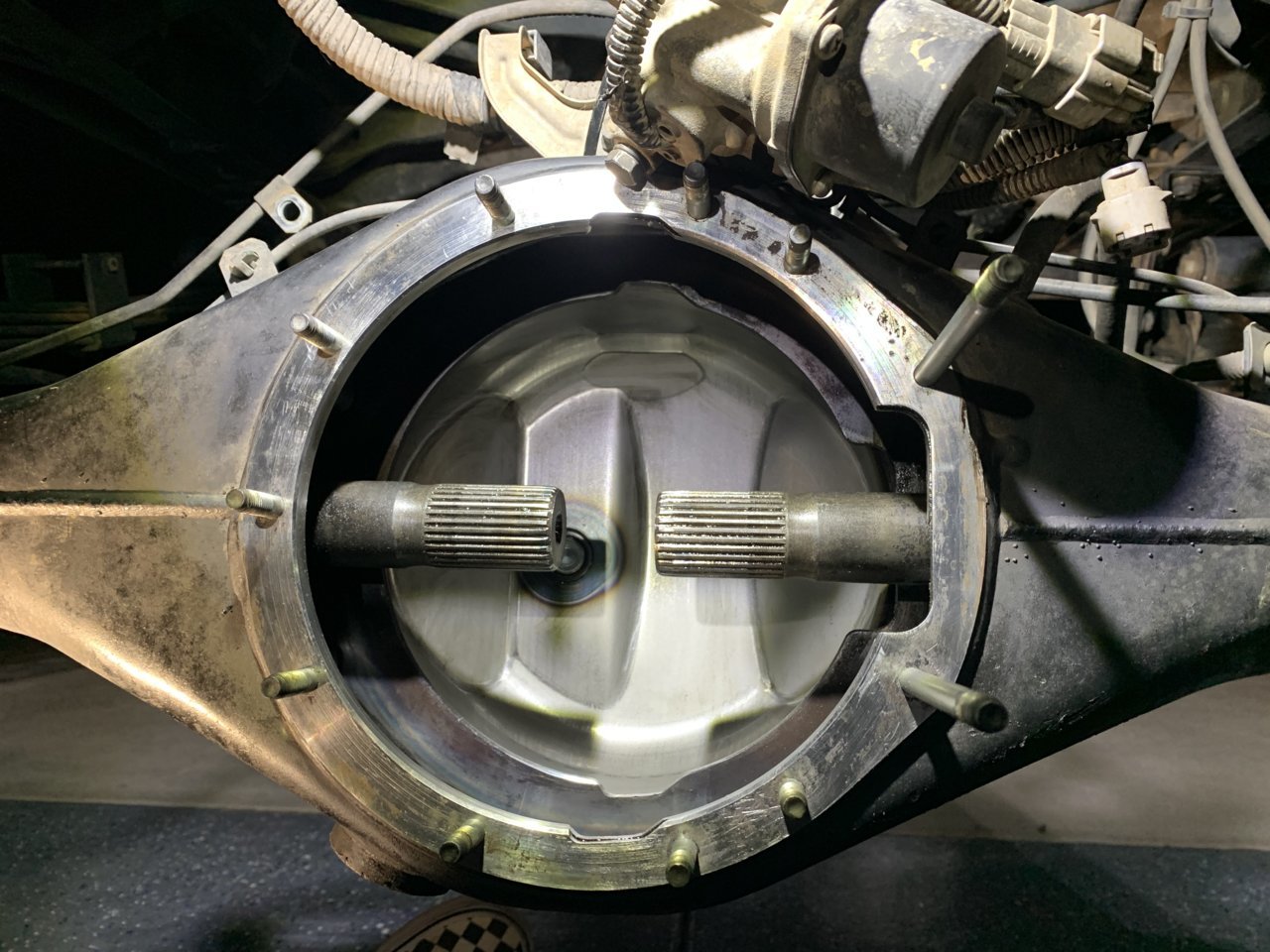

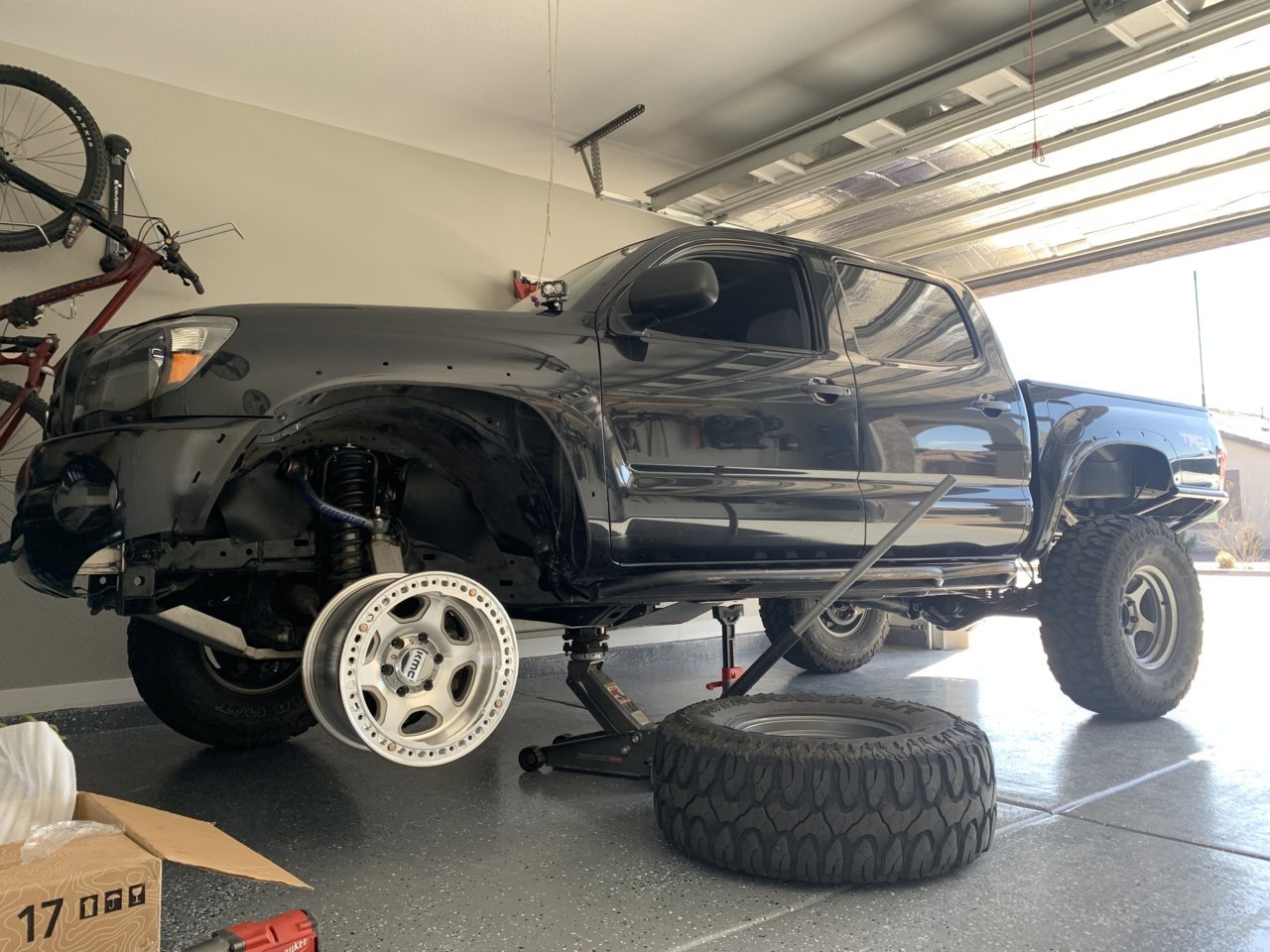

    This went well! Thanks to buddy Austin for helping me safely muscle these bad boys down to safety. Not too bad of a job at all, the writeups and videos always help a ton.

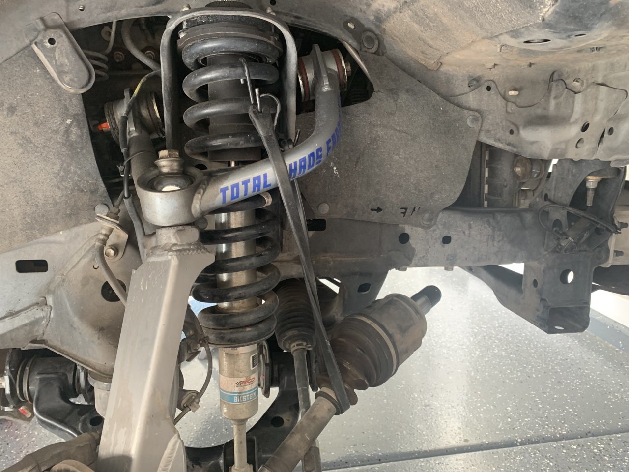

    Tossed some paint on my very gross front frame rails & ordered some new $20 splash shields

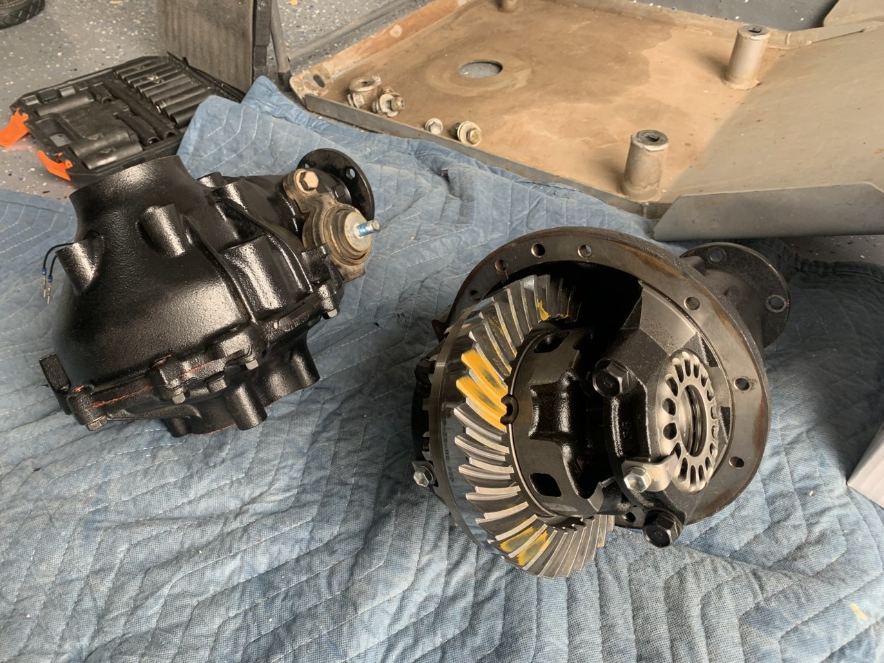

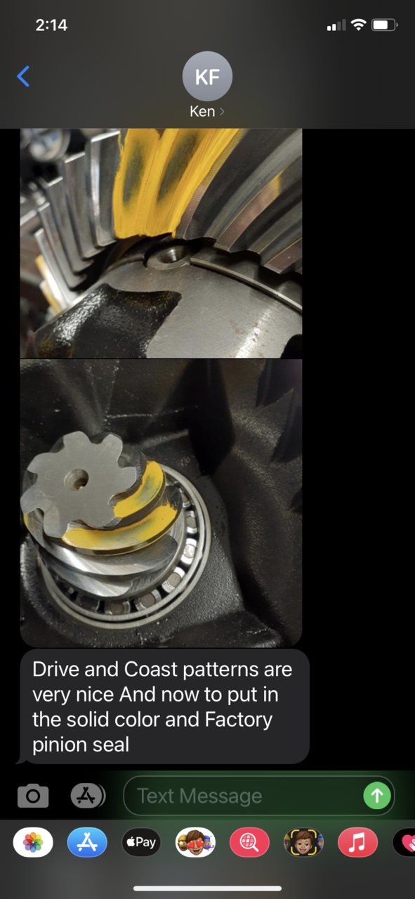

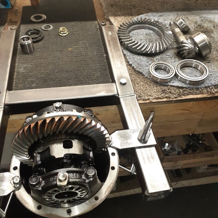

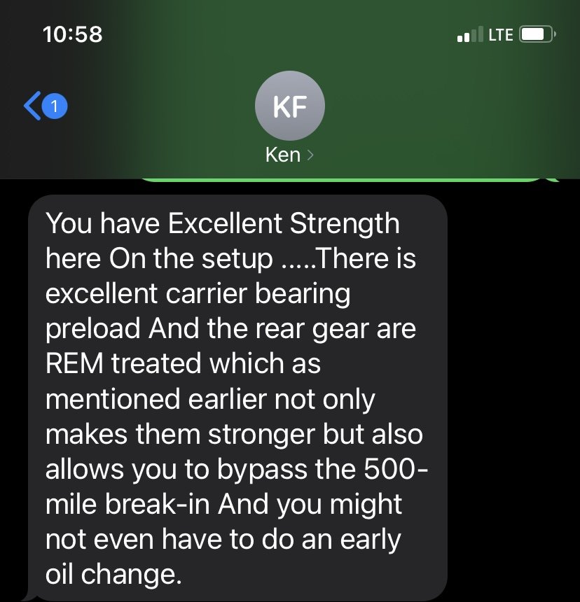

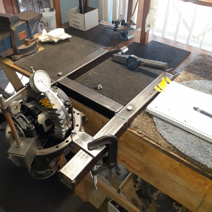

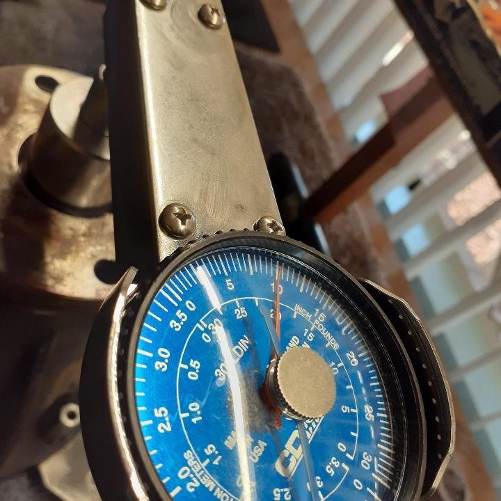

    Pretty cool when your gear pro sends you gritty details like this

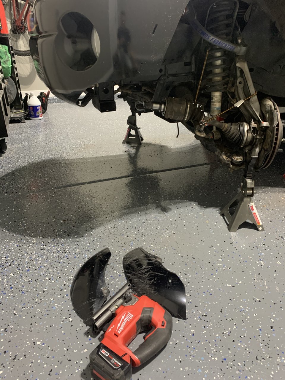

    Got bored. Put my sweet new jigsaw to good use trimming some corners

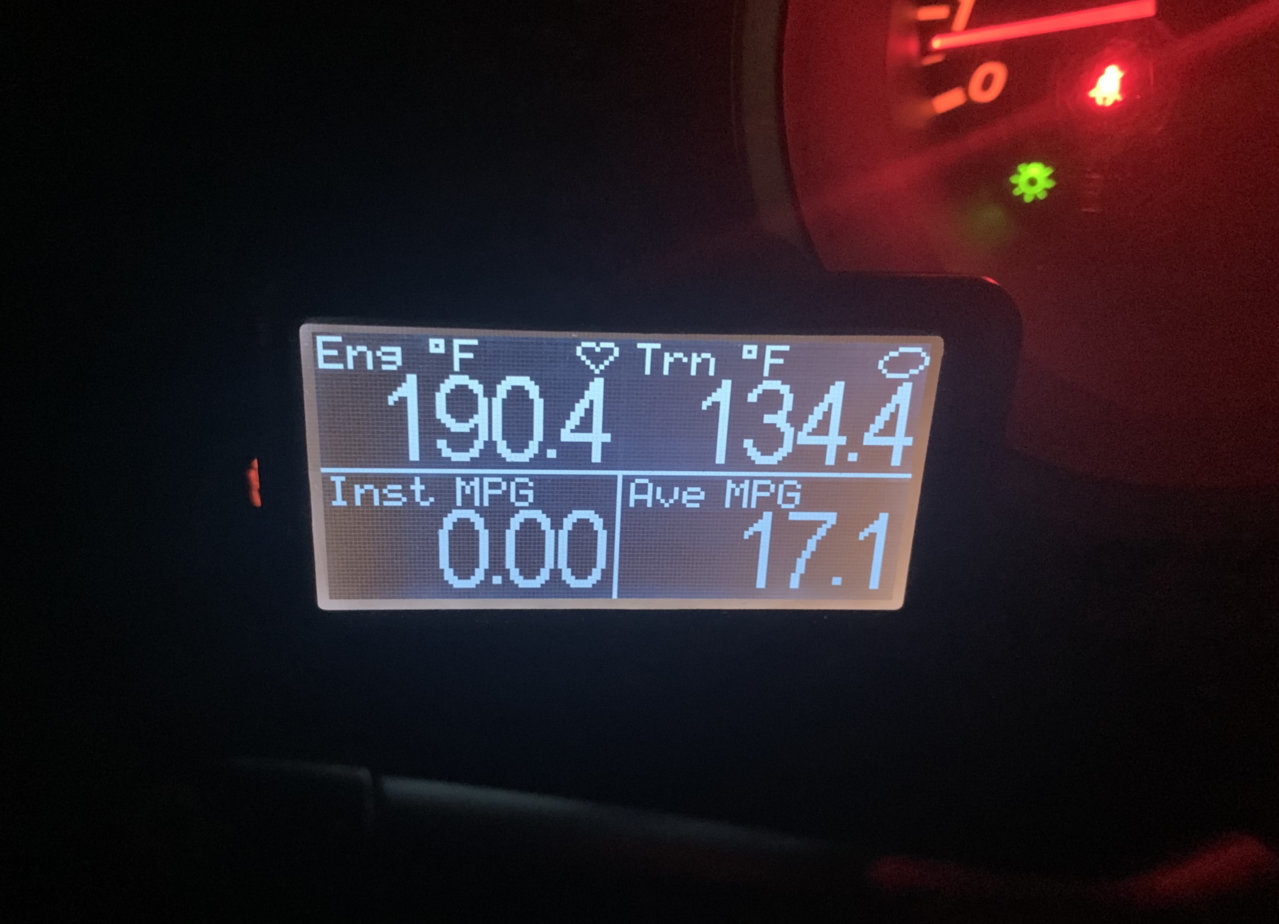

    WOWWWW. PRIOR MPG (combined city HWY) was 14.3.
    I reset my Ultragauge and right now my CITY MPG Is over 17

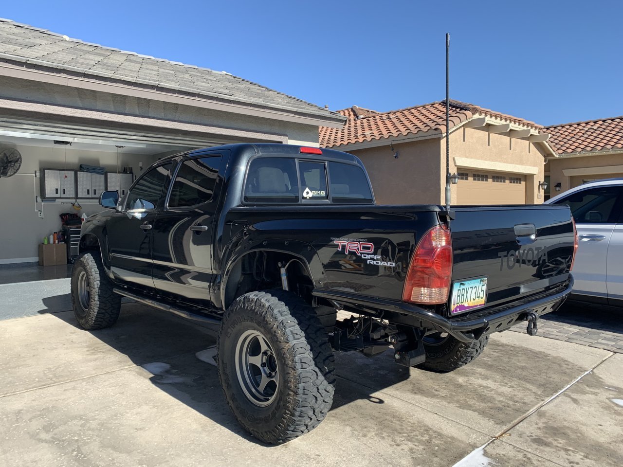

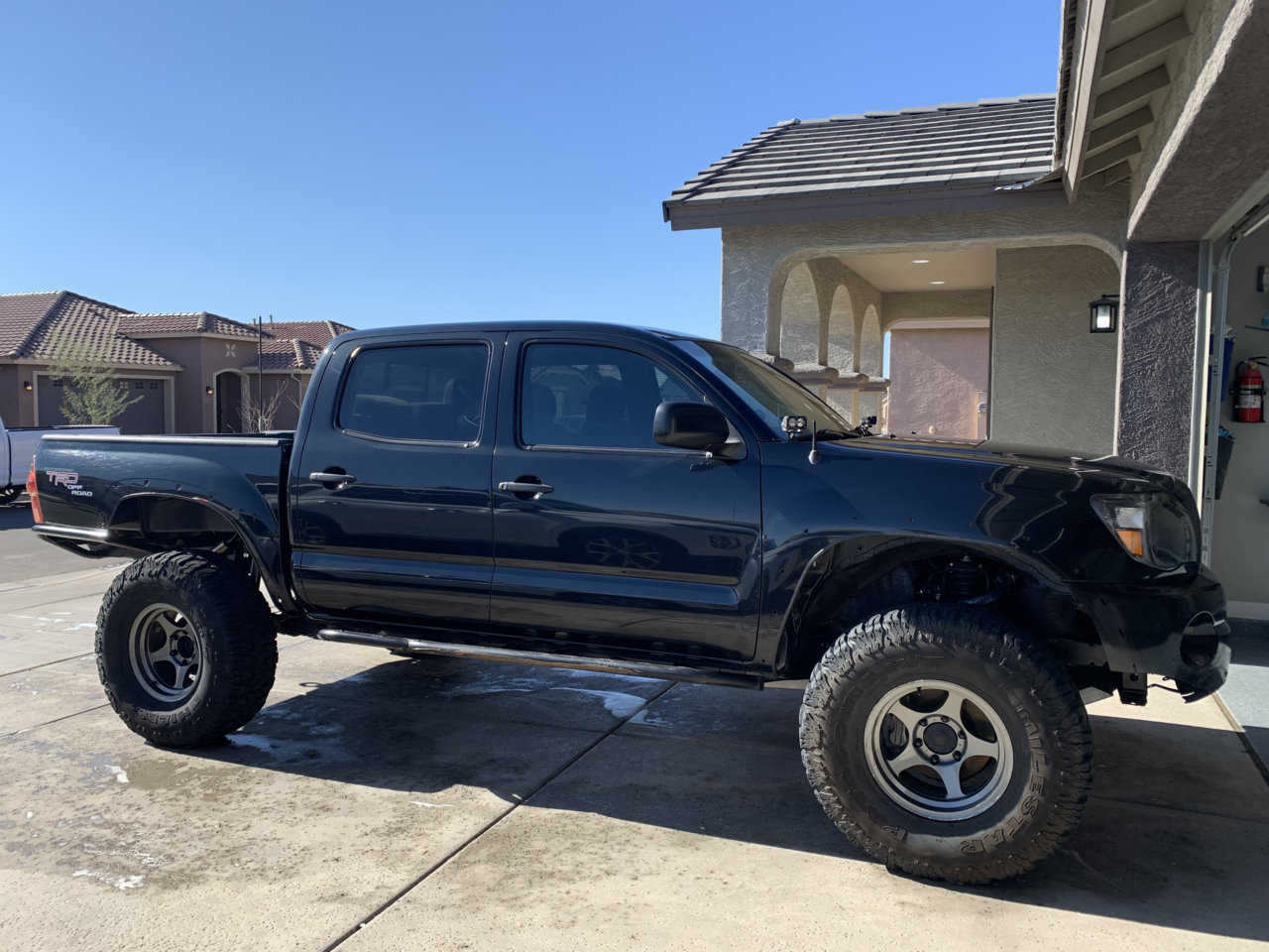

    Running errands, trying to rack up the break-in miles from the new gears. Washed the truck. Returned the dirty life wheel because -14 offset means I’d still need spacers and it’s dumb to me to have to add spacers to a $350 beadlock. Going with these instead. Gonna take a while to acquire the other wheels. Only buying one at a time lolllllllll

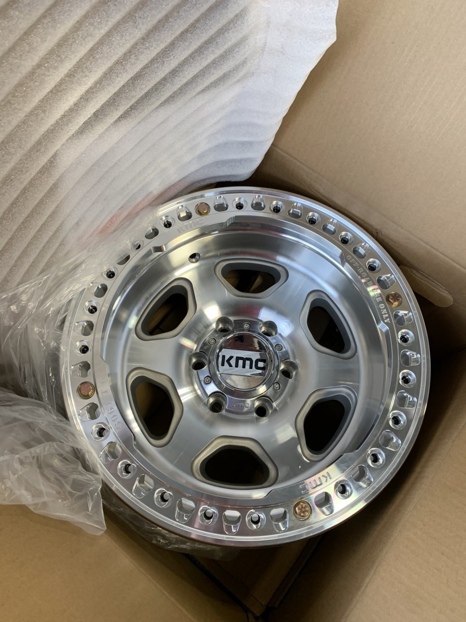

  18. Feb 12, 2021 at 2:01 PM
    #378
    singletrack_ftw
    Aug 27, 2017
    #228223
    3,685
    Tyler
    AZ
    ‘08 TRD OR 4wd

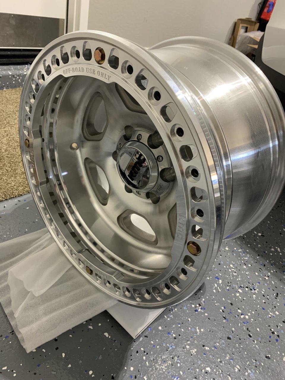

    Gonna buy one at a time of these sick wheels. Gonna take a while to accumulate them but I’m excited nonetheless.

    Really digging that rear HC man! :headbang:
