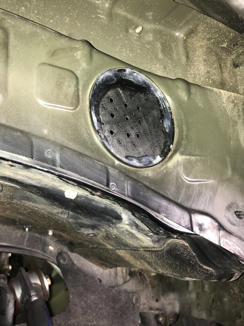

    Thank you so much! And yeah here’s what I put on that exposed hole to somewhat seal it off. I have since plugged half of these holes I drilled.

    Snorkel! Even after trying to mimic you and Meso I went through several variations none of which I was confident enough about! So Snorkel! Haha looks good glad it’s working for you?!!

    No snorkel for me. For several reasons but it is a secure solution!

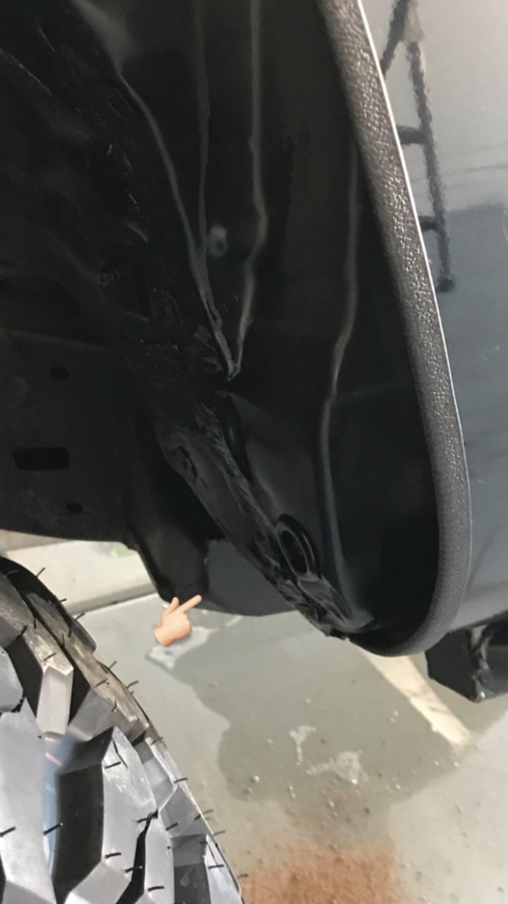

    Yes absolutely I do rub. I only rub at full lock in reverse. Anyone that has ACTUAL 35’s and says they don’t rub either Has a crazy body lift and or drop bracket lift or is lying. Or maybe they have 315/70/17 KO2’s which are closer to 33.7” tall or something. My rubbing isn’t bad and again is only in certain situations. The ONLY way to avoid rubbing with 35’s is with a cab mount relocation or by leaving the cab mount wide open after chopping the front of it. (Which is very foolish).
    Here’s a pic of what my wheel well looks like for example. FLAT pinch seam, aggressive CMC, NO outer fenders & hammered all over the place.
    I ONLY touch the firewall at full stuff. Not a big issue. And tbh I could just add a spacer to my front wheelers superbumps and fix that too

    My FN wheels are -25 offset which makes the trimming required even more aggressive for sure. But the stance is worth it IMO
