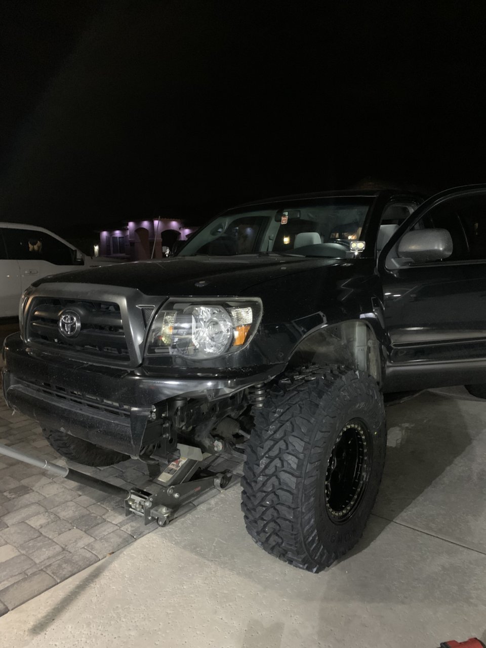

    Not ready to drive yet but you get the idea

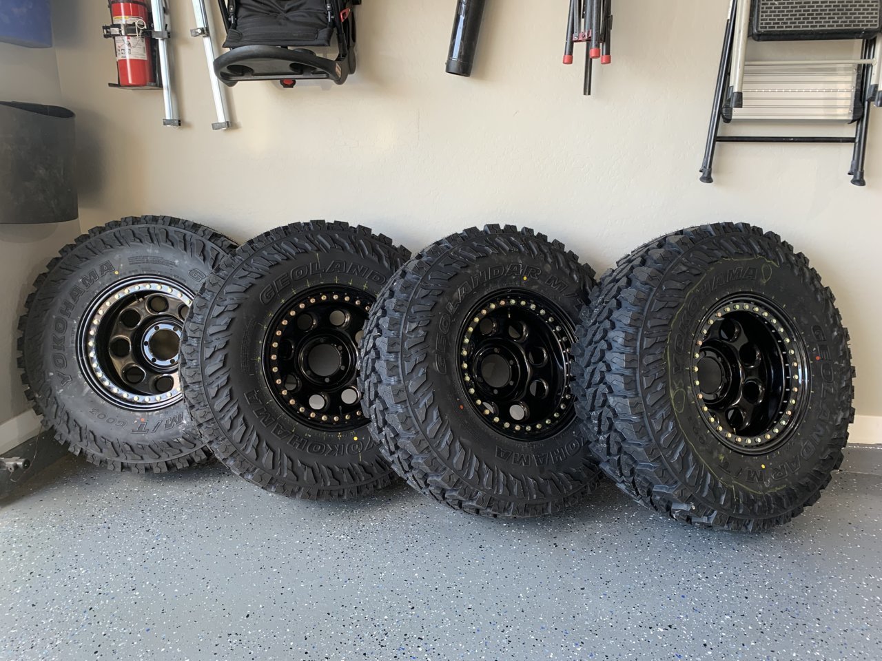

    Thank you! I think so too, but also … these are the cheapest, aggressive offset beadlocks you can buy

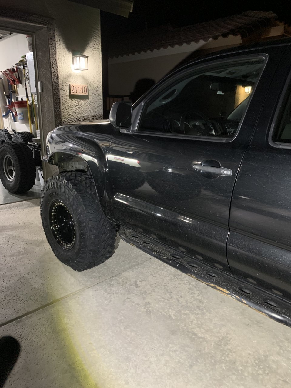

    We are ROLLIN! Test drive on 37’s and I only rubbed once at full lock during a 3 point tight turnaround in a culdesac. I will be tubbing the truck ASAP & I have a tundra steering rack on order from basikbiker.
    To my pleasant suprise, these budget STEEL beadlocks UNBALANCED, mounted on 37” MT’s ride ultra smooth at 50mph. The 5:29 gears don’t miss a beat with these big meats - the truck feels great so far. Heck even the steering doesn’t feel bad (ON ROAD)

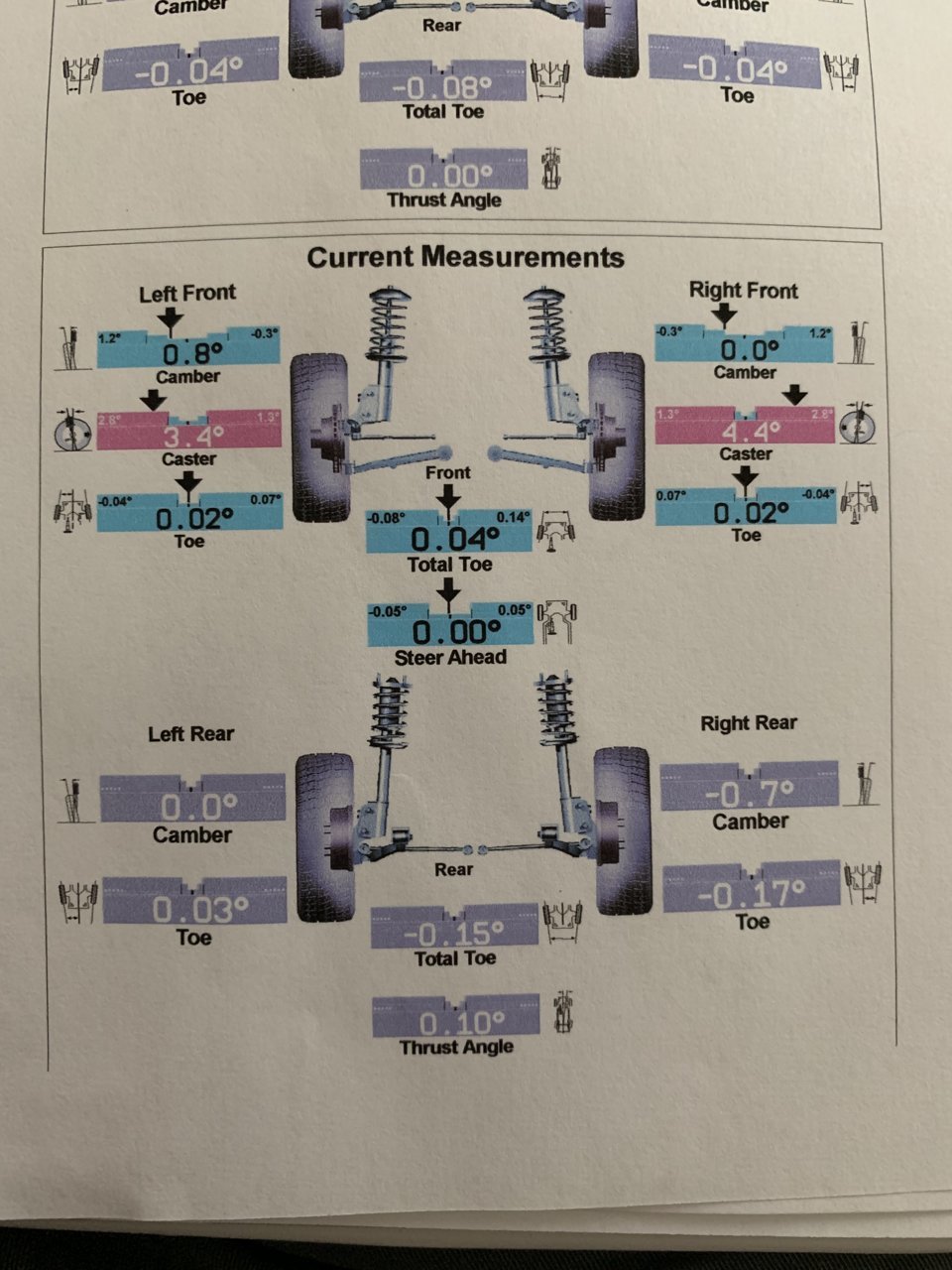

  14. Aug 17, 2021 at 4:35 AM

    Looks awesome.
    How much caster are you running?

  16. Aug 18, 2021 at 4:55 AM
    #476
    singletrack_ftw
    singletrack_ftw [OP] “I chopped the wrong leaf!”
    Aug 27, 2017
    #228223
    3,685
    Tyler
    AZ
    ‘08 TRD OR 4wd
    https://www.tacomaworld.com/threads/singletrack’s-‘dad-shred-build-thread’-i’m-just-doing-it-for-the-kids.619250/ Sos offroad sliders (kickout + filler) Sos offroad full belly skids (steel) Sos offroad front recovery point Sos offroad concepts HC rear bumper with bedside kickout tubes Marlin Crawler LCA frame brace kit Trail Gear rear diff cover Bilstein 5100 + OME 885 Total Chaos UCA BILSTEIN b110 OME Dakar standard pack Wheelers Ubolt flip kit Wheelers Superbump f/r Wheelers SS extended brake lines FN five star 16x8 -25 Milestar Patagonia MT 315/75r16 Custom projector retrofit (acme super h1 + morimoto 4300k) Baja Designs S2 sport ditch pods on CBI ditch pod mounts Amazon AMAK rock lights CMC CB radio hardmount
    Let me try to find my alignment sheet, I believe it’s in the +3-4* range. With 0 tie and 0 camber “ish”

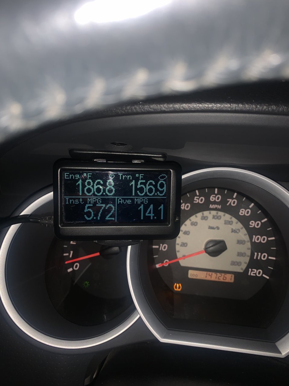

    Looks like conservative City driving / my dd work commute I can still get 14 mpg so far. Which is cool
