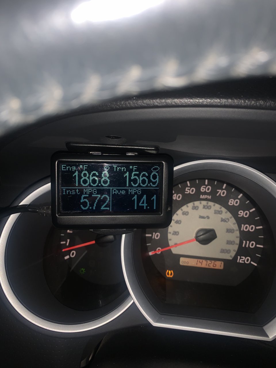

    [you guys are all so nice - I appreciate the compliments very much!!!! She isn’t an overly complicated truck or fancy but she does great! And I’m working on my driving style & still getting >14 mpg CITY in stop & go traffic.

    I’m actually getting almost 15mpg city right now. Wil upload more pics of that hahaha

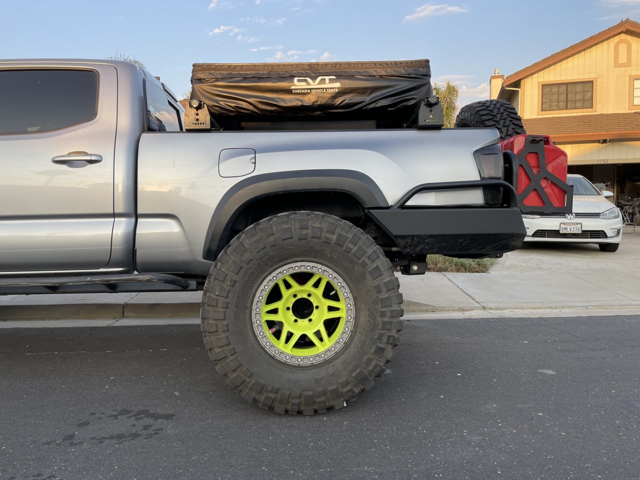

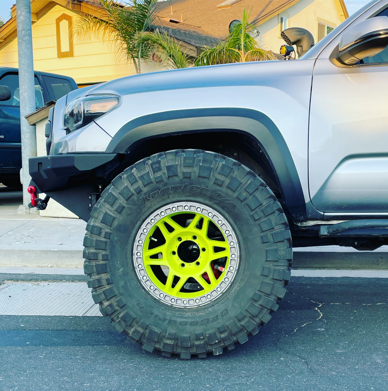

    4450FD0B-7DDE-4A0F-A998-CFAA5A700113.jpg C3EF34D6-6D89-4FA6-AACD-DDABC54623F3.jpg
    Incoming. You’re my inspiration

    Wowwwwwwwwwwww that’s baller. Seriously sick. post more pics when you can!

    Are those used? Do you have all 4?! I need details!

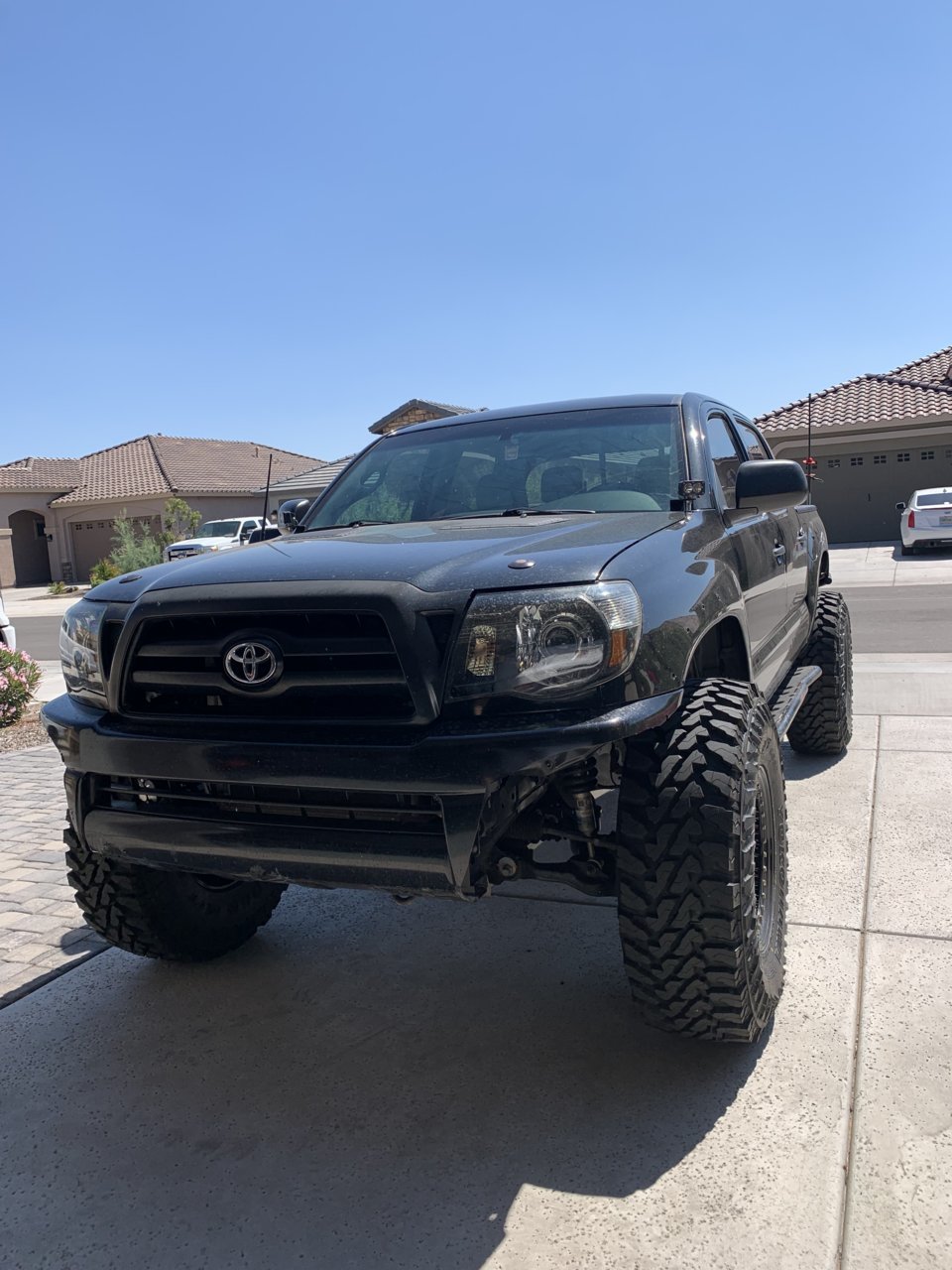

  11. Aug 22, 2021 at 6:27 PM
    #491
    singletrack_ftw
    singletrack_ftw [OP] “I chopped the wrong leaf!”
    Aug 27, 2017
    #228223
    3,685
    Tyler
    AZ
    ‘08 TRD OR 4wd
    https://www.tacomaworld.com/threads/singletrack’s-‘dad-shred-build-thread’-i’m-just-doing-it-for-the-kids.619250/ Sos offroad sliders (kickout + filler) Sos offroad full belly skids (steel) Sos offroad front recovery point Sos offroad concepts HC rear bumper with bedside kickout tubes Marlin Crawler LCA frame brace kit Trail Gear rear diff cover Bilstein 5100 + OME 885 Total Chaos UCA BILSTEIN b110 OME Dakar standard pack Wheelers Ubolt flip kit Wheelers Superbump f/r Wheelers SS extended brake lines FN five star 16x8 -25 Milestar Patagonia MT 315/75r16 Custom projector retrofit (acme super h1 + morimoto 4300k) Baja Designs S2 sport ditch pods on CBI ditch pod mounts Amazon AMAK rock lights CMC CB radio hardmount

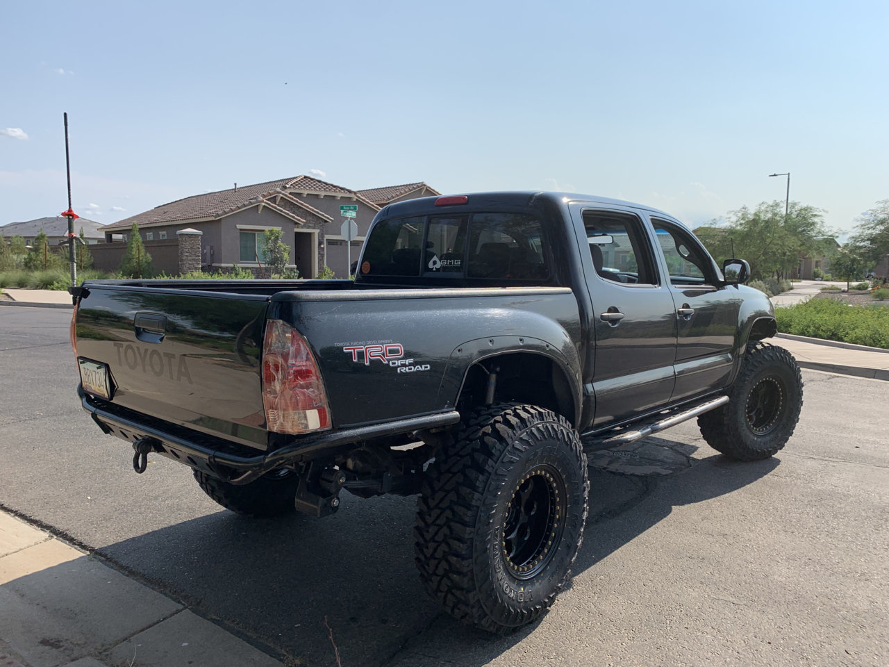

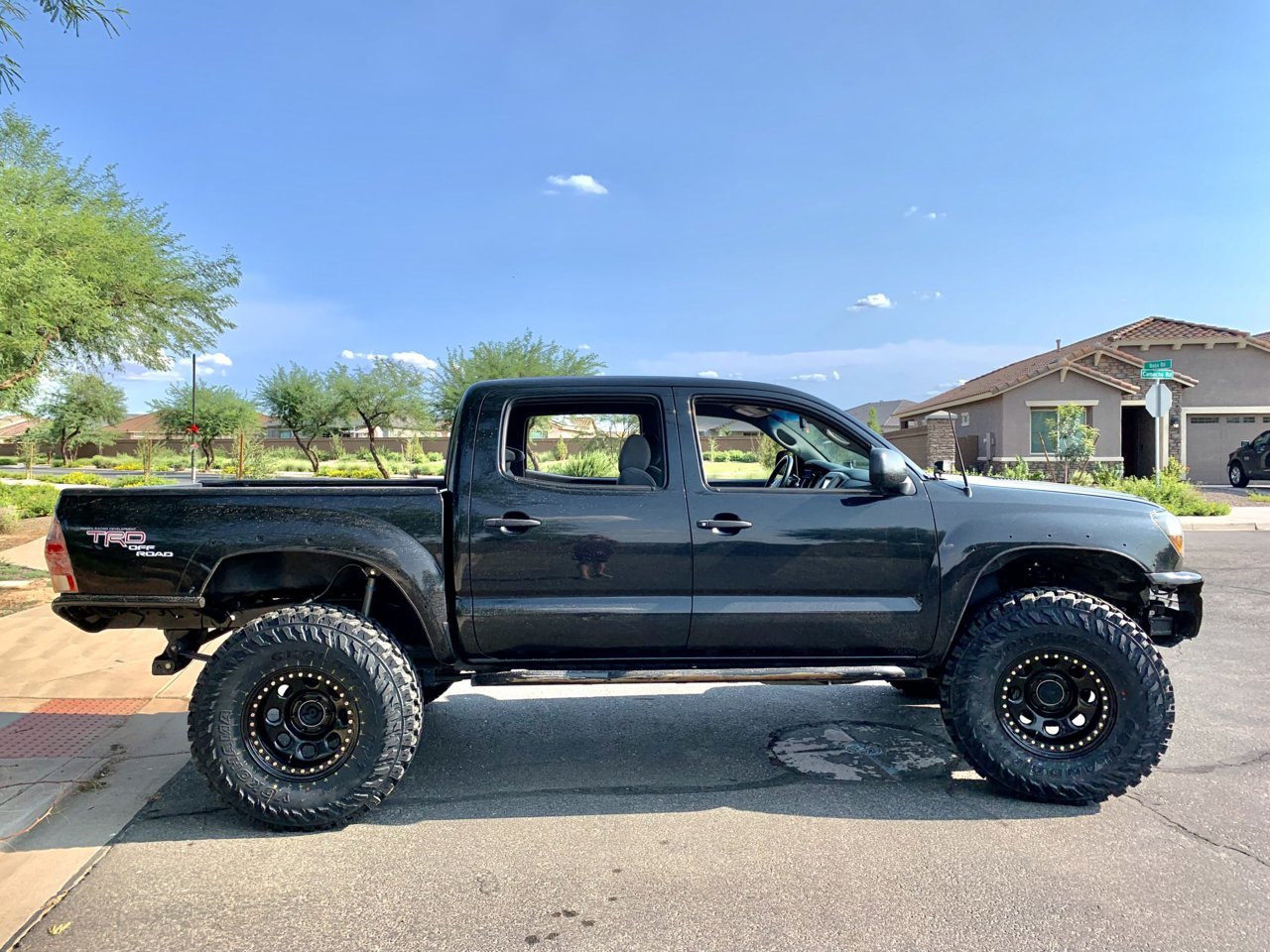

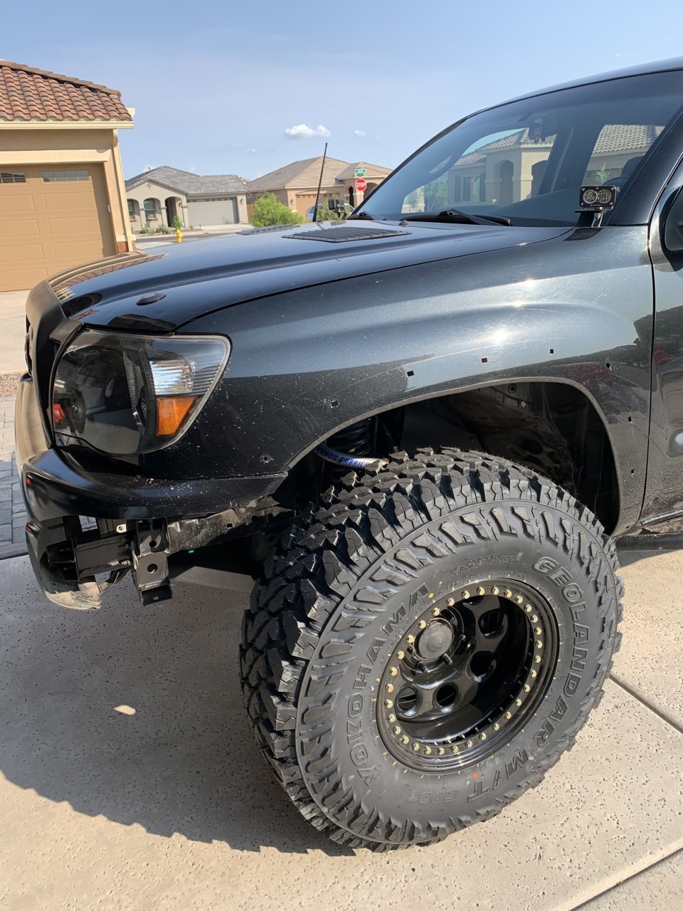

    Hmmmmm lots to do. Driveway pics for now

  12. Aug 22, 2021 at 6:37 PM
    #492
    DLRIII
    DLRIII Well-Known Member
    Feb 27, 2018
    #245744
    1,977
    David
    Baton Rouge
    2018 Quicksand SR5 DCSB V6
    I really like the cuts you made to the stock bumper cover. Those 05-11 front ends aren't my favorite to be honest when compared to the 12-15 but the cuts you made make it look way less chunky and more aggressive which suits the rest of your set up well.
  13. Aug 22, 2021 at 7:07 PM
    #493
    singletrack_ftw
    Aug 27, 2017
    #228223
    3,685
    Tyler
    AZ
    ‘08 TRD OR 4wd
    It’s all temporary but yes thank you, those sections kept getting banged up so I just trimmed them. I love the 05-11 because they have a simple and almost retro look to them. 12-15 tacomas still look relevant and not dated at all

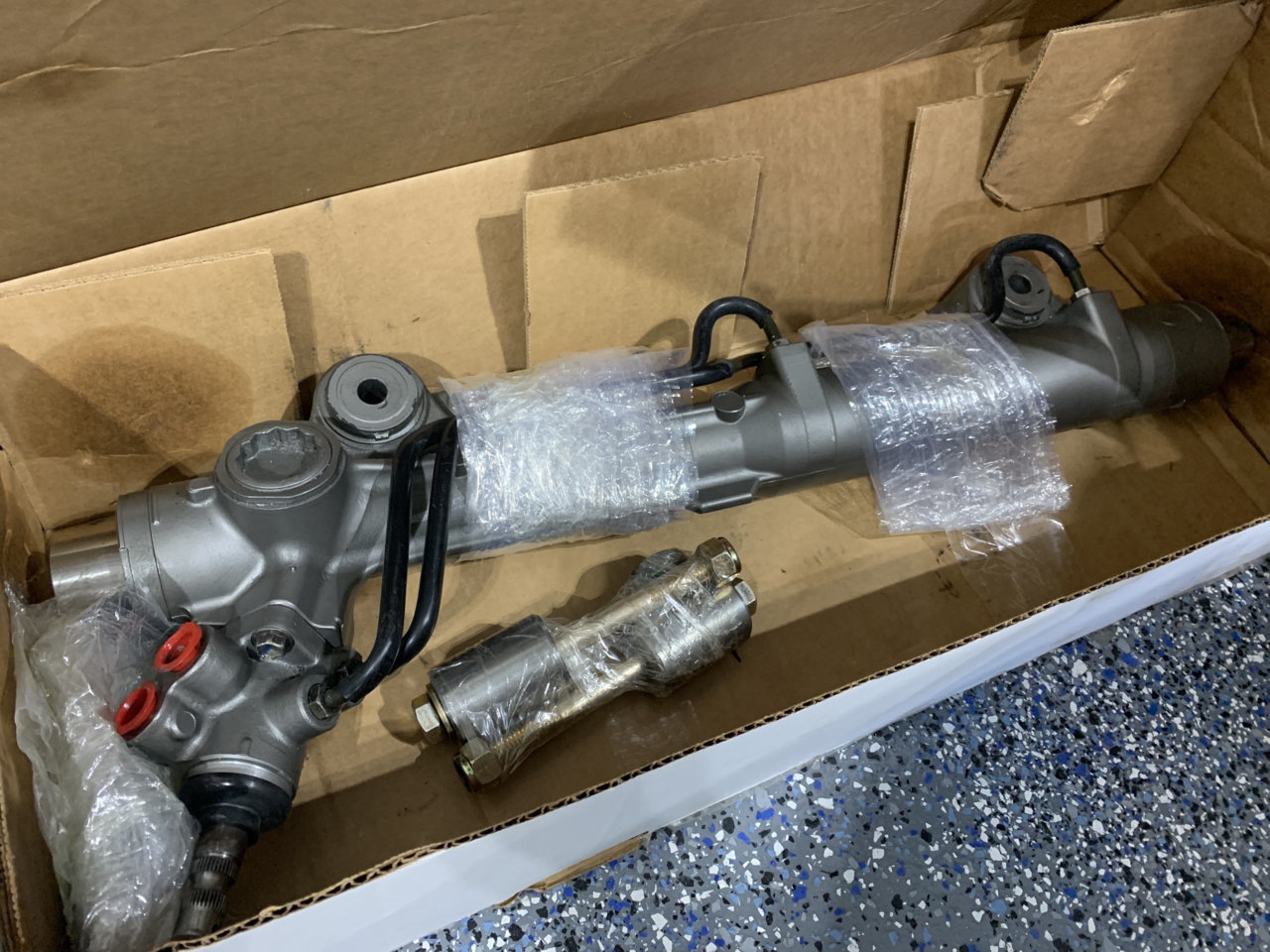

  16. Aug 26, 2021 at 11:03 AM
    #496
    crashngiggles
    crashngiggles Tacomaworld's Resident Psych Dr.
    May 17, 2015
    #155446
    7,469
    Jared
    Wilbraham, Massachusetts
    2013 MGM TRD 4x4 DCLB Trail Limo
    How much modification is necessary to shove that beast in our tacos?
  17. Aug 26, 2021 at 11:08 AM
    #497
    DLRIII
    Feb 27, 2018
    #245744
    1,977
    David
    Baton Rouge
    There's a thread around here where a guy explains it, but basically you have to remove the old rack, plasma cut out the mounting points for it that sit in the cross member, cut holes and weld in new mounting points for the tundra rack, and shorten the shafts on either end by an inch or so. Apparently there is just barely enough space for it to fit, especially if you have 4wd and therefore a front differential.
    crashngiggles[QUOTED] likes this.
  18. Aug 26, 2021 at 11:52 AM
    #498
    singletrack_ftw
    Aug 27, 2017
    #228223
    3,685
    Tyler
    AZ
    ‘08 TRD OR 4wd
    Option #1 @Basikbiker sells you a modified tundra rack for $1350
    option #2 solomotorsports sells you a modified tundra rack for $1650
    Both options require removal of mounting bung sleeves IN THE FRAME & moving each of them outboard 1/2”. Then the intermediate steering shaft (lower section) has to be shortened by about 1”
