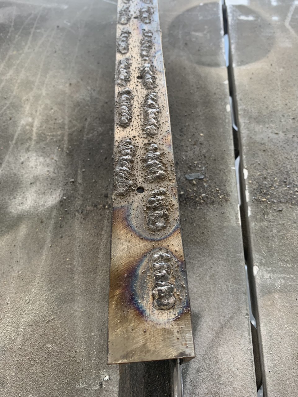

    https://www.tacomaworld.com/threads/singletrack’s-‘dad-shred-build-thread’-i’m-just-doing-it-for-the-kids.619250/ Sos offroad sliders (kickout + filler) Sos offroad full belly skids (steel) Sos offroad front recovery point Sos offroad concepts HC rear bumper with bedside kickout tubes Marlin Crawler LCA frame brace kit Trail Gear rear diff cover Bilstein 5100 + OME 885 Total Chaos UCA BILSTEIN b110 OME Dakar standard pack Wheelers Ubolt flip kit Wheelers Superbump f/r Wheelers SS extended brake lines FN five star 16x8 -25 Milestar Patagonia MT 315/75r16 Custom projector retrofit (acme super h1 + morimoto 4300k) Baja Designs S2 sport ditch pods on CBI ditch pod mounts Amazon AMAK rock lights CMC CB radio hardmount

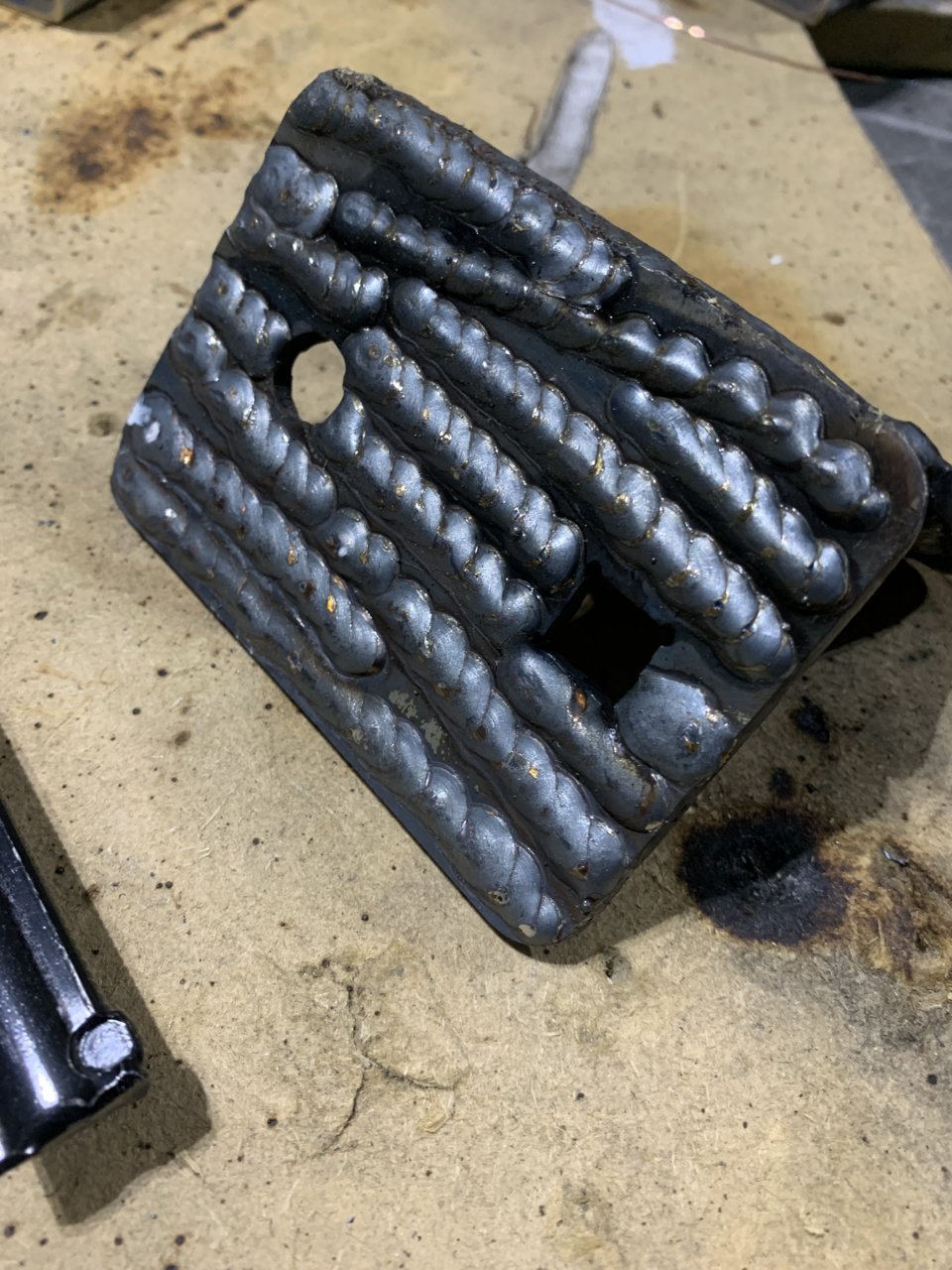

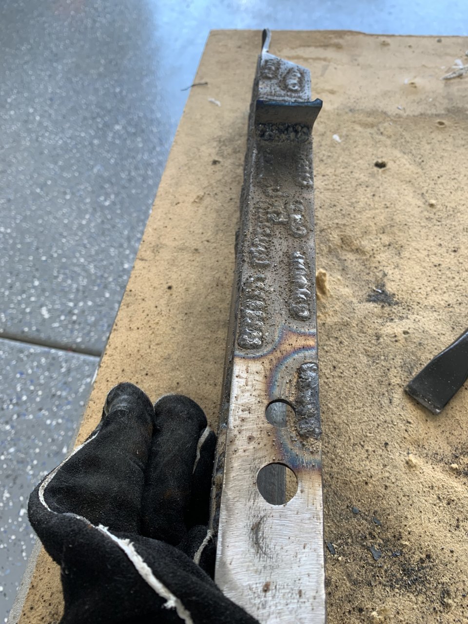

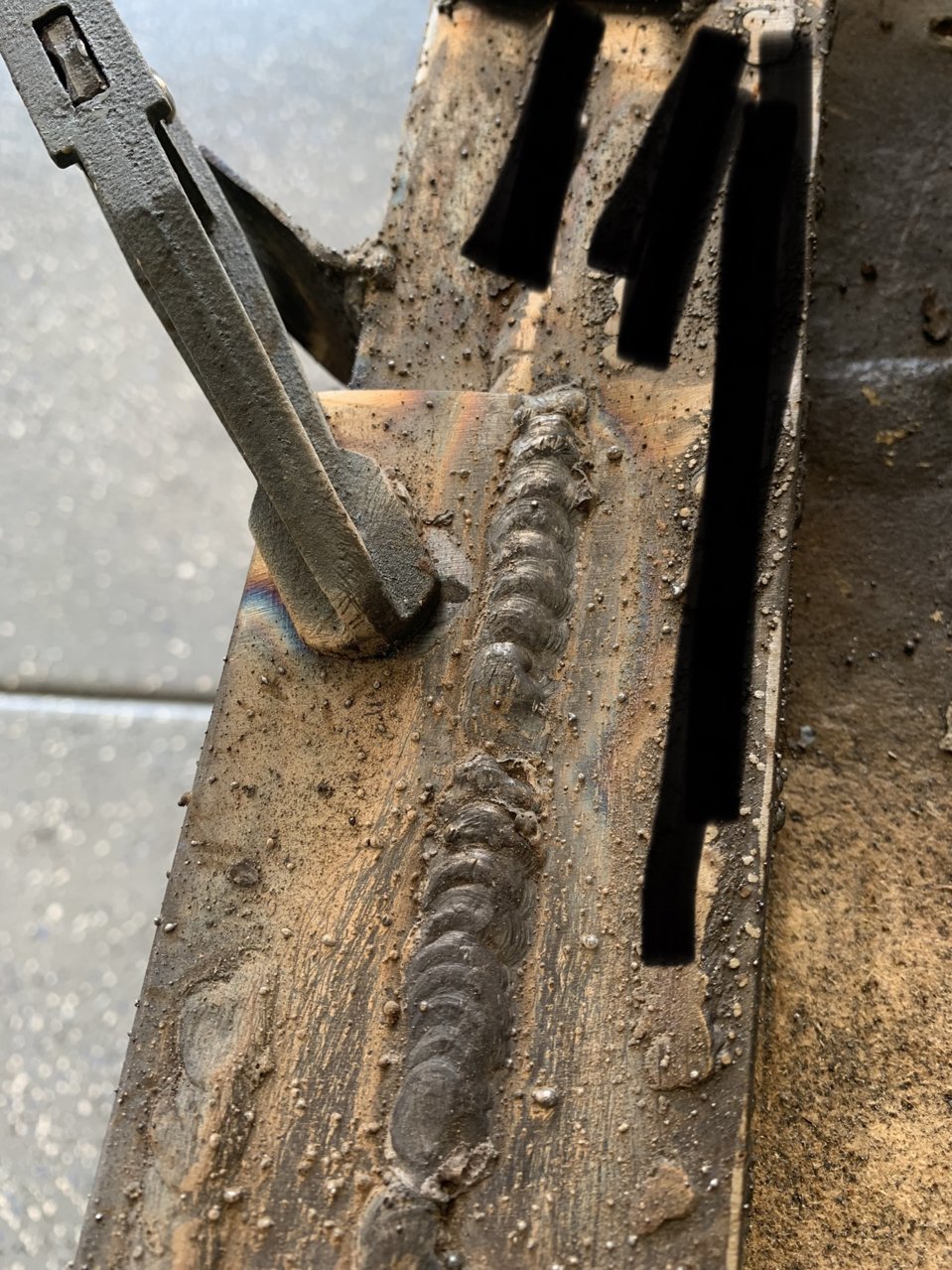

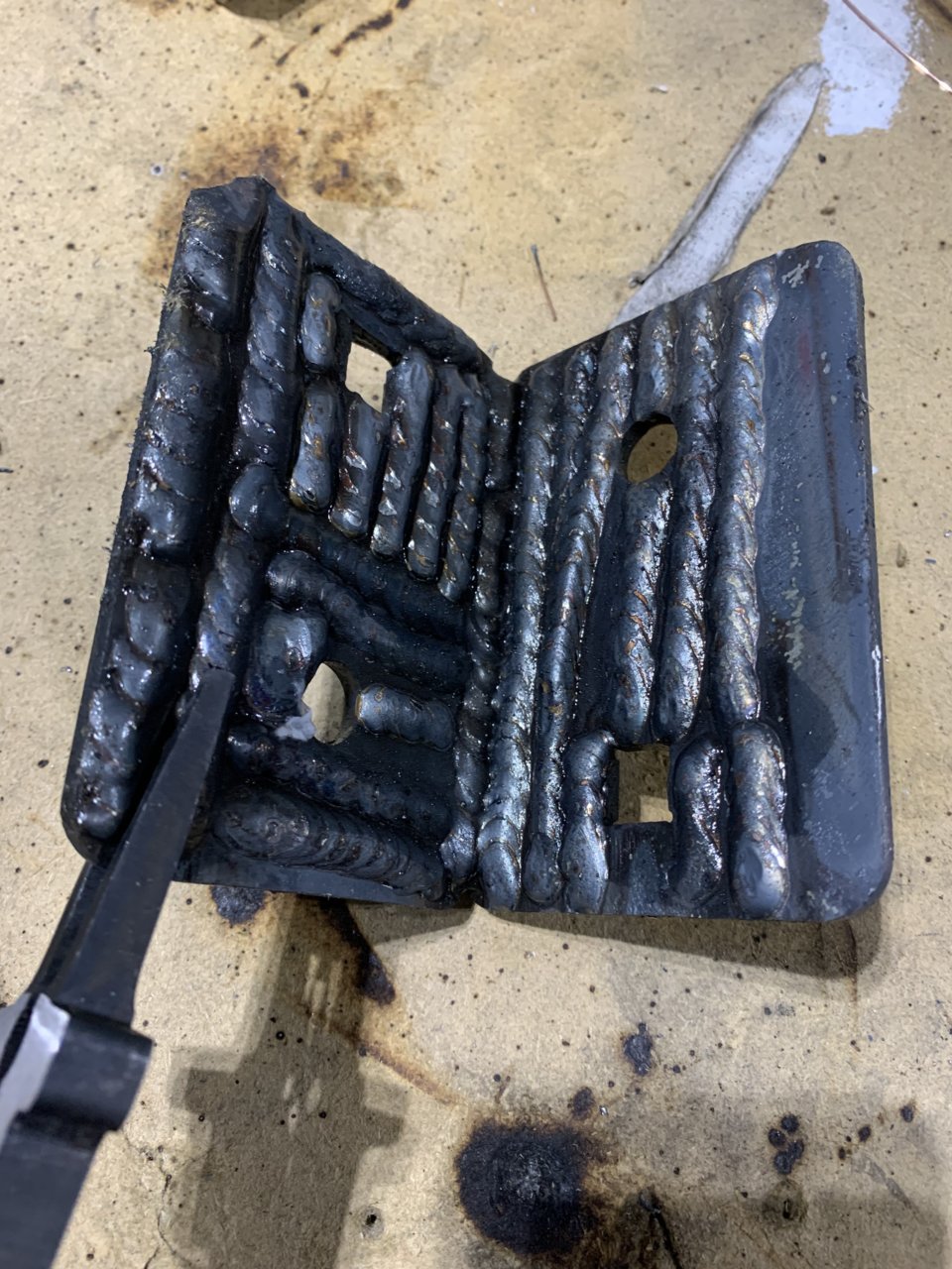

    Couldn’t get my hands on any gas so here is my very first beads with flux core .030 wire. Wow this is fun. I need a slag hammer.

    So you where forced to use flux after all. lol
    I'm not a welder but pretend to be in my garage. My first ever welding was sheet metal work when I tubbed my rig. I borrowed my buddies hobby wedler. That was with .035 flux. It sucked and I pretty much just used 1000 little tacks. I was sure I was the shittiest welder on the planet.
    After that I decided to invest in a 220V/180A Mig welder with shielding gas. I had some more sheet metal work to do and got .023 wire on the advice of a buddy. With the gas and thinner wire welding sheet metal became way easier. I still sucked but the proper set-up made it look like I sucked a lot less. Since then I've welded a bunch of other shit on my rig. I've never once thought about breaking out flux core in the garage.
    For the field I have a battery weld kit that I threw together. With 2 batteries and 3/32" 6011 rod it's taken care of more then a few trail repairs that otherwise would have left the vehicle on the trail until parts could be gathered.
    I do agree that melting two pieces of metal together is fun shit. lol

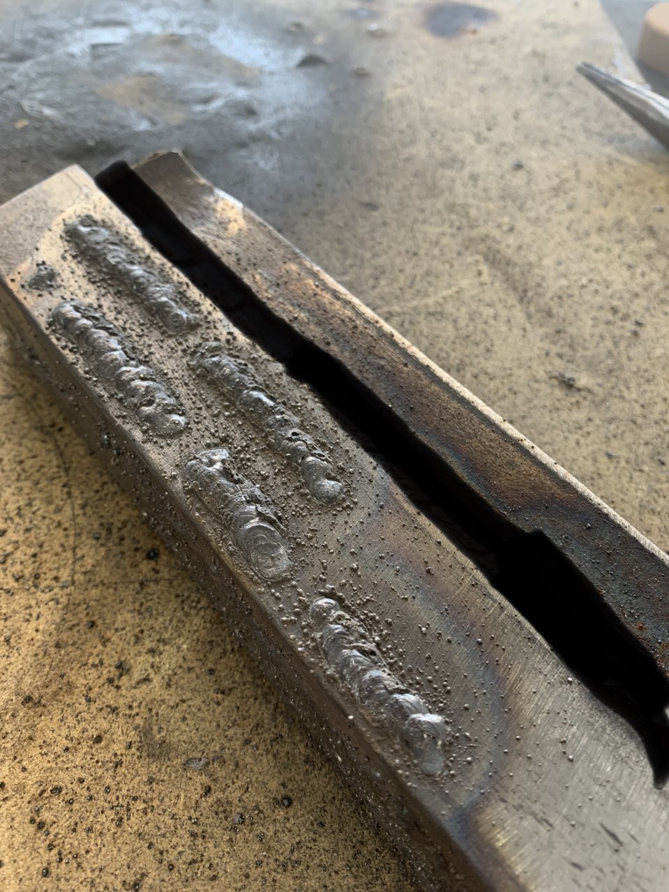

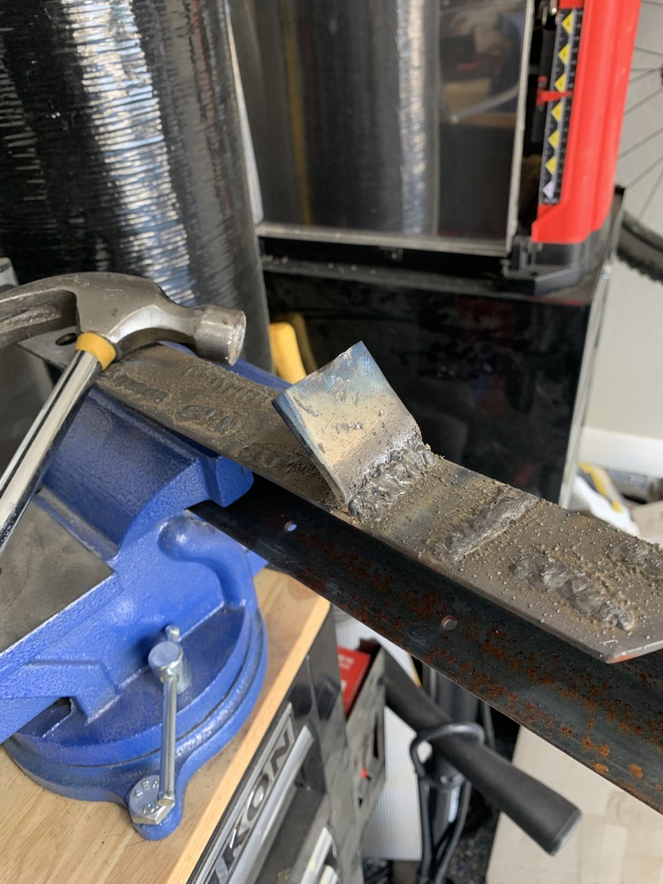

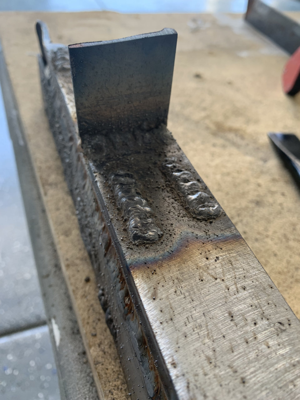

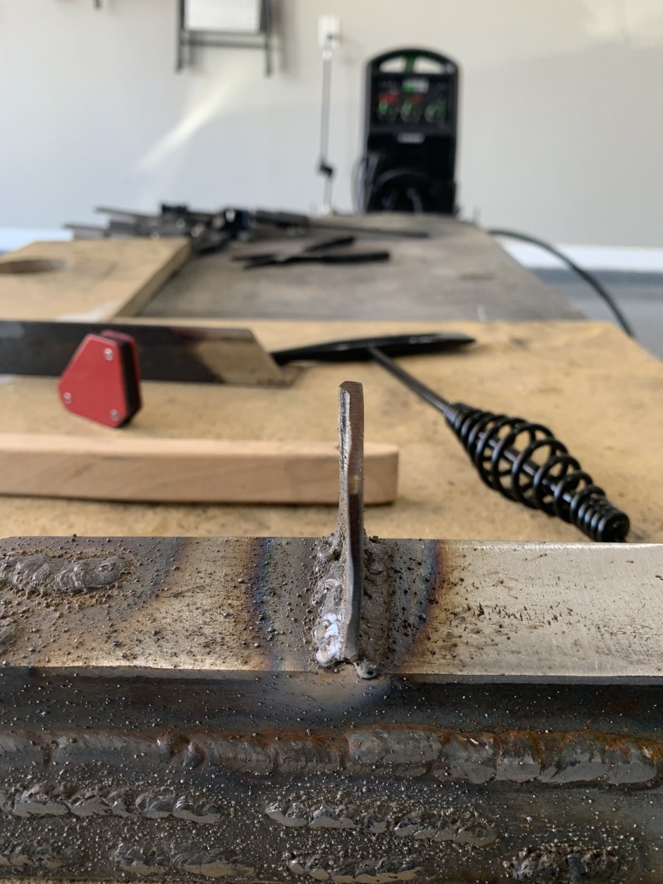

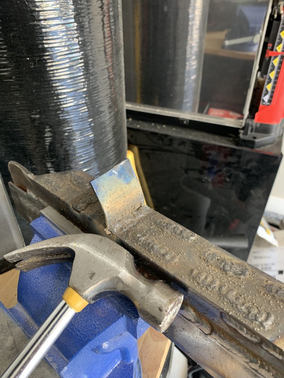

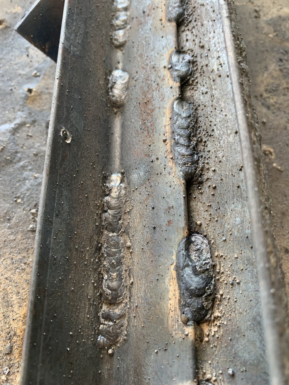

    Did a hammer test after welding up a t joint, really gave it some good force bending it both ways, no cracks or failures. LOTS of practice ahead of me and hopefully gas soon

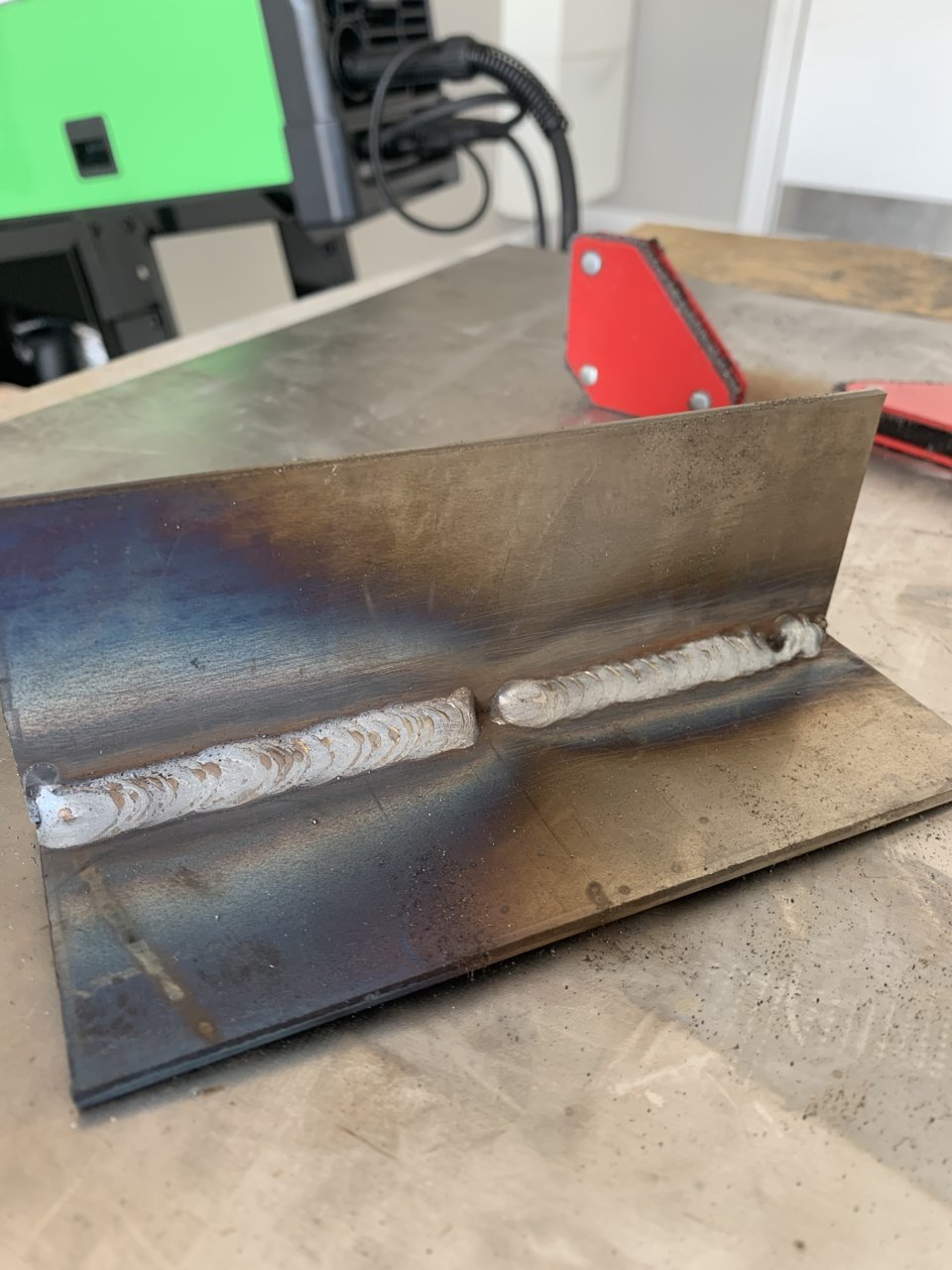

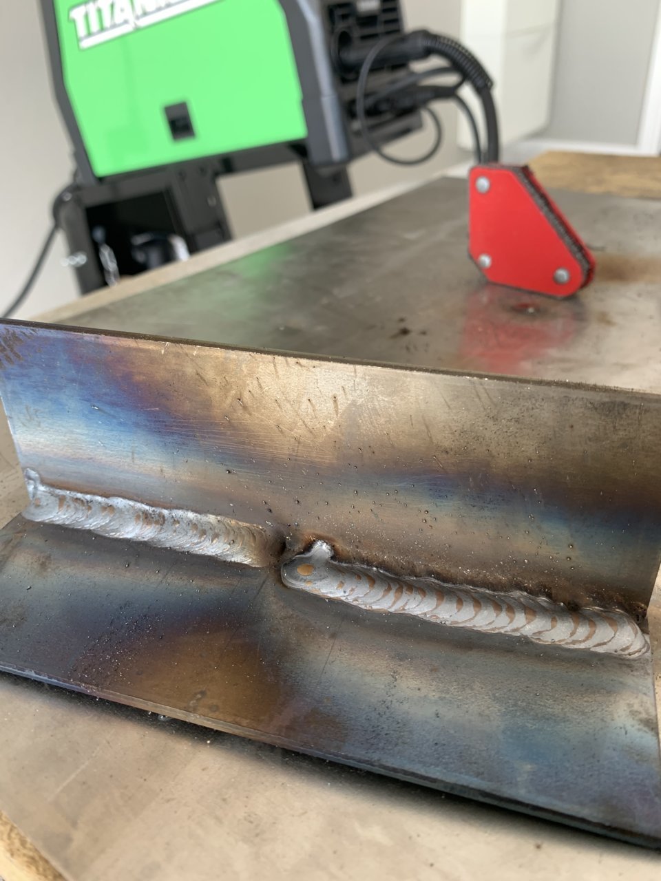

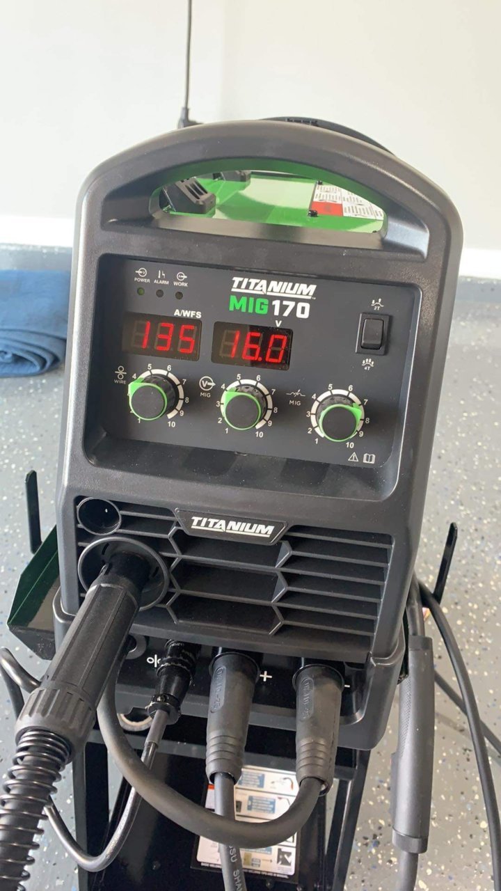

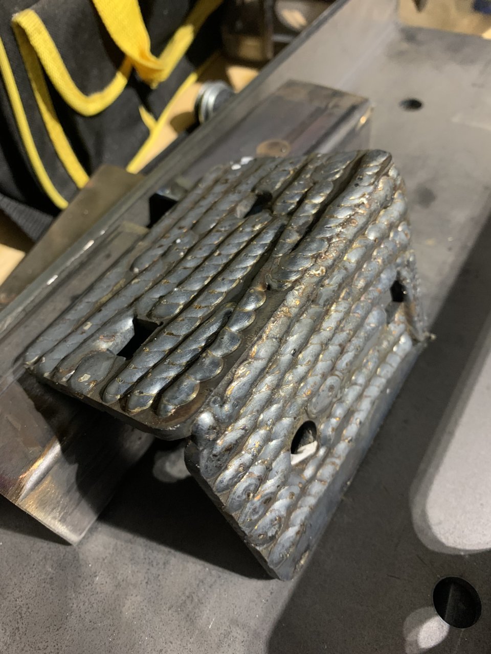

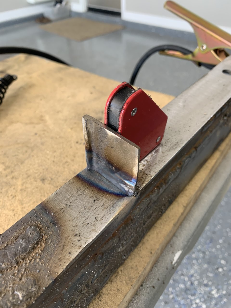

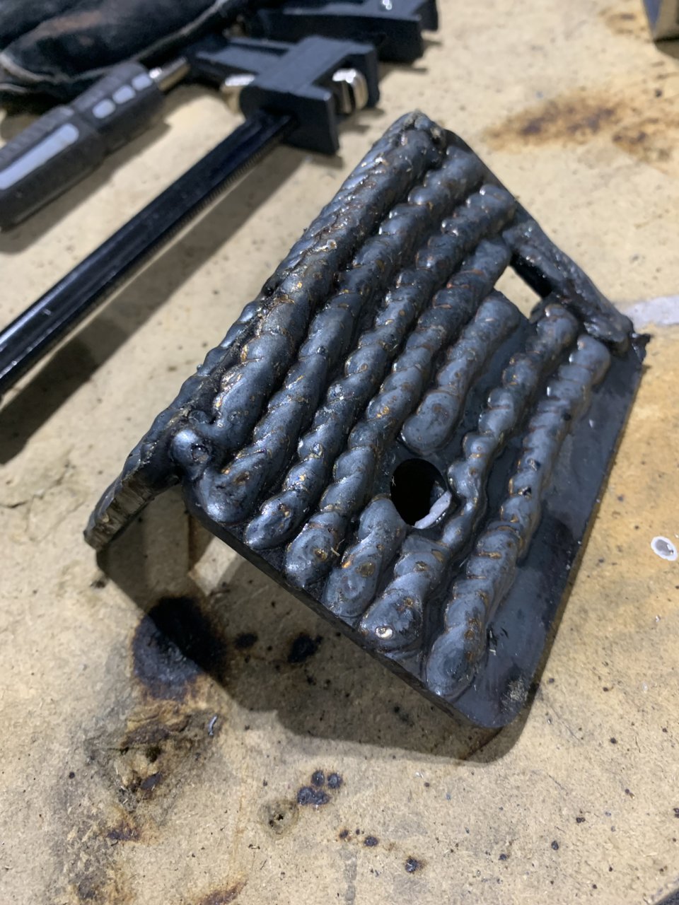

    Boy oh boy were my settings jacked up yesterday. I used the chart for 14ga but this is 1/8” material. What a difference proper settings make. A ton more wire speed and a little bit more voltage! I’m so hooked. Here are day #2 welds! All of this just flux core .030 wire on short circuit 110

    Practice practice practice. The chart is a good starting point for sure. I know with my technique I tend to run a little colder and slower wire speed than the chart says most of the time. Not sure if it’s because I’m running off 220 or because I move the gun slower but it works and parts definitely get enough heat

    Heck yes love that. Will probably give that a try. I am enjoying this so much

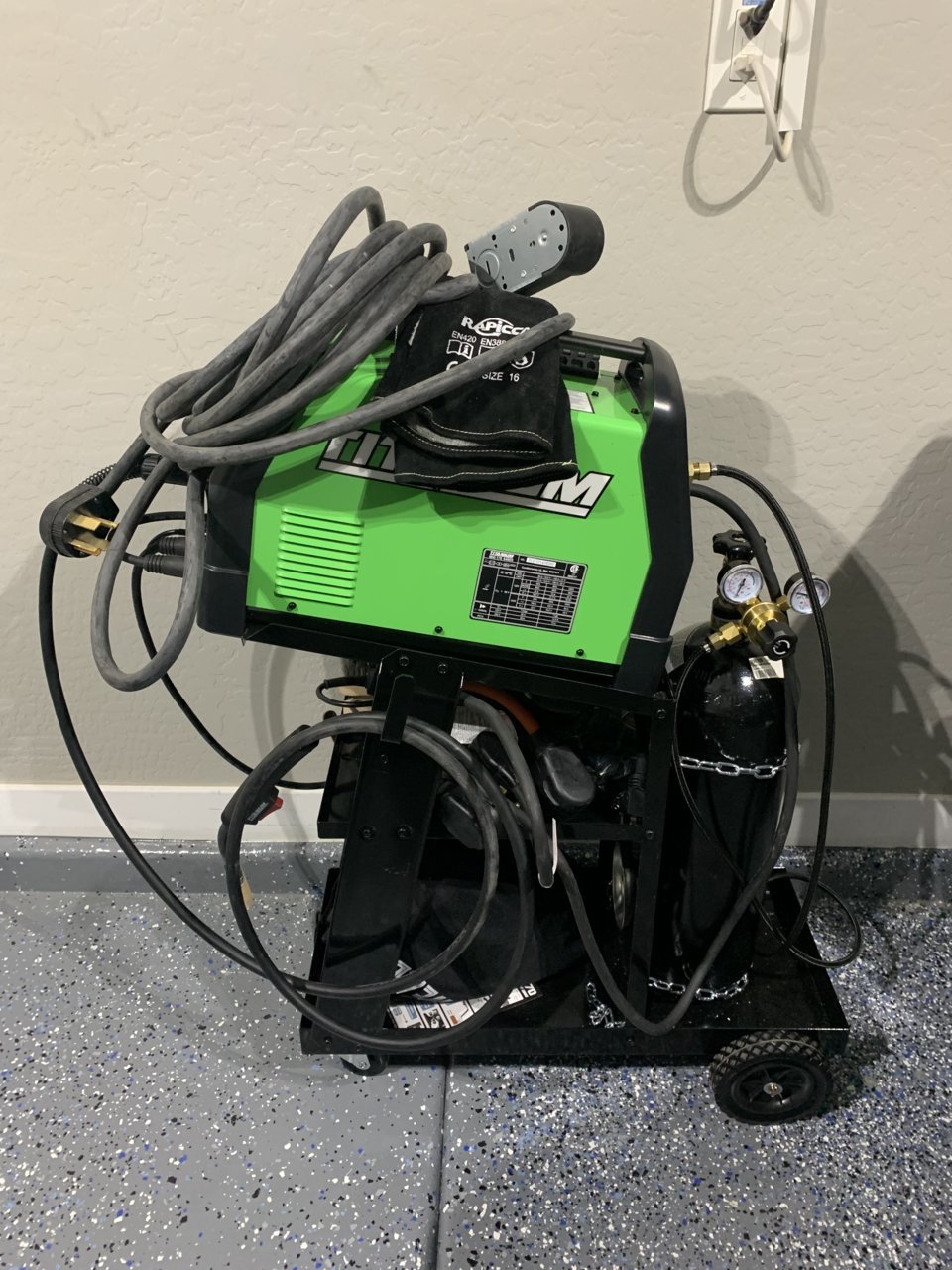

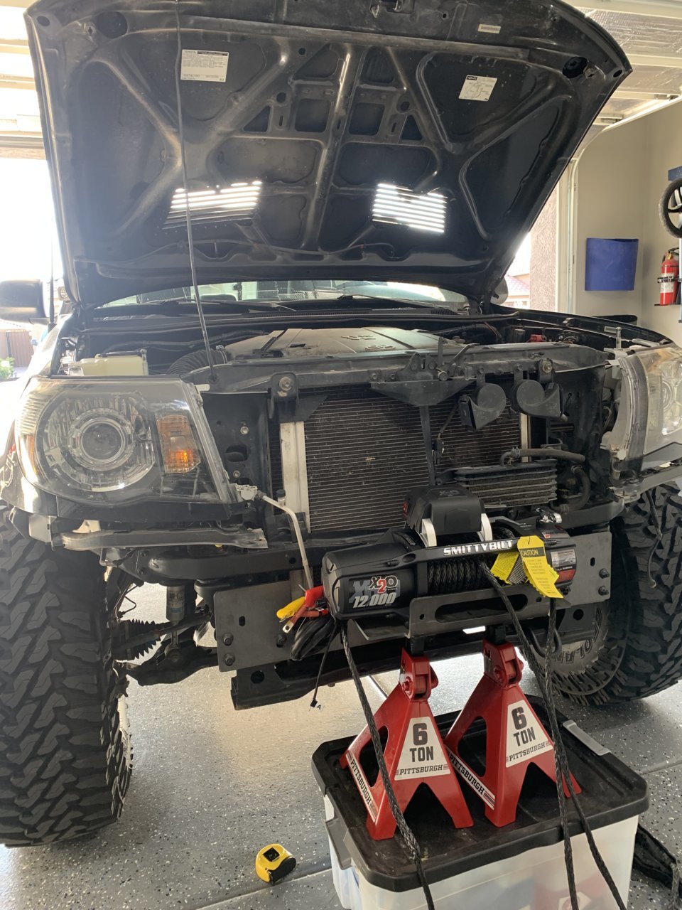

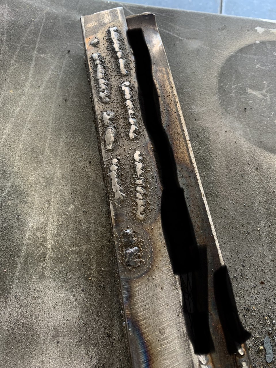

    Boys, we are cookin with fire now! I got a tank of gas for welding. Day #3 picking up the gun went really well. Can’t wait to weld up my @WarFab Armor front chop kit/winch tray. I mocked it up & im happy to cut into my grill if needed for the control box. Here are how the welds went. Harbor freight titanium mig 170! What a sweet little setup this is. No complaints other than the ground clamp a little more to be desired there. Even before I chop the low hanging crossmember this winch will be ultra tucked up front. Super stoked
    240v extension cord to dryer
    030 solid wire
    C25 argon gas running about 20cfh
    Whatever recommendations on the welder were for 3/16 steel I used but I slowed down the wire speed just a hair. Man this is a blast.

    Get to it! @Sixthelement and I will be taking notes as we plan his front chop kit and new bumper build for next month

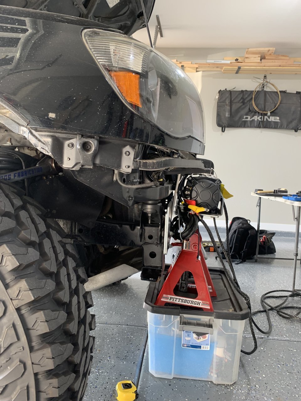

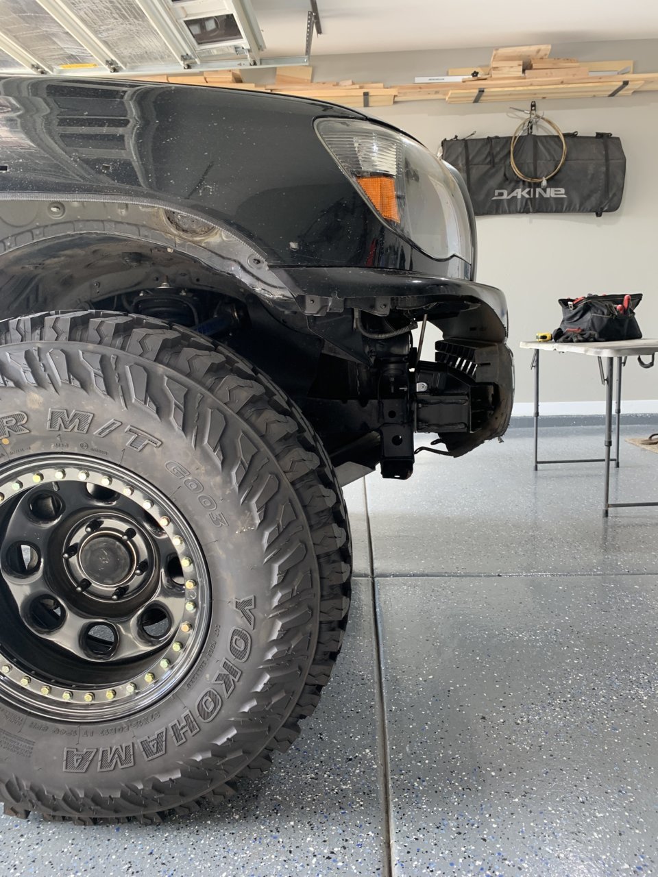

    Current situ :rofl: be patient w me

  16. Sep 12, 2021 at 8:24 AM
    #536
    Maxx
    Maxx Well-Known Member
    Dec 30, 2012
    #94017
    1,397
    Sweet minimalist bumper. Lol

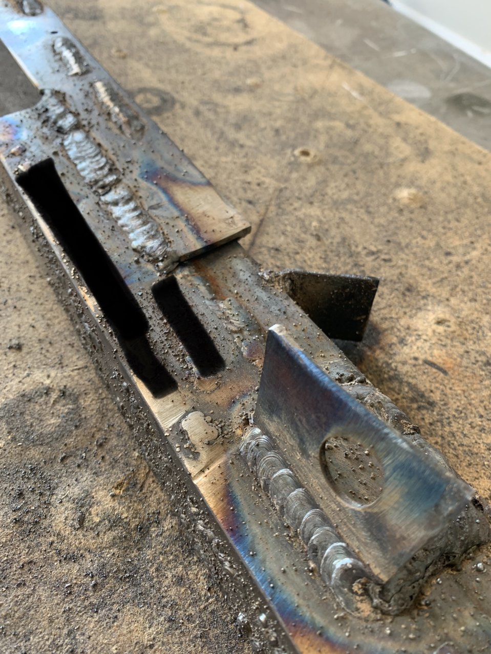

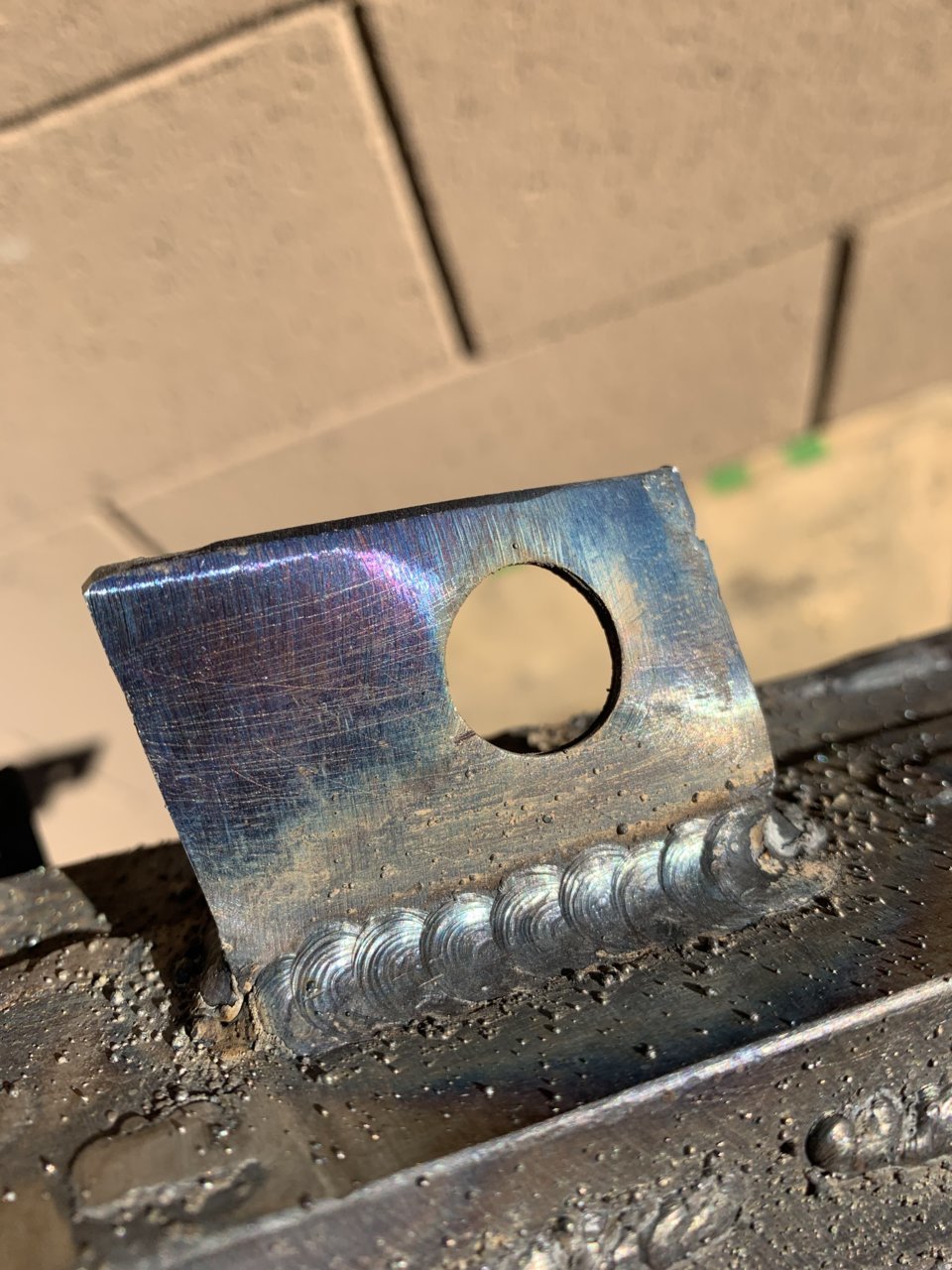

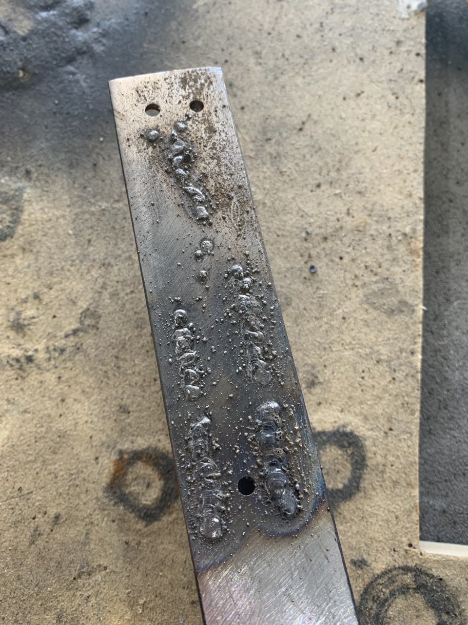

    More practice, focusing on tighter “e’s” and flatter / more penetration. CANT WAIT TO START WORKING ON MY WINCH TRAY

    LOVE to see the progression!!! nice work!

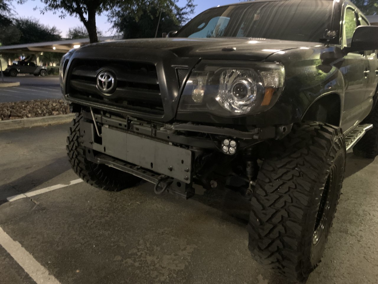

    Pretty cool difference between my stock SOS offroad concepts skid and the @WarFab Armor chop kit skid. So much more aggressive approach angle. Higher and tighter
