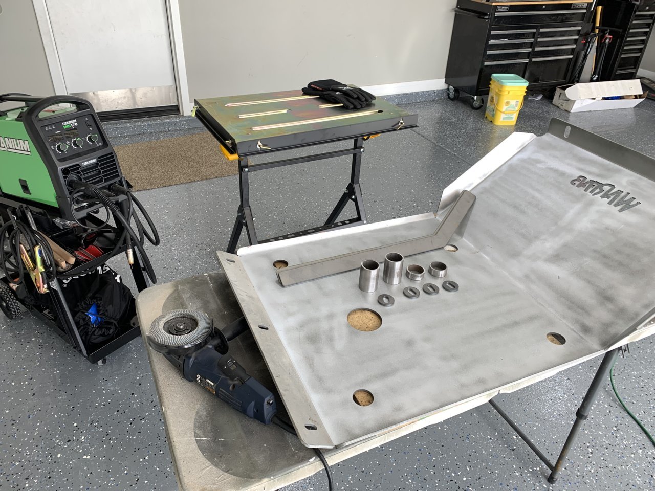

  5. Sep 18, 2021 at 10:22 PM
    #545
    singletrack_ftw
    singletrack_ftw [OP] “I chopped the wrong leaf!”
    Aug 27, 2017
    #228223
    3,685
    Tyler
    AZ
    ‘08 TRD OR 4wd
    https://www.tacomaworld.com/threads/singletrack’s-‘dad-shred-build-thread’-i’m-just-doing-it-for-the-kids.619250/ Sos offroad sliders (kickout + filler) Sos offroad full belly skids (steel) Sos offroad front recovery point Sos offroad concepts HC rear bumper with bedside kickout tubes Marlin Crawler LCA frame brace kit Trail Gear rear diff cover Bilstein 5100 + OME 885 Total Chaos UCA BILSTEIN b110 OME Dakar standard pack Wheelers Ubolt flip kit Wheelers Superbump f/r Wheelers SS extended brake lines FN five star 16x8 -25 Milestar Patagonia MT 315/75r16 Custom projector retrofit (acme super h1 + morimoto 4300k) Baja Designs S2 sport ditch pods on CBI ditch pod mounts Amazon AMAK rock lights CMC CB radio hardmount

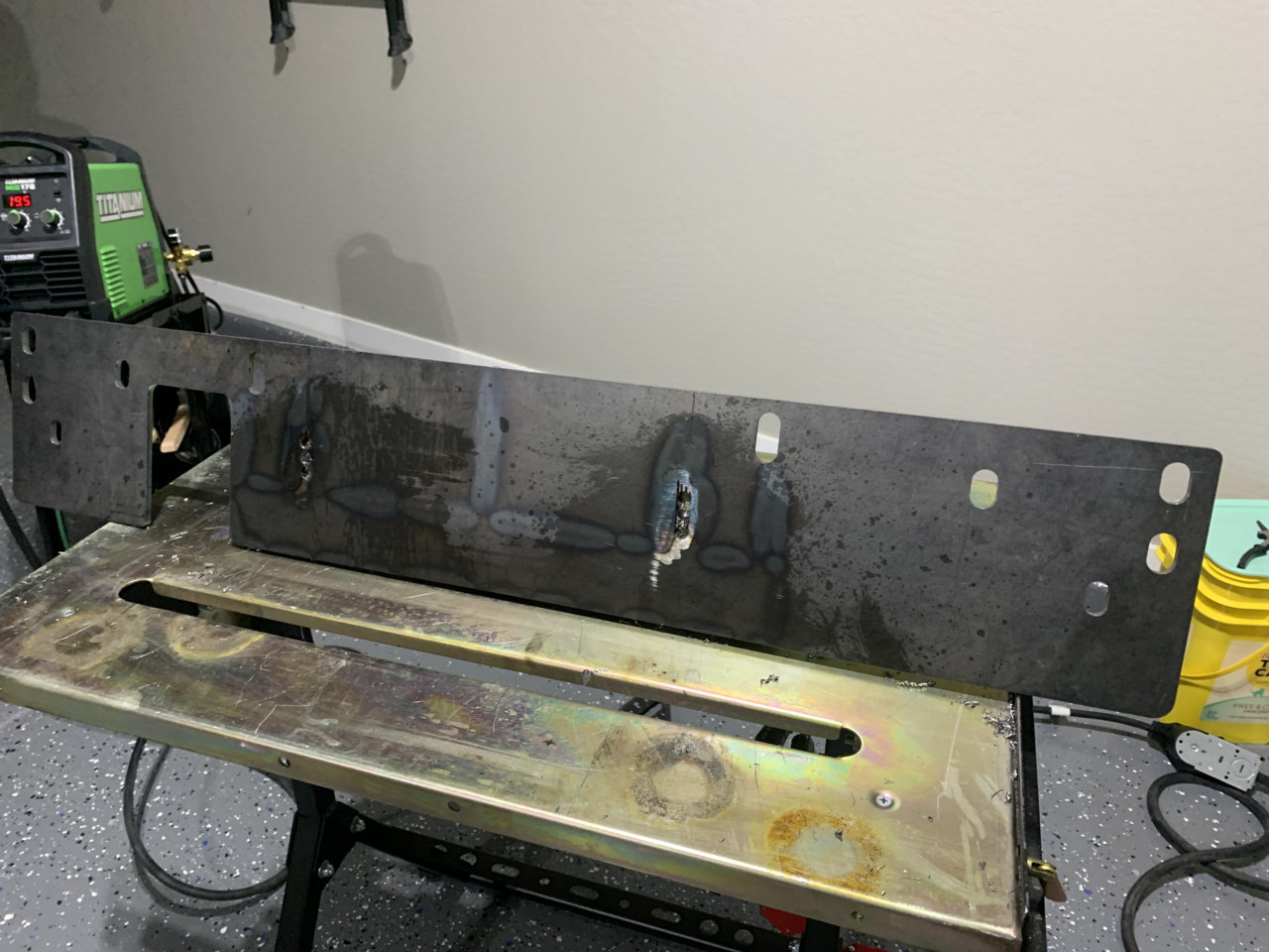

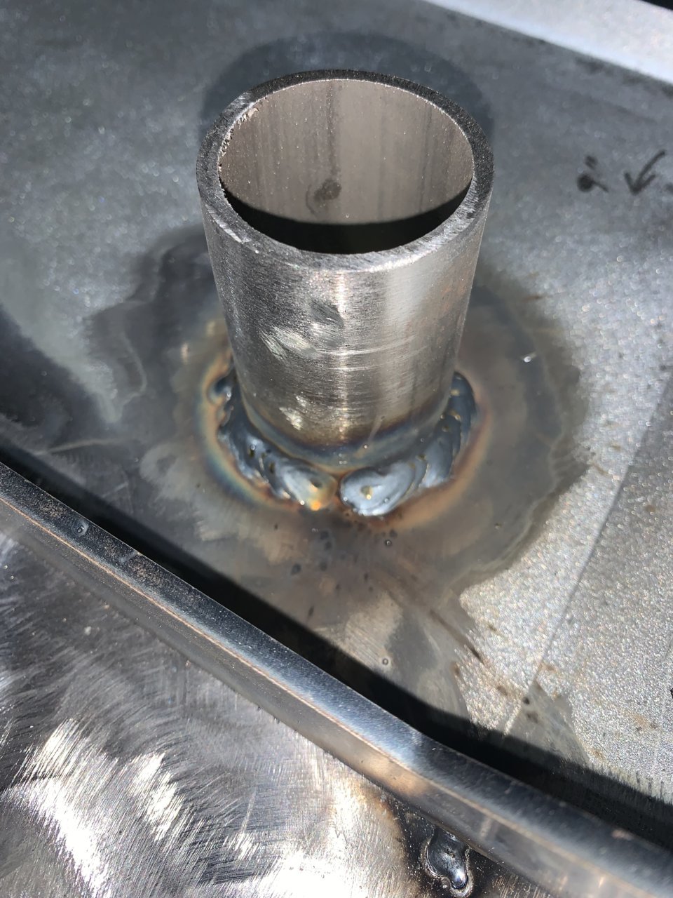

    Wowwwww. Welding is so much fun, I am so stoked on it. Learning a ton, working on my warfab kit. Absolutely LOVING this $60 welding table. It’s adjustable and really solid. Also I’m never pre painting anything again before welding. What a pita

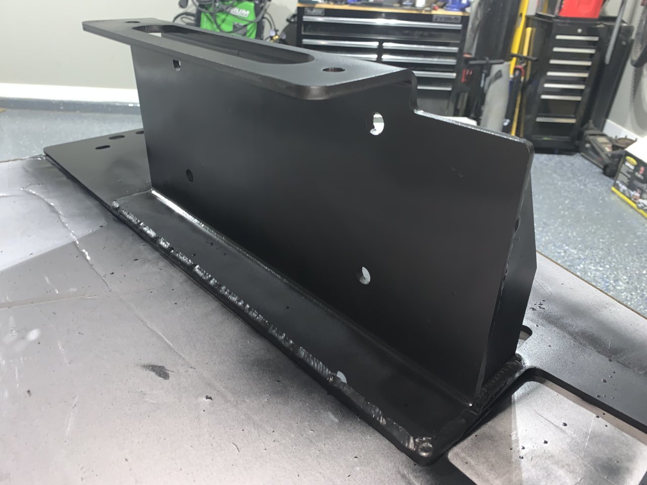

  12. Sep 20, 2021 at 1:49 PM
    #552
    singletrack_ftw
    Aug 27, 2017
    #228223
    3,685
    Tyler
    AZ
    ‘08 TRD OR 4wd

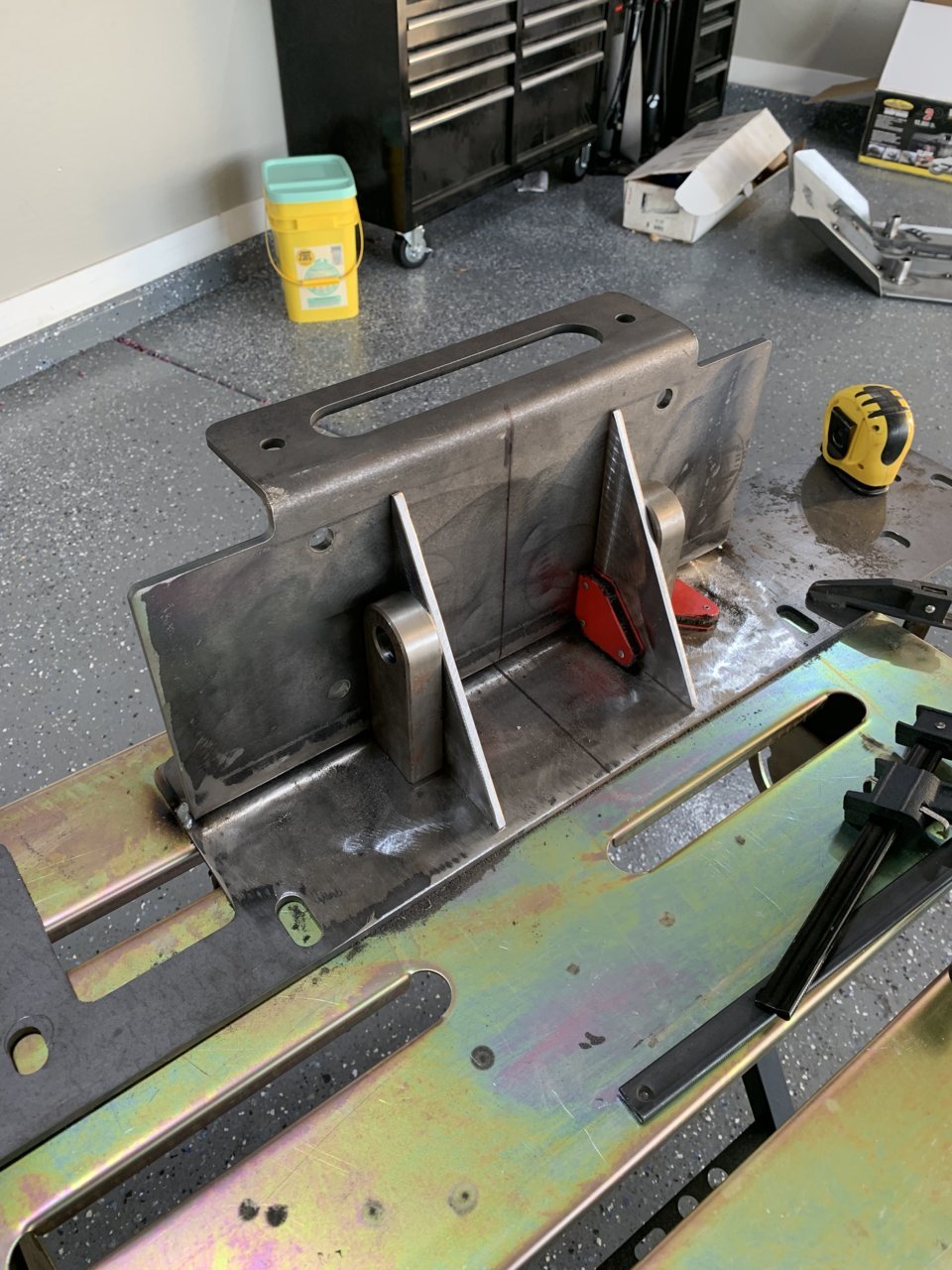

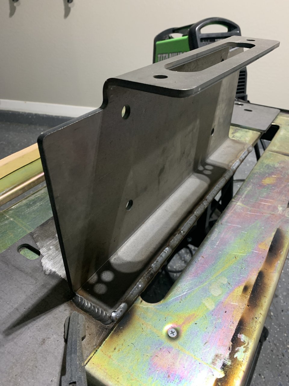

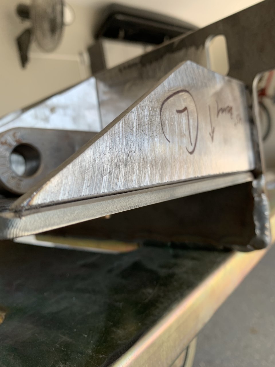

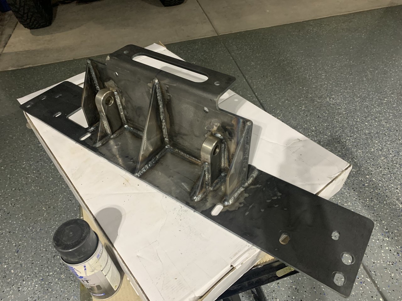

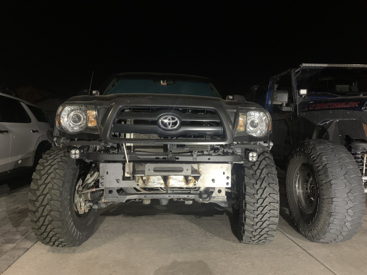

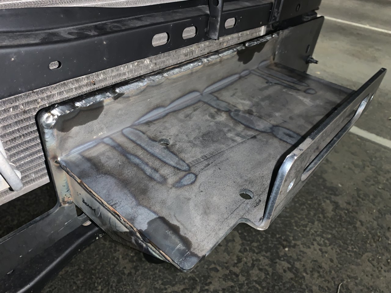

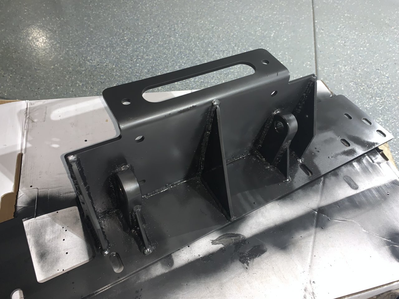

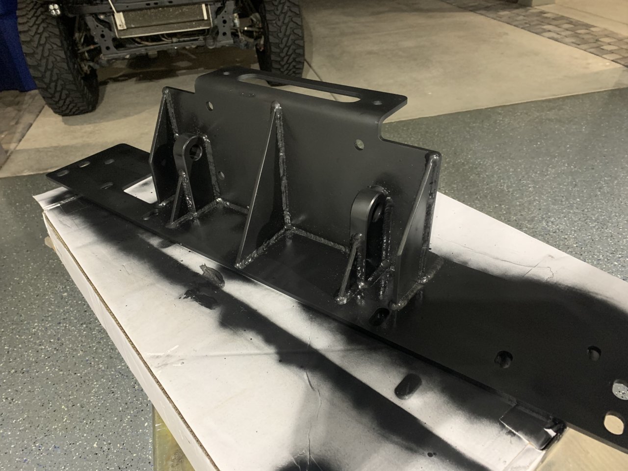

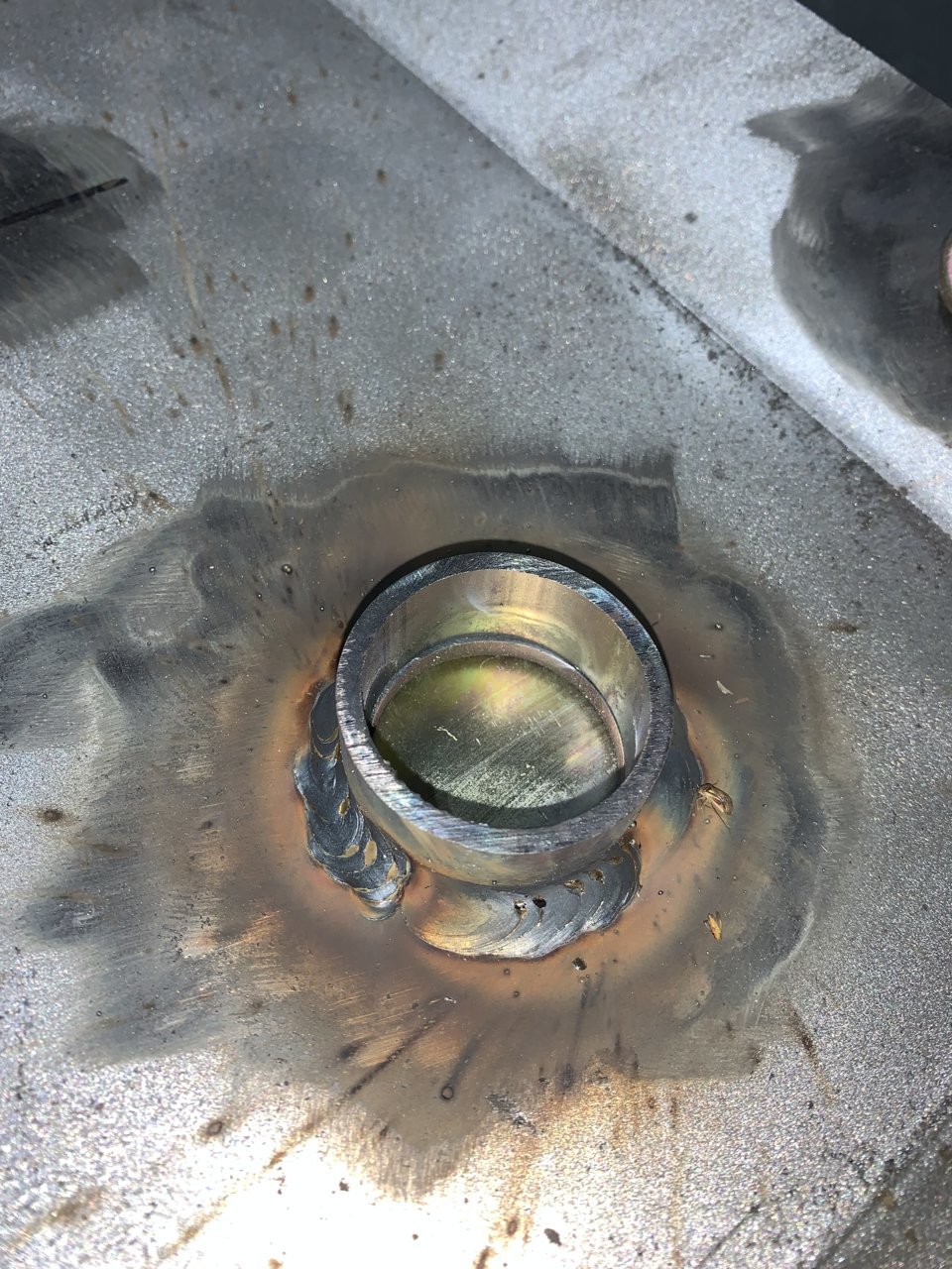

    Finished welding up my 1/4” winch tray with 1/4” gussets & fancy clevices from ballistic fabrication. I wish I took a little more time with some of the welds but overall it looks really solid. I’m going to chop my crossmember next and really get a nicely tucked front end. It’s 29” from ground to winch tray which is pretty sick. Will be cleaning it up a little and painting it ASAP. Also I drilled 3 holes behind each clevice and drilled into the clevice a little bit & plug welded the clevice from the backside - which should help provide a good amount of strength to those pieces. I won’t be able to do bar/tube work for a while so this will be “my bumper” for a bit. I can’t wait to tuck the front crossmember next. Gonna be such a rad improvement. Did some beveling on the joints where there was no gap to help penetration

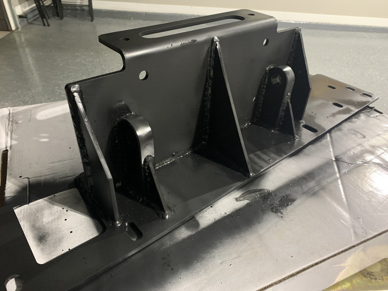

  13. Sep 21, 2021 at 4:45 AM
    #553
    singletrack_ftw
    Aug 27, 2017
    #228223
    3,685
    Tyler
    AZ
    ‘08 TRD OR 4wd

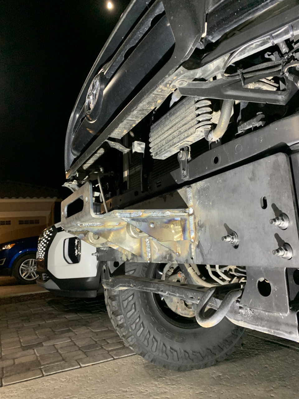

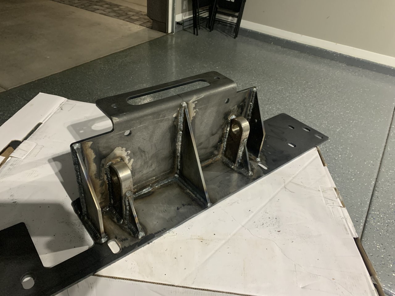

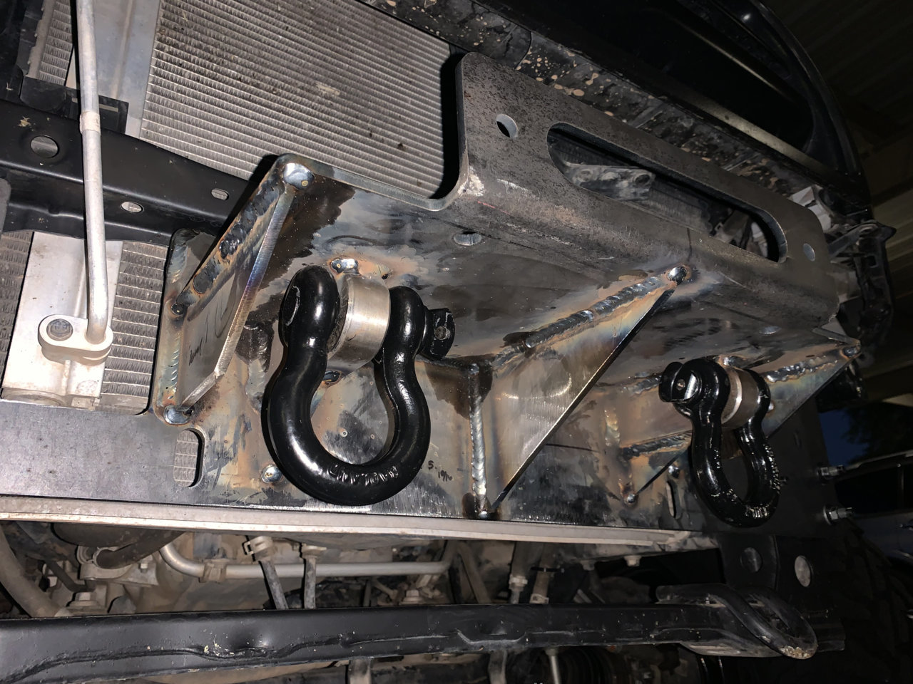

    Here are some better pics, threw some steel it on there last night
    y=mx+b, T.Barn, Cred92 and 9 others like this.

    Didn't take you long to learn how to weld.
    Looks :benchpress:

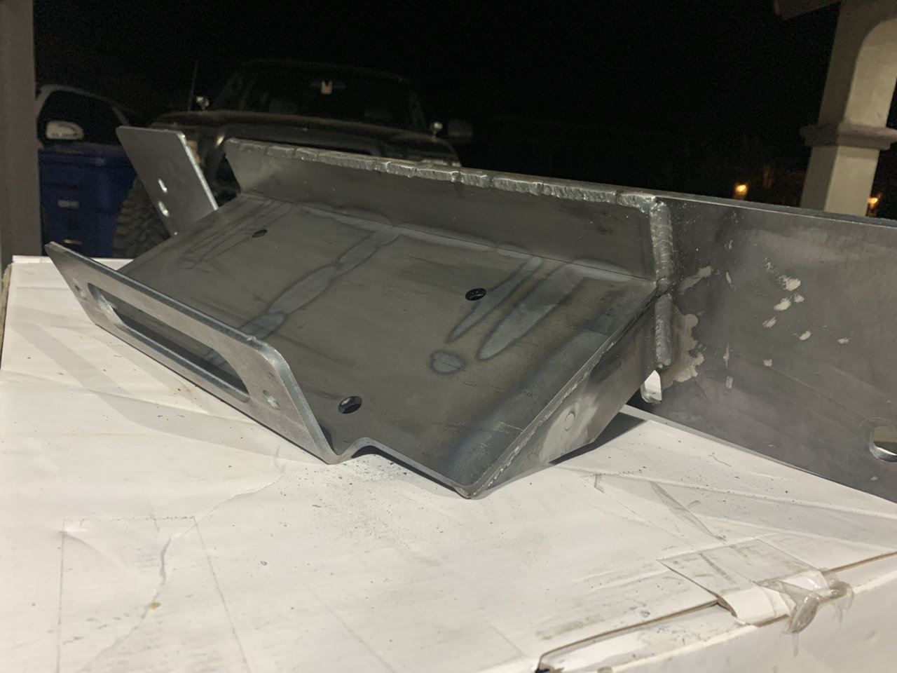

  16. Sep 22, 2021 at 5:51 PM
    #556
    singletrack_ftw
    Aug 27, 2017
    #228223
    3,685
    Tyler
    AZ
    ‘08 TRD OR 4wd

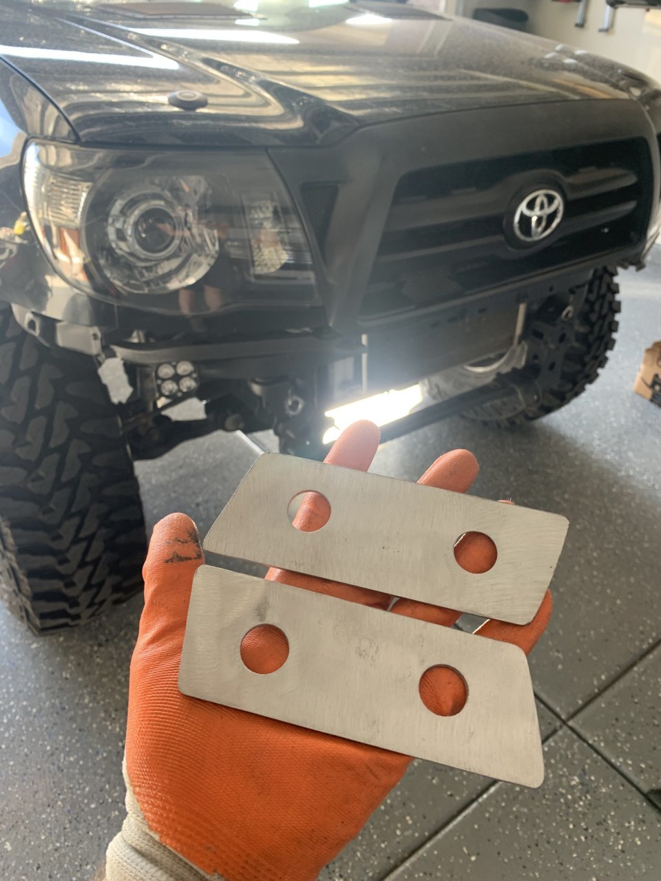

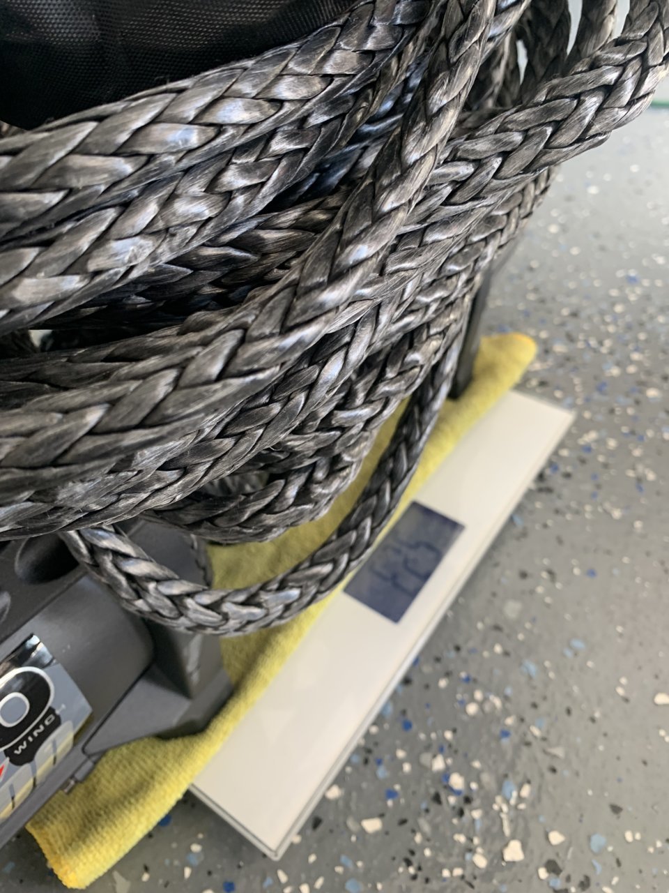

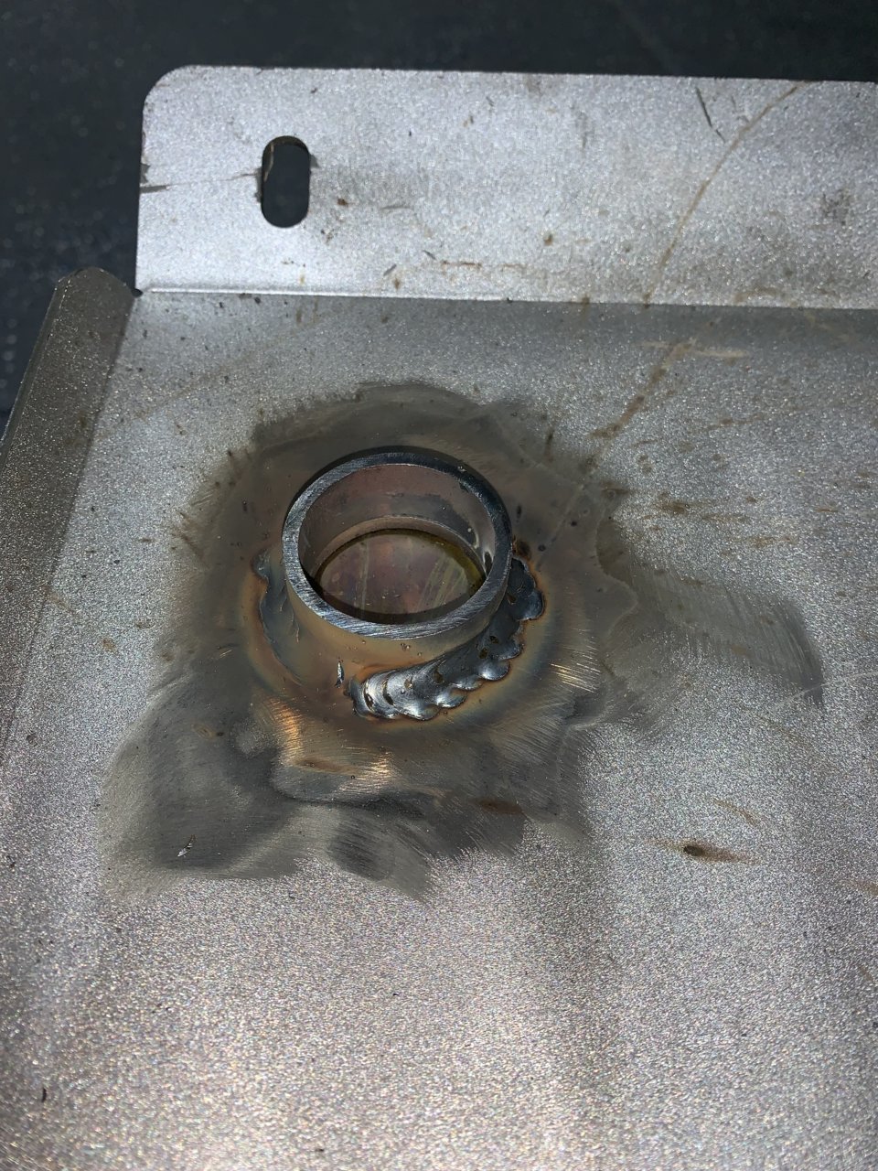

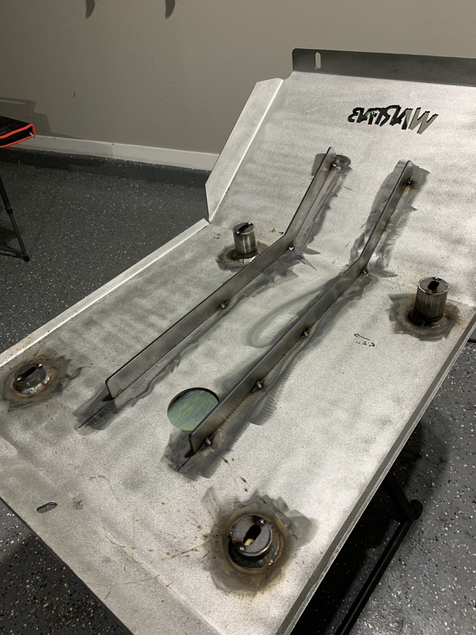

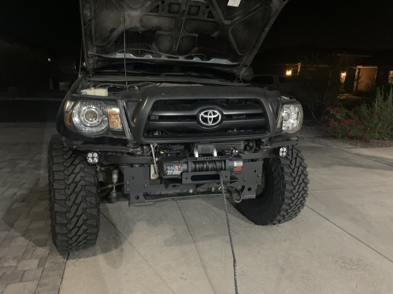

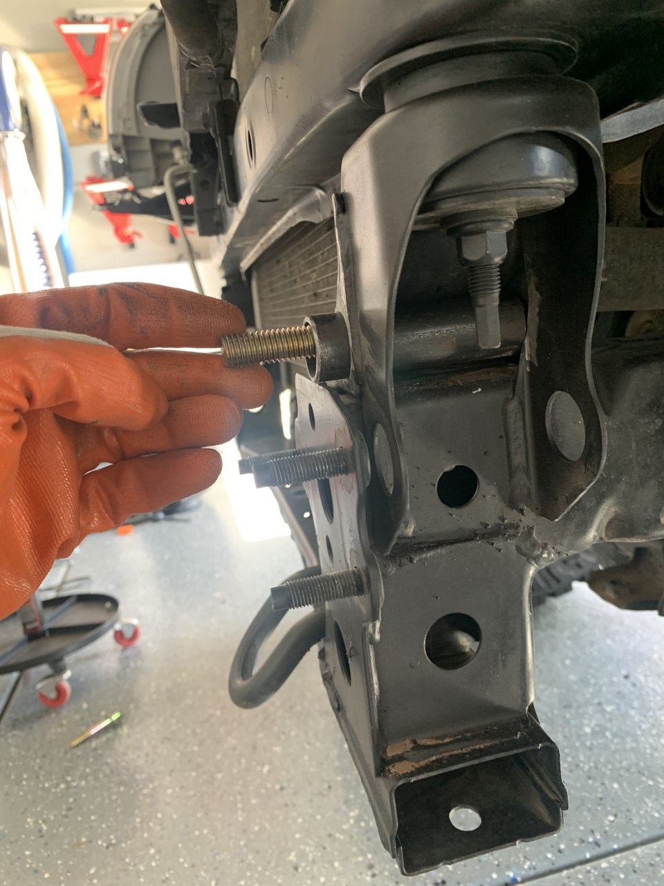

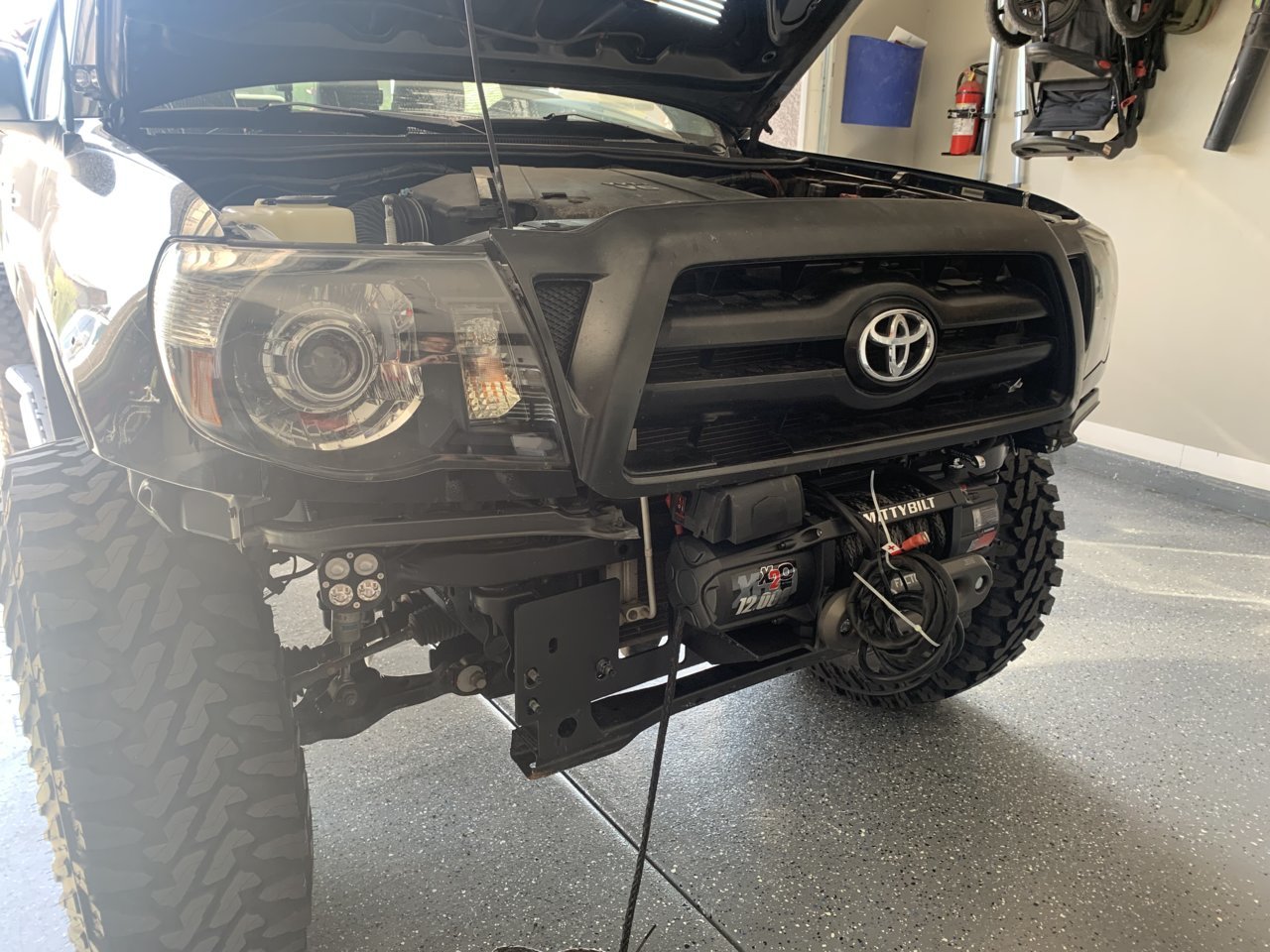

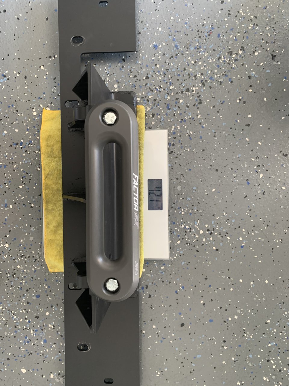

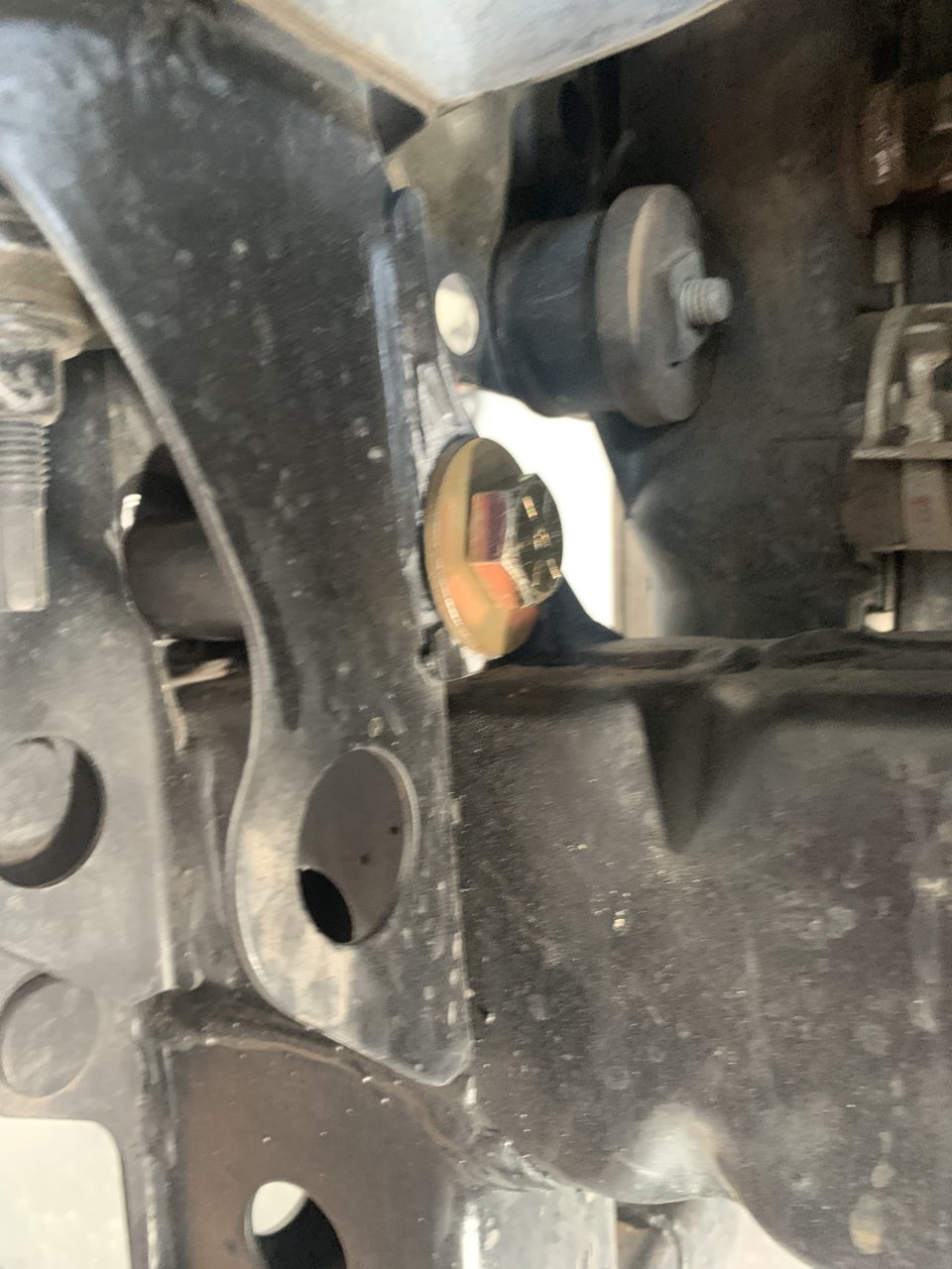

    Guys I am having so much fun with metal fabrication. I’m so hooked. It is literally unbelievable how many things you can accomplish with a grinder and a welder. Both of mine are from harbor freight and both work just great. I notched my grille for the control box & started working on the additional bolts for the mounting plate. Also was able to keep my center grille mount hole thingy after trimming the rest of that bracket.
    Also, so far my bumper weighs 42lbs. And my winch with line and all wires is 52lbs. Also made some rosette’d frame plates for the front of the frame up near the frame horns

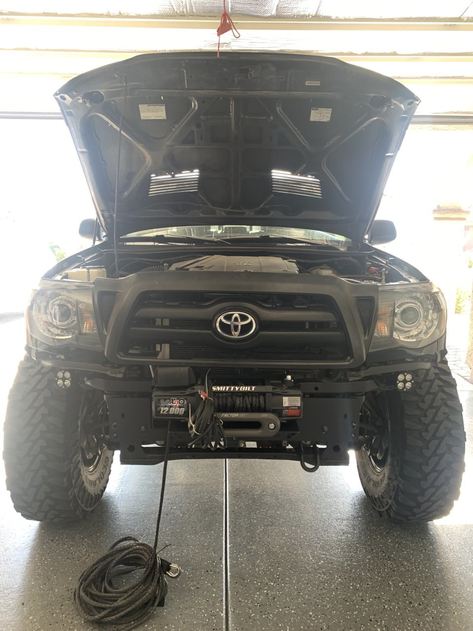

  17. Sep 25, 2021 at 5:01 AM
    #557
    singletrack_ftw
    Aug 27, 2017
    #228223
    3,685
    Tyler
    AZ
    ‘08 TRD OR 4wd

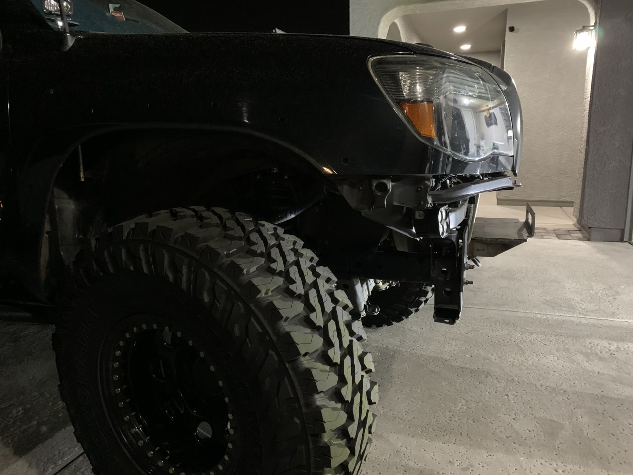

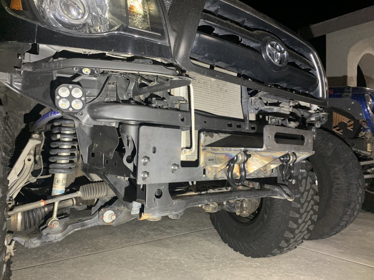

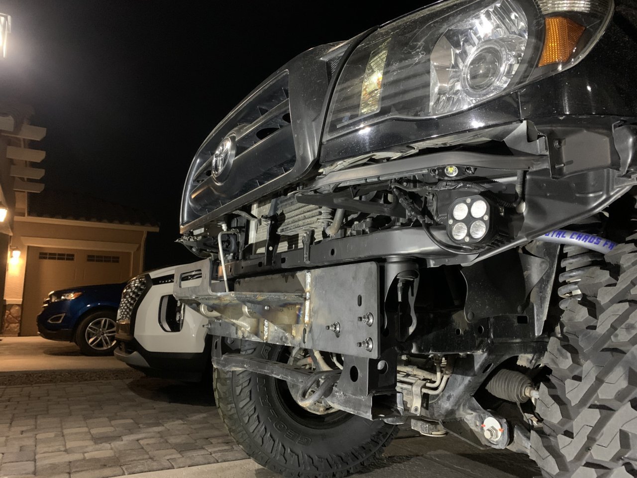

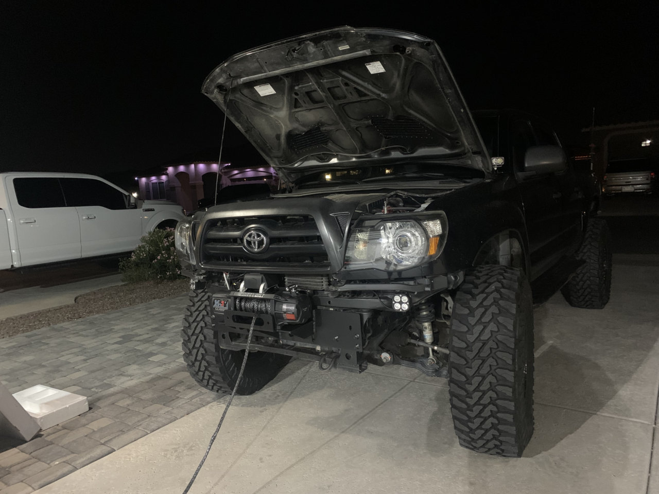

    More front end progress!
    LOLLY, T.Barn, dirtyrob and 1 other person like this.
  18. Sep 25, 2021 at 5:32 AM
    #558
    ovrlndkull
    ovrlndkull STUKASFK - HC4LIFE
    Jan 7, 2017
    #206806
    37,785
    Skip
    Burlington, NC
    2005 DCLB Silver
    63s, XD Machete, Beat not Babied
    How does your winch only weigh 52 lbs???? Mine weighed a lot more than that. Closer to the published weight of the winch at 90lbs. That's the reason I switched to the Warn 9RC
  19. Sep 25, 2021 at 5:39 AM
    #559
    EatSleepTacos
    Mar 24, 2015
    #151688
    59,838
    Randy
    West Valley, AZ
    2017 4Runner
    Holy crap, 90 lbs? Do you have steel line?
  20. Sep 25, 2021 at 5:42 AM
    #560
    singletrack_ftw
    Aug 27, 2017
    #228223
    3,685
    Tyler
    AZ
    ‘08 TRD OR 4wd
    No trickery here. Smittybilt x20 synthetic 12000k winch with all cables, right there on the scale, 52lbs. Really happy with that
    LOLLY likes this.
