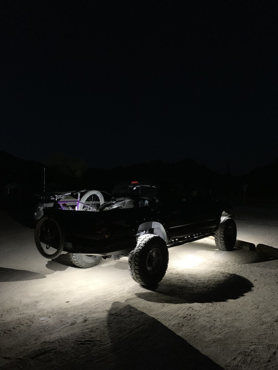

    If you’re a headlight junkie you’ll appreciate this. Here’s my headlights cutoff next to a nice Infiniti (which are known to have very good quality headlight projectors). Mine are better and I only spent $150 on the retrofit.

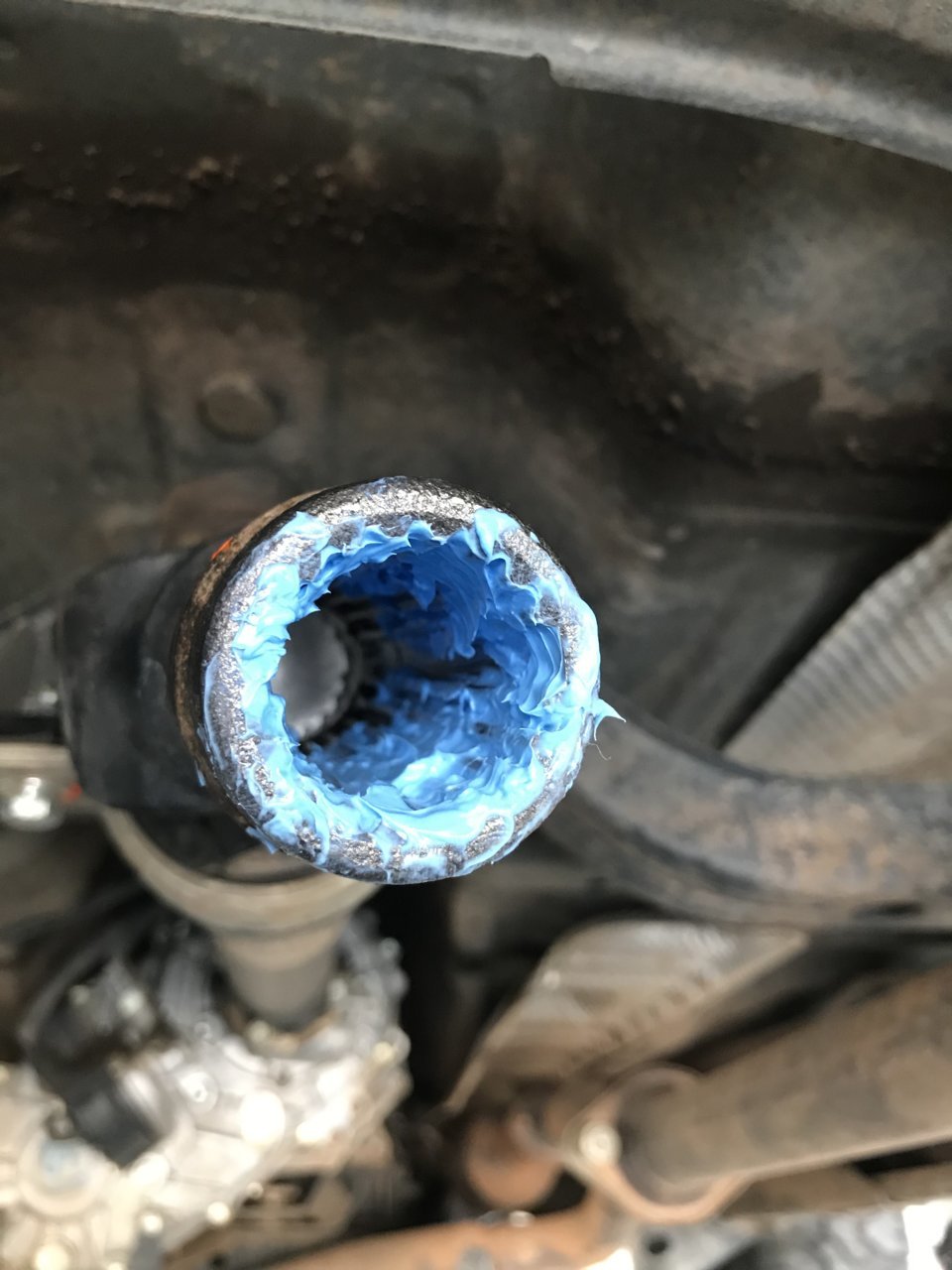

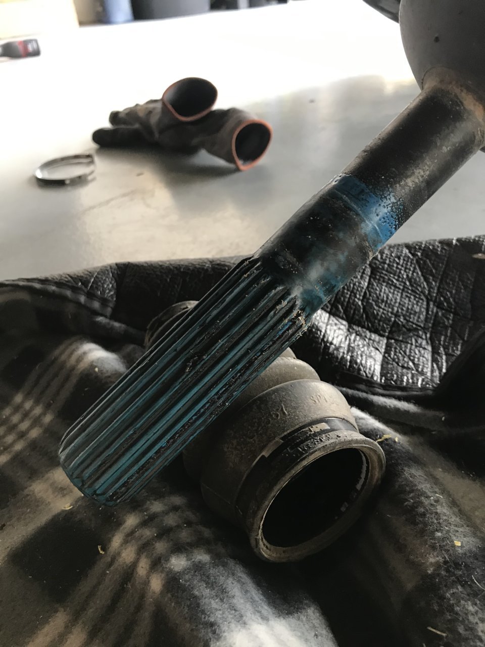

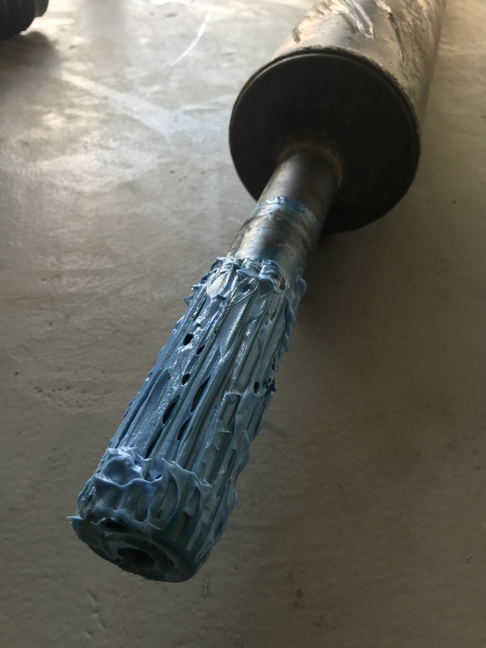

    I have had a clunk coming to a stop and starting again when I start moving forward. It was so annoying and been around for over a year. Just a very subtle but noticeable shifting-type clunk almost like a basketball was in the bed of my truck but it felt like it was in the drivetrain.
    It was my slip yolk. It was bone dry. I purchased some FORD XG-8 blue frosting lube from Amazon, pulled my driveshaft and lubed the male and female ends of my slip yolk and it’s like my truck is a 2020 tacoma offf the lot. The clunk is 100% gone and start/stop is so smooth now. Slip yolks aren’t designed to be run dry apparently. Barely took me an hour with taking my time matching the driveshaft with marks and cleaning the slip yolk really well before applying the lube.
    Slashaar, BajaAsh, cytocycle and 7 others like this.
