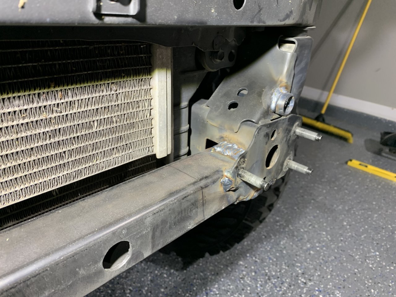

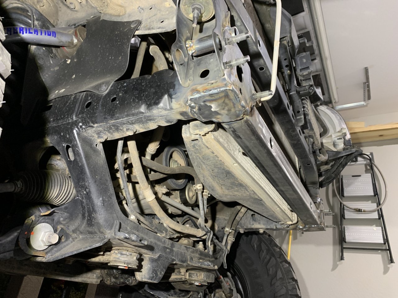

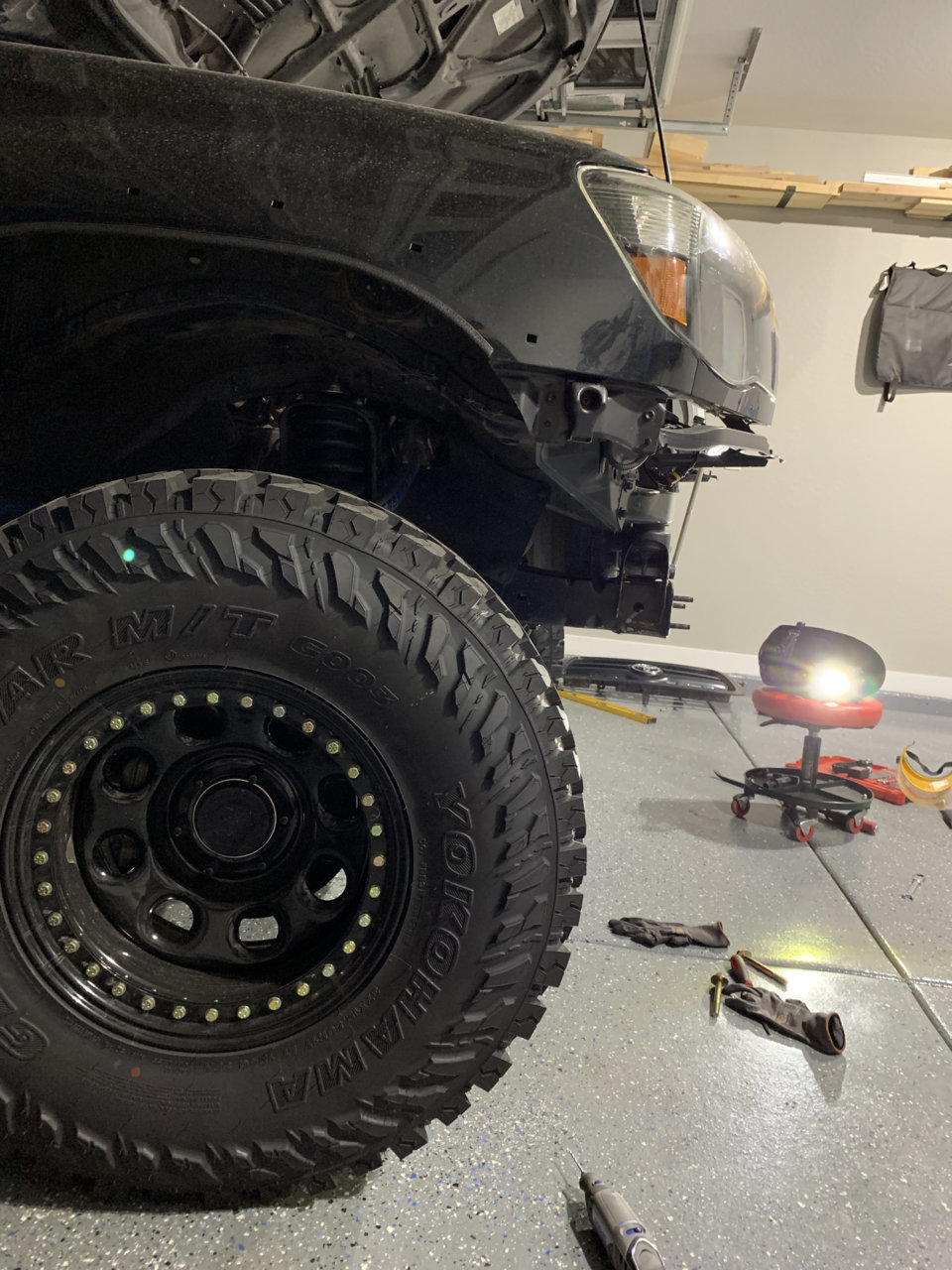

    :bananadance:I feel so accomplished. Still not done with all the extra bolts though

    Didnt change out the frame horn plates?

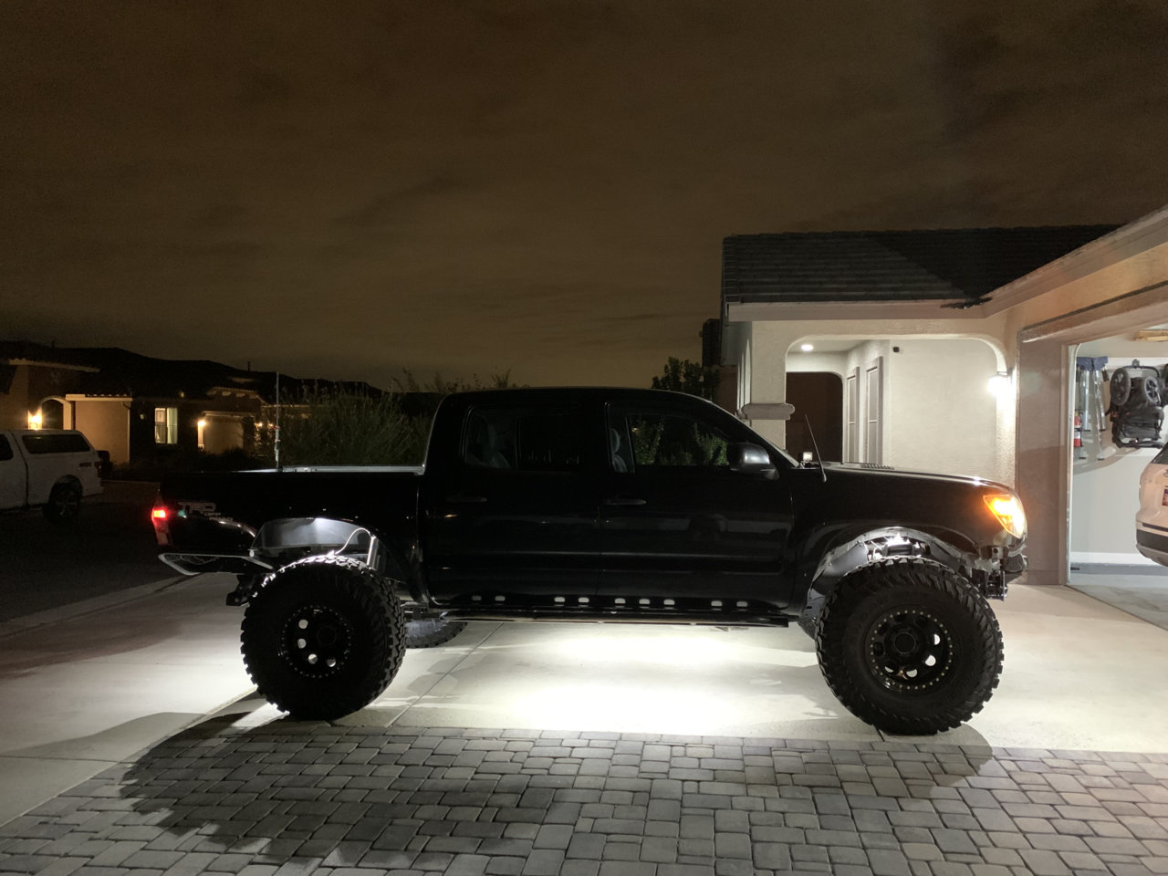

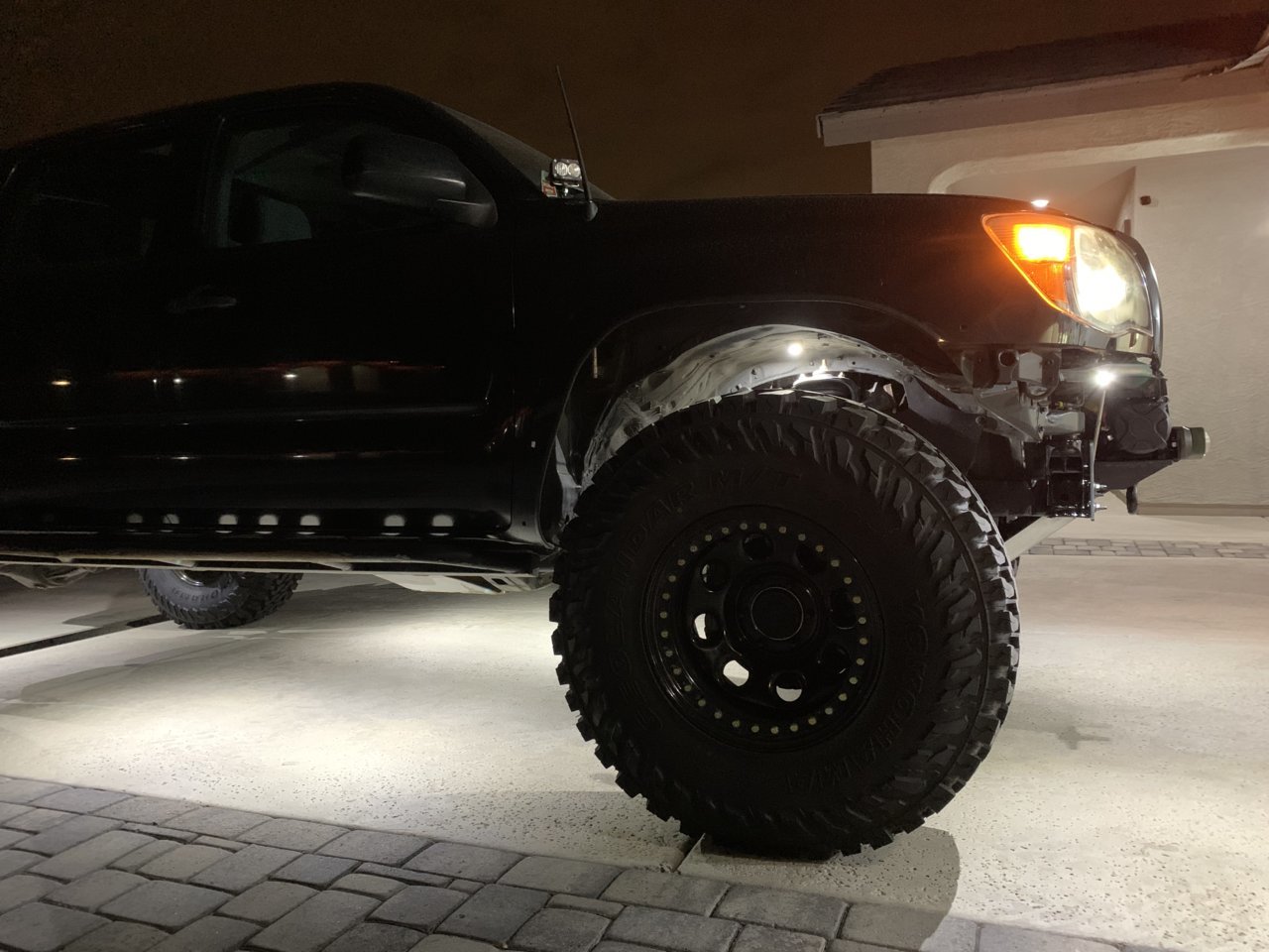

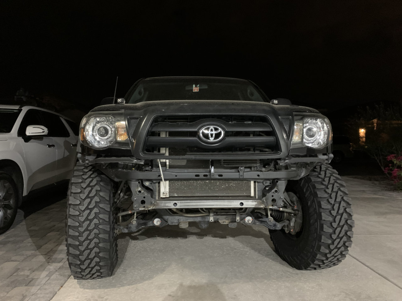

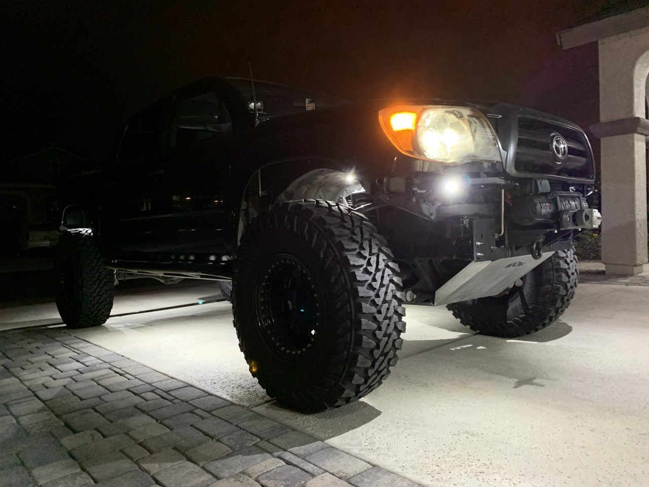

    Night pics, just because why not. Front and rear of this truck are so tucked

    No sir I did not

    Just need to bob the bed now

    Totally unnecessary thanks to how high my rear end is. :D Also, I haul lumber and just general crap in there because I DD & use this as a truck so removing 1 foot of bed wouldn't gain me nearly anything and would cost me a great inconvinence. I literally can climb the craziest stuff and still barely kiss the back end, especially now with the 37’s

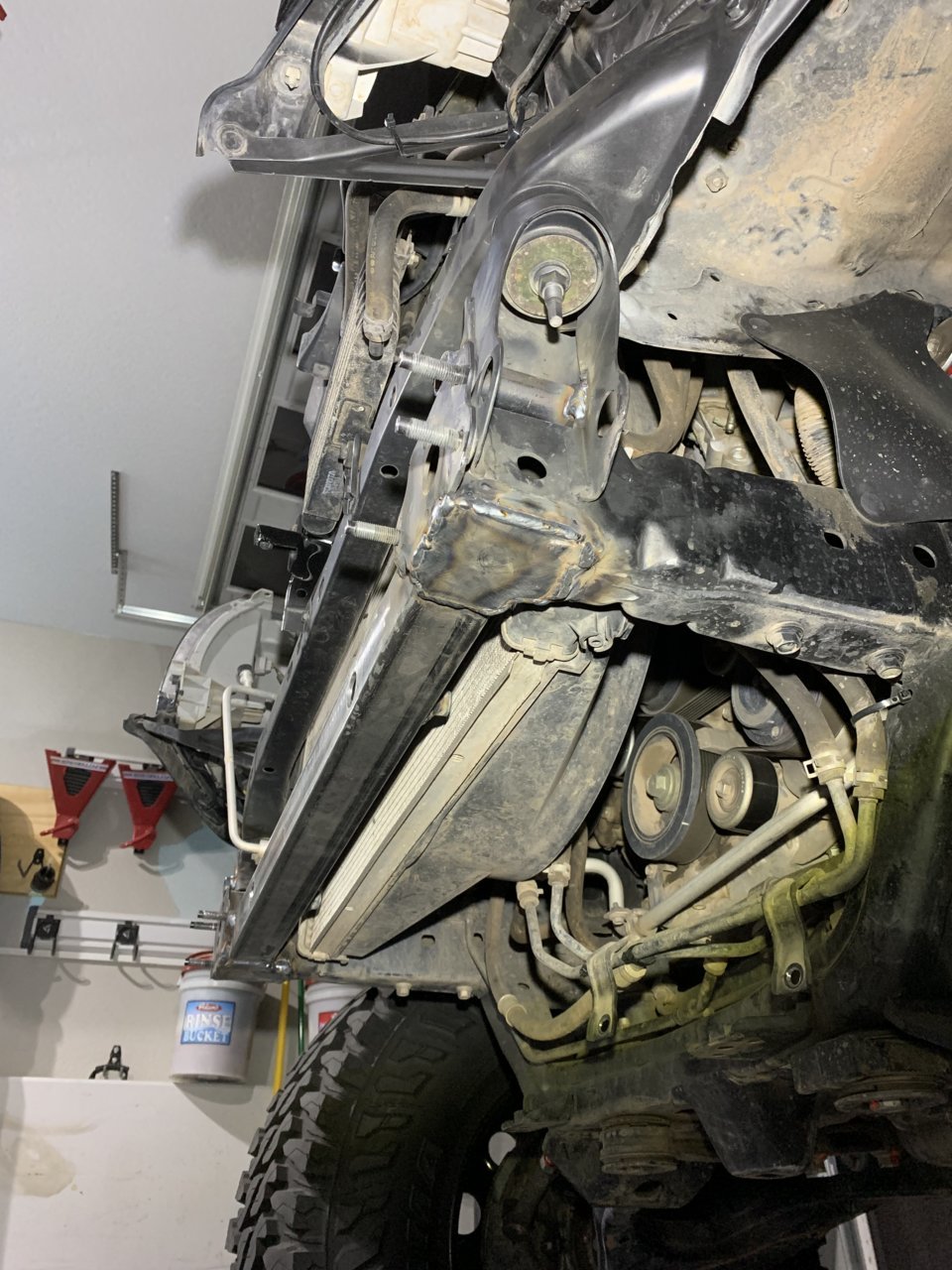

    I reinforce the bottom of the frame rails and I’m going to box the outer frame rails leading up to the frame horns as well as brace the frame horns eventually. I’m not worried about it

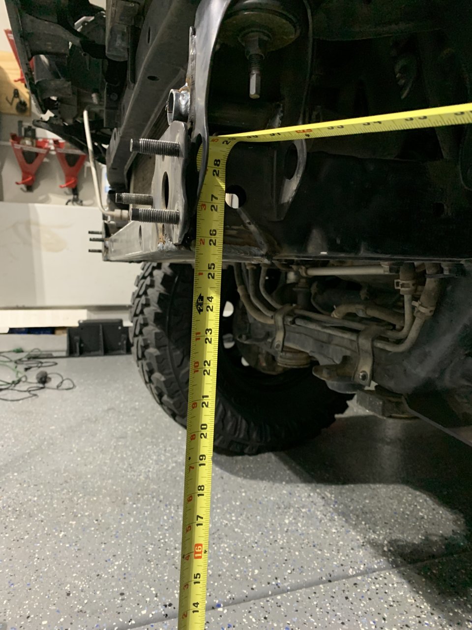

    Seeing the cut lower crossmember makes me curious how I could do something similar to my 4runner, so I like looking at your pictures. The front frame from 4runner to Tacoma is very similar from the side view, except for the 4runner I think has a taller radiator and for sure a different crossmember. The Tacoma radiator and shroud looks like stops at the bottom of the frame rail, whereas mine hangs down 3-4". This makes me think it probably wouldn't be possible without doing a lot of modification, but a dude can dream haha
    Anyway, looks good. I'm enjoying the bumper build process pics

    I wonder if you could chop it and then put a crossmember in front of the rad, about 1/4” below the bottom line of the rad. Would gain you at least a few inches.

    mine already has some natural north eastern weight reduction, so I'm going to cut it out anyway and replace with some 2x2" and 1x2". was hoping to eek out anything else I can get. Looking at his pics, the taco shroud stops just below the fan, whereas the t4r has an extra 3" of extended shroud below the fan cutout to cover the extra radiator stuff, which makes me thing the t4r rad is taller

    thats a good idea. My crossmember is pretty crusty, so its on the backlog of projects to get to. I'm slightly traumatized about anything radiator because I blew an ice chunk through there at AOAA, but something in front would also help to prevent this:

    Guys have been using the FJ rad in the tacomas which is about 3" taller than ours, I bet that's the same as yours. You could see if the tacoma one is shorter and would work for you and use it instead.

    yeah that would make sense, because it hangs about that much lower than the frame rails. FJs and 4runners are more similar than to the tacomas, so that all adds up. I like randys suggestion of putting the bar in front, so I'll think about how I could execute that cleanly

    Yeah just have it hang down a tad lower than the rad so you can put a skid there to protect the very bottom of the rad. Even that few inches will be a pretty big deal.
