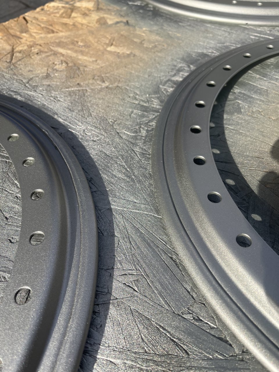

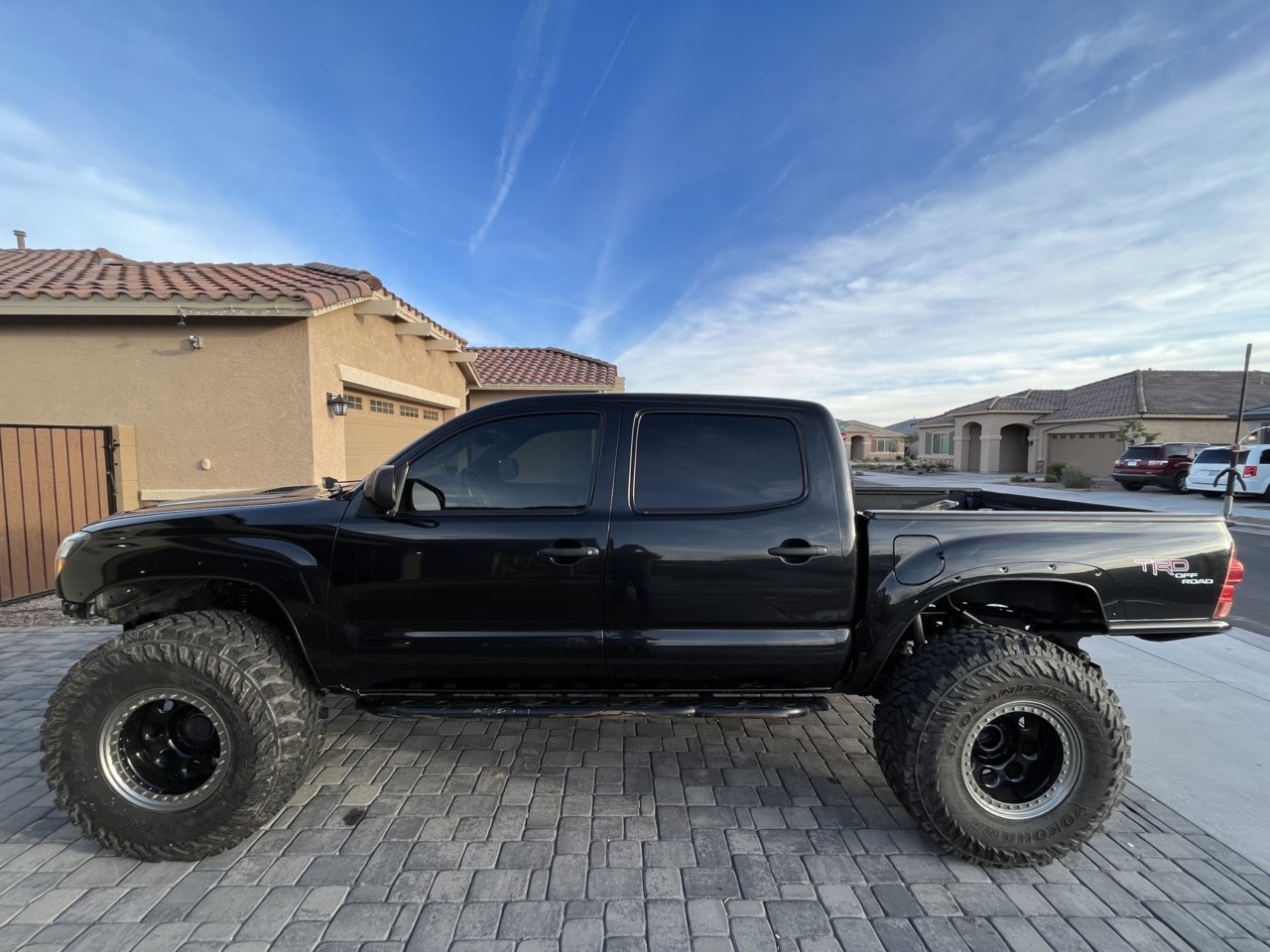

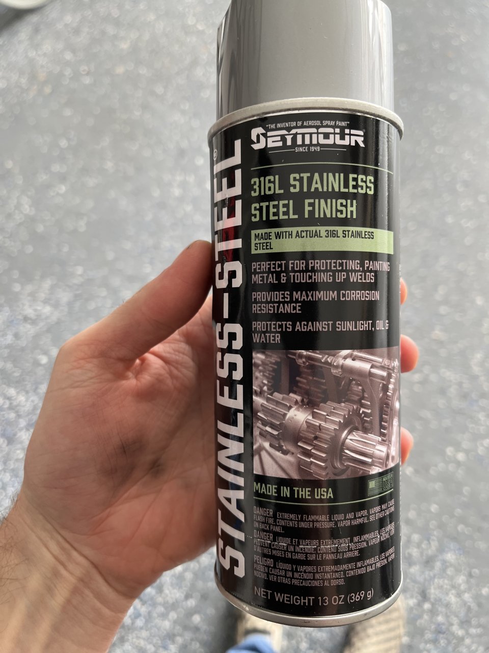

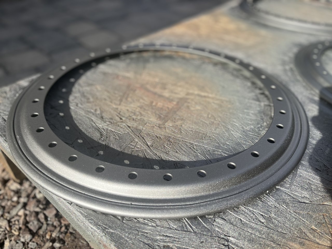

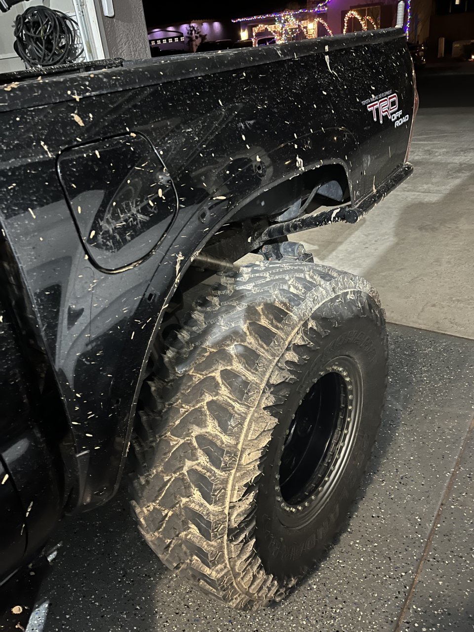

    Very impressed with these $6 cans of stainless steel paint. I had a legit excuse to redo my beadlocks because I didn’t put spacers between the rings initially and coned the rings a tad

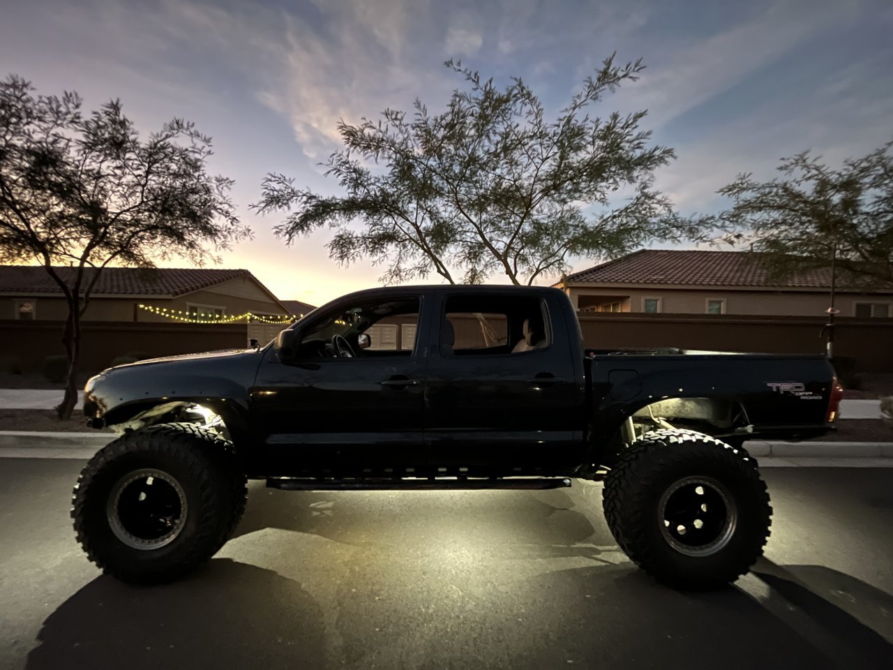

    Also had a VERY NICE morning enjoying my freedom.

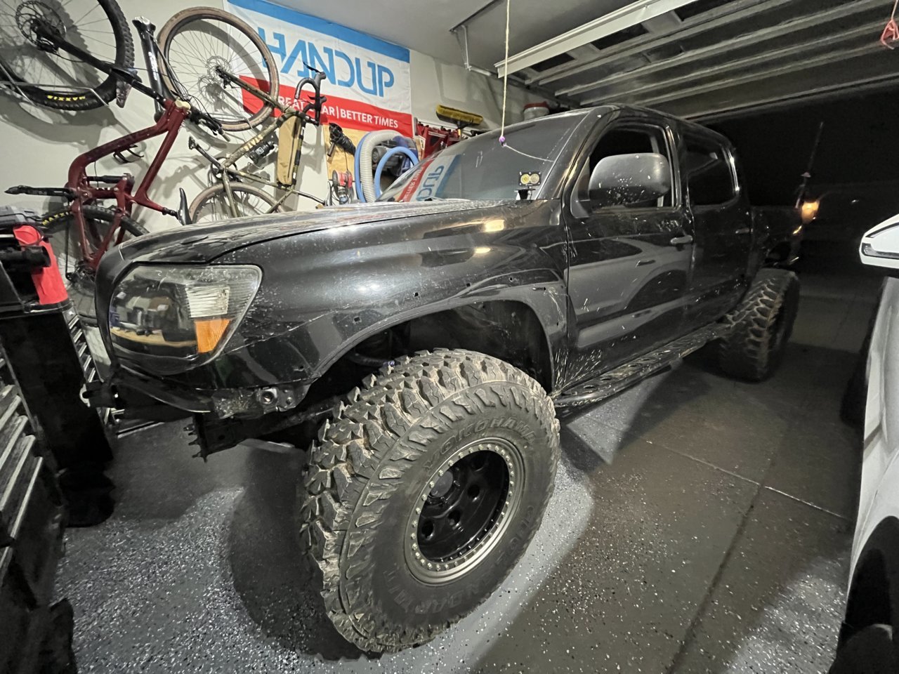

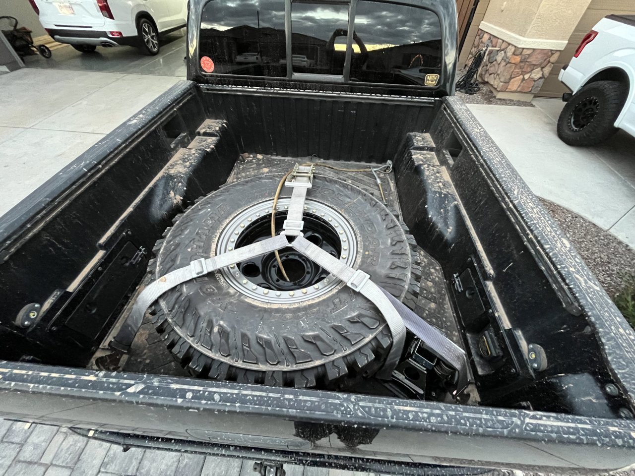

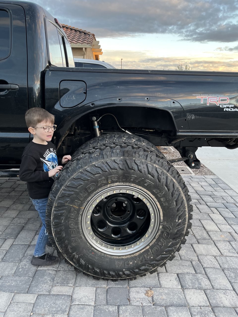

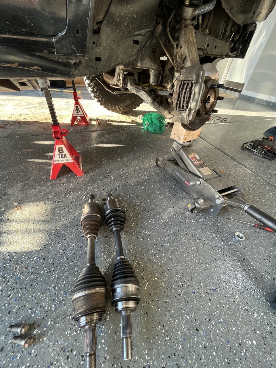

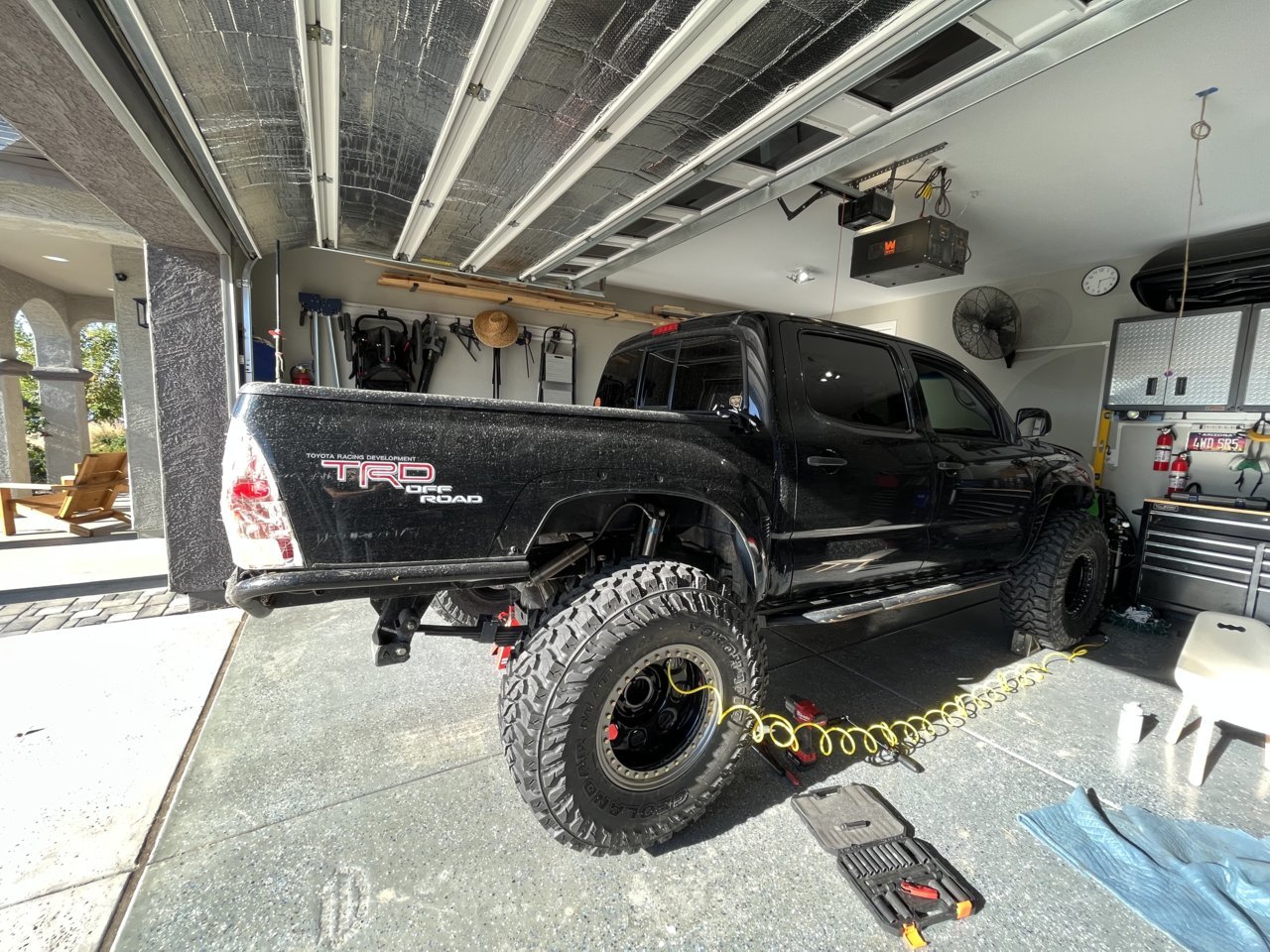

    Truck is ready to wheel.
    - all beadlock rings replaced with silver ones & ring spacers added for a better ring seat.
    - DS firewall hammered for 100% street clearance w no rub and some wheeling without obviously full bump clearance but a decent amount for now.
    - PS CV axle replaced (Napa lifetime warranty on axles FTW, free axle here I come)
    - 1.25” spacers added to rear for shock relocation clearance.

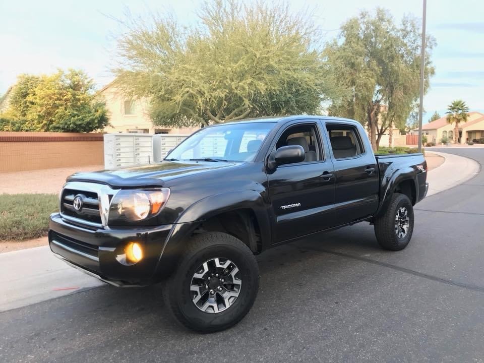

    https://www.tacomaworld.com/threads/singletrack’s-‘dad-shred-build-thread’-i’m-just-doing-it-for-the-kids.619250/ Sos offroad sliders (kickout + filler) Sos offroad full belly skids (steel) Sos offroad front recovery point Sos offroad concepts HC rear bumper with bedside kickout tubes Marlin Crawler LCA frame brace kit Trail Gear rear diff cover Bilstein 5100 + OME 885 Total Chaos UCA BILSTEIN b110 OME Dakar standard pack Wheelers Ubolt flip kit Wheelers Superbump f/r Wheelers SS extended brake lines FN five star 16x8 -25 Milestar Patagonia MT 315/75r16 Custom projector retrofit (acme super h1 + morimoto 4300k) Baja Designs S2 sport ditch pods on CBI ditch pod mounts Amazon AMAK rock lights CMC CB radio hardmount

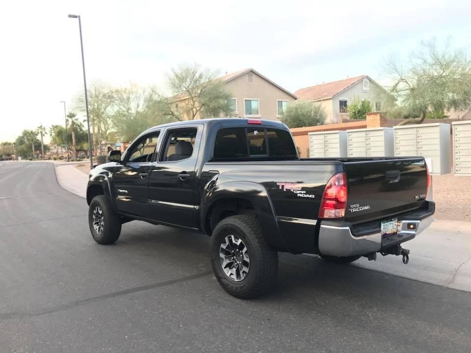

    Nice little flashback to January 2018 (1month after owning it & selling the awful rockstar 18” wheels with 33” all terrains

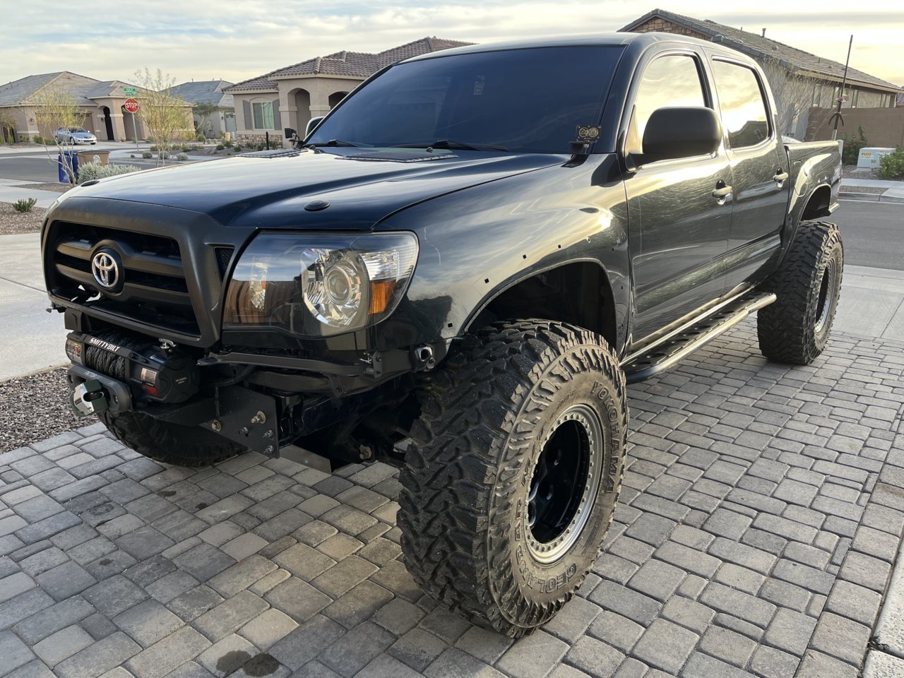

    No regrets with the silver rings I’m digging them. Also with driving habits I can still get 13.5/14 city MPG which is sick

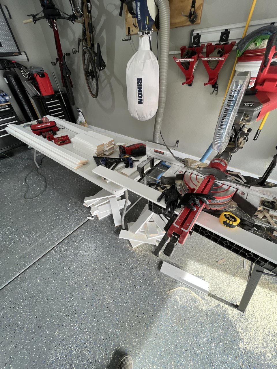

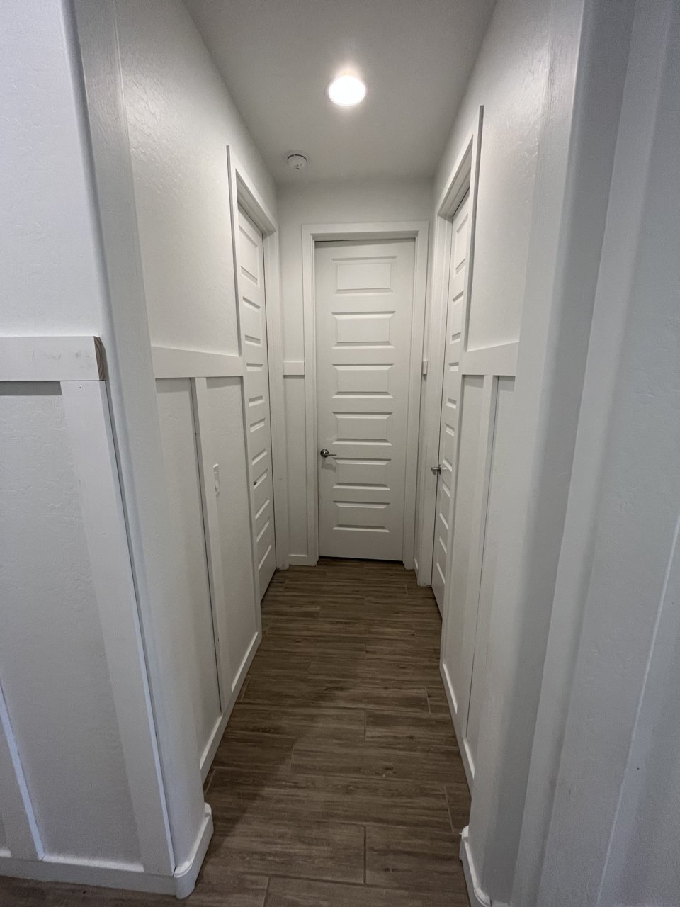

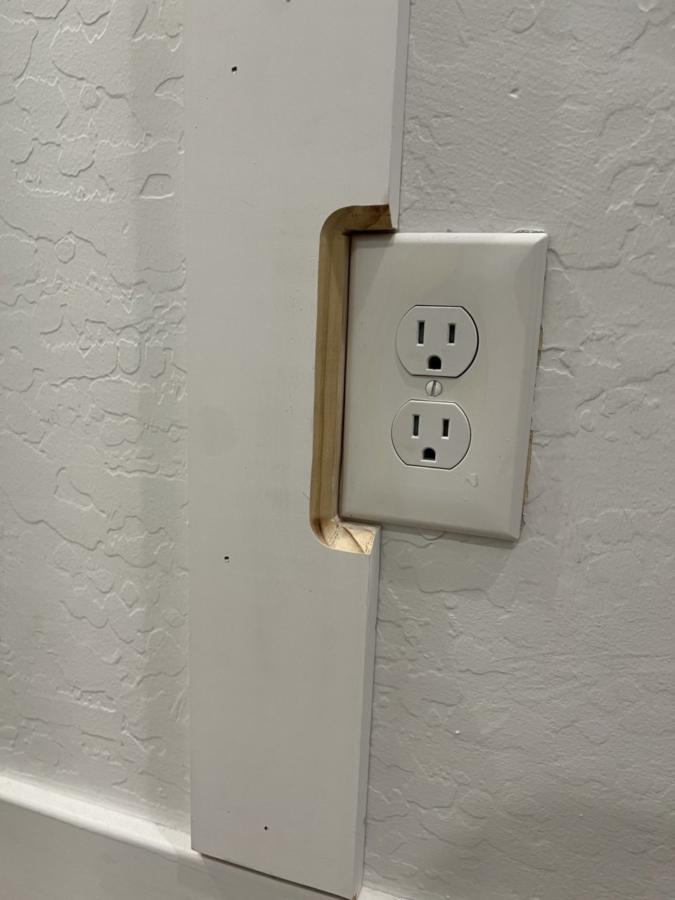

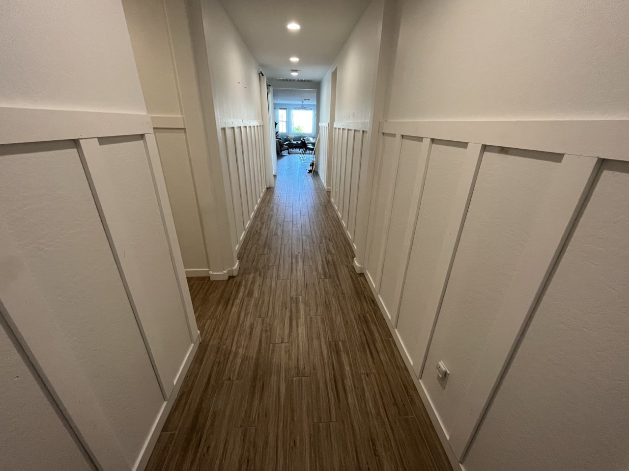

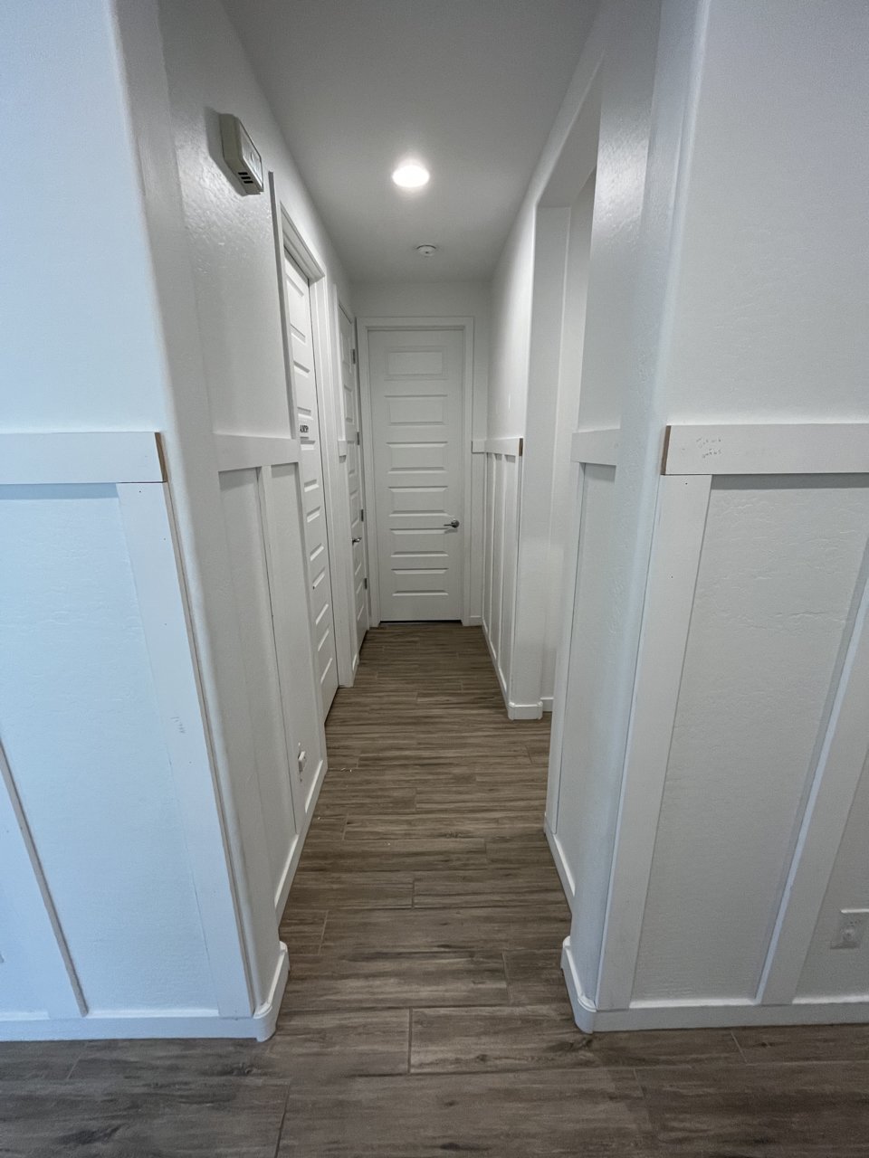

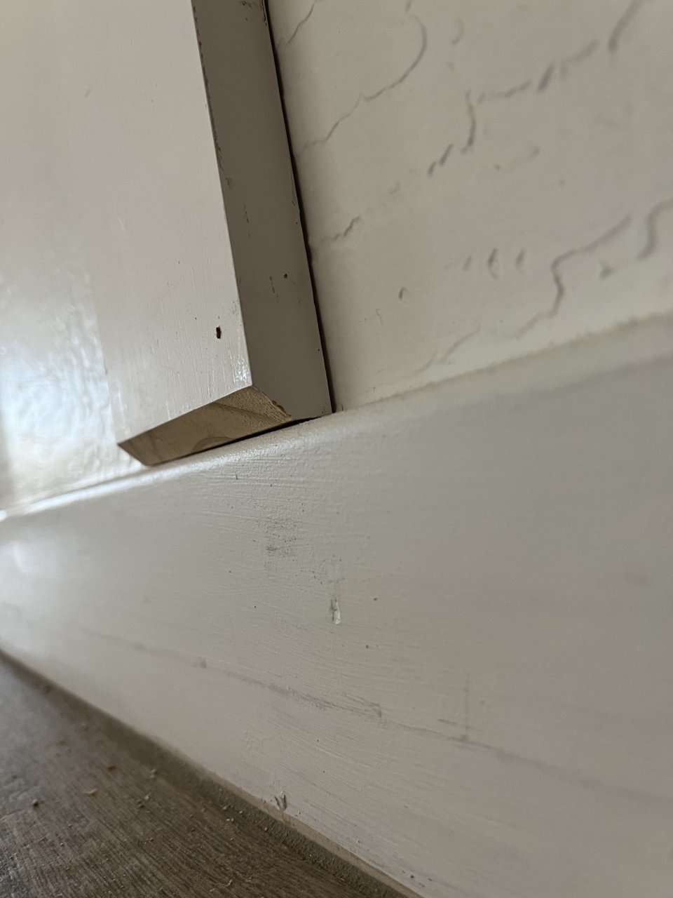

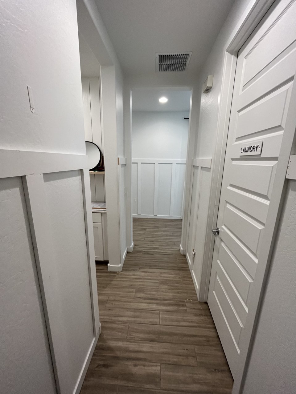

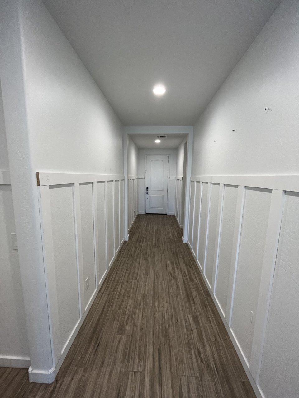

    Put some miles on my favorite new tool (Milwaukee 18ga brad nailer). Wife wanted board and batten in our entryway so I am knocking it out right now. Still need to fill, sand, caulk and paint but it’s coming along nicely. I feel so blessed to have so many different tools. I always end up busting out the jigsaw and router for stuff. The router has been awesome to chamfer the bottom edges of the batten boards because they’re thicker than the base boards. Also trying to make outlet cutouts look a little nicer than just a cutout. Needs caulk and paint

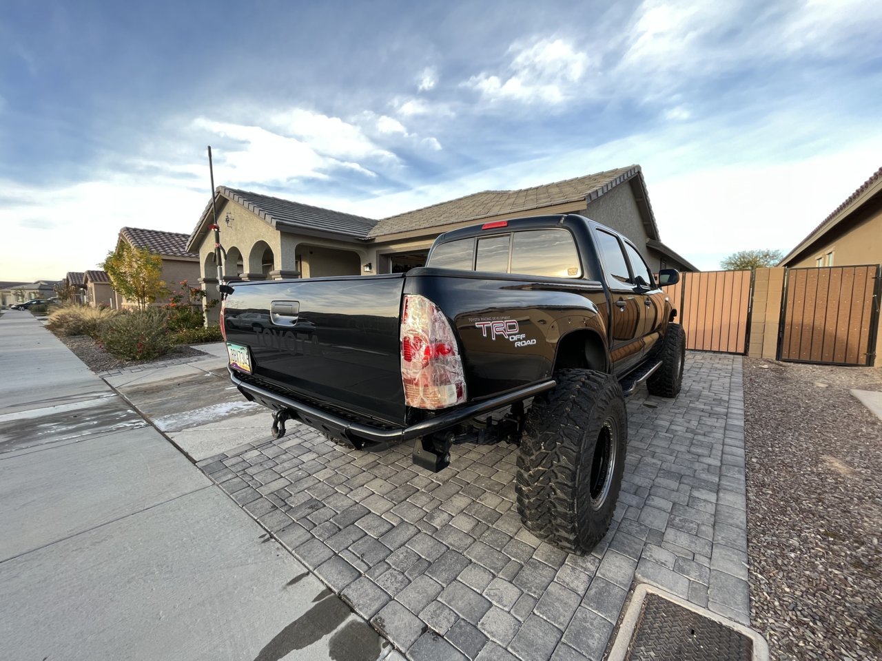

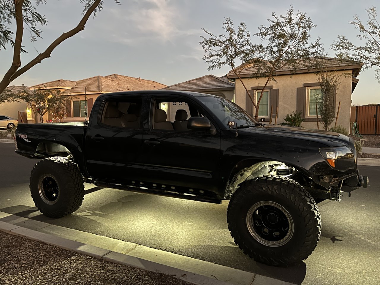

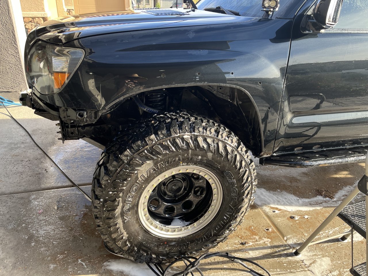

    Also finally washed the truck, it’s been a while. Hoping to wheel within the next couple of weeks. Also I’m going to make some tabs for my light pods so I can weld them to my front winch plate somewhere.

    This angle makes it look like an RC truck, in the BEST way possible!

    Yes agreed! Mainly it’s the wide angle :D

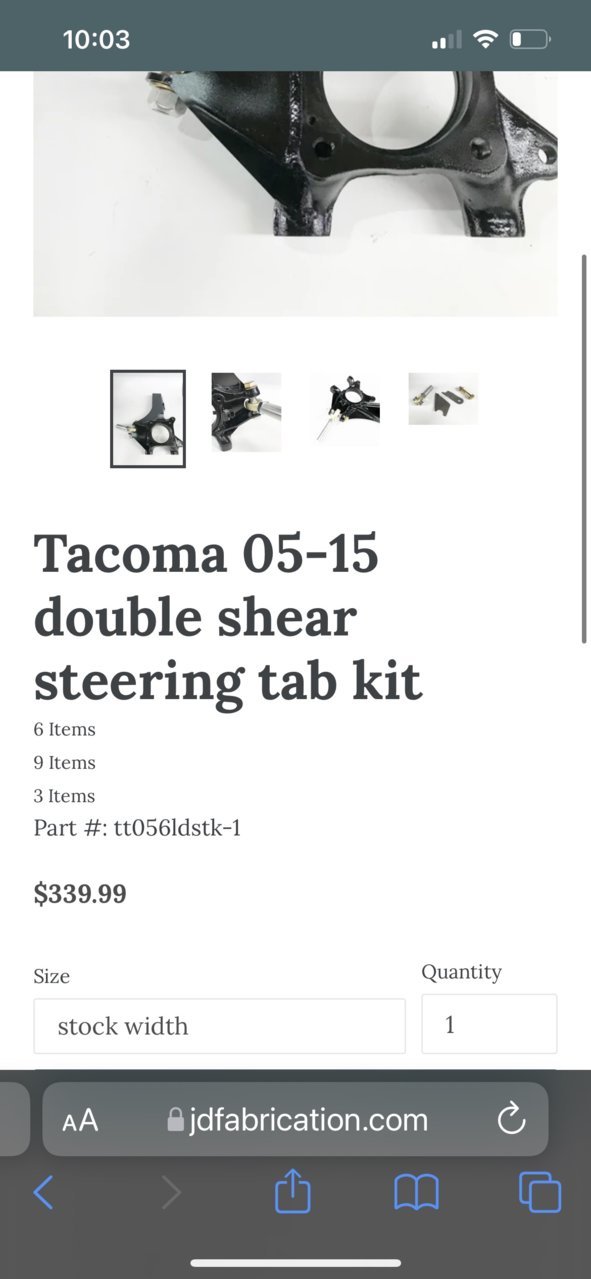

    I need to sell my JDFab double shear heim tie rod kit! Dm me if interested. Brand new in box

    Just curious why you’re selling. If I had the extra cash right now, I’d be all over them.

    Moving funds around in between hobbies and I’d rather not run 37’s on stock rack with stock inners and these ultra beefy outers
