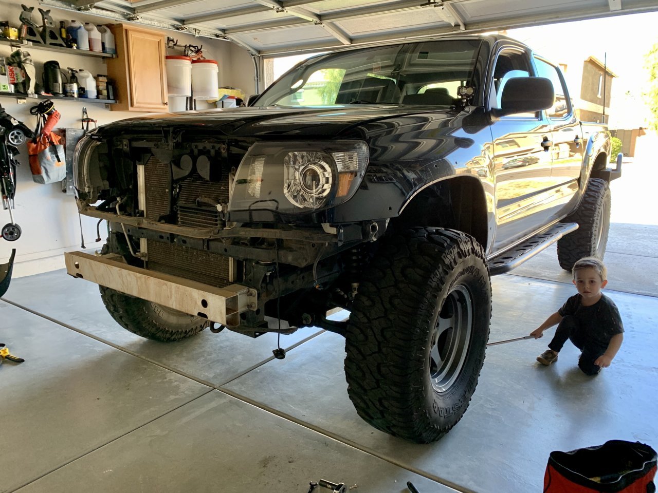

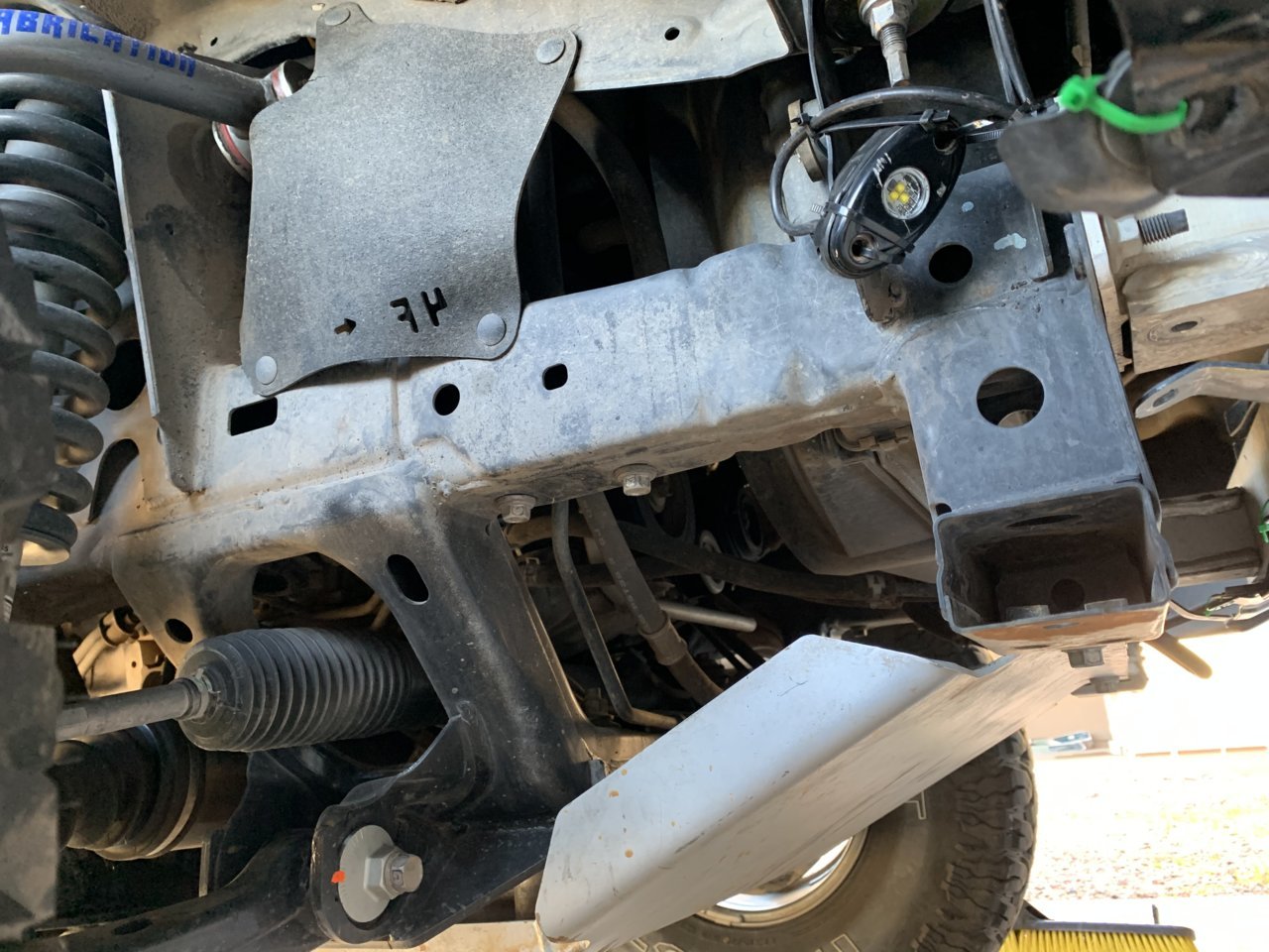

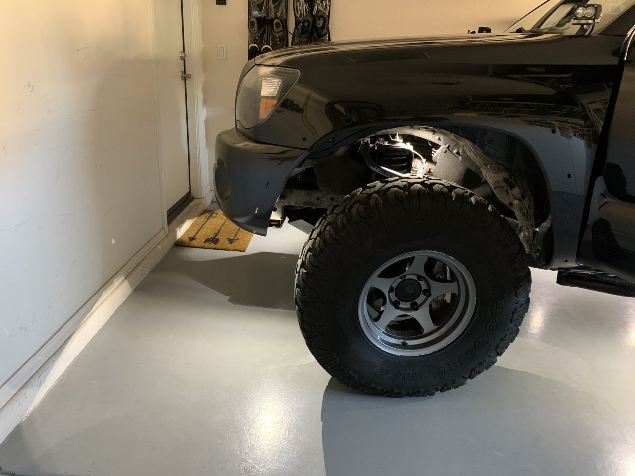

    Quick little mod day swapping out my OEM rad core support bushings with energy suspensions poly ones. Then I moved my front rock lights from the bumper to the frame and angled them perfectly for where I’d like them.

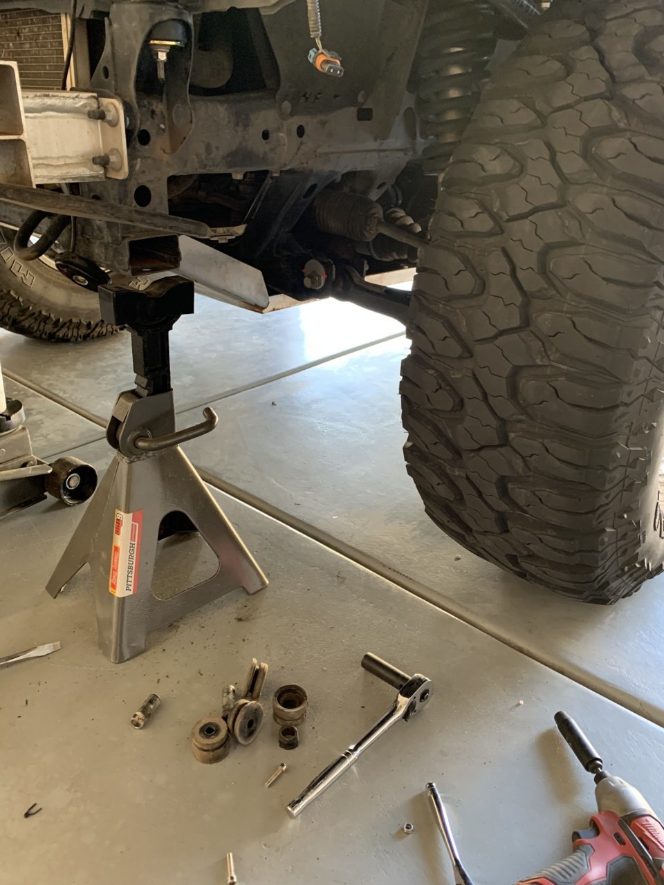

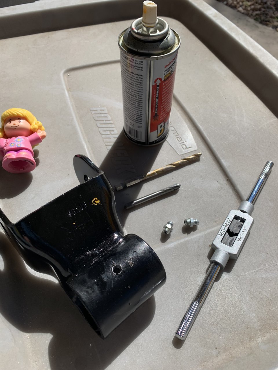

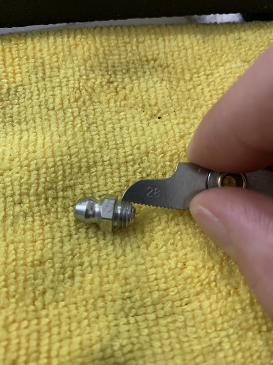

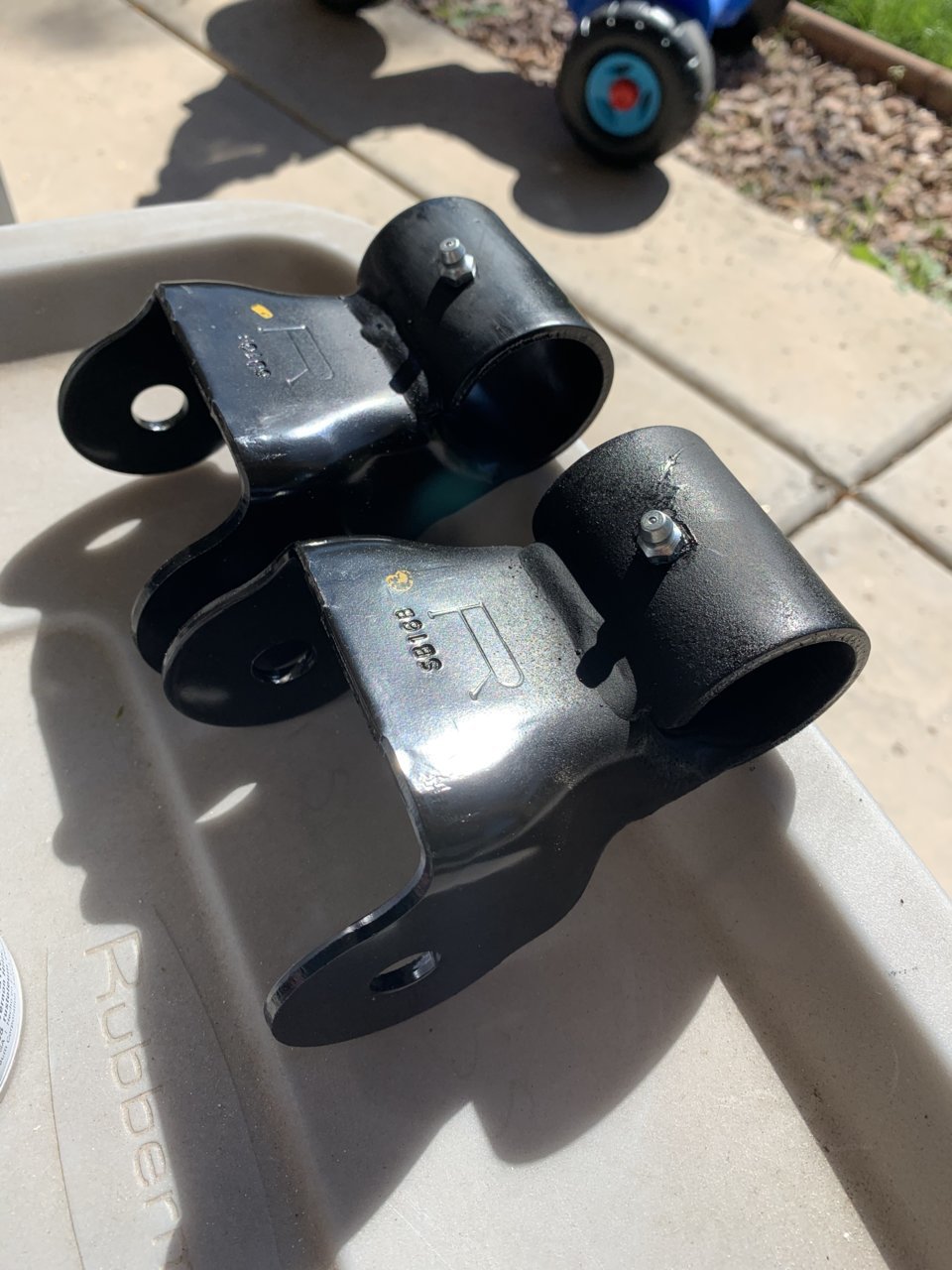

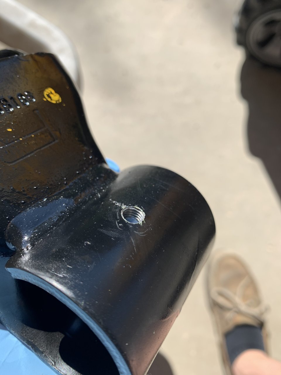

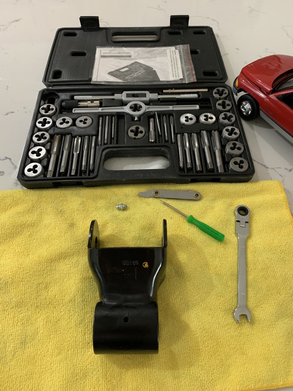

    Drilled/Tapped some shackles today with zerks so I can keep my @ARCHIVE poly bushings nice & greasy. These will go in next week when I do my hammer hangers.

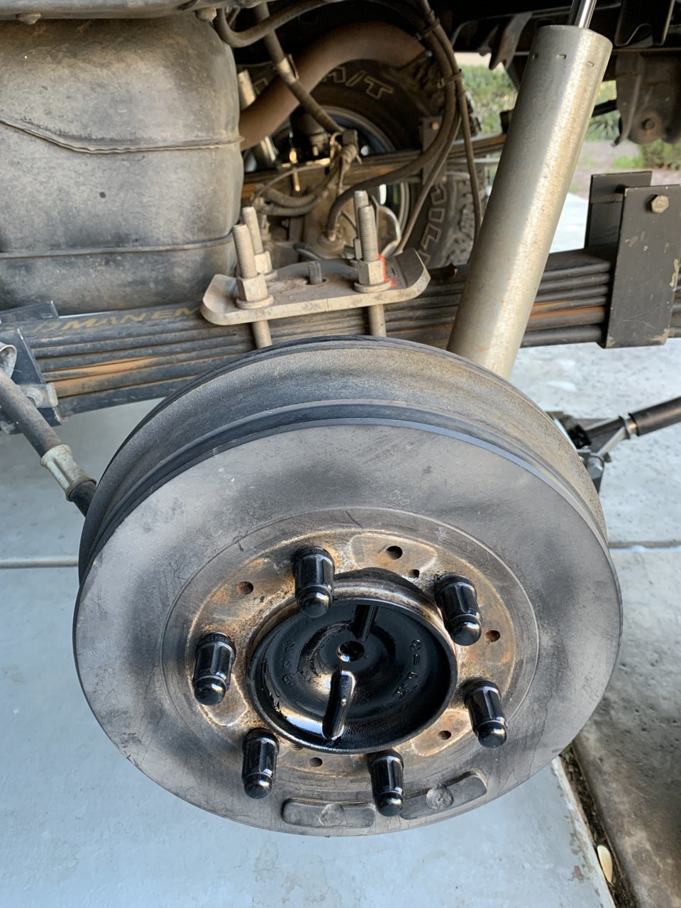

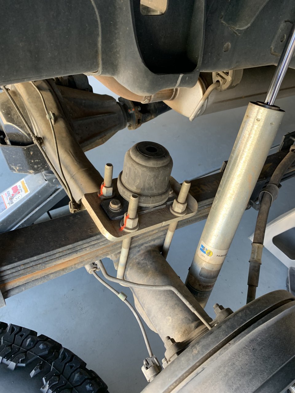

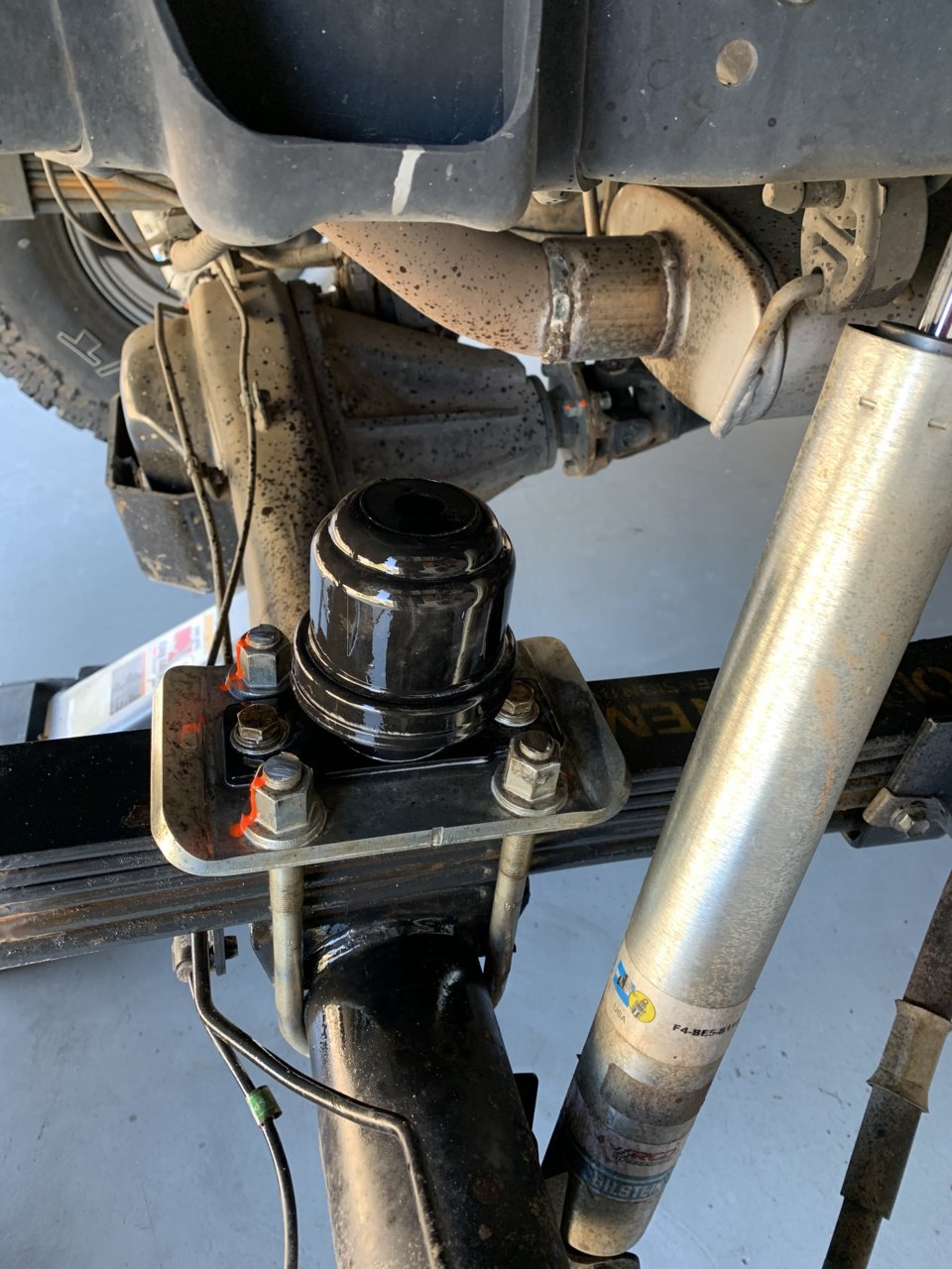

    Finally got around to trimming my Ubolts. Theyve been like this for a long time and it has really bothered me. Only problem is I woke my son up so I only got one side done. #napmods

    Just did the same the other day, whatd you spray on ur bumps?

    Lucas oil tool box buddy (its incredible stuff)

    Also painted my hubs while I was down there.

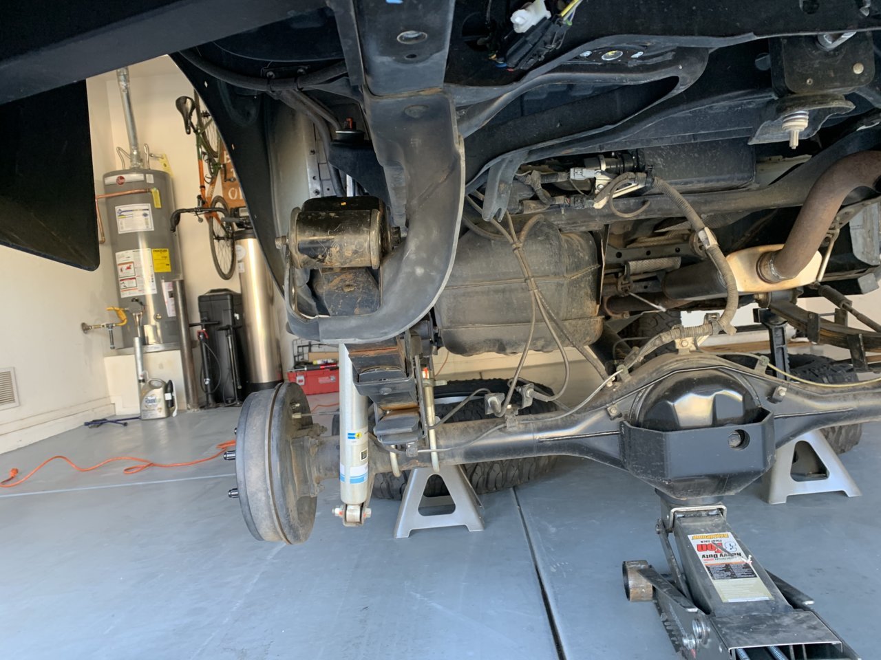

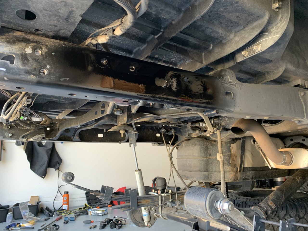

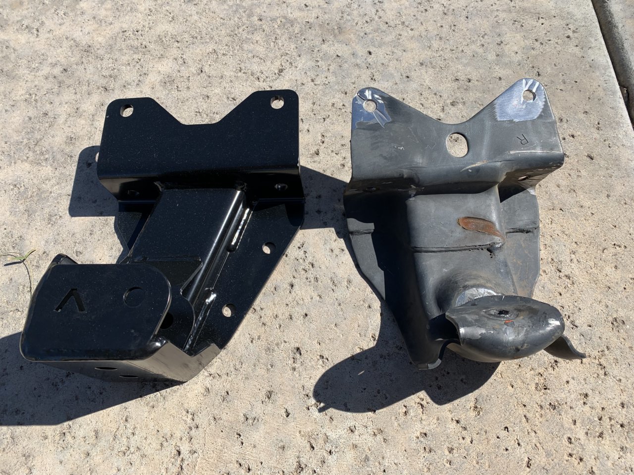

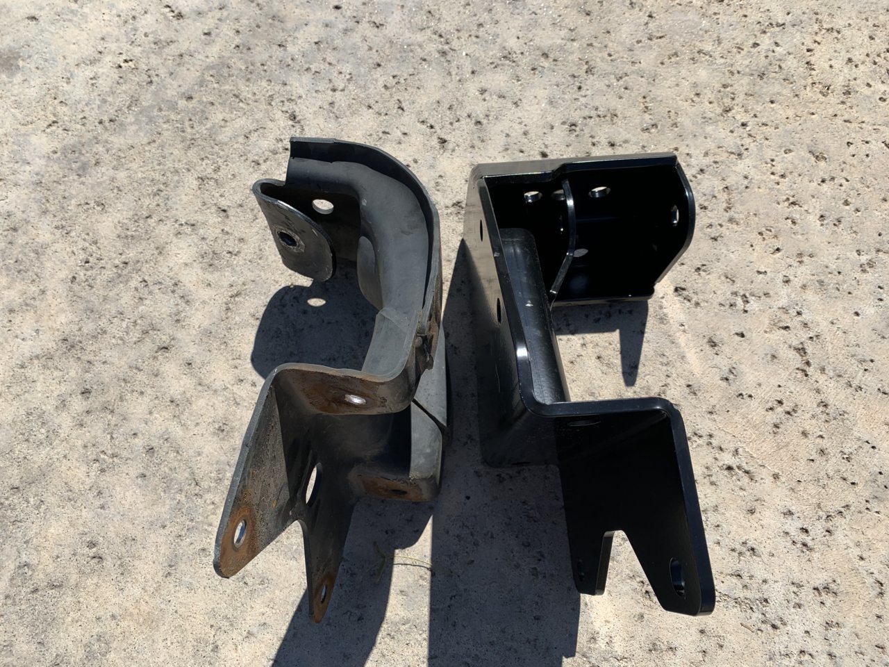

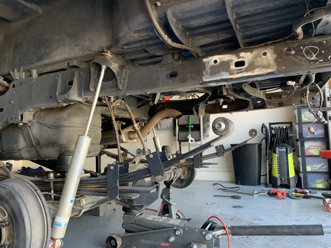

    Yeehaw. Lots of hard work, but went smooth! Installed my @ARCHIVE hammer hangers with cross tube, trimmed my correct Dakar leaf, & replaced my shackles with new OEM ones with Archive poly bushings & grease fittings that I made. I am SO STOKED FOR THIS. Already a noticeable increase in ride quality even just around town. Can’t wait to wheel this rear end, HARD.

    How difficult 1-10 and did you use a grinder drill them out r what?

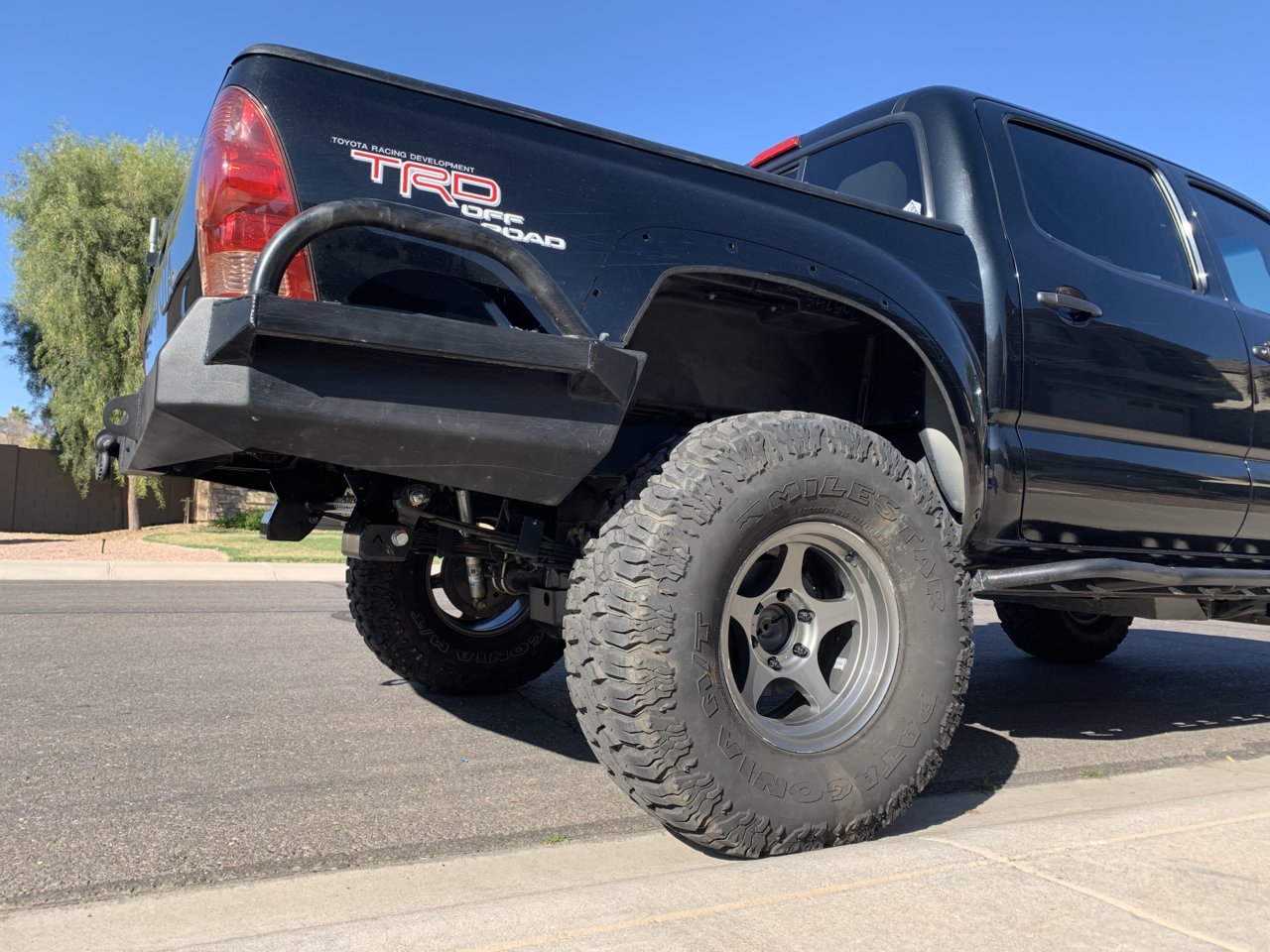

    What rear bumper are you running?

    It wasn’t that difficult at all. I have a $40 4.5” angle grinder from harbor freight & my cutoff discs are MILWAUKEE carbon & my flapper discs are Amazon special.
    it wasn’t that difficult, just gotta throw a lot of sparks & metal shavings, wear eye protection, gloves and cover your bare skin.
    -Use cutoff disc to chop head of rivets off (best you can).
    -use flapper disc to flatten, clean and grind down the remaining rivet
    -center punch the rivet (used as a guide for your drilling
    -drill out center punch all the way through with 1/4 inch bit
    -drill through with 1/2” bit
    -smack hanger off the frame rails with 10lb hammer, clean frame , paint frame, bolt up hammer hangers. It honestly wasn’t a big deal with that process.

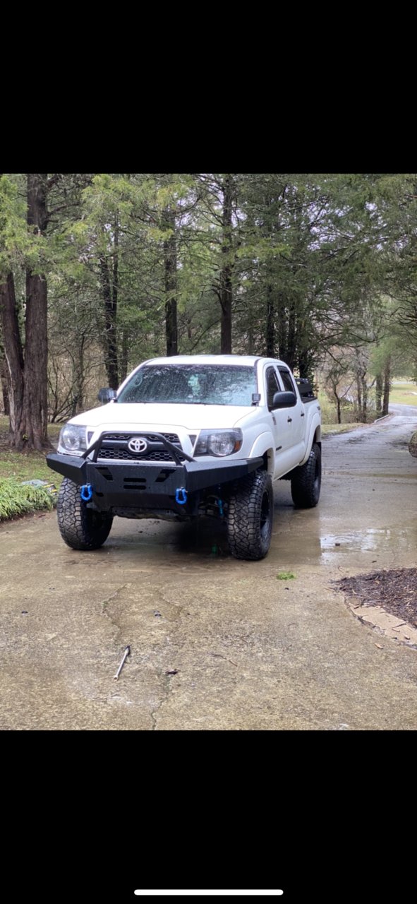

    @SOS CONCEPTS high clearance with bedside kickout protection tubes. Look at page 1, in my build thread. He’s running a 10% off tax time sale Rn. I bought all my sos armor at 20% off. Eddy is a good guy, with killer products, low prices and fast lead times.

    I’m currently running one of his OG fronts. I have one of the first ones he ever made. Thinking about pulling the trigger on a high clearance rear now
