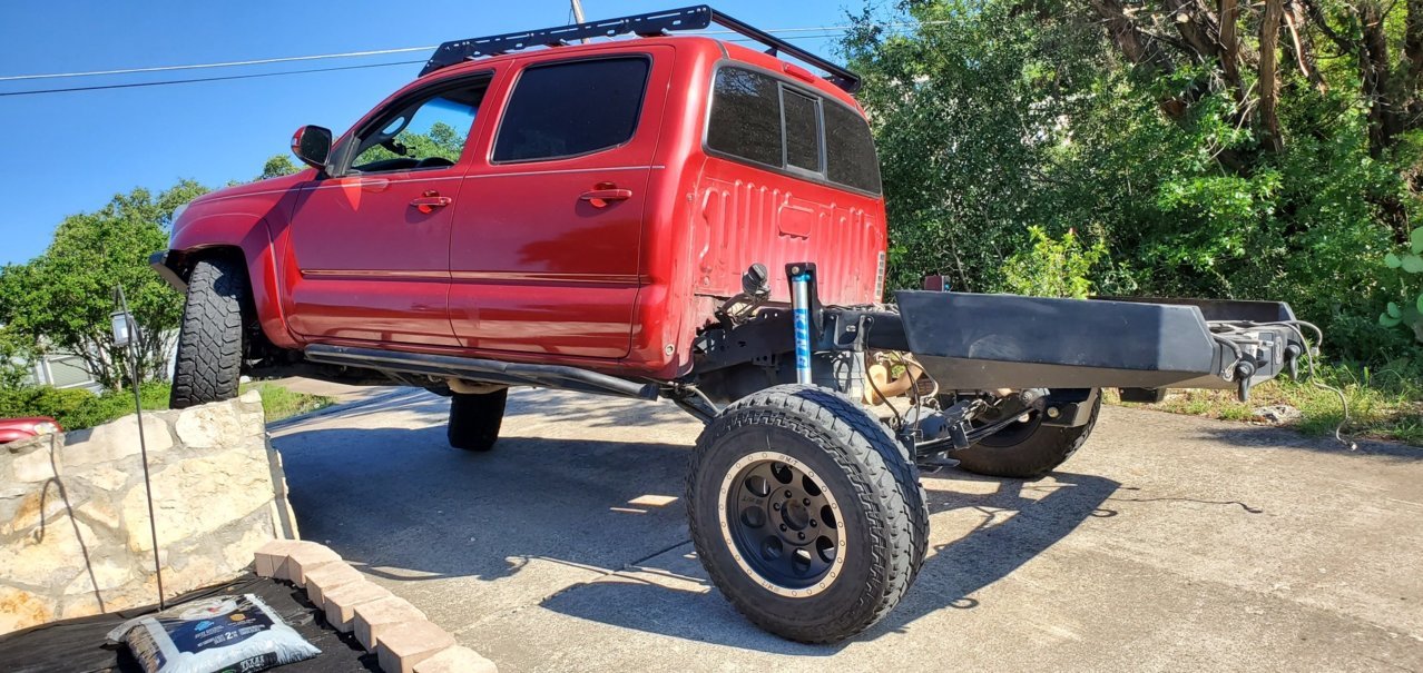

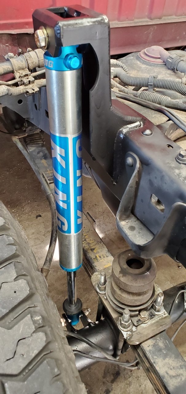

    Hopefully soon. My bilstein 7100 14” short bodies with RR should be here within the next few days. Then I just need to convince the wife to let me drop my truck off at my fabricator. I don’t want to do the relocation myself personally.

    Hell ya I love the this setup with I did this right off the bat. I know you’ve seen the flex but got dang it’s a game changer for me.

    Can you post some pics?

    Ya sure and a small video from a little hill climb this weekend. I didn’t install it a local member did.

    Killer. Those are 12” smoothies non RR? How much shaft do you have showing at static height? Love it.

    Thanks, and yes they are got a killer deal on eBay for them.
    At static height about 4.5-5in showing if I had to guess I forgot the measurements.

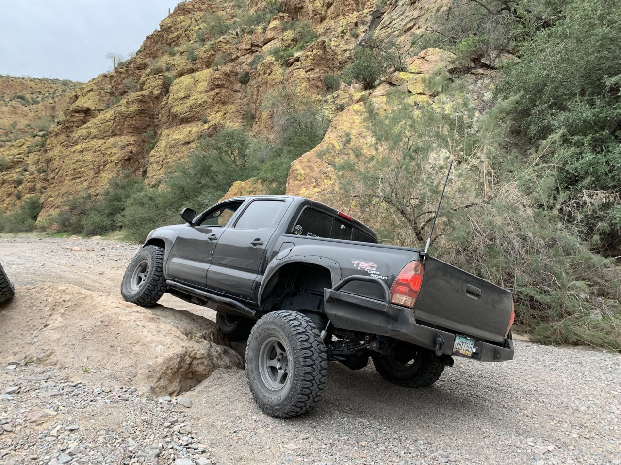

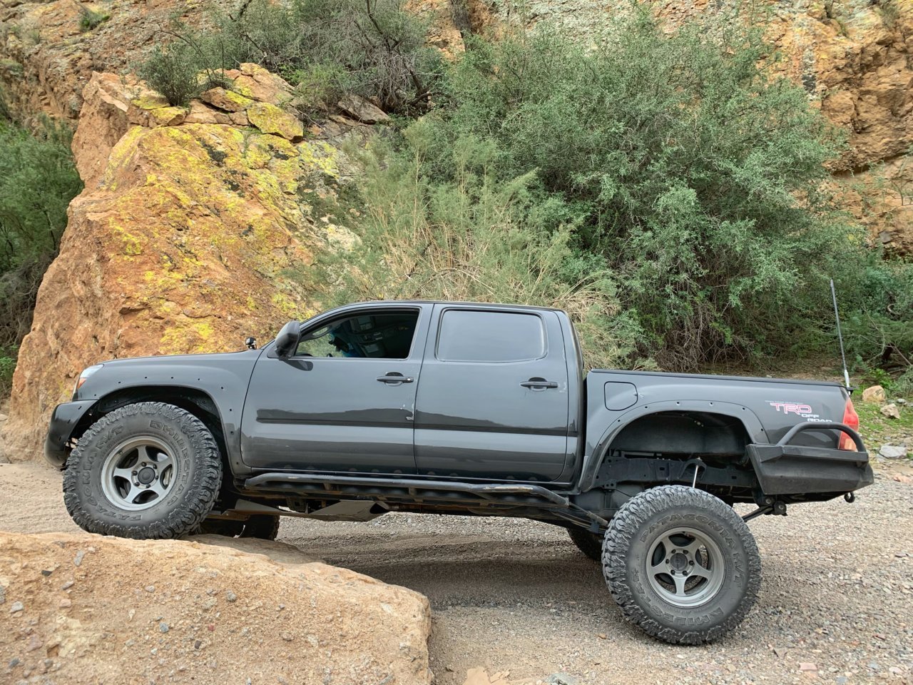

    I’m stoked because this is with my current 27” long shocks. The ones I’ll be putting in are 33” & this is also before hammer hangers. The shackle also wasn’t fully horizontal I believe. So I’m hoping to get 2-3 more inches of droop travel beyond this with HH and 14” short body 7100’s
  17. Mar 5, 2020 at 8:15 AM
    #177
    singletrack_ftw
    singletrack_ftw [OP] “I chopped the wrong leaf!”
    Aug 27, 2017
    #228223
    3,685
    Tyler
    AZ
    ‘08 TRD OR 4wd
    https://www.tacomaworld.com/threads/singletrack’s-‘dad-shred-build-thread’-i’m-just-doing-it-for-the-kids.619250/ Sos offroad sliders (kickout + filler) Sos offroad full belly skids (steel) Sos offroad front recovery point Sos offroad concepts HC rear bumper with bedside kickout tubes Marlin Crawler LCA frame brace kit Trail Gear rear diff cover Bilstein 5100 + OME 885 Total Chaos UCA BILSTEIN b110 OME Dakar standard pack Wheelers Ubolt flip kit Wheelers Superbump f/r Wheelers SS extended brake lines FN five star 16x8 -25 Milestar Patagonia MT 315/75r16 Custom projector retrofit (acme super h1 + morimoto 4300k) Baja Designs S2 sport ditch pods on CBI ditch pod mounts Amazon AMAK rock lights CMC CB radio hardmount
    You can actually see the 2nd leaf preventing further droop travel there.
