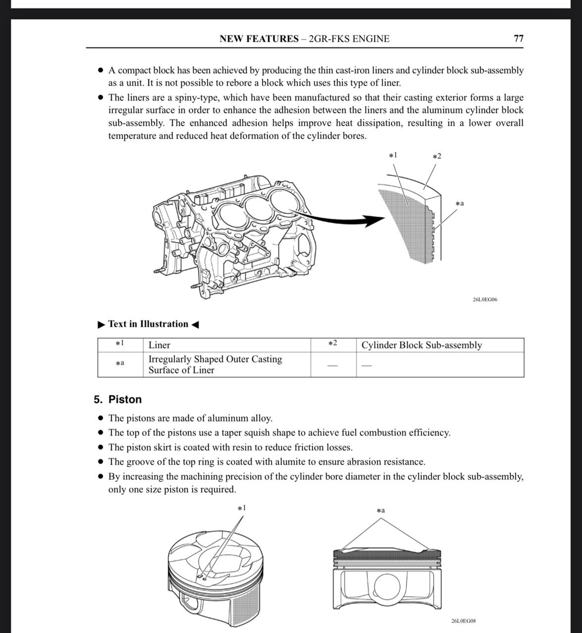

    So unfortunately that video does have a glaring error regarding “sprayed on liners”. I’m sure the creator will discover this as he becomes more familiar with this engine. It does have proper cast iron sleeves, not a spray-on coating. However, as stated below, Toyota does not recommend a rebore.
    This is a great document to nerd out on:
    http://www.toyotareference.com/guts/tacoma16_engine.pdf

    Can something like this be re-sleeved?

  3. Nov 7, 2021 at 5:33 PM
    #43
    Stocklocker
    Stocklocker [OP] Well-Known Member
    May 15, 2017
    #219125
    12,738
    17TRDORDCSBAT
    No. It’s a “spiny type” liner, which basically means the back of the iron liners has a texture that is cast right into the aluminum block.
  4. Nov 7, 2021 at 5:37 PM
    #44
    Amanelot
    Amanelot Member
    Jul 29, 2018
    #260931
    1,869
    Texas
    2016 MGM TRD Sport DCSB
    I read that in your picture, but it didn't click what that meant until your response. Pretty darn cool. I wonder why they chose this route?

    2gr darton sleeves should fit. you have to completely cut the cylinders out and press fit them.
    Amanelot[QUOTED] likes this.

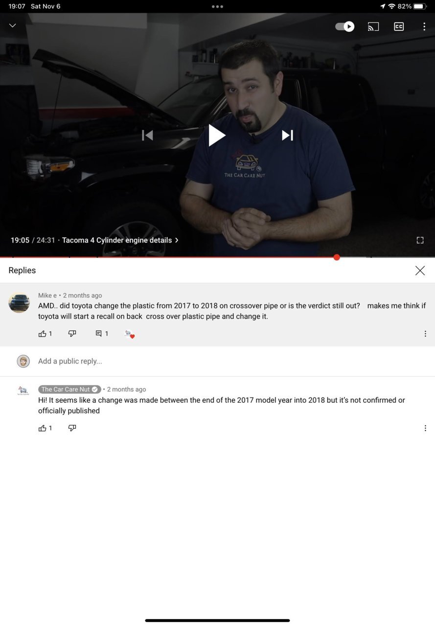

    Tough call on fixing it. However they say that the pipe was possibly updated as there are no more reported issues with the 18'ish and up. But it's unconfirmed as per AMD See below Screen Shot. Also, Car Care Nut. 14:20 mark. https://youtu.be/ei5yC4IdDhs

    Interesting design, but I wouldn't think that they cast the iron liners in place. Iron melts at around 2800°F, aluminum melts around 1300°F. Pouring 2800° iron into an aluminum casting probably wouldn't be free of voids and defects.
    My guess would be the iron sleeves are cast (probably investment cast to make the precise "spiny" projections) then set in place in the mold, then the aluminum. is poured into the mold sealing the cast iron liners in place.
    Impressive engineering technology
  20. Nov 9, 2021 at 8:22 AM
    #60
    Stocklocker
    May 15, 2017
    #219125
    12,738
    17TRDORDCSBAT
    That what I meant. The iron liners are there, and the block cast around them.
