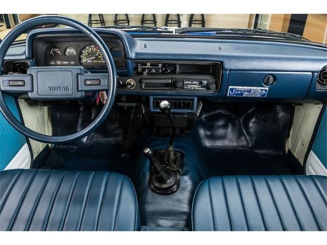

    Yeah the interiors all felt the same in the cars vs the trucks there for awhile. Think the 3rd is a stand alone. It does remind me slightly of the early eighties trucks, with a more of horizontal dash, no center pod and round vents.

    I really like the 3rd gen Tacoma interior. Nice and clean, just modern enough, without looking like the bridge of the Starship Enterprise.
    It’s tasteful.

    It is my favorite so far, nice and basic without going over the top. Besides of course a 40 Series, or even an early 70 Series.
    I hear you on the starship enterprise! Lol!
