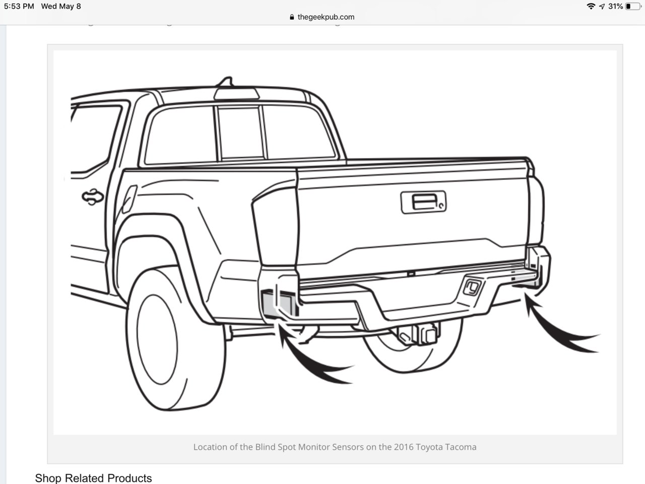

    Silly question where are the sensors? They sure are not on the rear bumper unless they are paint coloured lol

    i believe they are inside the ends of the bumper. I don't think you can see them.

    A lot of people used to report that error if enough snow or mud got packed on the underside of the rear bumper.
    That would be my first look. Wash out the underside and let it dry.

    So I cleaned out the truck bumper underneath .. problem is still ongoing .. ugh headache .. I like that the side mirrors lit up when vehicles were in the “blind spots” also it used to beep when vehicles where behind the truck … ughh
