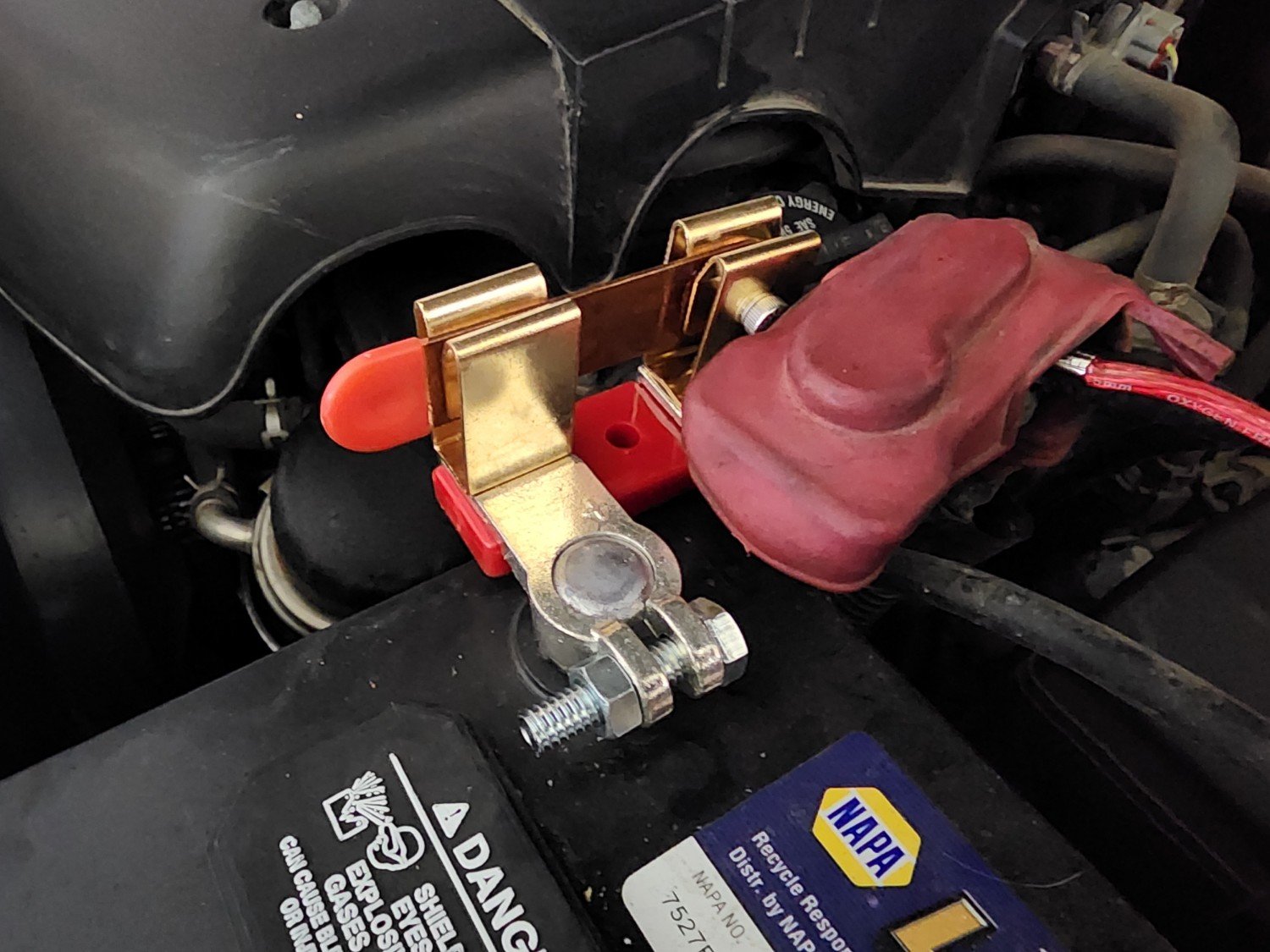

    Being that the Check engine + Trac off issue is only occasional, but still irritating to reset, after it happened this past week, I decided to stop looking for my wrench to take off the positive battery terminal, and installed a blade switch instead. Now I dare it to annoy me again.

    But that doesn't fix the problem, it just turns the lights off until the next time the code sets.

    If you're disconnecting the battery to turn the light off for yourself, so be it.
    But if you're doing it to pass inspection, it may be worse.
    It resets the readiness monitors too. And those can take 100, 200, or more miles to pass.
    It's your truck, do as you please. Just throwing it out there.
    I haven't fixed things on my truck, because it doesn't bother me.
    So I can't say much.

    Yeah, I'm planning to figure out what's caused it here shortly. I couldn't find my Bluetooth OBDII reader forever, so it was just a workaround to get the lights off. Finally found it on the bookshelf in my living room, where I'd put it a couple of years ago "so I'll know where it is". I'll hook it up this week when I get time; hoping it's just a gas cap issue.
