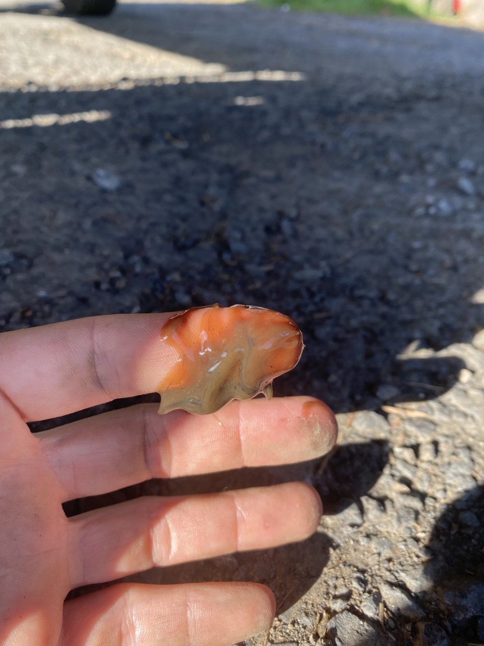

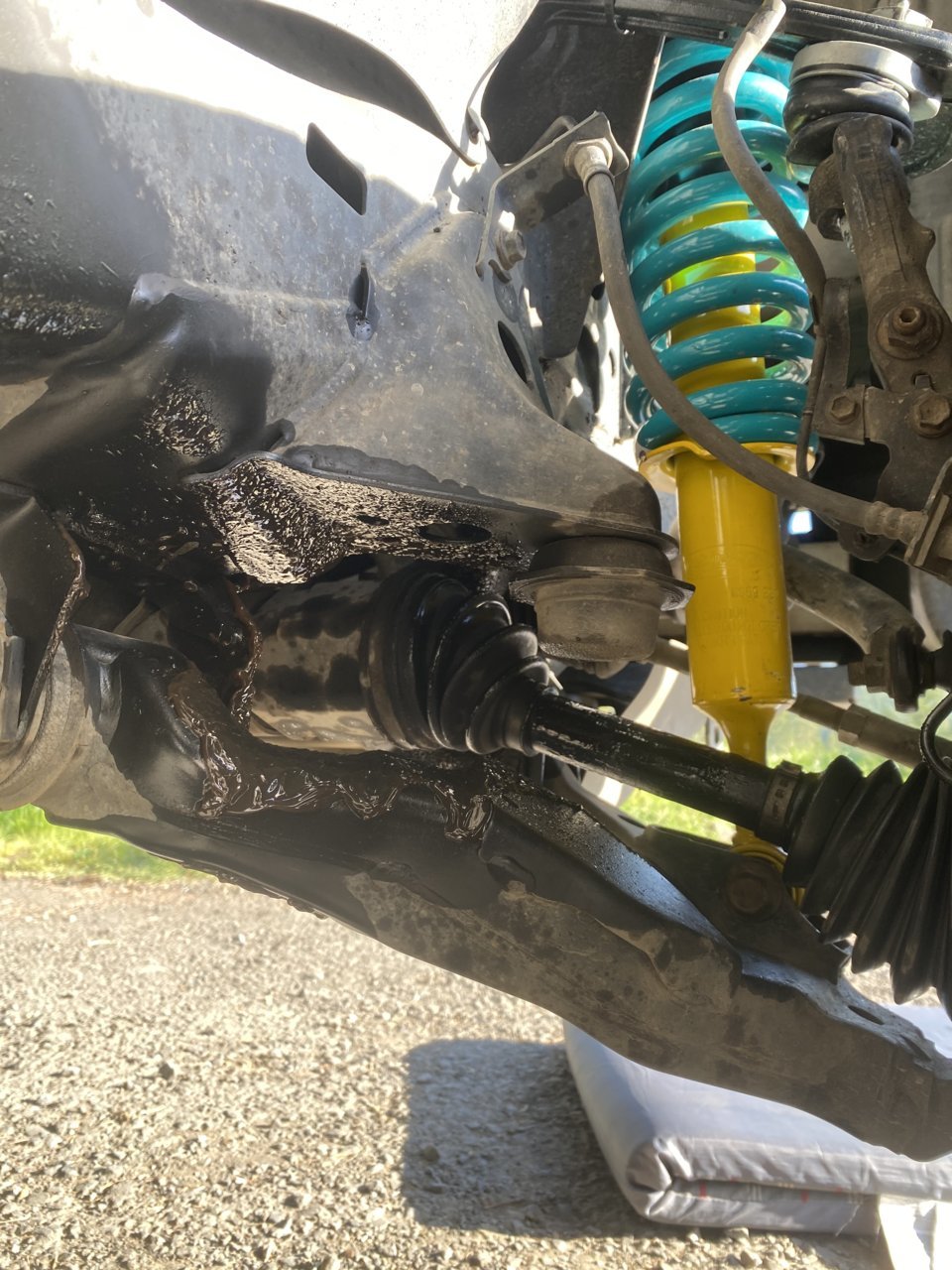

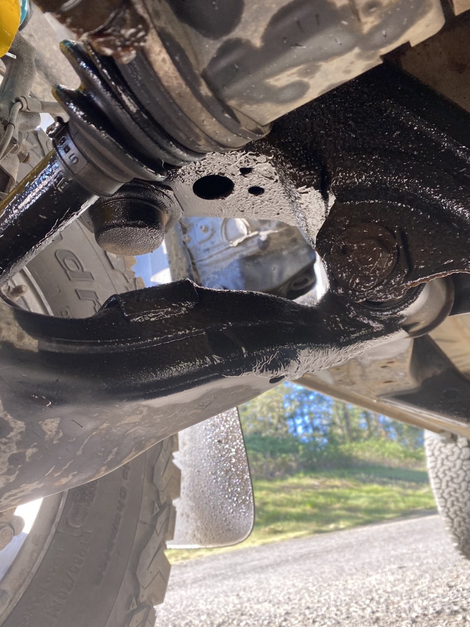

    Need some help fellas. Was just about to head to town when I noticed there was grease everywhere behind my right front wheel.
    It looks like it’s coming from the inward sides of the LCA bushings. I just had a new lift put in and alignment done a couple weeks ago.
    Any ideas what this could be?

    Yep, my guess its a CV boot.

    Your cv angle is too great and you’ve burst your sealed joint. Your lift is your problem.

    Was just going to say... that angle is a tad excessive.

    Looks like you have dobinsons front coilovers. I would talk to crikeymike and see if he can help your out with you cv issues. I know they specifically sell high angle cv boots and other products. Best of luck.

    Upon further inspection the seal on the CV boot is clearly bad (I used protection this time).
