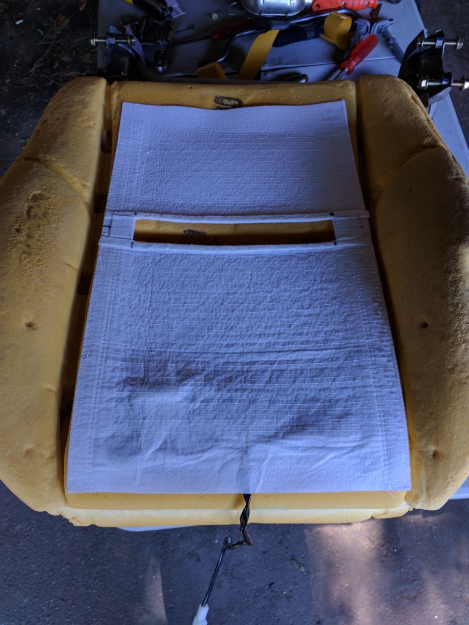

    Got the heaters on Amazon. The controllers are rotary 0-5 adjustable for each seat. Under a 100 when I bought them.
    I relocated the fuses that came with them to the other end of a wire run to the battery. The control power came from an add a fuse tapped in the cab fuse block.

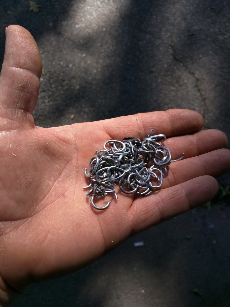

    Tractor supply has hog ring pliers, you'll need them and a pair of electricians diagonal cutters to cut out the existing ones.
    The seat cover clips on the sides and front and will come off. Hog rings in the back underneath.

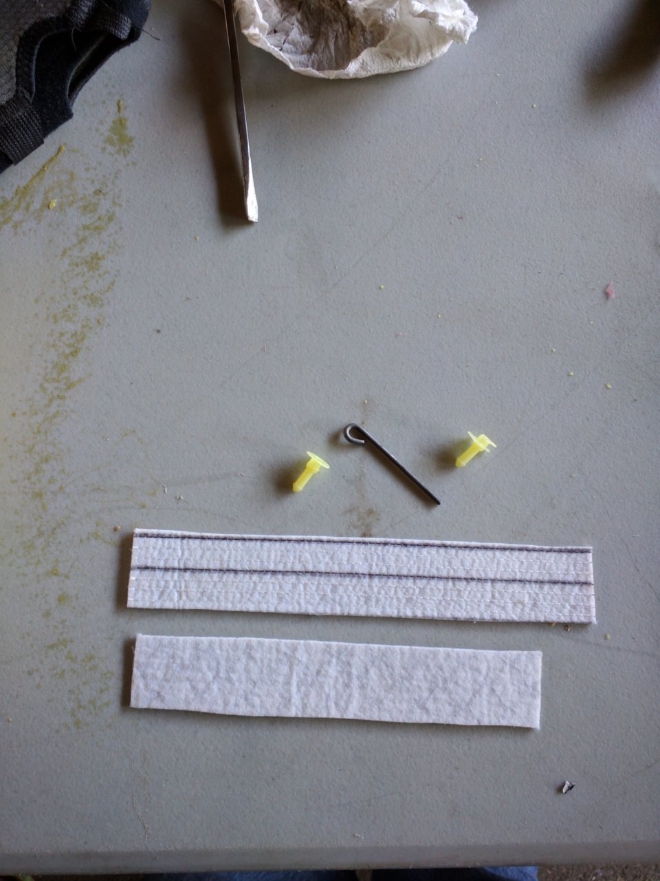

    The lines in the seats that go side to side are done with a metal rod, in a pocket sewn in the back of the seat cover that is attached with hog rings to a wire in the seat cushion. You will cut the heater mat to accommodate this.
    Pics:
    The seats aren't that difficult to take apart.
    When cutting the mat, you want to bind the edges so the heating element doesn't fray.
    I believe the last pic is either the hog rings cut taking the seat apart or the ones I f'd up putting the seat back together.:rofl::rofl::rofl:
    Edit: to those are the practice ones. Lol
