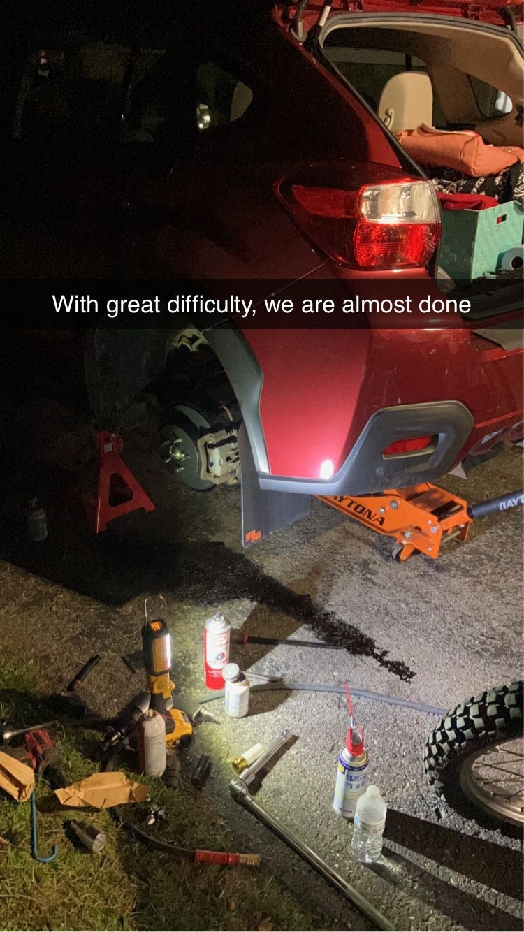

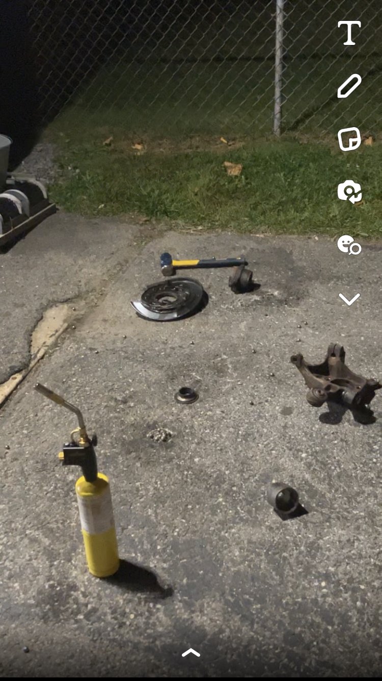

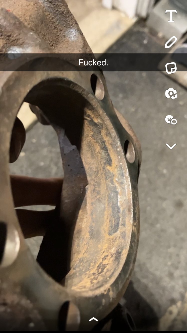

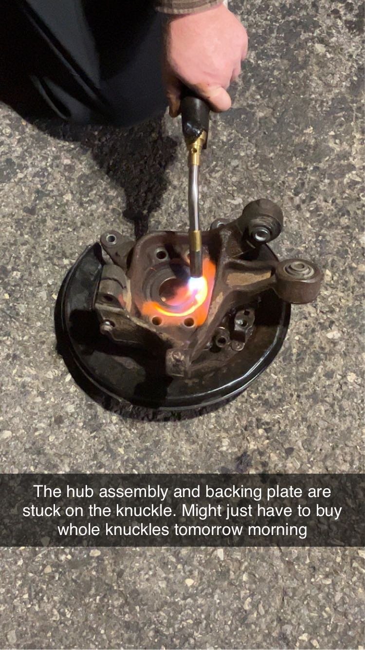

    Alright, its been a while, this is going to be a long winded post/couple of posts. Here we go.
    We have had an issue with the rear brakes on this car almost since we got it. I swapped out the original rusty brakes for centric coated rotors and ceramic pads around 24k i believe. One of the inboard rear pads jammed up in the slider and decinigrated itself against the back of the rotor. Replaced the pads with duralast gold pads. Same thing happened again, but i caught it before it ruined the pads. Lots of rust, holy fucking rust bucket, subaru PLEASE FUCKING COAT YOUR GODDAMN CARS WITH SOME KIND OF FUCKING ENAMEL PAINT YOU CHEAP FUCKS. UNCOATED MILD STEEL IS NOT ACCEPTABLE.

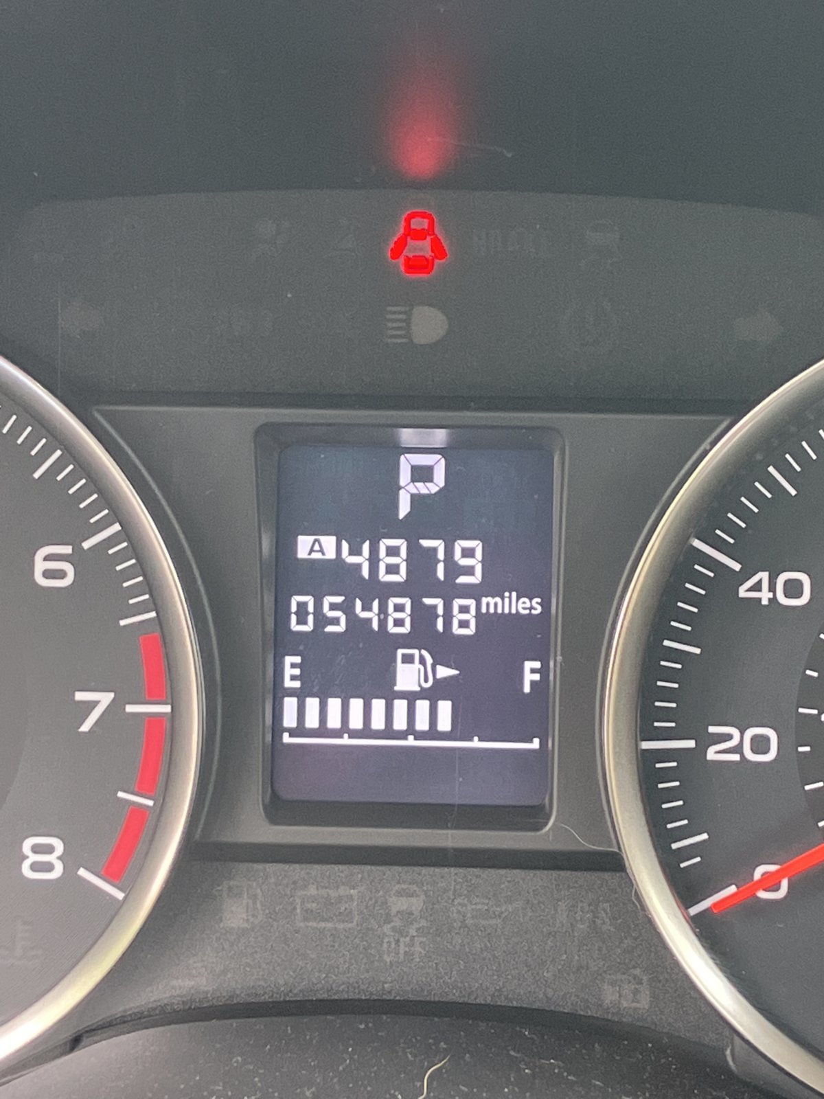

    Anyway, Alec kept complaining of a brake “noise” that would come and go in the passenger side rear. It would rain or snow overnight and then the car would make the grinding noise for a couple days. This continued on inconsistently all year. UNTIL I FOUND THE PROBLEM just shy of 51,000 miles.

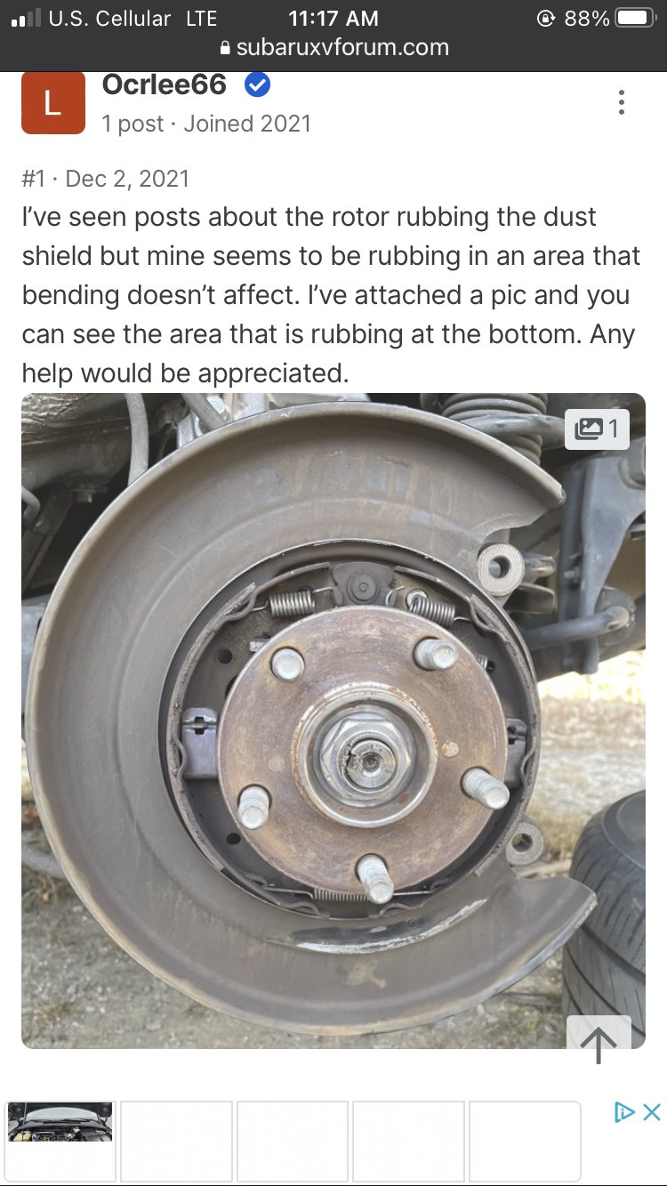

    https://static.nhtsa.gov/odi/tsbs/2020/MC-10185064-0001.pdf
    Subaru put out a TSB for all crosstrek/outback/foresters from 2013-2019 for the REAR brake dust shields rotting and warping to cause contact with the back of the rotor, which creates enough friction to overheat the knuckle and bearing/hub assembly. Should have been a recall, fuck you Subaru.
    this is what that looks like:
    Ruby did that on BOTH sides but it was WAAAAAAAAAAY worse on the passenger side. So I tore the car down and found that both rear wheel bearings were compromised. ZERO lateral play, but they both had clicking/dead spots in the rotation from the grease being superheated and cooked out of them, lovely. Ordered NTN/Timken hub assemblies from rock auto, new rotors/pads from autozone, and went to the subaru dealership to get the CORRECT UPDATED PART NUMBER dust shields. To which, the parts guy told me they do this TSB literally ALL THE TIME. Great.
    So I thought I was good to go, got all my parts and i’m just gonna R&R, right? Wrong.
    Tried for three hours to get the passenger side (the worst side) hub assembly out of the knuckle. Ended up removing the knuckle, putting it in a 20Ton press, when that failed, I laid the assembly on the blacktop, super heated it, flash cooled it, and beat it with a 5lb sledge for another ten to fifteen minutes. By the time i was done, the knuckle and hub union was broken and the pressed bushings in the knuckle had started to show signs of having been melted a little. Additionally, the mating surface for the bearings had so much rust/rot, that the new assemblies would not go in straight and true. So now that knuckle is fucked and the car was bricked. I’m about $640 in at this point.
    Back to the dealership, tried to order knuckles, they didnt have them, so i got the part numbers and ordered them myself. A week later, which was last night, we tried again with all new everything (knuckle, hub, rotor, pads). With zero difficulty, the passenger side fell back together. Fortunately the ball joints, bushings and toe arms were all still in great shape everywhere and even the fuckin speed/abs sensors NEVER MELTED, which is insane to me still. The driver’s side fought when coming apart, the upper control arm ball joint froze inside the knuckle and took a lot of persuasion to unmarry itself from the old knuckle we were trying to eliminate. Finally got it all. From 4pm, to 9pm, we got it all done. Over $955 later, we have the car back. First and ONLY MAJOR failure we have had with this car and I almost just traded the fuckin thing in on a Rav4 adventure. I’m still pissed.

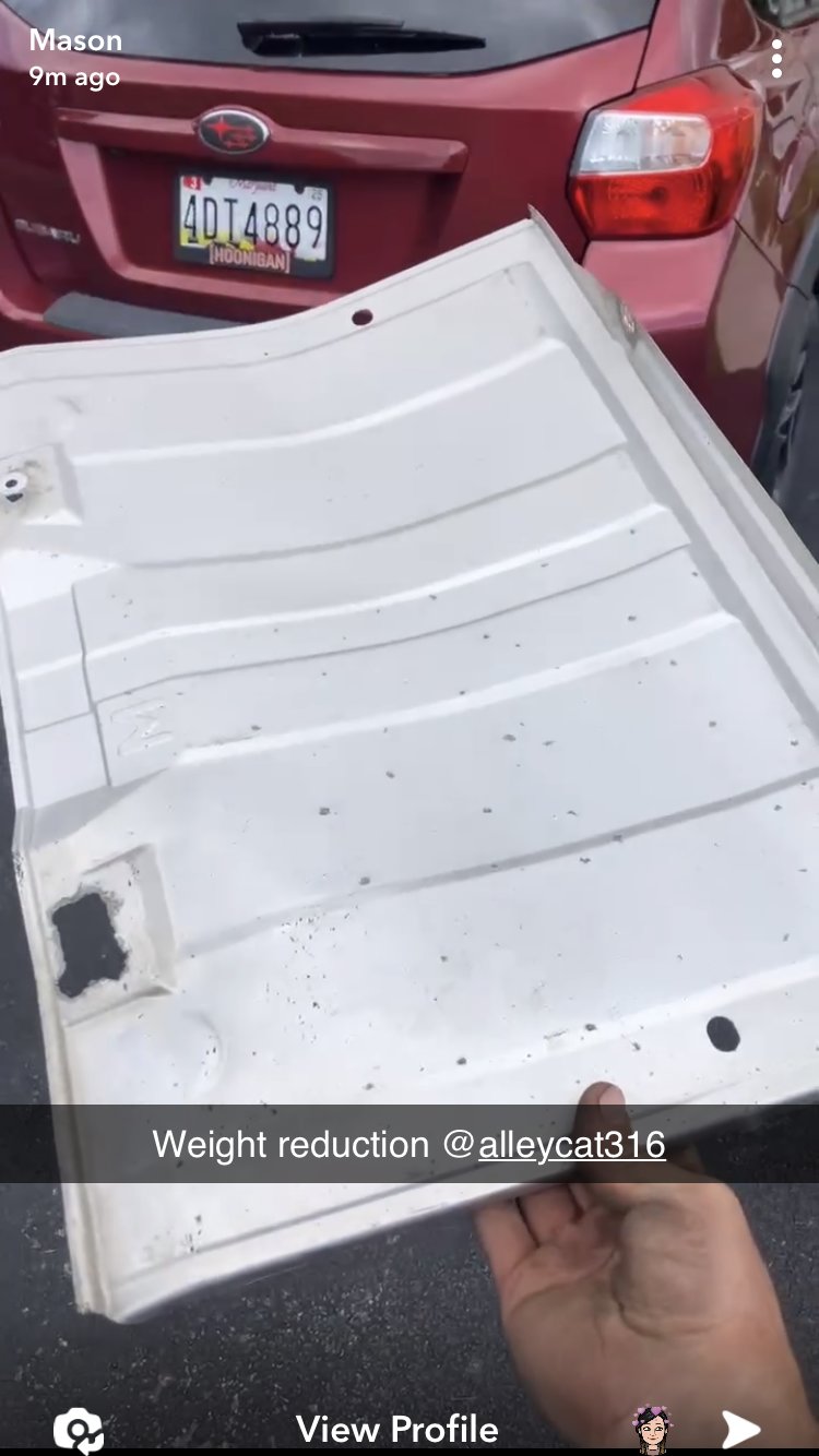

    Oil changed, tires rotated, heat shield removed (weight reduction)
