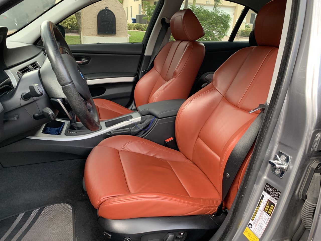

  13. Oct 5, 2019 at 4:16 PM
    #33
    Stormtrooper1
    Stormtrooper1 Well-Known Member
    Feb 18, 2017
    #210949
    56
    I can’t get over how the seat rises improved the ride quality. I drove my bmw 335 the other day with m3 seats and I thought my truck was more comfortable. Truly amazing the difference made.
