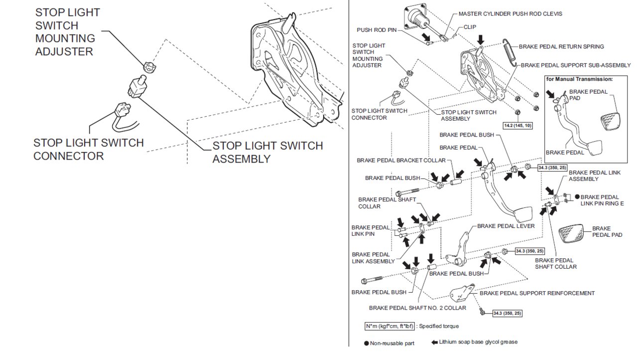

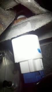

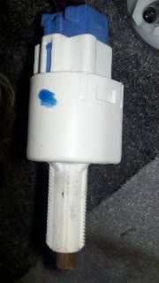

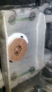

    [Do I in need to take the bottom plastic piece - the one under
    the steering wheel- off before I will be able to see and get to the break sensor pictured below? (*not a picture of my truck*)

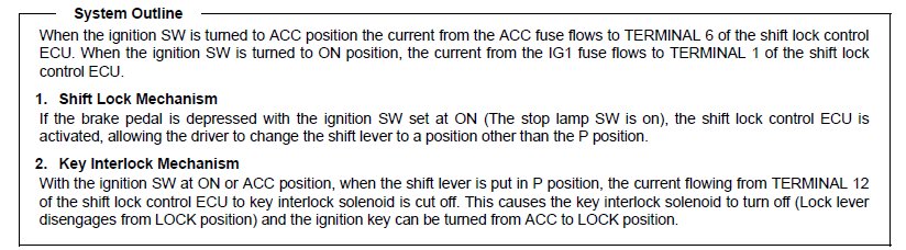

    My husband’s truck (Tacoma 2011) has been “stuck” in park for about a month now - abs and traction control dash lights came on (and are still on) at the same time.
    — he is able to use the truck by pushing the tiny override button to shift out of park (it’s an automatic) But knowing something must be causing the shifter to stay put, i came here for answers.
    I’ve been searching about for the potential cause(s) for the shifter not wanting to move, and after reading through many of these awesomely informative threads, my first guess is that this break sensor thing has been knocked out or gone bad. but, when I look up under the break pedal as Far as I can see - I cannot see anything resembling what I see in the pictures (at the end of my post.) and the similar clip things I DO see I cant figure out how to get to to easily disconnect and replace.

    No need to remove dash panels.
    Follow the brake pedal “shaft” from the foot piece up to its hinge.
    Reach around the back, and you should feel a wire loom that goes to the brake pedal sensor.
    Find the hard plastic body, give it a 1/4 turn to the left
    It should drop out relatively easily
    From there you can see the clip and remove it.

    @L.Strong If you ever come back to this thread, you should be aware that your husband is driving around with no brake lights.
    Before you go digging around under the dash, check the stop fuse.

    Thank you for this diagram I will be checking this fuse as soon as he is home with the truck.
    And yes I told him his breaks aren’t working- was surprised he hadn't realized this or been pulled over for it yet ! I did replace a blown 10a “tail” fuse inside the truck and no it didn’t fix the stuck in park problem and he said he noticed his break lights were on when he was scraping. Snow this morning. I do have a new break switch coming in the mail but will check this fuse under the hood as well. Thank you for sharing your knowledge!

    Thank you for this as it is exactly how I got it removed

    Thank you for this very helpful diagram!
