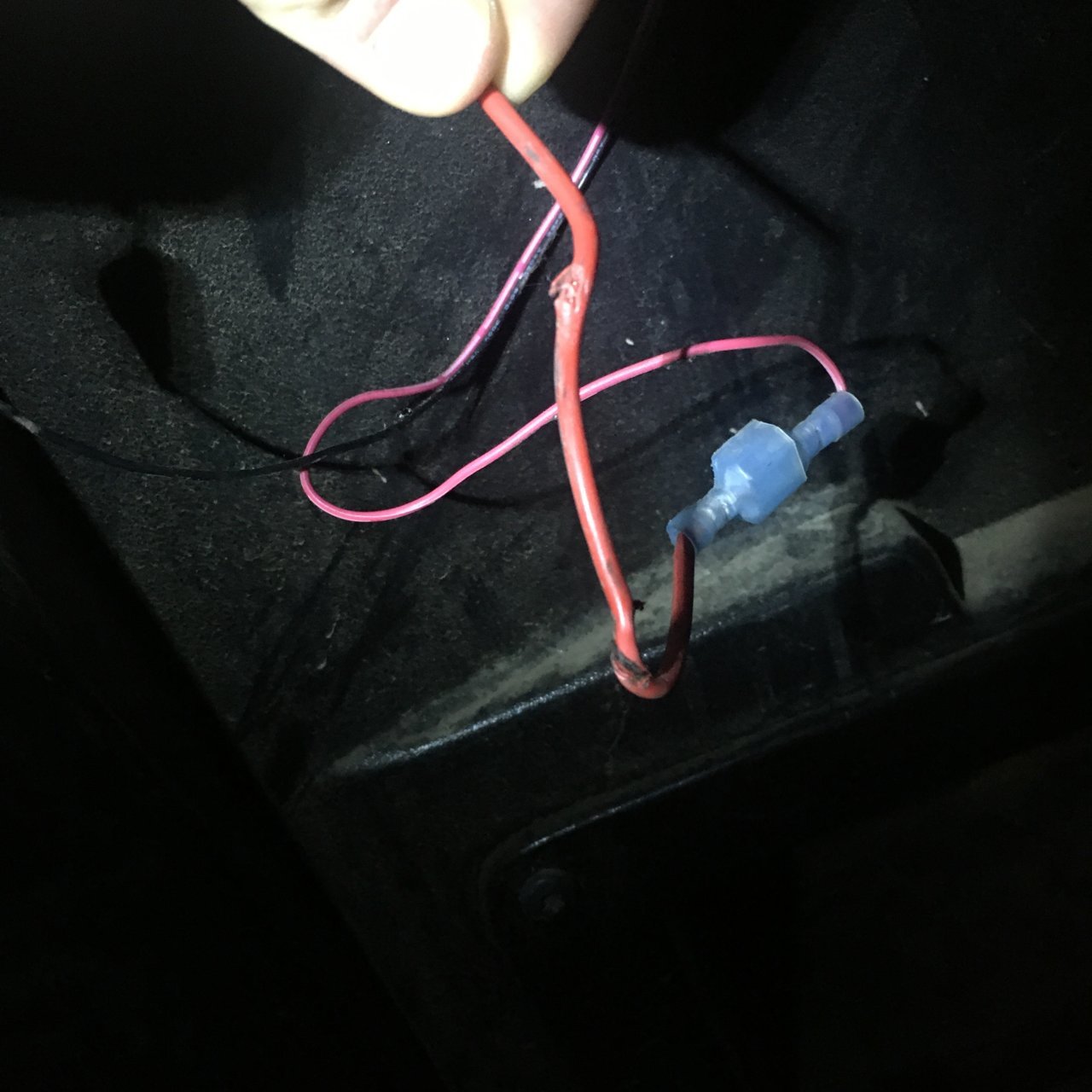

    and I think maybe I found the culprit- one of the wires coming from taillight has definitely been pinched so the coating is removed - sorry for the dark picture - but could this exposed wire cause fuse to short out? The broken area defiantly rests on the tailgate and could very easily bump metal when he pushes the breaks.
    if this is the issue would covering the wire with electrical tape be a sufficient fix?

    Oh yeah, that would definitely do it. Wrapping with electrical tape and zip tying or taping the wires up so they're not dangling would solve the problem. In a perfect world, the wiring should be redone properly, but we're not talking about the guidance system for the international space station here.

    Yep. This.
    Wrap it, check for function.

    @Naveronski and @Muddinfun I can’t say thank you enough. Wire has been wrapped - it was exposed in two places, probably had been pinched in the tailgate- and I velcro’ed it all up out of the way.
