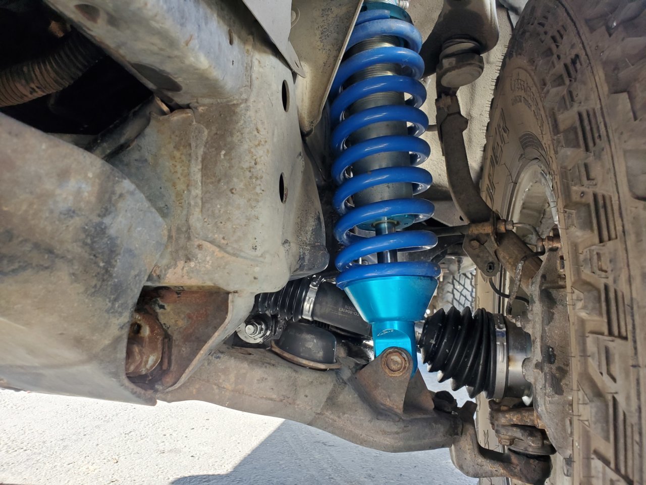

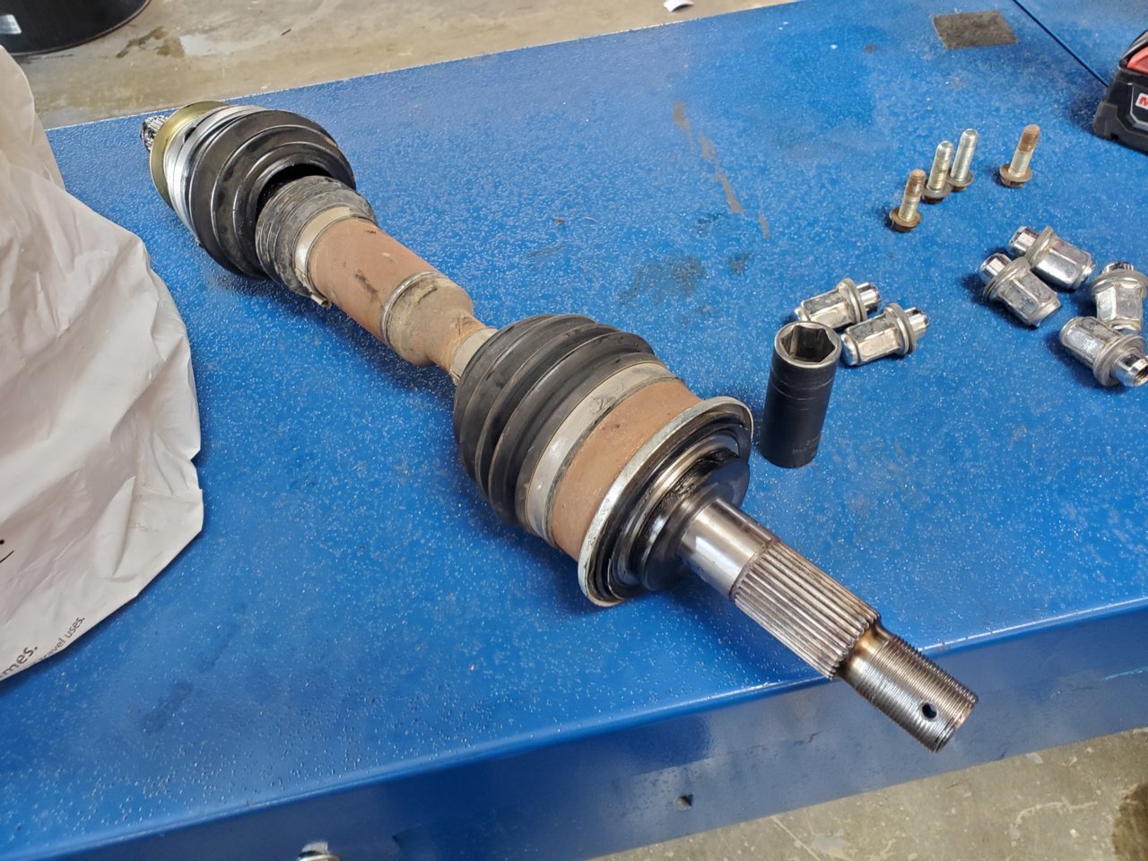

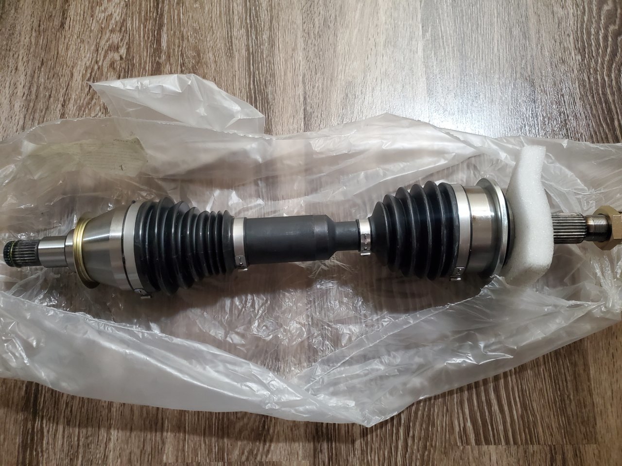

    On the subject of CV axles, I will say I've run O'Reilly's "ET" variants for roughly 10 months and have put over 20k miles on them.
    Here when I bought them new -
    After install -
    And after 9 months of heavy use -
    I've gone off-roading quite a bit with them in mud, snow, and dirt.
    Aside from the inner boots ripping pretty quickly 4-5 months in, with my 2.5" lift, they're very stout.

    My stock UCA's and King shocks being the inhibitor because these cv axles definitely allow a lot of travel -
