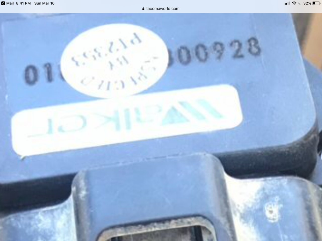

    Are you getting any codes, or it just won't run?
    Can you post a photo showing the connector wires and the MAF sensor part number?

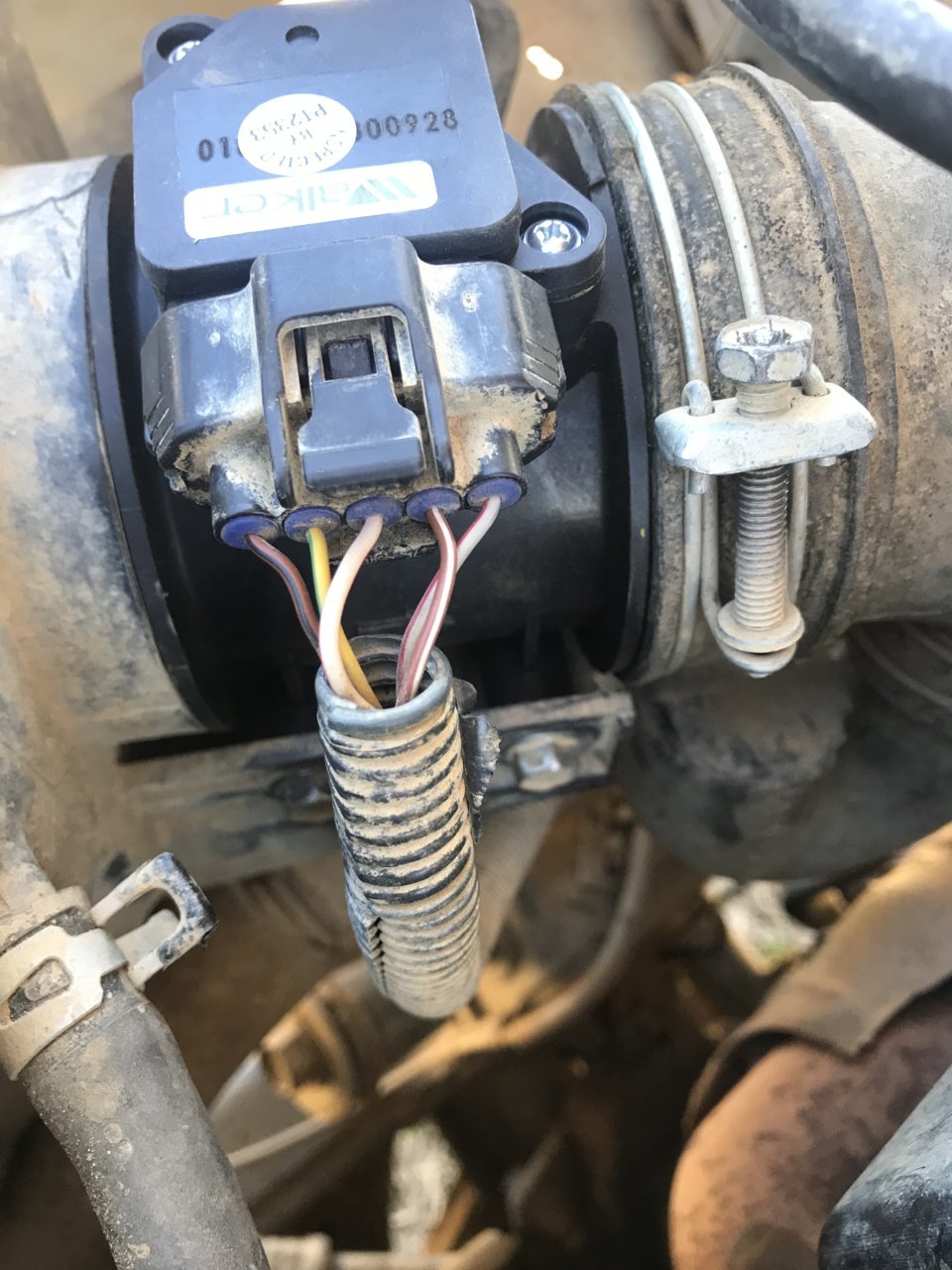

    Here’s my repin
    1997tacomav6[OP] likes this.

    The wiring looks right, although there are two W/R wires, did you leave the one on the right in its original location and just move the other one?
    Also, I'm not familiar with the rockauto sensor, is it for the '99+ models?

    If I remember I did leave the one wire in place on the right side.

    I’ll try to swap the red white wire around.

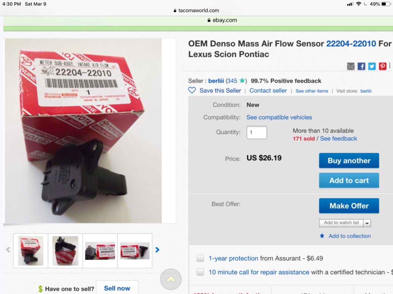

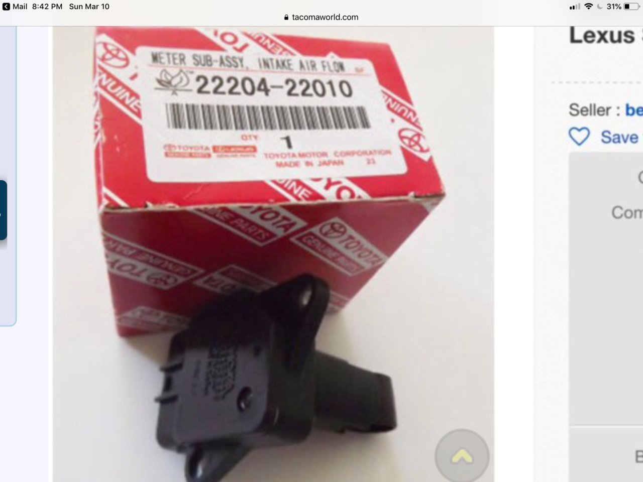

    I used the suggested sensor from ebay with no issues. Also, I did not move the far right wire on the connector.

    I would first replace the Walker sensor you have with a DESNO sensor

    I changed my pin around and this worked great! Cant tell much yet. Haven't been able to drive got wheel bearing trouble.
