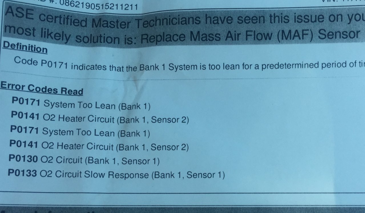

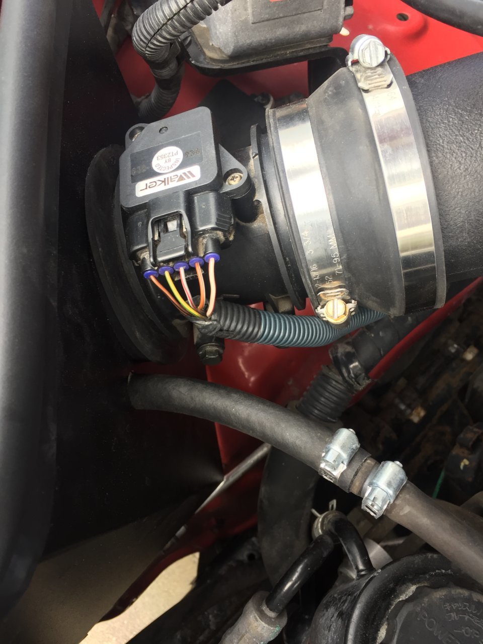

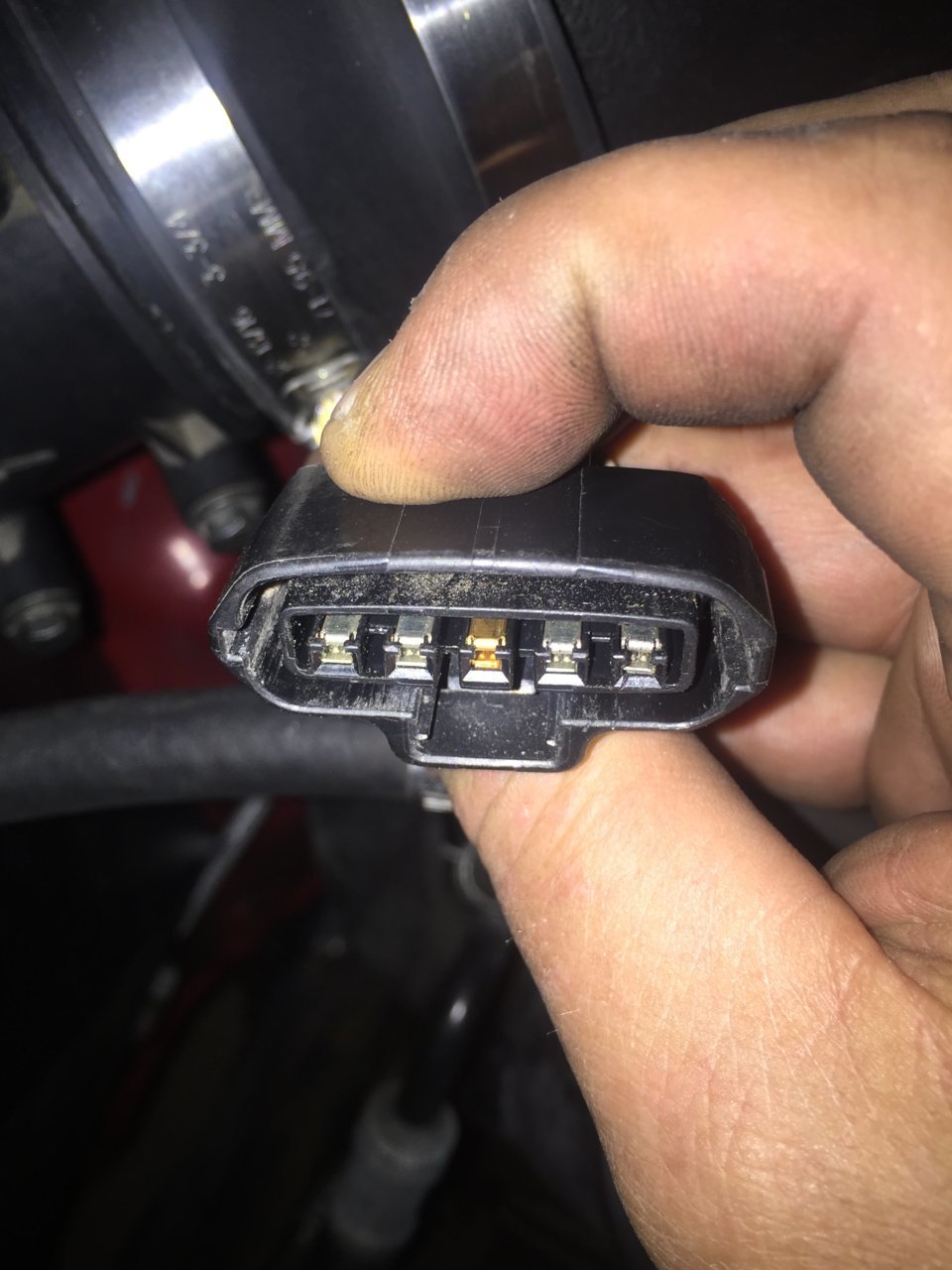

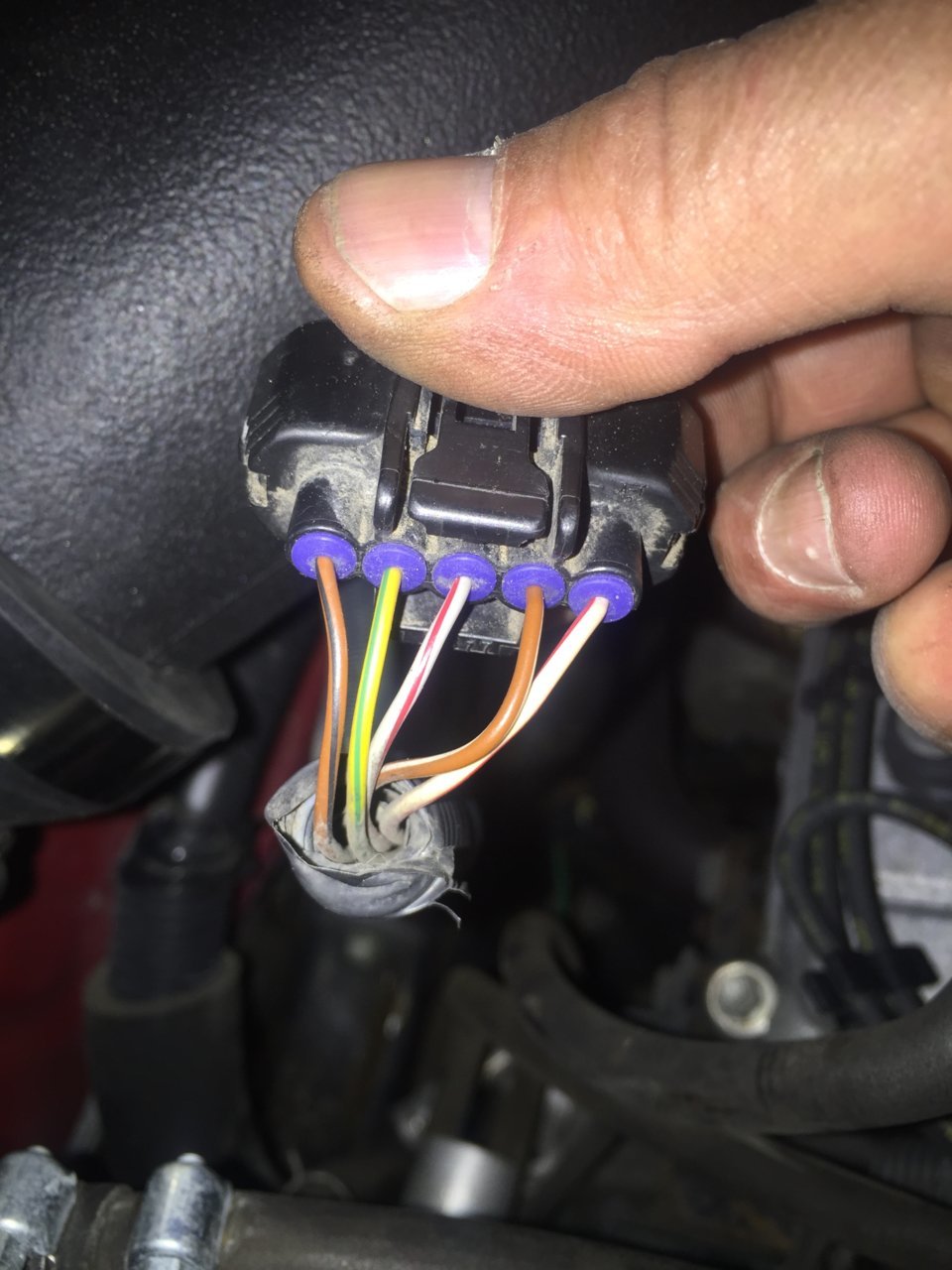

    Just bought a 97 supercharged and the check engine came on bummer . MAF codes came up so I did this conversion . Check engine light came back on real quick! Double checking if anyone can help. I’m wondering if my wiring is right an about the white and red strip wires . One has a gold tip. Does the gold one go in the middle like it is now or do I swap the whites. Any suggestions on eliminating the code?

    Wait, the light came on before the you did the swap?
    You sure it was the MAF code? Check vacuum leaks?
    What code?
    It will work for the 1997 truck, your wires are the same as mine.

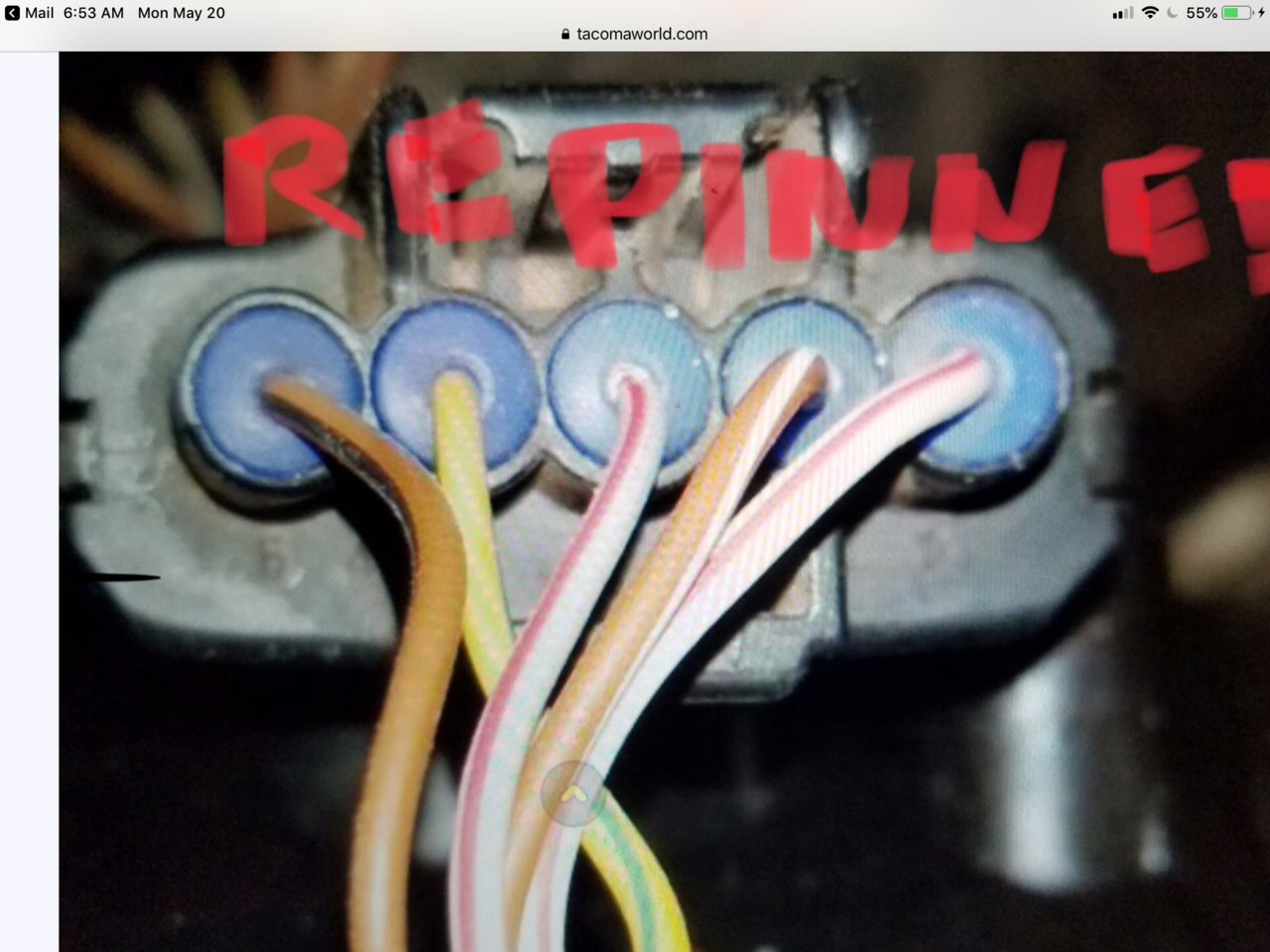

    Yes. Codes in pic. I have look for looked for leaks found only one so far . So the wire configuration I have is right ? Gold in the middle?863040F9-B251-43D6-AEEA-551236F5C575.jpg

    Yours is the same year, same wire configuration as mine, your is correct, you have a problem from some other issue I think

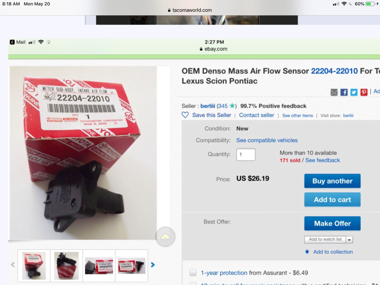

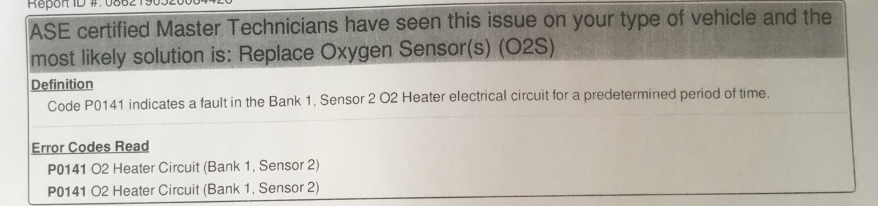

    Yes sir ! Just stoped by the auto parts store on my way back home to check codes again. Looks like the MAF code went away from last night stoked now I’m left with these codes should be a simple fix. Thanks for your time @1997tacomav6 and checking my repin.

    PO171 code can be a bad cat, bad plugs injector, vacuum leak, fuel filter plugged,
    Try resetting ECU

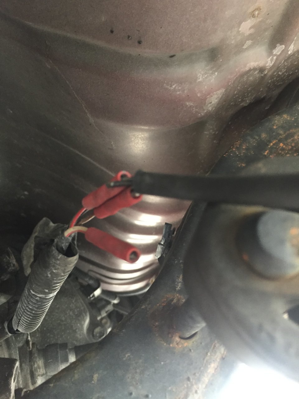

    So far so good found my o2 censer problem . Light hasn’t came on yet:fingerscrossed:096511C9-D052-4F8D-9B55-40551CF949F7.jpg4D7A0E8B-5F08-4A02-8F70-FDA992B34D1C.jpg
