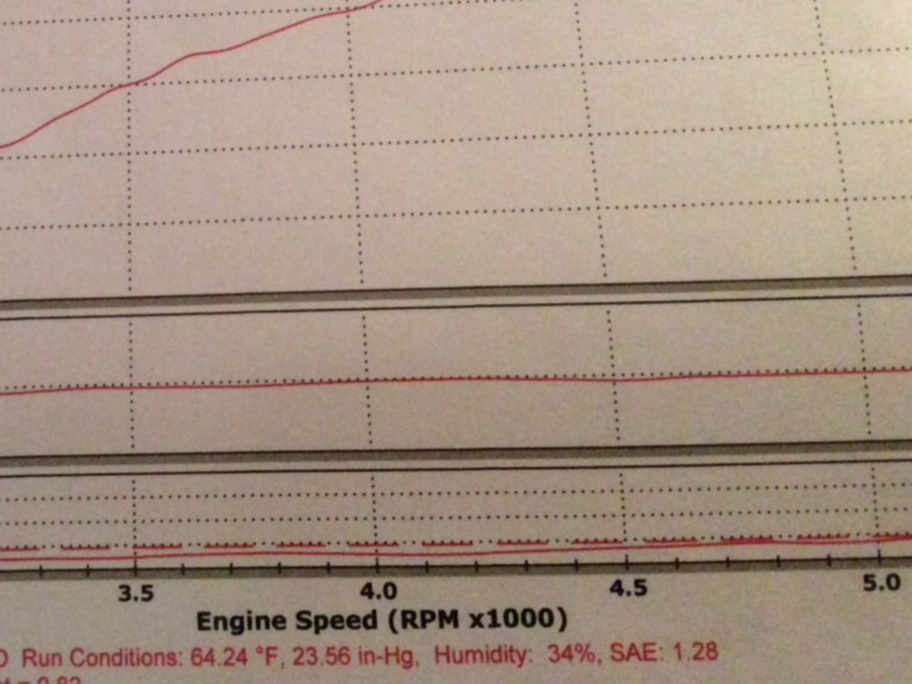

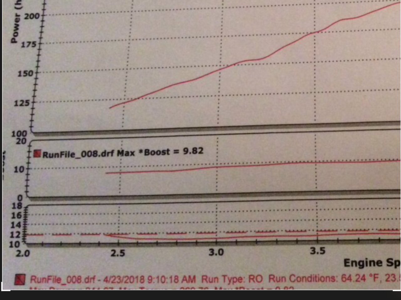

    Your funny, “ignorance is bliss” I seriously would not have a supercharged 3.4 with almost 600,000 miles of actually supercharged miles and not know what my motor is capable of.
    I had a speed shop setup my methonal kit and tune it for what the motor needs for added fuel.
    It runs with perfect AFR that is shown on the dyno graph.
    I have the larger 3.4 injectors, bored throttle body, ported supercharger, and. 2” pulley, and the added Volvo MAF. I will see if I can get my trims checked, but I’m sure they will be higher because off the added air flow I have compared to most.
    Either way keeping my AFR correct has been with the methonal kit all the way up the rpm range.
    The AEM FIC 6 is probably the better way to go if you know how to adjust your maps.
    The AFR reads the actual reading from the exhaust where as the fuel trims are read from the MAF I thought. So your 7th injection or methonal additives are not actually seen in the fuel trims so I thought so I have not looked to see fuel trims because they would not be telling me the whole truth unless I had an engine issue
