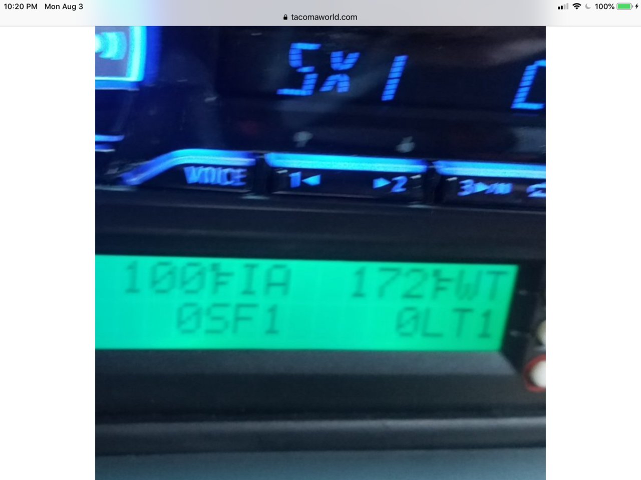

    AN UPDATE ON THIS MOD 40,000 MILES LATER
    Every thing was going very well till a month ago.
    I was having high fuel trim issues at +10 to +15 +19
    I actually replaced my fuel pump thinking this was my problem.
    It was over due anyways. Didn’t fix the problem.
    I bought 2 new MAF off eBay (they ended up being fake Toyota) and then a DENSO from Napa.
    My fuel trims with the 2 off eBay MAF were not good at +10
    The Napa DENSO fuel trims were at +5
    So I just went and bought an OEM MAF from the dealer and now my fuel trims are at ZERO 90 percent
    of the time,
    The DENSO and OEM MAF didn’t look the same either.
    If you do this MOD and use an aftermarket MAF sensor the fuel trims may have issues with an aftermarket MAF
    With the OEM MAF my numbers are excellent.

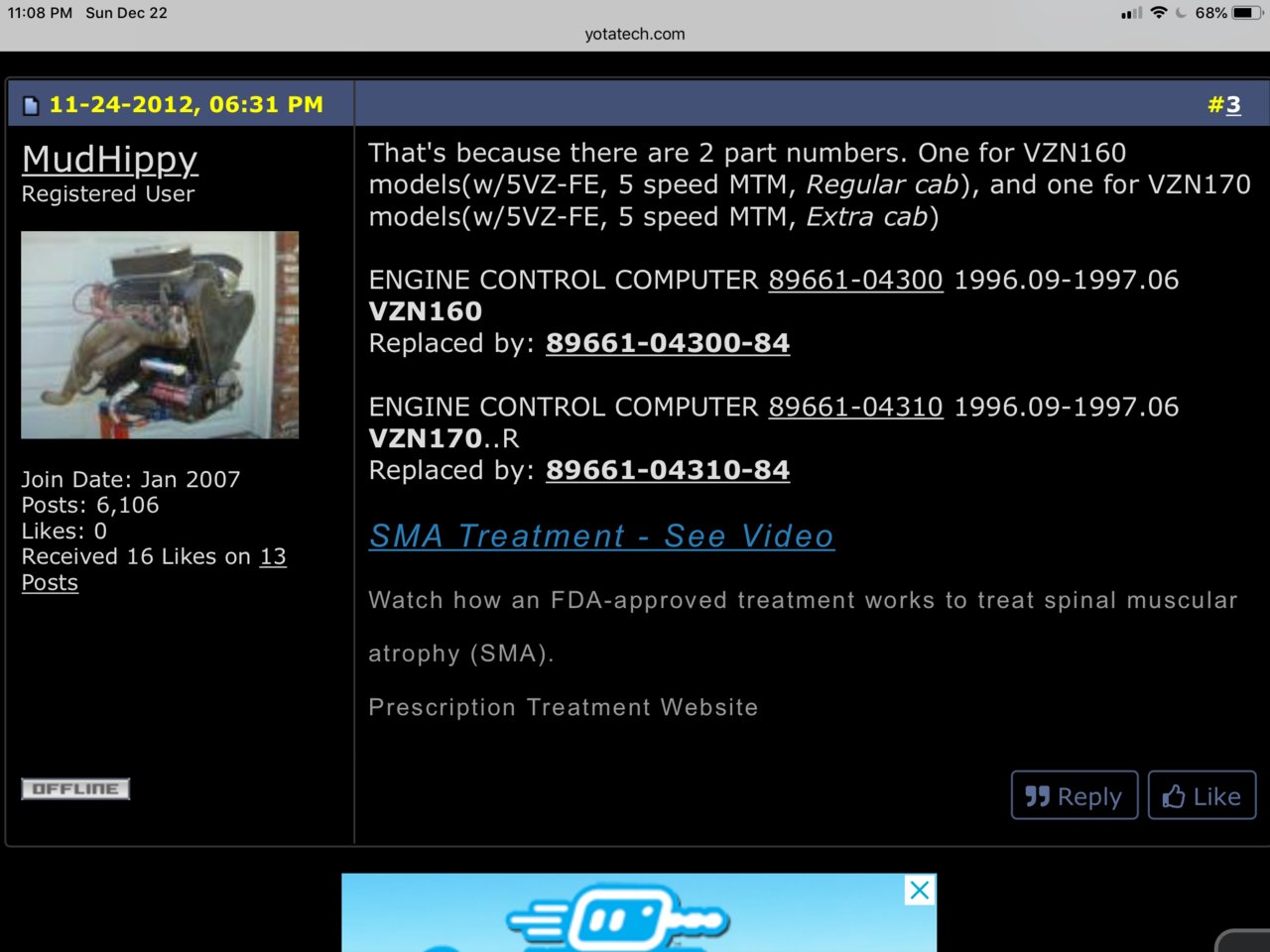

    Says the different numbers for 1997, they are for a reg cab and an Extra cab.
    Not sure why they would be different tho,
    Both are 4x4, 3,4, Manual

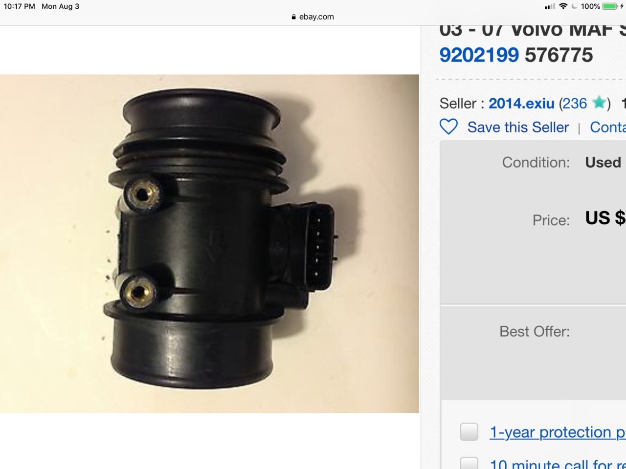

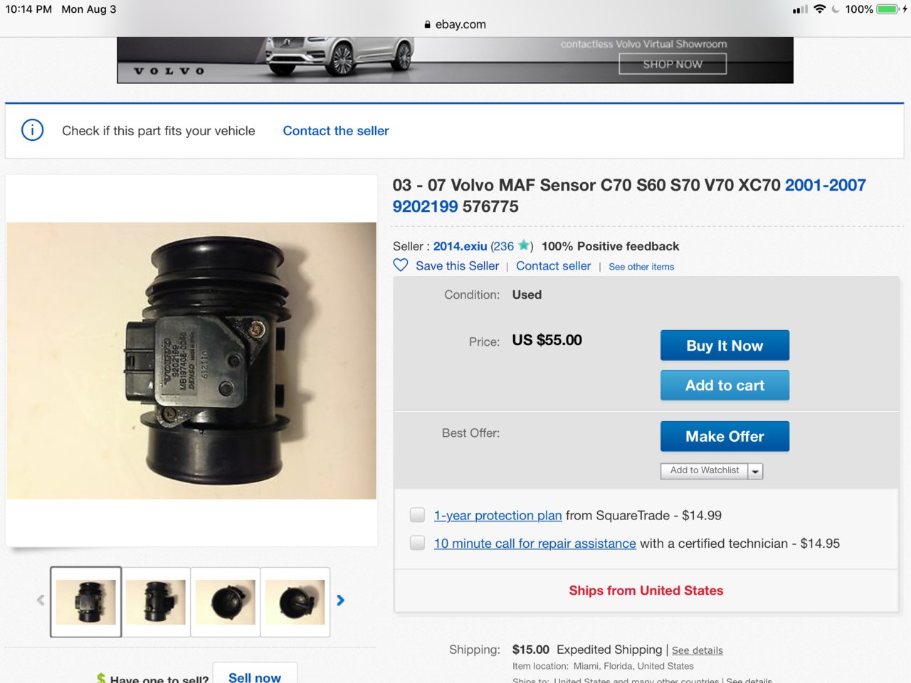

    1997tacomav6 do you know the part number for the Volvo MAF tube? I am in australia and the only s60 MAFS I can find have a flange mounting design, nothing with the 2 bolts coming from the side like in your photos?
    Cheers

    #293
    1997tacomav6
    1997tacomav6 [OP] V6 5sp,RegCab,TVS1320 Supercharger,Haltech, 800k
    Oct 5, 2013
    #113940
    10,386
    John
    Denver
    97 reg cab, v6 5sp 300hp supercharged, Methonal Injection, 800,001 plus miles, Original Owner
    V6 5sp,RegCab,TVS1320 Supercharger, 56mm pulley, methanol injected Haltech ECU, AC Tvs1320 supercharger,(MUST DO) every 125,000- 150,000 needs rebuild Projector headlights HID 5 speed manual Amsoil for all drive train Smaller 56mm custom pulley, (MUST DO) 2004 DESNO fuel injectors, zero ping ping, 2004 side door mirrors Dick Cepek Rims, Michelin tires LTX, ATM Pathfinders Dynopro ATM ( that last 100,000 miles) Now running Dynopro ATM mud and snow tires KN cold air intake Cat back dual exhaust with ss exhaust tip, Raised exhaust tail pipe to 2" below body line Optima*dry cell battery,red top Alpine sirius radio, 200 watt amp, focal is165 split door pod speakers Focal door speakers Subwoffer behind seat Viper alarm, Electric Locks Dark tinted windows, bucket seats corbeau lg1 Tacoma Rubber floor mats TRD fender extenders, Bilstien shocks, King shocks JBA UCA trailer iv hitch, electric brake control, Drilled slotted brakes, High carbon steel (MUST DO) EBS green stuff 7000 series pads(MUST DO) TRD engine oil cap TRD stick shift, Marlin crawl shift kit. Rear sliding window 2002 4Runner functional hood scoop cut into Tacoma hood, 4Runner dual overhead map light Gentex Auto dim + Compass + Temp, garage,rearview mirror Snow Methonal kit stage 2 Custom 3 core aluminum radiator Linex bed liner Haltech stand alone ECU, Intake supercharger gauge. Stainless steel brake lines, Custom leather wrapped steering wheel, Haltech stand-alone ECU,
  14. Aug 3, 2020 at 9:21 PM
    #294
    1997tacomav6
    Oct 5, 2013
    #113940
    10,386
    John
    Denver
    I just bought an OEM MAF sensor from the dealership, there are SO many fake
    DENSO toyota ones out there.
    Perfect trims,
    SpikerEng[QUOTED] likes this.
