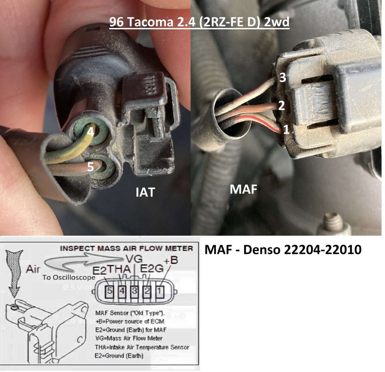

  13. Jul 11, 2021 at 3:10 PM
    #313
    cheeriotaco
    cheeriotaco Member
    Jul 11, 2021
    #371010
    11
    1996 purple tacoma 2.4 rwd
    n/a
    So I'm trying to do this 5 pin conversion for my 96 Tacoma 2.4 and it wouldn't run. It would start up and then stall and die in 2 sec. I'm using a Spectre performance 3" air sensor mount from AutoZone with a Spectre Performance SPE-8148 3" Air Duct Mounting Plate. I am currently trying a 02 Camery MAF (Denso 22204-07010) which I am not sure how the MAF internal wiring different from the Denso 22204-22010 but I think they wouldn't be any different. I just ordered a Denso22204-07010 from ebay and I'll see what happen when it comes. As for now, I'll take the MAF from my 05 Prius and test it out on my conversion because they use the same Denso MAF model.
    Below is an image of what I have to deal with atm and the pinout to the MAF.
    1997tacomav6[OP] likes this.

  15. Jul 11, 2021 at 4:52 PM
    #315
    cheeriotaco
    cheeriotaco Member
    Jul 11, 2021
    #371010
    11
    n/a
    Thanks, 1997tacomav6. So your saying that in order for this to really work, it would require an 1997 up ECU to even work/function properly? That going to be hard to find!
  16. Jul 11, 2021 at 4:55 PM
    #316
    1997tacomav6
    1997tacomav6 [OP] V6 5sp,RegCab,TVS1320 Supercharger,Haltech, 800k
    Oct 5, 2013
    #113940
    10,386
    John
    Denver
    97 reg cab, v6 5sp 300hp supercharged, Methonal Injection, 800,001 plus miles, Original Owner
    V6 5sp,RegCab,TVS1320 Supercharger, 56mm pulley, methanol injected Haltech ECU, AC Tvs1320 supercharger,(MUST DO) every 125,000- 150,000 needs rebuild Projector headlights HID 5 speed manual Amsoil for all drive train Smaller 56mm custom pulley, (MUST DO) 2004 DESNO fuel injectors, zero ping ping, 2004 side door mirrors Dick Cepek Rims, Michelin tires LTX, ATM Pathfinders Dynopro ATM ( that last 100,000 miles) Now running Dynopro ATM mud and snow tires KN cold air intake Cat back dual exhaust with ss exhaust tip, Raised exhaust tail pipe to 2" below body line Optima*dry cell battery,red top Alpine sirius radio, 200 watt amp, focal is165 split door pod speakers Focal door speakers Subwoffer behind seat Viper alarm, Electric Locks Dark tinted windows, bucket seats corbeau lg1 Tacoma Rubber floor mats TRD fender extenders, Bilstien shocks, King shocks JBA UCA trailer iv hitch, electric brake control, Drilled slotted brakes, High carbon steel (MUST DO) EBS green stuff 7000 series pads(MUST DO) TRD engine oil cap TRD stick shift, Marlin crawl shift kit. Rear sliding window 2002 4Runner functional hood scoop cut into Tacoma hood, 4Runner dual overhead map light Gentex Auto dim + Compass + Temp, garage,rearview mirror Snow Methonal kit stage 2 Custom 3 core aluminum radiator Linex bed liner Haltech stand alone ECU, Intake supercharger gauge. Stainless steel brake lines, Custom leather wrapped steering wheel, Haltech stand-alone ECU,
    Correct,
    It seems that others tried this swap that were 95+96 and it didn’t work to well.
    1997 they switched to a newer type ECU
  17. Jul 11, 2021 at 6:56 PM
    #317
    cheeriotaco
    cheeriotaco Member
    Jul 11, 2021
    #371010
    11
    n/a
    Alright, some new. I was able to swap MAF Denso 22204-22010 from my 05 prius and with the Denso 22204-07010 (02 Camery) and the 05 prius ran fine with the 02 Camery MAF. But with the test of the correct Denso 22204-22010 in the 96 tacoma it still have the same issue.
    So, I'm trying to understand this. According to this thread, it was ruled out that the ECU found in the 95-96 Tacoma used a different mapping that separated the IAT & MAF. But what I don't understand is that this wouldn't cause an issue as long as the wire is pin to the same pinout location to the ecu and the signal is being wired to the correct pin on the 5pin MAF sensor, then it should still work. Unless the 97 Tacoma ECU was mapped to recognize a 5pin MAF and vice versa to the 5pin MAF Sensor. Correct?
