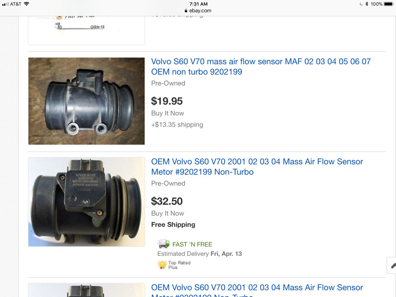

    OP can you post pics of the tube from different angles or provide a part number? All the tubes I see on EBay for the s60 look different from yours and the bolt orientation for the sensor appears to be different.

    There are a few types available but the one you wants will look almost identical to the Tacoma one and will have the same screws
    that are part of the plastic as shown.
    The sensor position is the same, the double lip rubber end is what goes into the air box side.
    There are plenty on eBay from 12.00 up
    OEM Volvo S60 V70 2001 02 03 04 Mass Air Flow Sensor Metor #9202199 Non-Turbo

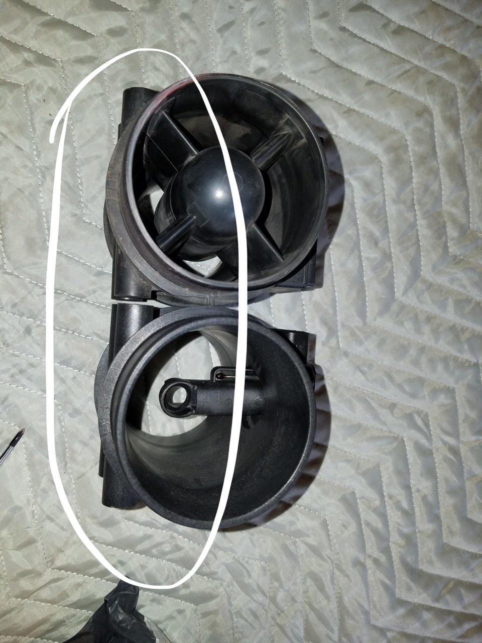

    Yes, it’s pretty obvious how much of a blockage the original tube section has.
    The newer MAF sensor works much better. For my mileage to have jumped 2 miles more per gallon
    for me it’s amazing just by changing out a part.
    It’s a 50.00 investment, how can anyone go wrong and be able to swap in a new DESNO MAF sensor at anytime in a few minutes. Even if you got 1 more mile per gallon it would pay for its self in no time

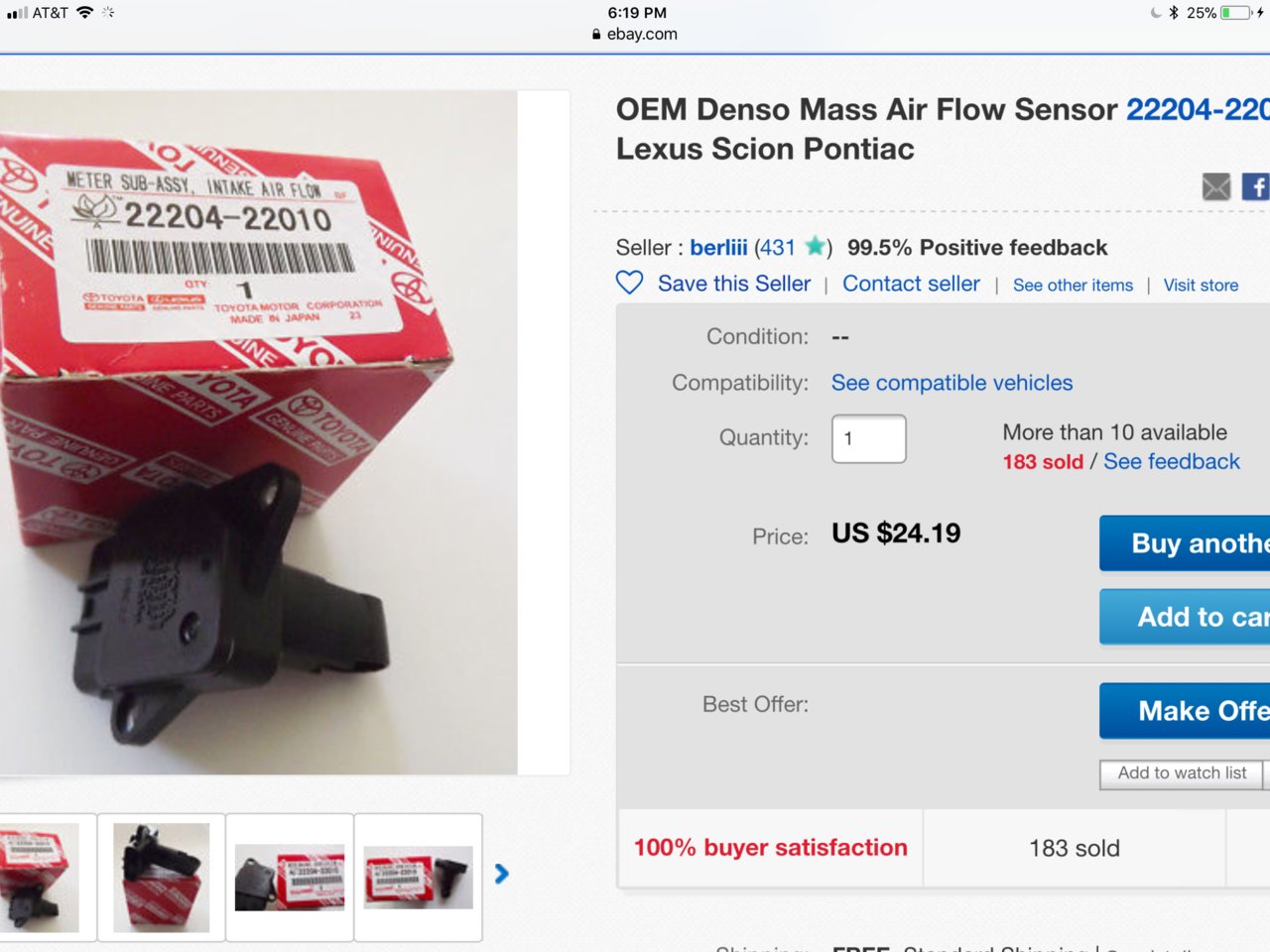

    Order a new DESNO MAF sensor also as shown in the link in the previous page

    Ya ordered a Toyota Denso that was new
    Ordered all same p/n
